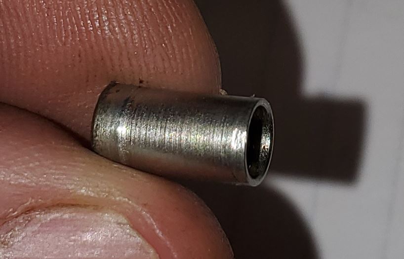

Update... don't drill the plug. It is not a plug, it is actually a pressed-in cup that contains the spring and ball for the rebound clicks. Once that cup is removed the knob assembly and top bevel gear comes out. I may end up threading the hole and making a cup out of a short 6mm bolt since I have boogered up the cup on this shock. I'll try to add a few photos later but it has been a while since I've done that on this board.

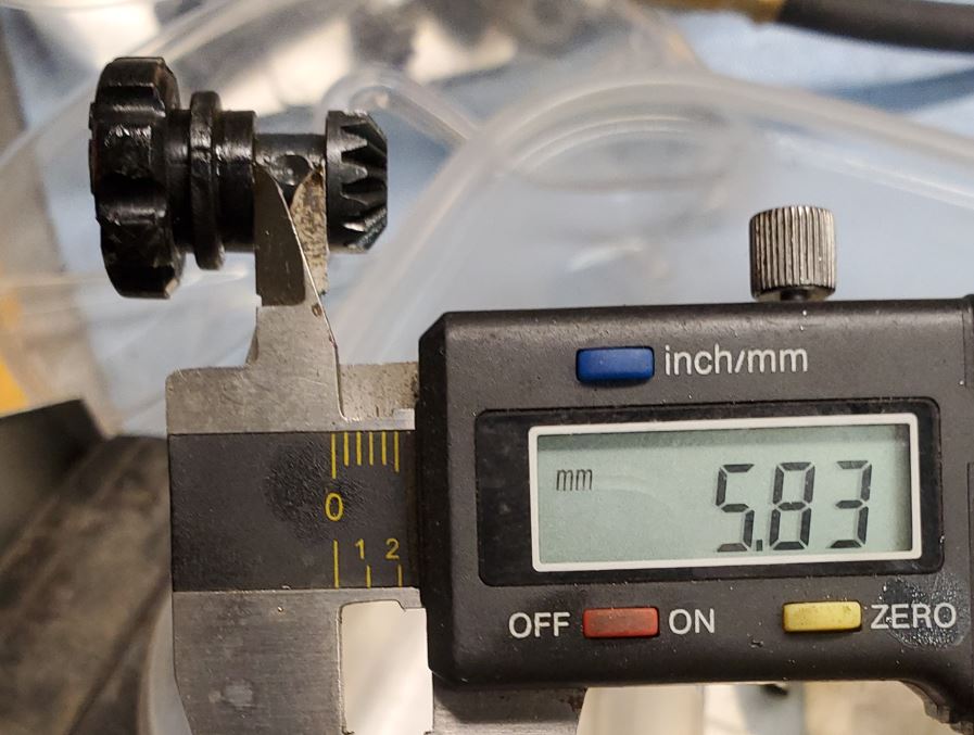

I wonder if the detent setup in the shock is equivalent to something like this that I found on McMaster Carr's website? There are a lot more options including threaded versions on their website so maybe we can get one of them to work.... :hmm:
Re: 87 KDX Rear Shock Lower Clicker Bind?
Posted: 05:56 am Jul 08 2025
by pkenney
I was already heading down that road with my own shock problems so you didn't steer me wrong.
The Mcmaster parts are very similar but this cup-spring has around a 5.6mm dia with a 5.8mm step at the top.
Overall length is 10.6mm but the step at the top is about 2-3mm.
You will need to drill it out to remove it but it might be able to be reused if you don't drill too big - I'd say the spring is ~4mm dia.
I assumed it was a thin plug like you'd see in a carb so was not careful and ruined mine but I think the top step is the only part that is pressed in.
A small thru-hole probably won't prevent it from being reused since there should not be pressure up there just stay well below 4mm.
I think it only holds the knob in and provides the clicks so the hole could probably be RTV'd.

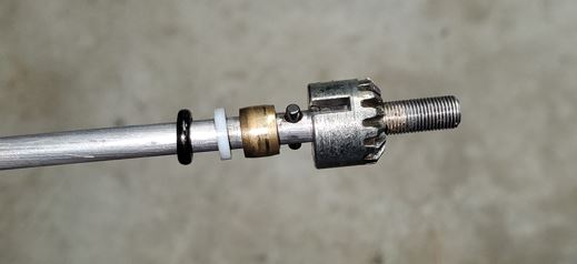

Not sure if you've torn into your clevis yet but here is a photo of the cup spring and rebound clicker gear.
spring cup.JPG (48.43 KiB) Viewed 52670 times
rebound clicker.jpg (78.47 KiB) Viewed 52670 times
Posted: 07:47 pm Jul 15 2025
by pkenney
In case you want to see the rebound shaft o-ring.
I had oil on top of my shock and the gears were wet so I am replacing this o-ring.
The o-ring didn't seem too bad but since it's apart I'm replacing it.
rebound gear and seal.JPG (13.7 KiB) Viewed 49766 times

I wanted to correct some info on the upper clevis disassembly to help anyone who may need to take this apart.
My shock leaked oil again from the upper clevis under the rebound adjuster.
It wasn't the o-ring, the rebound adjusting needle had a groove in it that I didn't notice.
I disassembled it again and found the disassembly easier since I knew how it all fit together.
You don't need to mess with the spring loaded ball detent unless you want to get the knob out of the clevis.
To disassemble the upper clevis:
Loosen the rebound adjuster all the way - this makes the bevel gears tight against eachother since the needle is fully raised
Hold the clevis with a large wrench or stick it in a vise and loosen the lock nut - don't try to turn the clevis off the shaft, just loosen the nut.
Once the locknut is loose you should be able to easily spin the clevis off the shaft - the rebound needle will come with it.
If you want to get the rebound needle out of the clevis you can tighten the rebound adjuster all the way until the gear teeth disengage.
Once the needle stops spinning with the gear it can just be spun out of the threads in the clevis.
To reassemble, get the needle back in and once it mates with the slot in the gear, turn the adjuster fully out.
Put the needle into the shock shaft and spin the clevis back onto the shaft until it bottoms out.
The end of the shock shaft sets the engagement depth of the bevel gears so if it is too tight the gears will not rotate and too loose it won't move smoothly.
Lightly bottom the shaft out and hold the clevis in position on the shaft while you lock it in place with the locknut.
Once the locknut is tight, make sure the adjuster turns freely.
There was no locktite on mine so I did not use any when reassembling.
BTW, to get to the o-ring, I used an easy-out to pull the brass bushing out of the shaft end.
It boogers up the brass a little but I think it can be reused since it just holds the o-ring in place.
This may have been why my needle had the groove in it though so make sure the ID is smooth.
The replacement o-ring is a 3/16 X 5/16 o-ring.
Good Luck!
