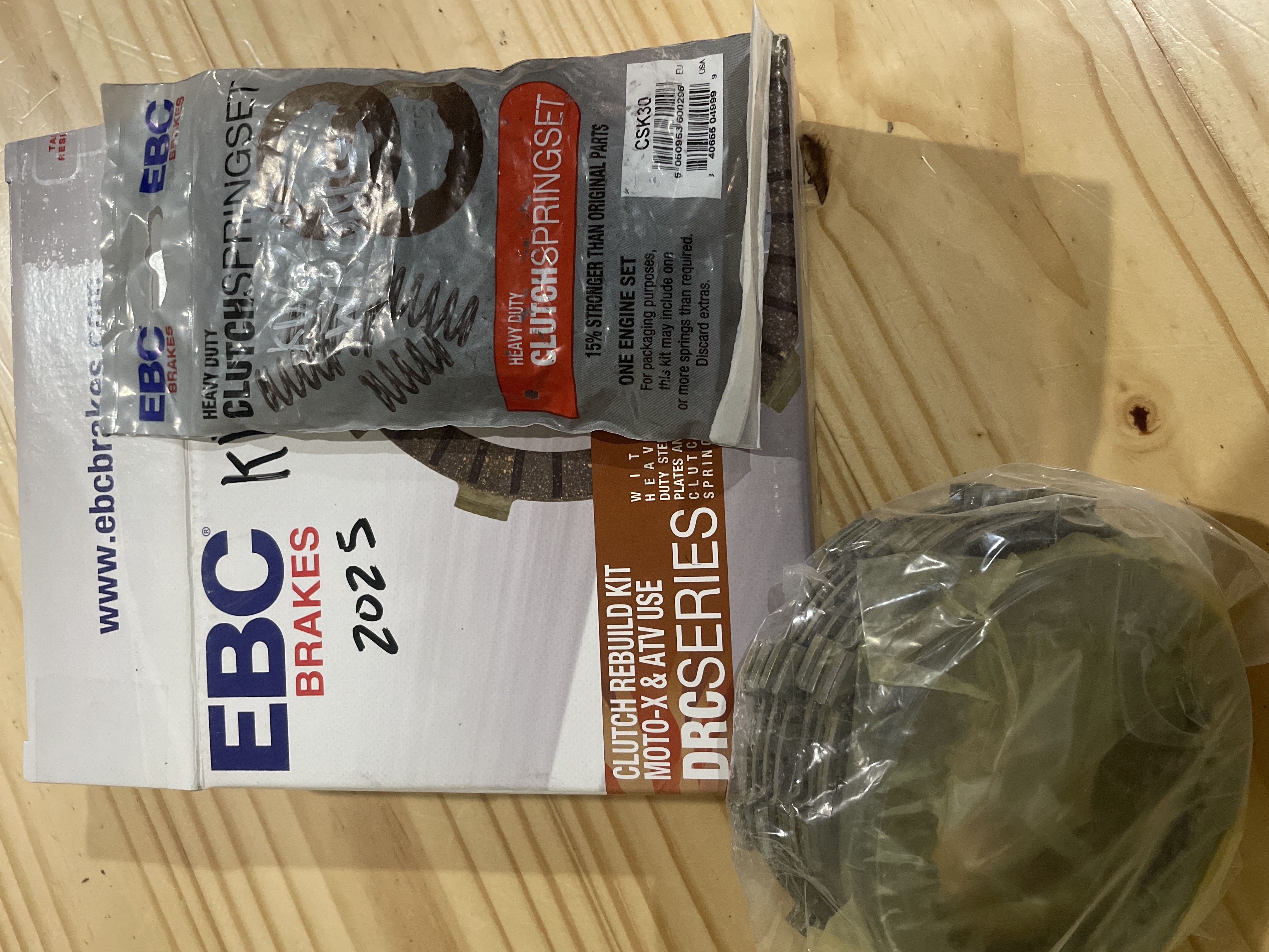

Is there something you all would suggest as an alternative to oem springs that have the same performance? Like prox or something idk?
I’ve been reading and discovered that the springs I got with the ebc kit are probably not correct(csk30). I wasn’t sure about going with hd springs anyways, I’ve never thought it was necessary. The 96 springs I’ve read are weaker to start with and are likely now not what they used to be. Oem 97+ seem to be what’s recommended. I’m happy to pay the price, but they have to be ordered individually at $15 ish a piece with shipping.
92144-1522 is the part number I think I want,I would be grateful for confirmation!
My clutch does pretty good overall but from experiencing a few clutches die on other bikes, I would say the engagement isn’t as solid as new. It seems like it takes just a moment to hook up at higher rpm and maybe a bit “vague?”. Still rideable, I had The chance to get the kit pretty cheap and have had good results from EBC products so I purchased it before I did any research. If true, it’s crazy that the spring issue still persists.
- image.jpg (3.11 MiB) Viewed 1489 times

That number you have is the part # for one of the judder springs. You want part #92144-1160 for the 1997 and up spring coil spring. RMATV has them for $7.40 each and shows they have plenty in stock.

Thanks a bunch, close one.SS109 wrote: 05:27 pm May 27 2025 That number you have is the part # for one of the judder springs. You want part #92144-1160 for the 1997 and up spring coil spring. RMATV has them for $7.40 each and shows they have plenty in stock.

I ended up getting them on eBay. I cancelled my big order of jutter springs and got the correct ones coming haha
