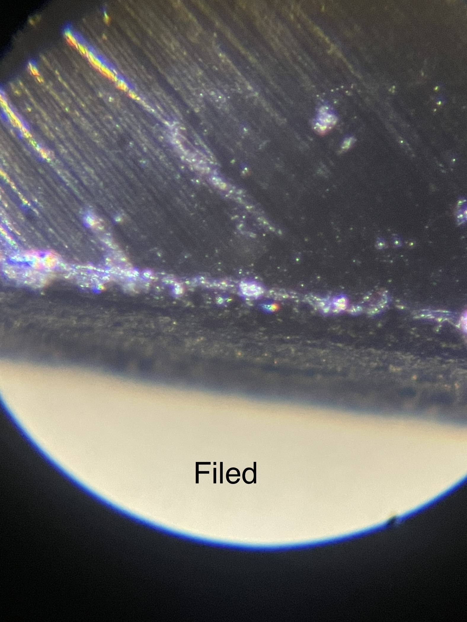

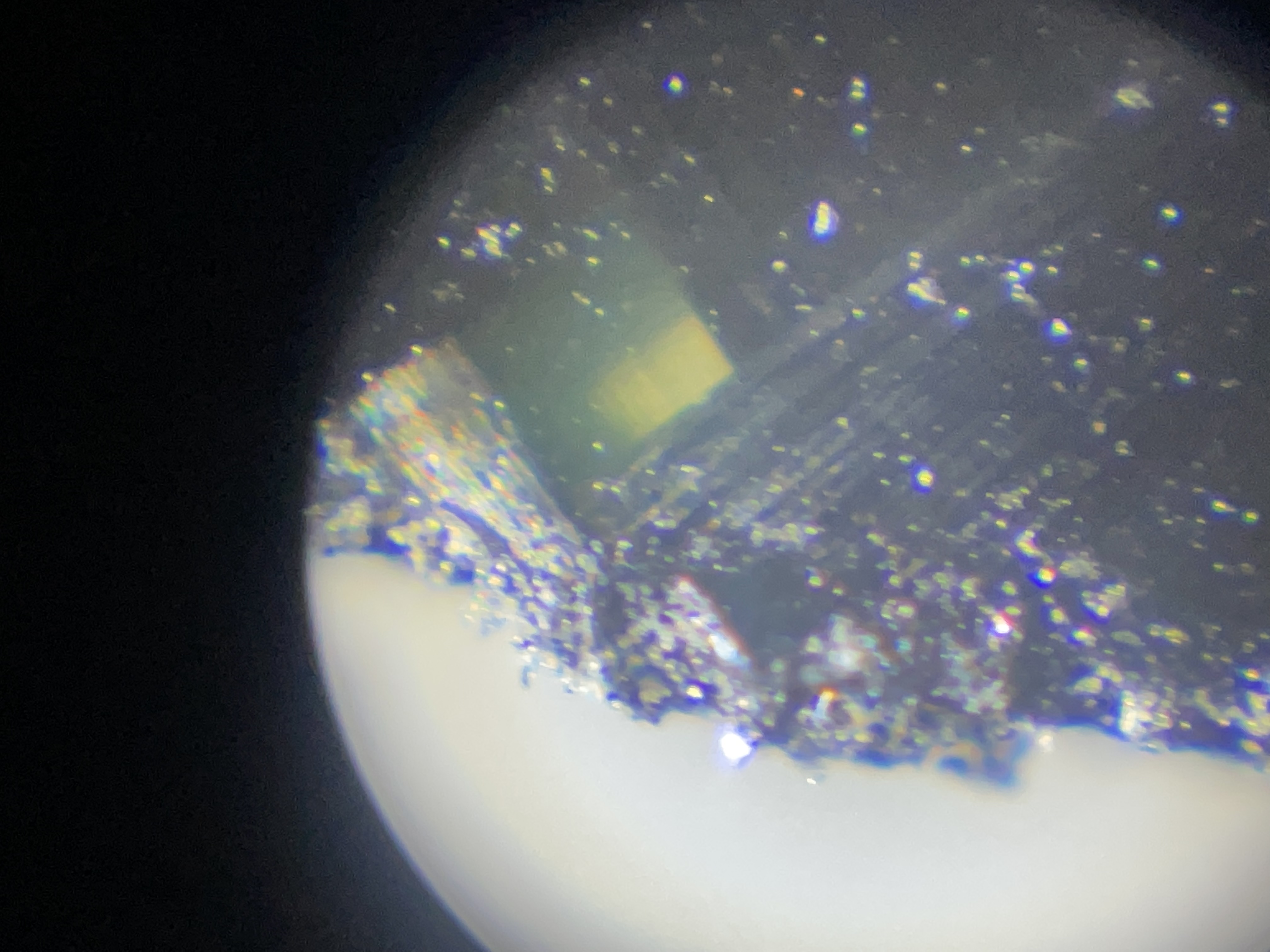

I had the idea to lightly sand the edges of my new reed petals because they were a little rough.I decided to google after and Ive only found one random scooter forum where they talked about doing this.
Has anyone else considered or done it? I just went over them with a fine diamond nail file. I figure it might help a little with the edges breaking down or with too small to notice pieces coming off when they break in.
If someone has a suggestion as to how often I should check on them I’d love to hear it too. I’ve read 20hr to once every year or two.
Petal with white dot has been filed.
I felt very OCD until I looked at them under magnification. Now you can think I’m OCD.

Looks good!
