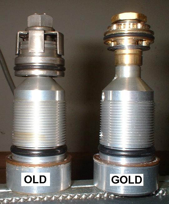

Here's a pic I took in 2006. Maybe they changed items since back then?
There is no rebound side. The top is a check plate and spring. The rebound piston and valving is on the end of the rod (the 10 mm rod).
oldgold - Copy.jpg (50.37 KiB) Viewed 18333 times

I recently installed them per racetechs instructions and they looked just like KDXGarage's photo above

brademan76, did yours have the brass colored spacer on the bottom like mine? Thanks

Yes it did. It also came with the black one KingDaddy has pictured, but that is for a different type of cartridge/fork I believe. Instructions should clarify that.

Thanks for the info. The real old ones did not have a black piece. I was wondering if that was how they were now or what.

Brademan76 mine did not come with the brass bottom spacer as seen above. The black piece is if you were to use a regular nut. I think rt instructions call it a spring washer. I just used it as a bottom spacer because it had the bevel I wanted and it was over twice the height of the baseplate, then I finished lengthening the stack with leftover washers in descending order as to give the valve stack as much room as possible. Probably doesn’t matter at all, but i figured it would be easier to keep up with the extras if they are in the fork haha. I have reasoning to everything I did, however it may be faulty logic!

I purchased my kit last year around this time. From western power sports or parts unlimited directly and I got no fancy spacer, the guy in the you tube video didn’t have one either I guess. It would be the very obvious solution to my dilemma if I had seen it in my kit. Rave tech does say shims can be used as a base in both the instructions for the shock and forks, that was a red flag to me that many other people could have easily overlooked the issue.

Do you have a spring for the check plate? I can not see from the picture.
