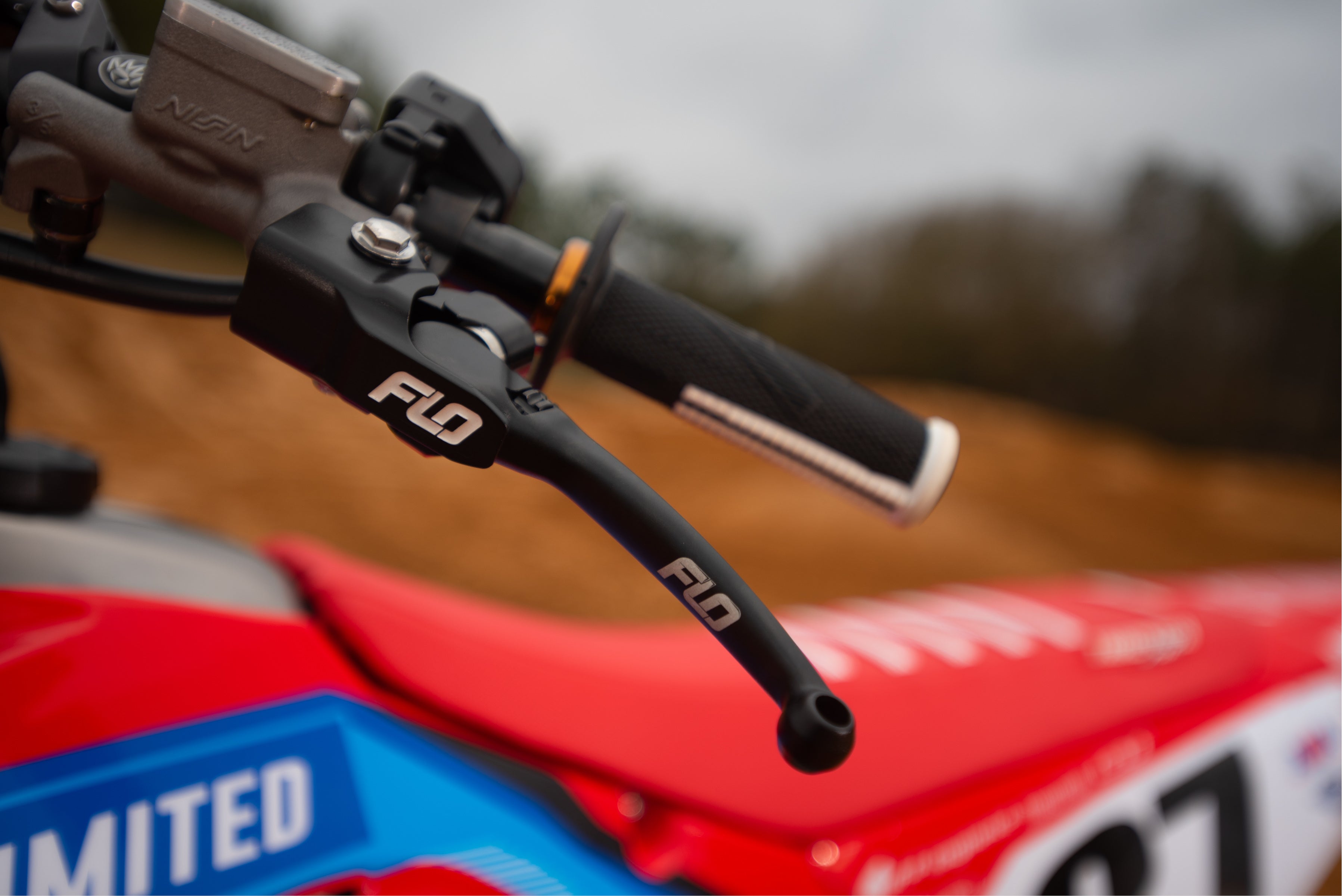

I picked up a used Flo Tri-Pivot clutch lever that someone was running on a Suzuki RM or a Yamaha YZ, and black, and then I picked up a used later model KX Flo Tri-Pivot brake lever in black and did a pretty basic modification to convert it to the earlier style that fits the KDX.
The Flo Tri-Pivot levers fold forward in a crash as well as swiveling up and down in a crash, even more protection against breaking. I don't think you would ever break one... Every once in awhile in a hectic hairy situation, when I make an awkward difficult panic grab to the clutch or break, the lever does occasionally pivot downward, but despite my fears, this is never prevented me from grabbing a handful of clutch or brake.
The adjustable reach on the clutch lever with a quick turn thumb screw dial has been a very excellent tool for helping me get a little bit better at clutch control in hard enduro/technical terrain type situations, with dialing in the clutch so that I have to have it pulled almost all the way back to the lever to be completely disengaged, which makes it a lot closer reach for average hand size so that it's not a mile away when you're trying to hang on to the handlebars for dear life...
That was an incredible tool to just be able to dial it back on the fly without getting out tools to move the set screw and lock nut on typical stock levers.
