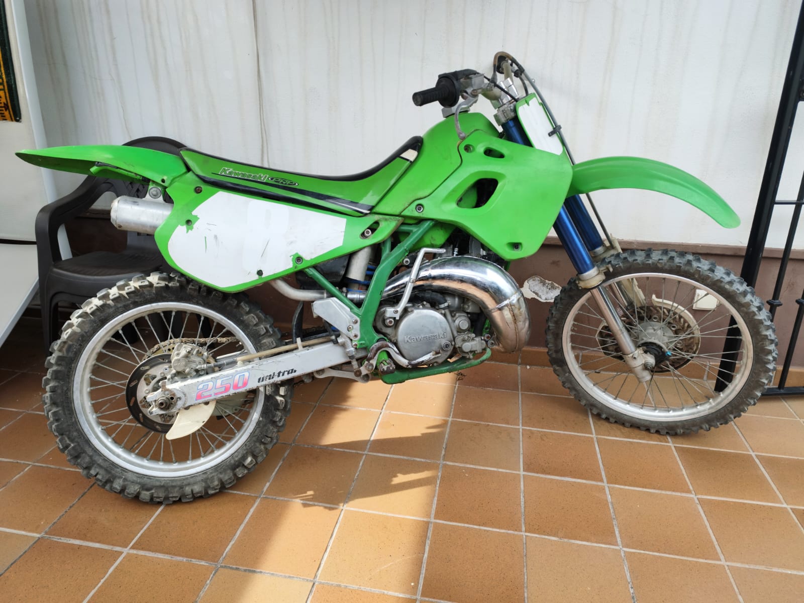

Hello everyone, as I mentioned in the introduction, I'm new to the forum and have purchased a KDX 250 with the goal of returning it to its original physical condition, restoring the engine, and documenting it. This is quite a challenge since this motorcycle lacks spare parts, and even more so where I live in Spain.
The current condition is acceptable as it retains many of its original key parts. The engine starts well, although it will also be rebuilt. I'm not sure if the silver exhaust body was original or from another motorcycle. I'm also having trouble identifying it. This KDX has a 12-digit chassis number, not a VIN. When I enter the characters in the Kawasaki spare parts section, it doesn't recognize it. I think it's from 1992, since the identification number indicates it was distributed in 1992.

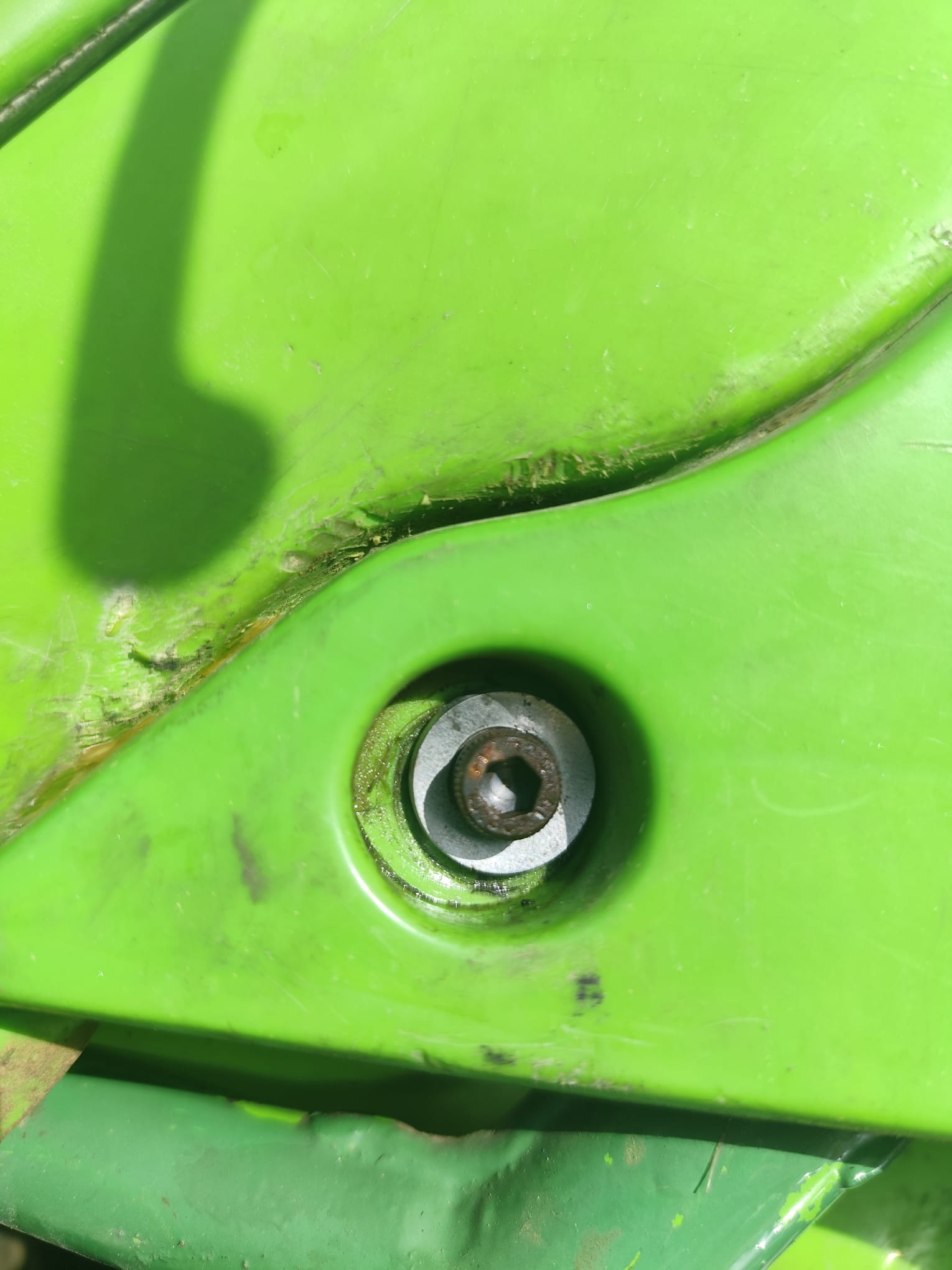

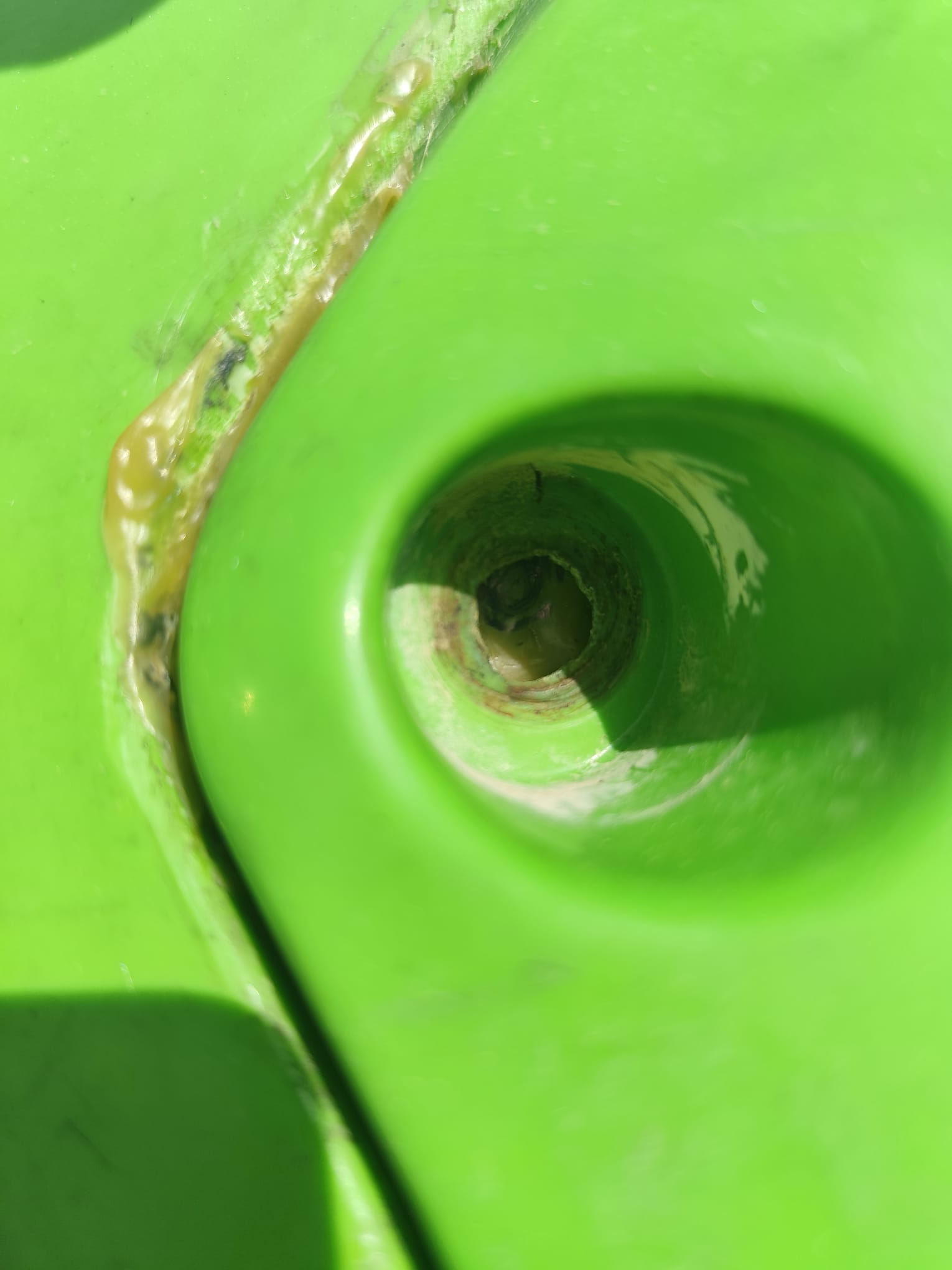

I've only had it for three days, and I've already encountered several issues, including the fuel tank. It's been repaired, and it appears to be leaking from one of the side plate bolts. Finding a tank in good condition is a challenge. I found one on eBay for a fortune. Anyway, one of the main tasks is to figure out if I can repair the tank and be able to sand and polish it and see what options it has.

from the 1992 - 1994 Kawasaki Model Recognition Manual as used by dealers:
1992 KDX250-D2
1992 KDX250-D2.png (200.44 KiB) Viewed 2016 times
DC Plastics or OEM are the only choices I know of for various plastic.
The exhaust pipe and spark arrestor are not stock, but aftermarket. They may be designed for the KDX250.
Someone painted the frame GAUDY GREEN, as I am sure the can label stated. :grin:
