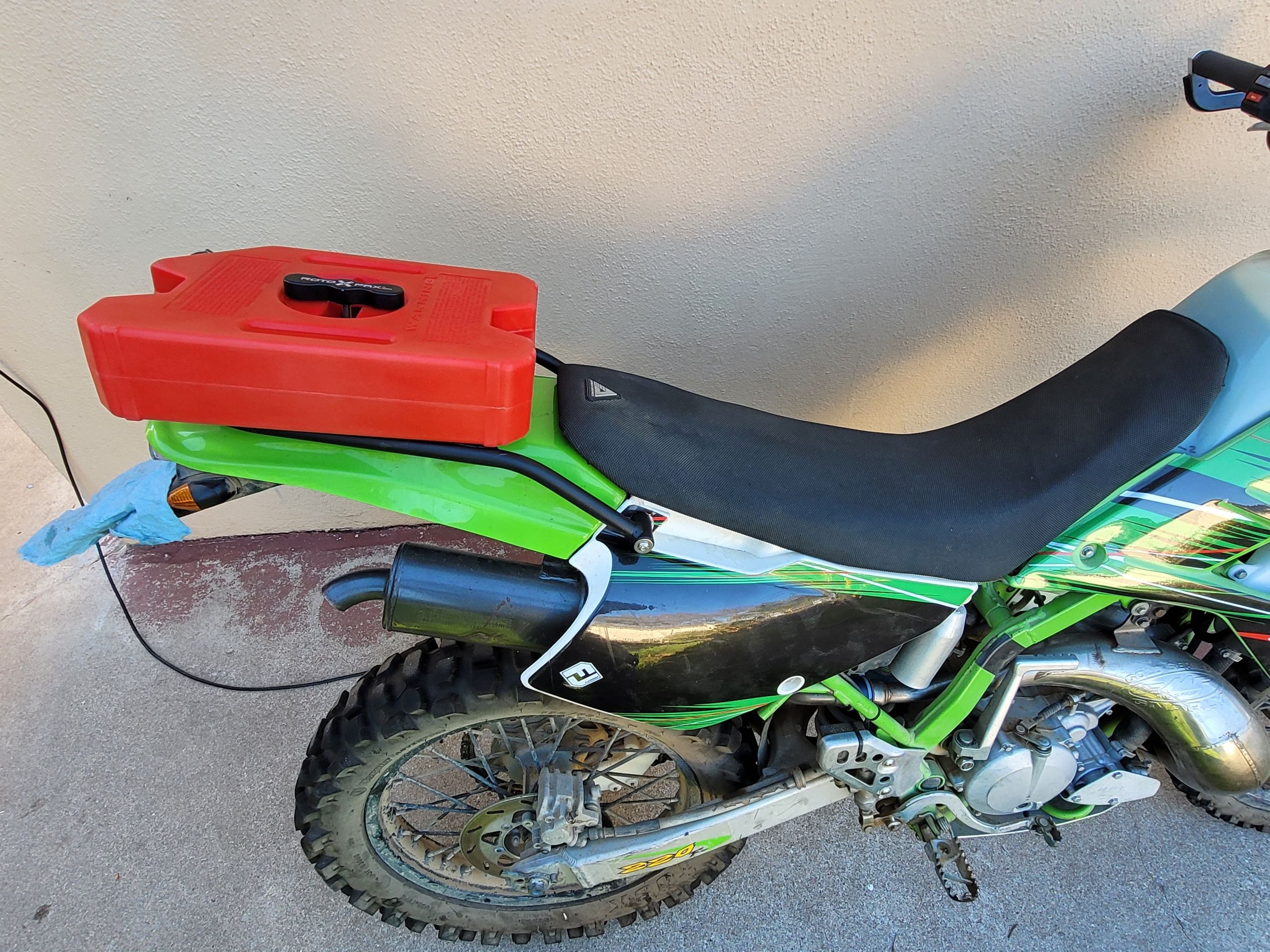

here's how I carry an extra gallon of fuel (photo). In theory, it's possible to stack two of these cans on top of each other.
I have the Clarke tank. It's capacity is 3.6 gallons.
I ride county roads to trail heads. The average speed for this is 35 mph. It is also necessary to drive about 5 miles on a mountain highway to access one of my trail heads. The speed for this ranges from 55 to 60 mph. It's amusing to ride a dirt bike at highway speeds on wide asphalt highway.

I may have to do that. I haven't had a good look but is the subframe fairly sturdy? Wouldn't wanna break anythingbillie_morini wrote: 02:02 am Mar 19 2025 assquatch,

Also what year is your kdx? The fender looks different to mine I think

Yes, there is sturdy subframe. Will share additional photos on Friday so you can see rack bolt-up with subframe
My KDX 220 is a 1999. The teenager that I bought it from about 4 years ago replaced the original plastic body work with parts for a newer Kawasaki. I don't know what model's parts he selected, but updated the appearance. The teen also gave me all the original plastic body work. While the original body parts are thicker, they are beaten up and are not as stylish as the new plastic.

Billie, that appears to be a Maier KDX-MX fender based on how exacting it fits against the KDX side plates with the correct angle. The KX rear fenders don't quite mate up like that I don't believe, I'd tried fitting one before, and it required extensive modifications and still wasn't a great fit.

I'm wondering if it would interfere with my tail light or fender but I may have to try one. Where can I find them?

assquatch, you mean where to get rack? This is the one I bought and use. It's on the Amazon website.
PMRACKS SF Rear Rack
