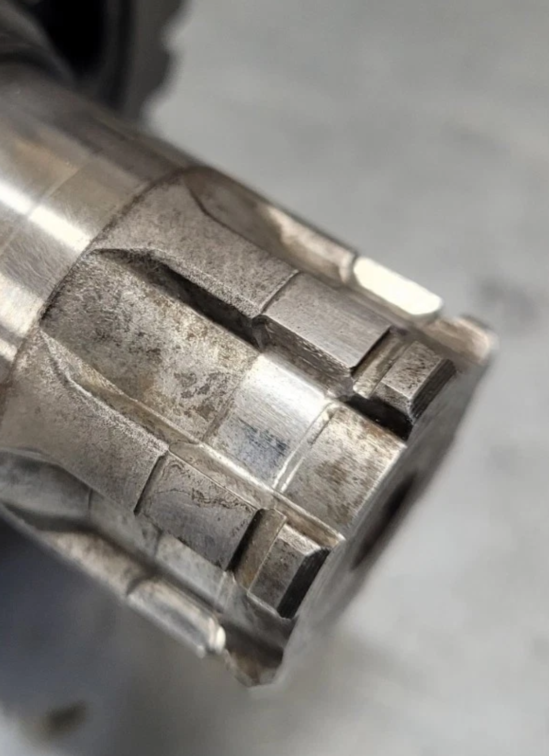

It's useable but less than perfect, but something like this pictured is about the best one can expect from most random eBay countershafts (1 of my 3 is far worse than this):

Silicon bronze is very soft and wouldn't last 2 minutes, just throwing ideas out there, there's a lot of Pakistani YouTube videos than show spline and gear repair, maybe check from the video what kind of rod they are using, even though our parts are very small compared to what they do you could take the stick rod,remove the flux and use it as a Tig filler rod, I would also add in pre and post heat, I work for a hydraulic company, the cylinders and shafts are made of 4140, when welding we preheat to 200 degrees Celsius then wrap in a fire blanket for slow cooling, they are then machined and sent for nitriding,
I've done quite a few Kickstarter repairs and I use Allen keys as filler material for the repair, incredibly hard if Tig welded quickly due to the quench effect
Another option would be to weld with regular Tig filler wire then DIY case hardening which is quite easy with a forge
But having said all this to rebuild your engine and install the repaired shaft and it may or may not work is a big headache
I've used the kx500 sprocket with great success , I would be inclined to go this direction
Have you tried the loctite 660 fix ? I've tried it on 2 of my kdx's , 1 worked well, the other one didn't but maybe I didn't clean it well enough, I'm in Australia now so will try the loctite fix on my kdx here as the shaft is slightly worn, I think the trick to the loctite fix besides being clean is when installing the sprocket, hold it in the turned direction of travel, that way it's hard up against the splines
