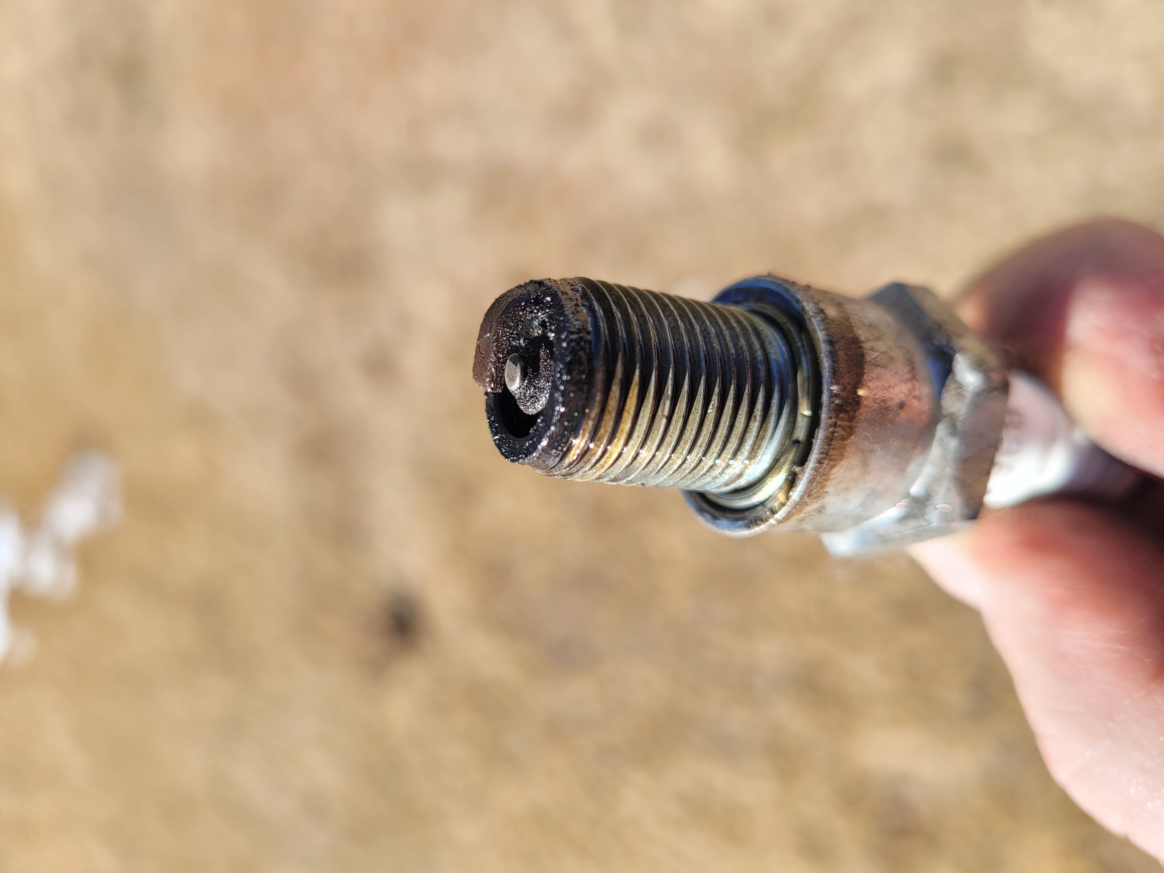

by billie_morini
Here's mine pulled from my KDX 220 after several hundred miles. The majority of my riding is 2nd gear & moderate RPM in very steep mountains.

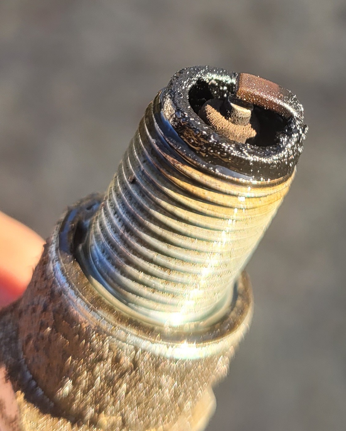

by brademan76
Not an H model... '93 200E. Wife's bike, pretty wet and gunky. She doesn't get it up into the higher RPMs much. I'll pull my 220 plug tomorrow.

Posted: 10:45 pm Feb 24 2025
What plug is that? What heat range?

KDX-G,
if you are asking me: "What plug is that? What heat range?"
Then my answers are BR8EG and 8.

Posted: 02:20 am Feb 25 2025
Nah, bradememan's

by brademan76
KDXGarage wrote: 10:45 pm Feb 24 2025 What plug is that? What heat range?
NGK B9ES heat range 9

Posted: 06:14 pm Feb 25 2025
Switch to an 8, please. That, or go tell her she is going to have to wring it out a lot and then tell her "DO WHAT I SAY". OR....switch to an 8. Either way. :mrgreen:

by brademan76
Will do both! My 220 plug below. It's a BR7S. A little better.

Posted: 08:50 pm Feb 25 2025
What is all that crust on those plugs??

by brademan76
The 220 plug had decent amount of spooge leaking out around it as it was a little loose. Couple that with a chalky desert dirt ride a few weeks ago and no wash since.
