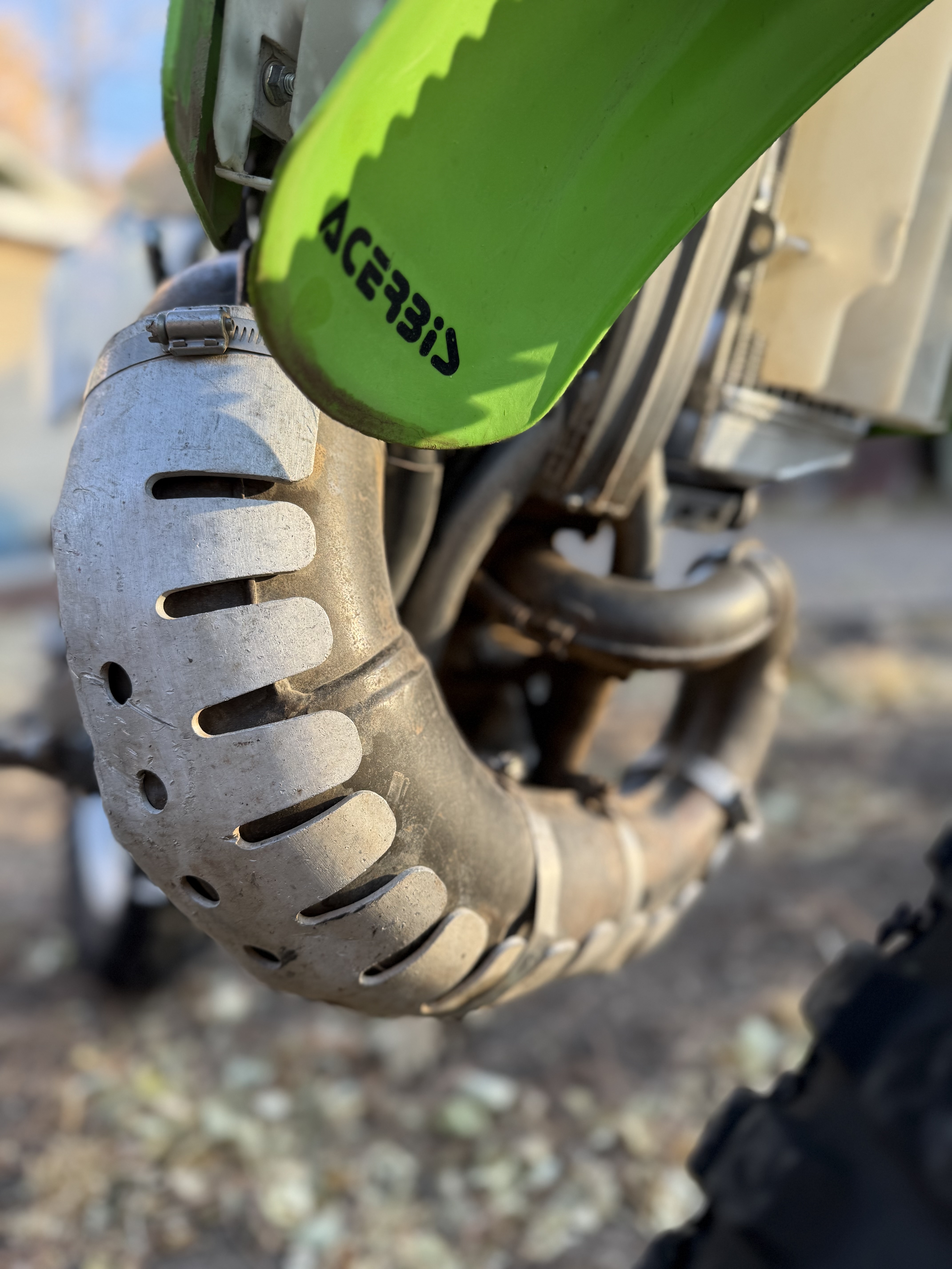

Good looking bike for the $1400 you have into it, you are missing the rubber coupler between the pipe and muffler part # 92093-1328. You can buy some self-fusing silicone tape for a temporary repair, just clean the area very well before wrapping it.
Are you using tranny oil, fouling plugs? I would try a couple things before thinking about pulling it apart, first thing I always do is a leak down test, simple and cheap to make up and will tell you if the motor is leaking especially at the seal, if this checks out ok and you are continuing to run rich with jetting changes maybe check into the jet block gasket if you are having jetting problems, if jetting make sure to only use genuine Keihin jets, what does the overall condition of the carb look like, possibly worn out?
I would be tempted to pull the pipe also and check if it has a lot of oil build up in it, clean it out with some solvent, the stock pipe is a double walled pipe but can't remember if it had any sound deadener in it also??
Just curious what mixture and oil you are running, if a high flashpoint oil and just slow trail riding this can sometimes create a lot of spooge/mess.

Thanks for the reply. I looked up the rubber coupler , 40 bucks. Think I could just use some radiator hose or high temp silicone hose there with some hose clamps? As far as using tranny oil, I’m not sure yet it wasn’t showing in the window and seems a little more Smokey than usual so I added some more oil until it was at the top line of the window. I need to ride it some more to see if it goes down. For my premix ratio I am using maxima super m at 1:40 (what the mechanic who looked it over told me run). Jetting and carb conditioner is unknown as I haven’t taken it apart to see. It seems to run fine fueling wise. I took the pipe off to clean, didn’t seem too bad. Silencer has some spooge in it. I believe it may be aftermarket as it says pro circuit spark arrestor on it. I of course broke one of the o ring on the exhaust so I’ve got a new set on order. I’ll try to get a video of it running. I have been going pretty easy trial rides with it as I ride with my gf on her KLX 140 and we’re pretty new. I got a quote for about 1500-2k ballpark to have the engine completely rebuilt if needed. It hasn’t been fouling spark plugs and by the look of it not for a long time as the spark plug looks just as old as the head and everything else. Ive got new plugs, but I couldn’t get it off with a spark plug wrench from Amazon, so I probably need to remove the tank. It’s a bit tight with the cooling thing next to it.

Get an exhaust coupler for a YZ250. They're made of silicone so have high heat resistance, and are cheap. Rubber hose there will melt.

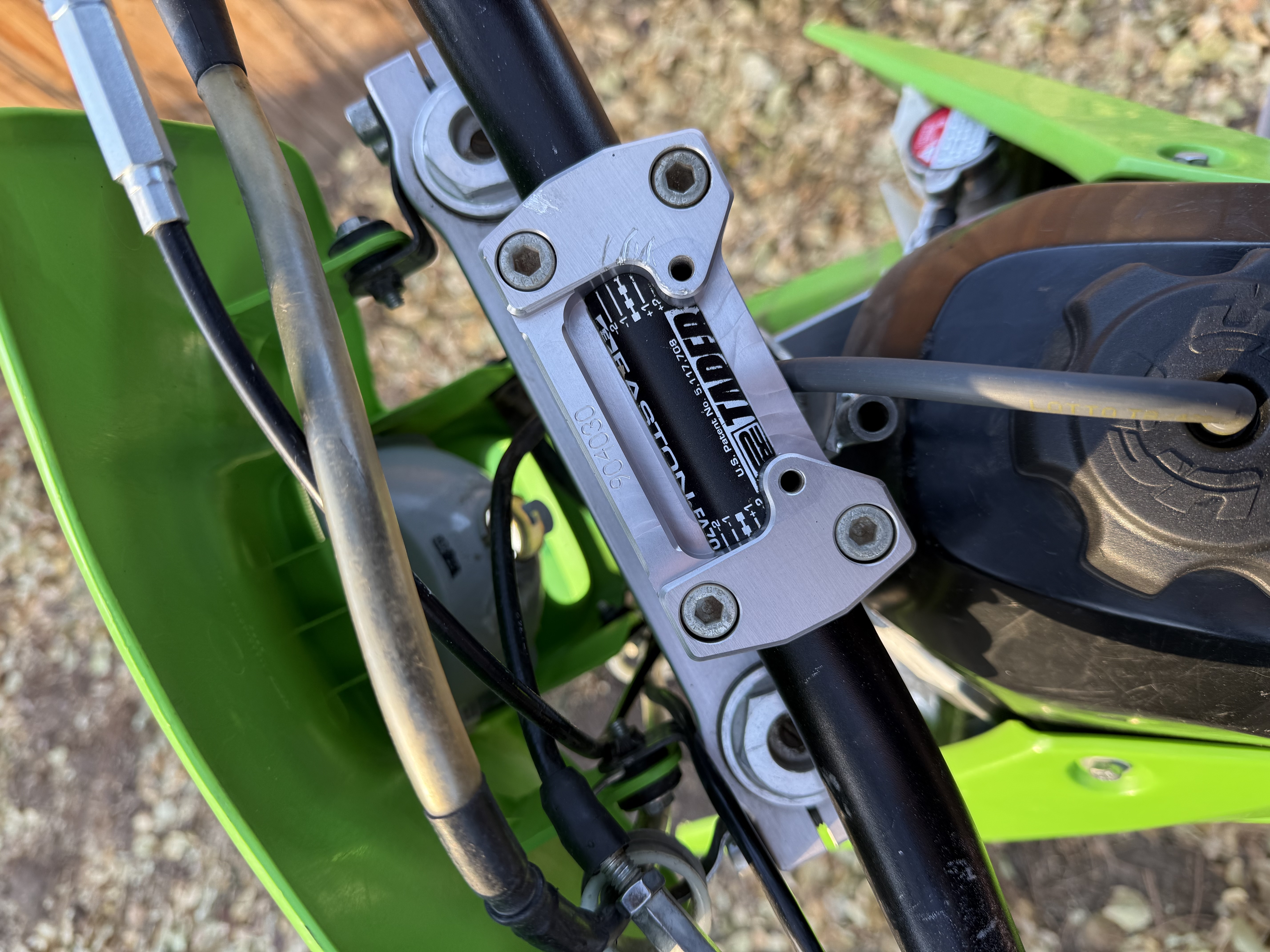

Also, get a bar pad before you really hurt yourself.
