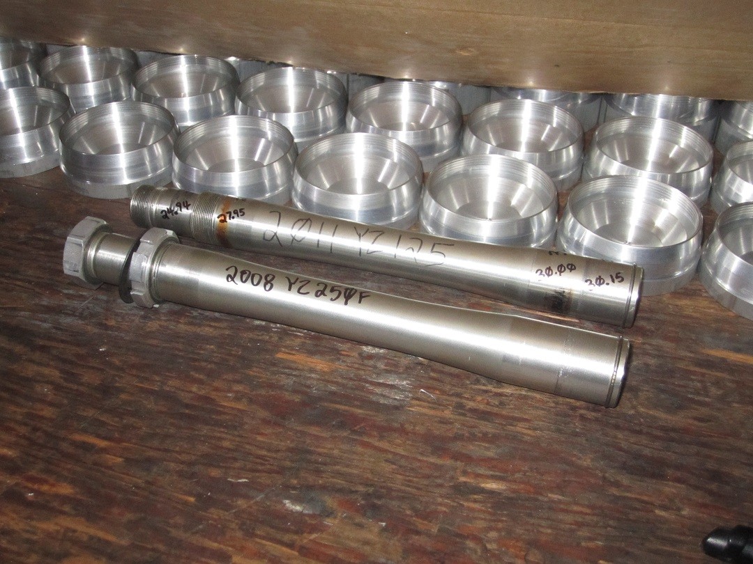

cwtoyota on VitalMX.com @ 4/2024 wrote: I have my pal's 2008 YZ125 here to change her fork and shock seals and I have my *2011 YZ125, both are assembled.
Measuring from the bottom of the lower clamp to the top of the stem with a stainless ruler I see 268mm on those bikes.
I have two stems in the drawer, one that I labeled with a sharpie as the original stem from my 2011 YZ125 and the other is from a set of 2008 YZ250F clamps that I put on my '19 YZ250.... Those stems measure about 267.5mm from end to end.
*Currently I have 2008 YZ250F clamps on my 2019 YZ250 and 2011 YZ125.
The 250F Aluminum frame stem is the compatible with the YZ125 aluminum frame.
The YZ250 two strokes from at least 2002 up use a longer stem.
Without disassembling my 250, I measured 275mm from the bottom of the lower clamp to the top of the stem.
Hopefully that helps. Here's a photo with some stem diameters for the 2011 YZ125 stem. The 250, 250F and 450F stems share these diameters back to at least 2002 model YZ250s and at least back to 2005 model YZ125. I bet the diameters have stayed the same since models farther back than those years, but I can't confirm it.

So from what I'm gathering above, with the conversion bearings now recently available in the last couple of years, both the long Yamaha stem found on the YZ250 2-stroke and some of the other models of 450, and probably Honda CRF250X/250R forks, the steering stems can be a direct fit now... No stem swap or knurling needed if you get the right triple clamps.
It sounds like there is a 10 mm difference between the shortest and longest of the three Yamaha stem sizes I believe (YZ125 & -'09 WR250F/-'11 or -'12 YZ250F etc)? And 10 mm difference between the YZ 125 short Yamaha stem and the CRF250. So if the YZ250 2-stroke steering stem chopperpilot has fits the KDX frame well, then we have a new standard for KYB fork swaps. I'll check a few Suzuki steering stems in the next few days for the press fit diameter, but those might also work out nicely to fit a Yamaha stem in as well, with a press fit and no knurling or bushings required! The Showa forks certainly are very nice. The 06+ KX250F & KX450 & X models used show up most years, with some years KYB I believe the early 450s and 2019 through 2023 KX250F/X.
The Hondas use Showa pretty consistently since the KYB equipped CR125 halted production, and only '96 CR250 used KYB. The CRF250 has used Showa nearly the whole time, but I believe a lot of the CRF450 models were KYB still, same as some of the KX450 years, while all but 2004-2005 and 2019-2024 KX250F were Showa, back to Showa for 2025 on the KX250X as well same as the 2019-2023/'24+ KX450/KX450X has been Showa the whole run. Interesting Honda and Kawasaki keep fairly equal business relations with BOTH Showa AND KYB at nearly all times... Showa seems to be on top again, as they were the original innovators in my eyes with the Twin Chamber forks a decade before the KYB AOS aka "Yamaha S.S.S." came out, and the 50mm shocks being standard far before KYB made the jump in size.
