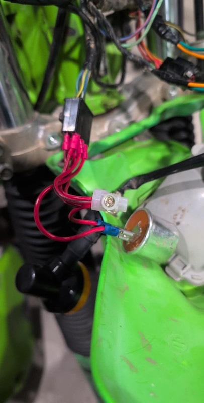

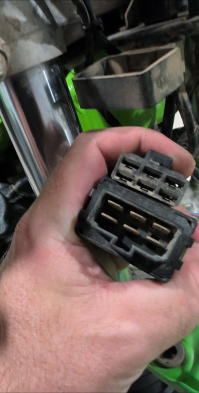

Have most things working and she is in great shape. I am working on the electrical to get it road registered and everything is working except the indicators not flashing. I found this flasher unit (i believe) in the head electrical rack but i cannot find replacements or this item anywhere online.
It appears that 5 of the cables are the ground wires for each of the indicators and the indicator light on the dash (5) and then the 6th cable in earth.
I created a DIY harness to convert to 2 pin filament flasher and it works 100% when i inject 12v from a battery but then when i start the bike using the stator the headlight and tailight flash like the indicators... seems to slow/stop when rev'd but then it comes back.
Anyone have ideas on this and if maybe there is a better replacement for this unit or conversion? :partyman:

Pretty ingenious fix, too bad it didn't work and I'm not sure why. This might help:
http://garakutahatkara.web.fc2.com/kdxwink/kdxwink.html
And this:
https://drops662.hatenablog.com/entry/2020/07/03/204731
This is the Kawasaki part number: 27002-1066
I found a new one at CMSNL:
https://www.cmsnl.com/products/relay-as ... 270021066/
I found this used one for sale in Russia:
https://www.farpost.ru/vladivostok/auto ... 88038.html
This might be one too, not sure though:
https://buyee.jp/item/yahoo/auction/j1150186373
This is "turn signal relay" in Japanese ターンシグナルリレー , you can search for that on Buyee.com to find more possibilities
Good luck!
