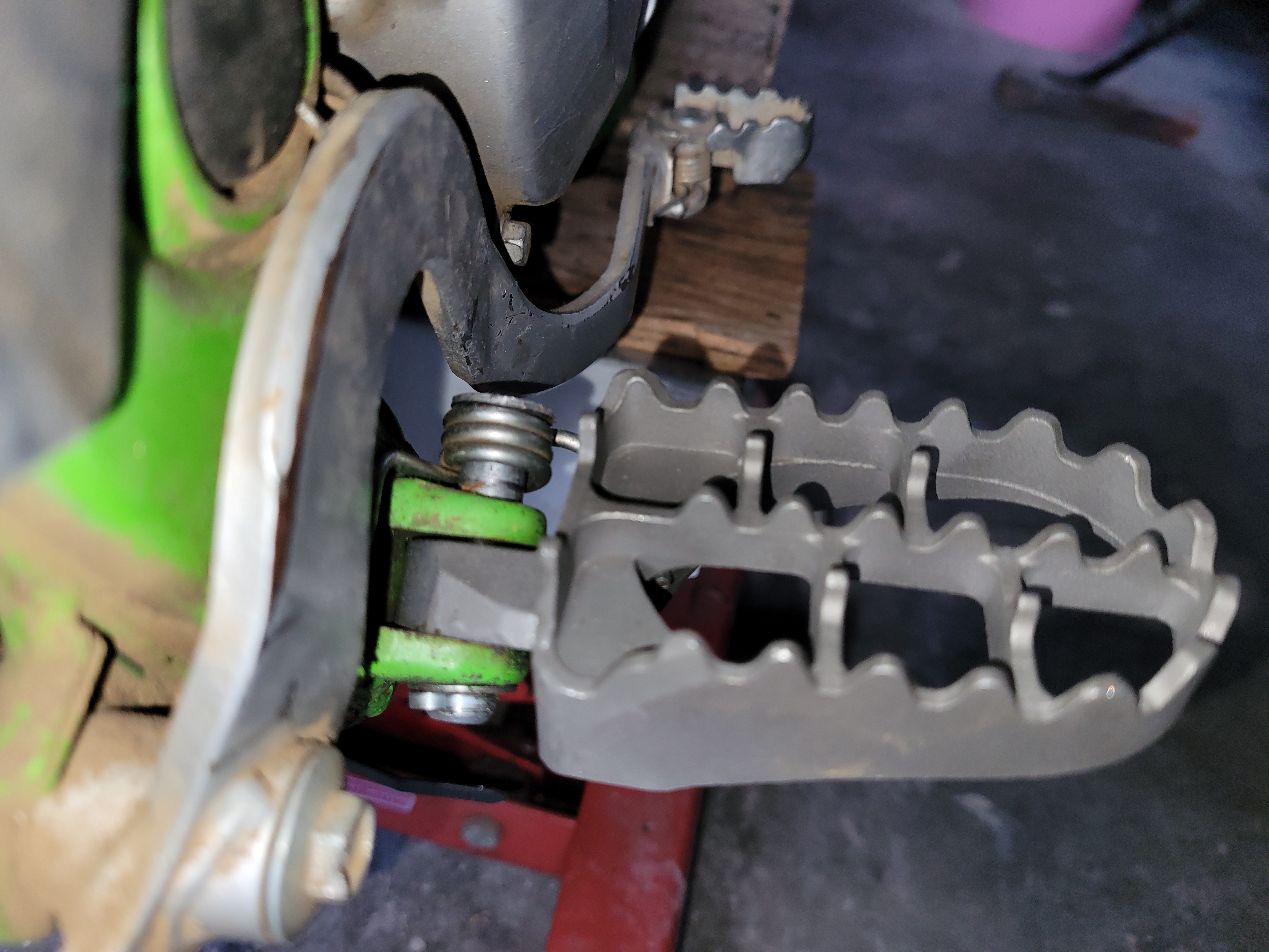

Re: IMS Super Stock Foot Pegs (Only Me?)
Here is the OEM foot peg installed without the spring during fit-up activity with aftermarket IMS peg. Note the peg angle / orientation.

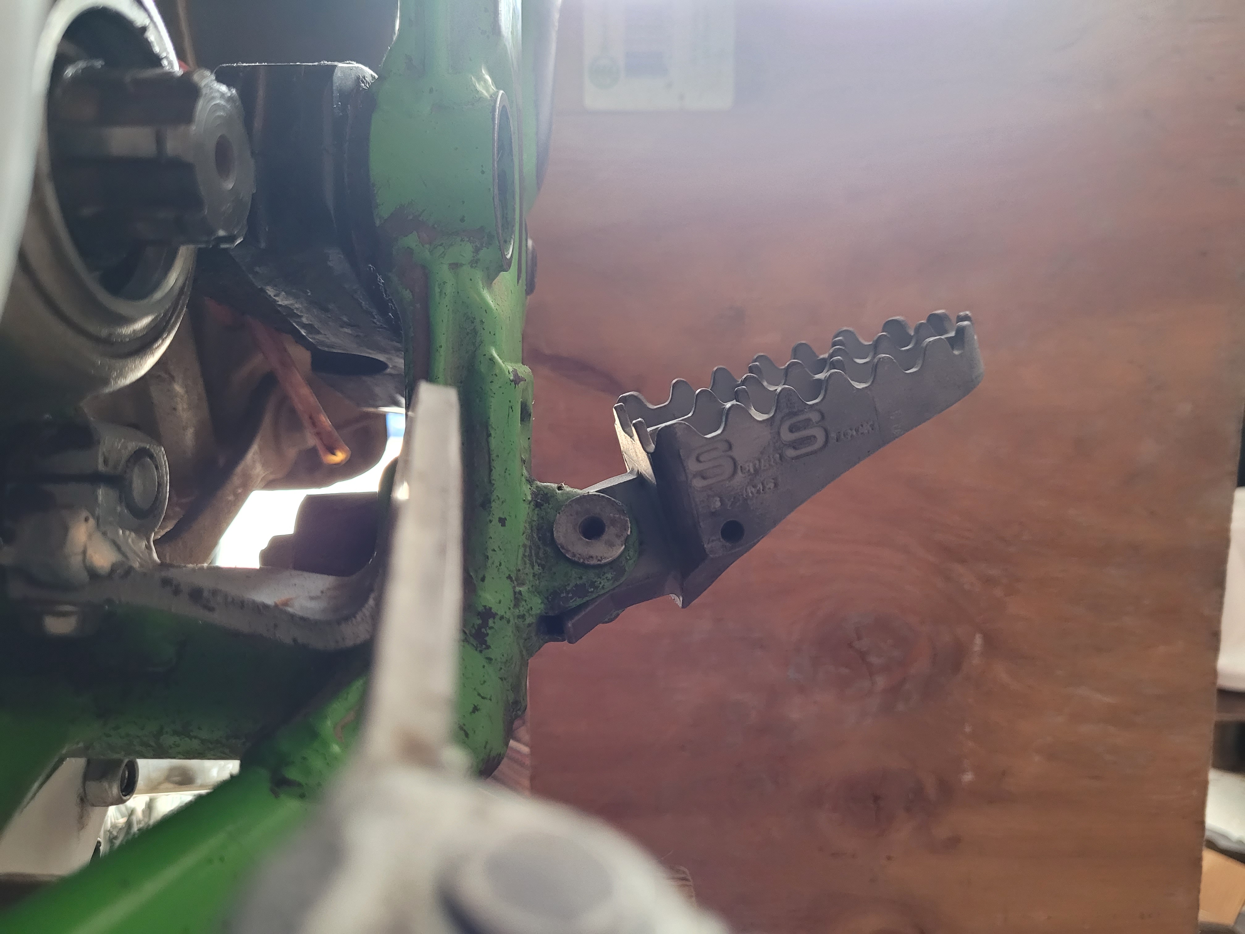

Here is the IMS aftermarket foot peg installed without the spring during fit-up. Note the peg angle / orientation.

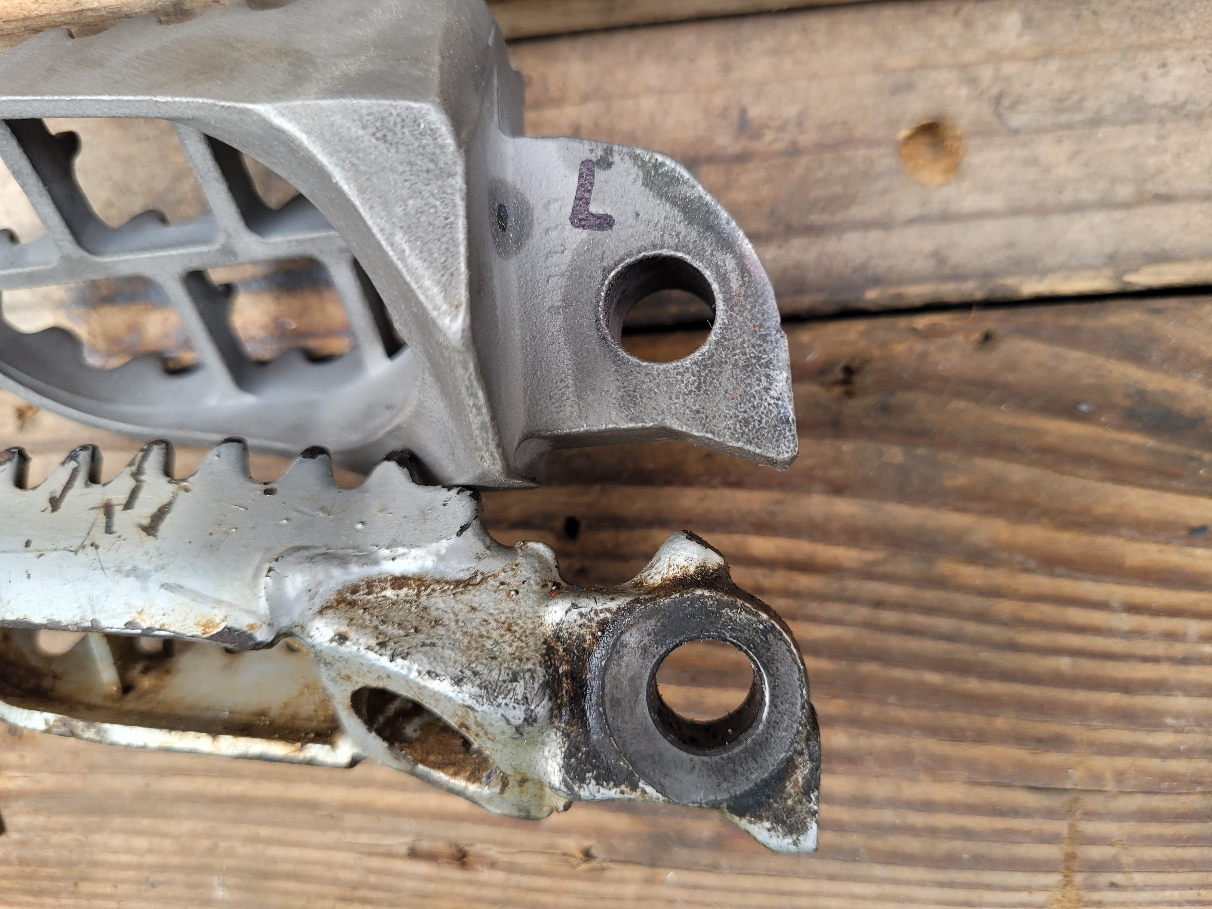

The IMS peg dimensions were not correct for peg portion that pivots between the ears on the frame. Here's photos of the OEM and
modified (ground) IMS peg to provide proper fit / function.

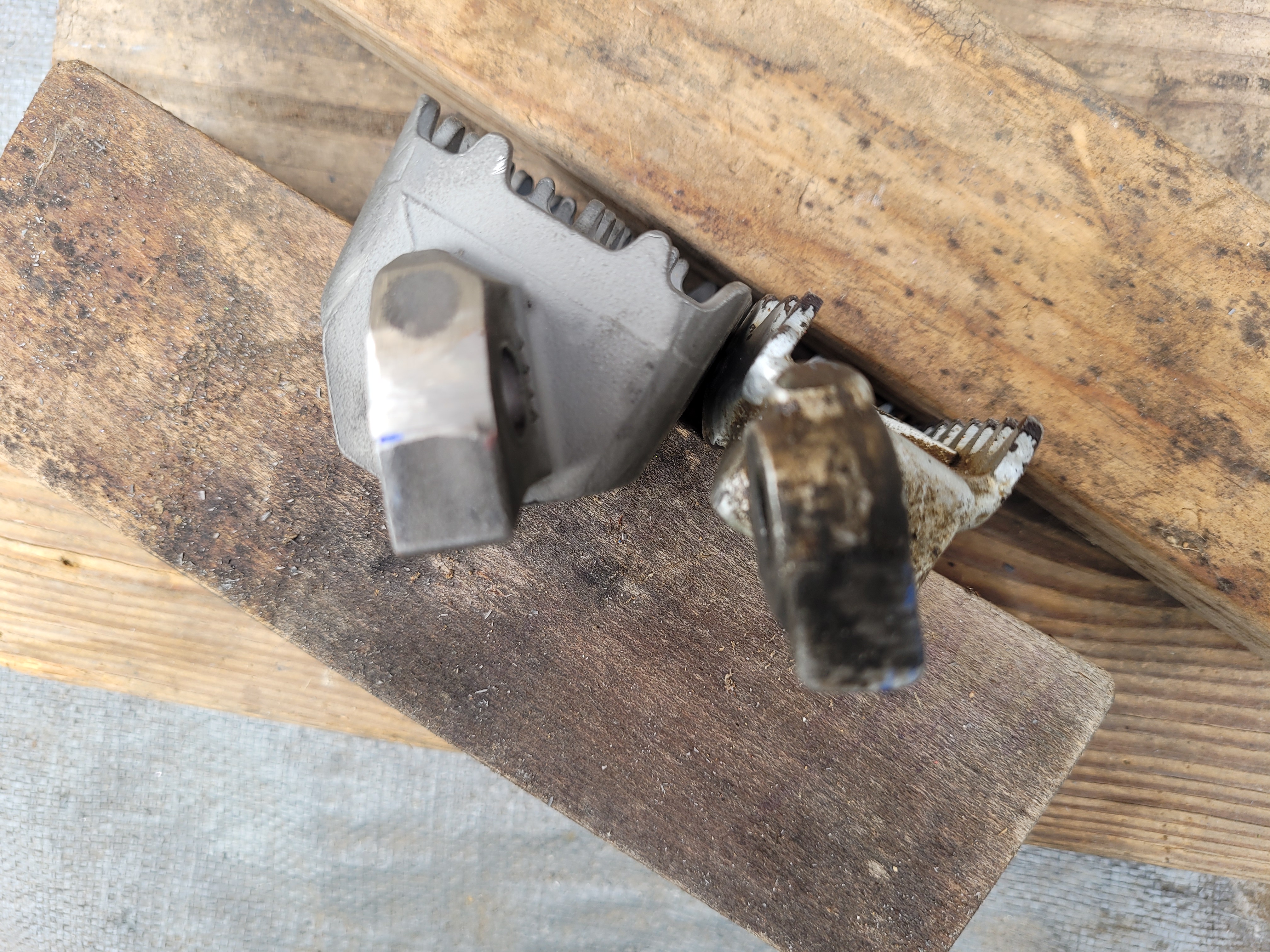

It was also necessary to remove a tooth from the right peg (after photos attached). The tooth with folded peg made mid-width contact with rear brake. This prevented peg from folding as much as it should and also could potentially damage brake lever on hard ground small.
