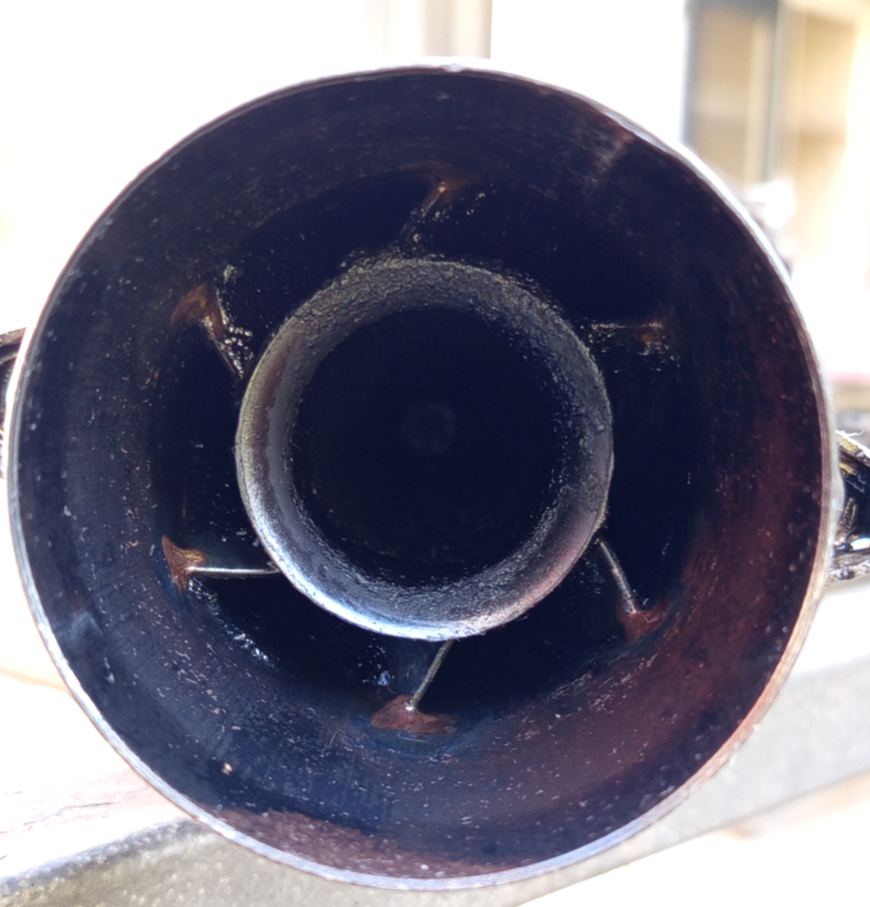

Very interested in this, did you take any photos? I've been suffering a lack of top end power in my kdx200, I've opened up my stock muffler for decarbonising, if it is the cause this is a pretty significant discovery for kdx owners using the stock muffler.shunpiker wrote: 08:20 pm Apr 13 2025 Woah... been a while.
I was discouraged over the winter, but I got more serious about things as the days started getting longer. I swapped the electronics on both bikes, putting the electronics from bike a onto bike b and putting bike b's electronics on bike a. I learned a lot. I started with the coils, then the cdi and regulators, and lastly the stators. I rode both bikes at each swap.
The sick bike never ran any better by installing the healthy bike's electrics. And the healthy bike still ran strong with the sick bike's electrics. I never swapped them back.
What the problem was... the silencer/spark arrestor had become clogged.
A new turbinecore, and I'm back in the power. A belated "thank you" to everyone. I hope you have a great summer.
If and when I will do a write up on opening up the stock muffler

Re: KDX220 just quit making power; baffled. Solved
The stock muffler also uses the turbinecore design, I thought it was just an fmf thing
