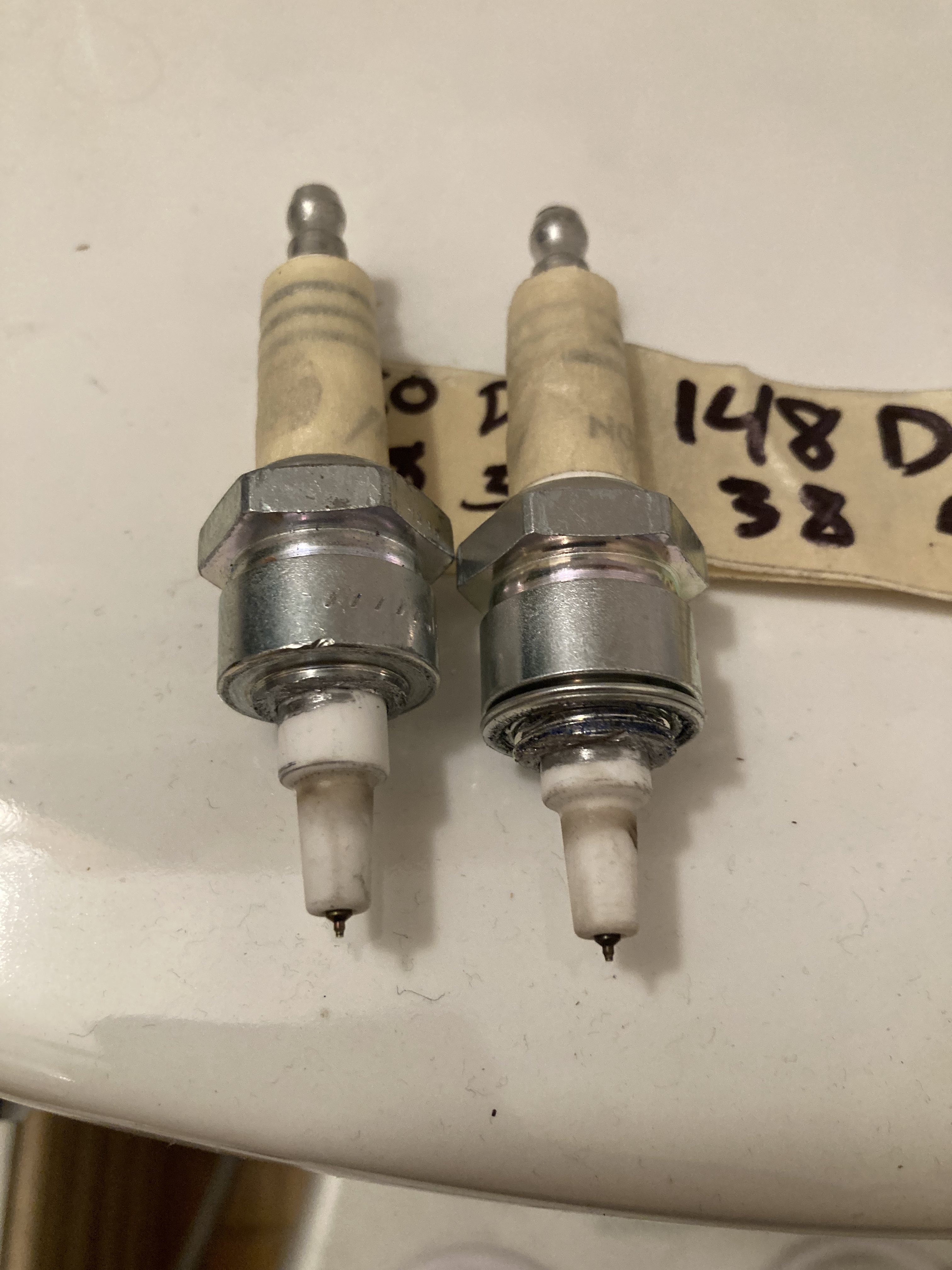

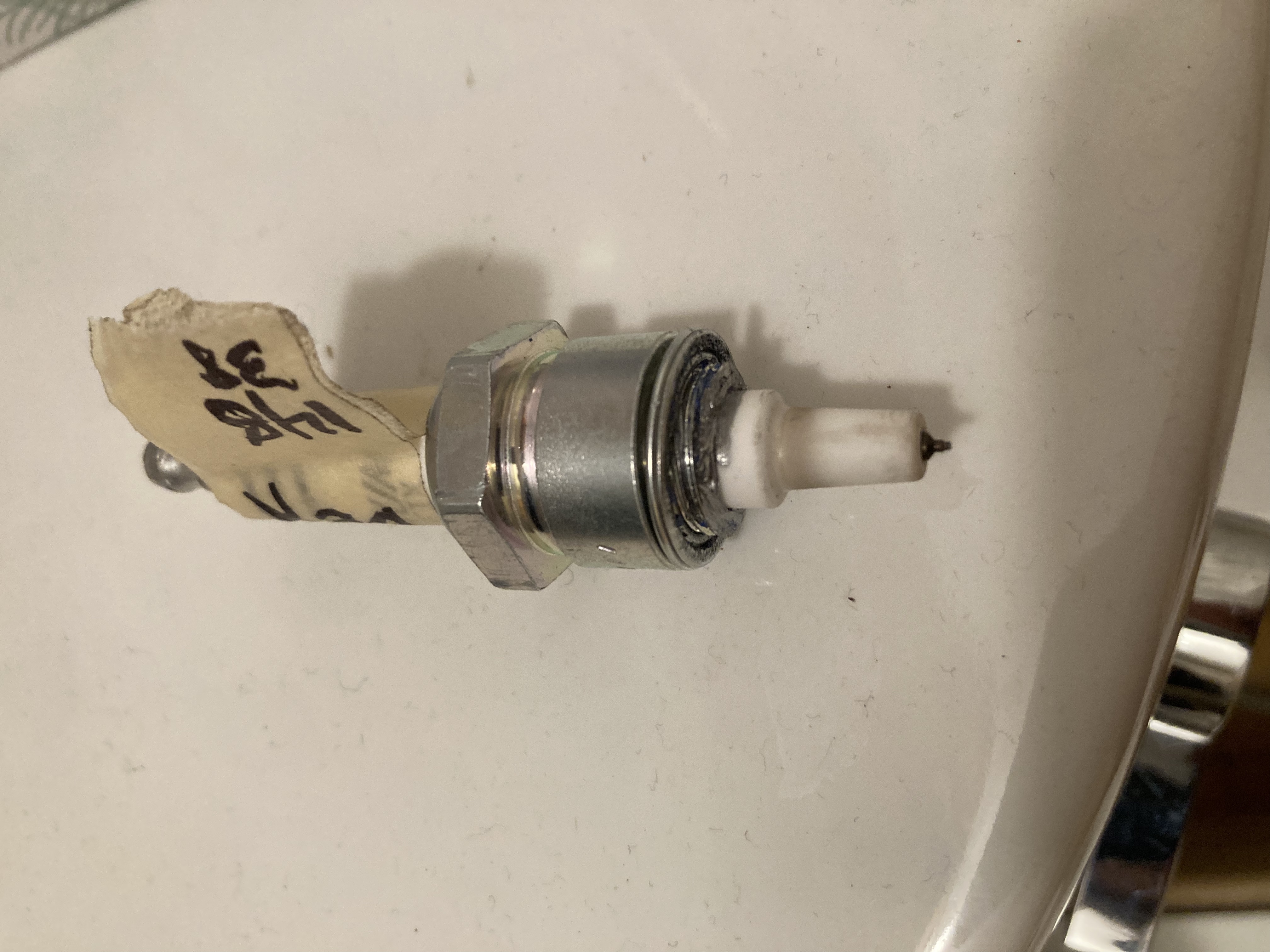

I did a plug chop this evening. Looks like the ragged edge of too lean. What do you guys think?
It's worth mentioning that i had spooge half way down the silencer and dripping from the exhaust joint onto the swingarm after this evenings ride with the current jetting.
This was all done at the same time i was doing a top end, and i always leak test motors on the bench before they go back in the bike, so crank seals are definitely good.

That definitely looks too lean, IMO/IME.jamiethegiraffe wrote: 06:57 pm Oct 11 2024 I did a plug chop this evening. Looks like the ragged edge of too lean. What do you guys think?

I thought it looked a lean as well. Probably will repeat the process this weekend with a 150mj and see if it's better. I think i have a 152 and 155 on hand to try out as well if need be.

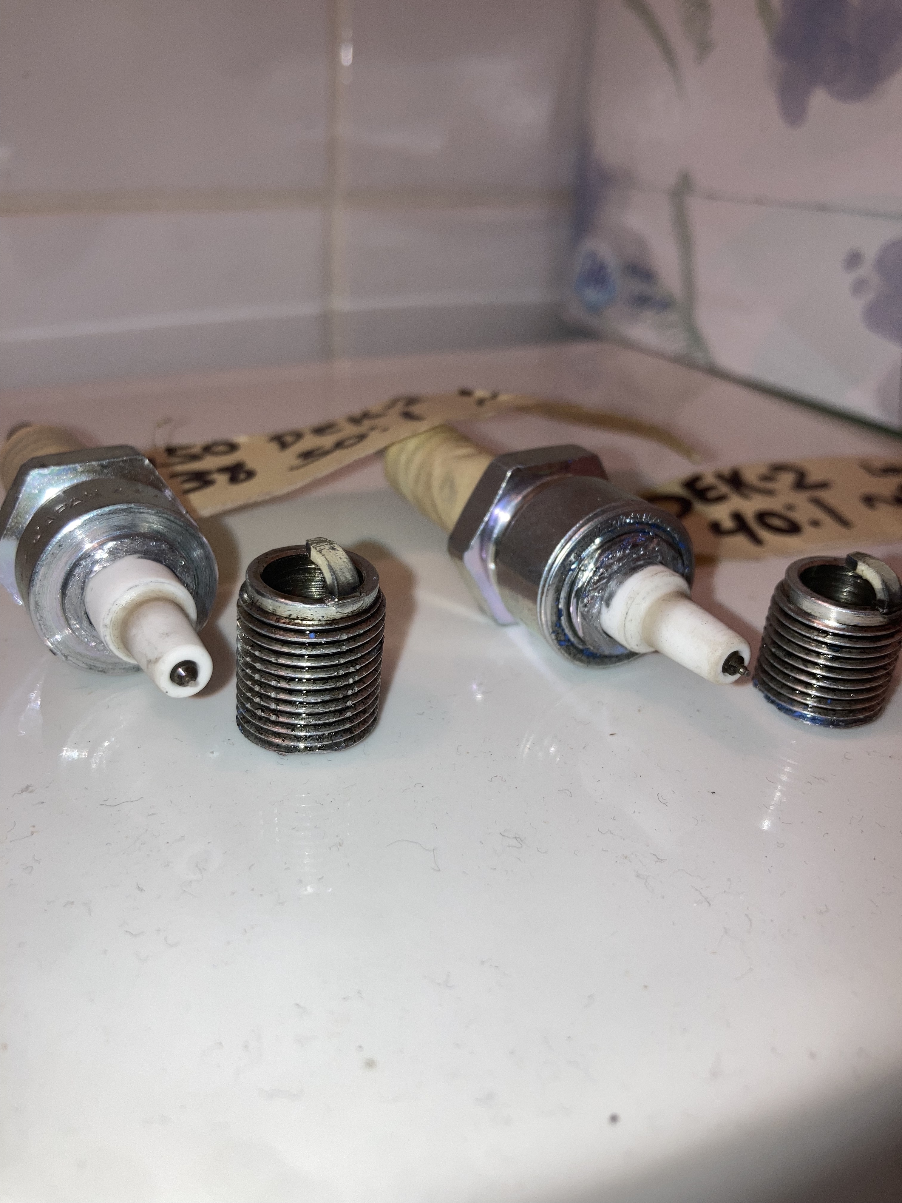

i thought it looked kinda thick as well for how light it is....KDXGarage wrote: 03:11 pm Oct 12 2024 How did you do the plug chop? That color band looks pretty thick.
From what i've learned i believe i'm doing the chop test correctly:
Warm up the bike riding normally, then stop and swap for a brand new spark plug. As soon as the engine starts pin it at WOT and go through the gears on a slight uphill. Hold it at the top of 5th or 6th for 10-15 seconds, then immediately pull clutch in, hit the killswitch, and coast to a stop with the clutch in. Swap plugs again and ride back home to cut the threads off and have a look.
I did another chop today with a 150mj and 50:1 fuel. It's worth noting that the ground strap is reading 'too hot' on these WOT runs, but the same plug (BR7EIX) reads as perfect heat range (color change right in the middle) after a day of normal riding. It's also worth noting that the bike runs awesome and i'm not looking for more power or better throttle response. I'm just looking to get a safe baseline.
Today's plug in on the left- yesterday's plug on the right for comparison.
Whadya guys think? should i go another step richer on the main?

Just wondering, any reason for using a hotter #7 Iridium plug for plug chops? usually use and run the standard NGK BR8ES(B8ES)

Whoa, why are you using a 7 range plug? That's too hot of a plug for the KDX. You should be running an 8 and you don't really want to use the expensive plugs for plug chops. I highly suggest using standard NGK BR8ES plugs for plug chops and riding.
