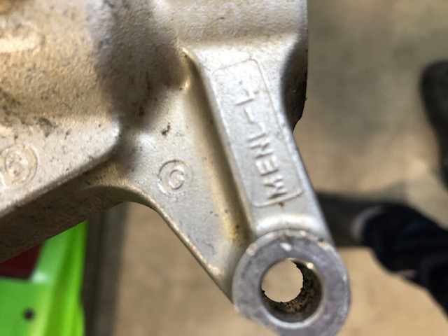

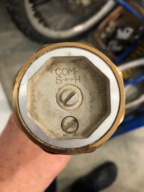

I purchased a set of used forks which I was told came from a 2003 KX250 but I'm wondering if this is correct. The ones I have seen have a hex protruding from the cap (like a nut) The forks I have have a recess. The code on the lower leg is MENL. I tried googling this but couldn't find anything. If anyone has info on what these are or can point me in the right direction I would appreciate it. Also, I bought these as I was/am considering installing these on a 1990 kdx200 but these forks are quite a bit longer (about 1 1/2") than the original forks. This measurement is from the axle to the top of the upper clamp. I've read some of the posts on fork conversion and I've seen other people use the 2003 kx forks and wonder how they get around keeping the same geometry.

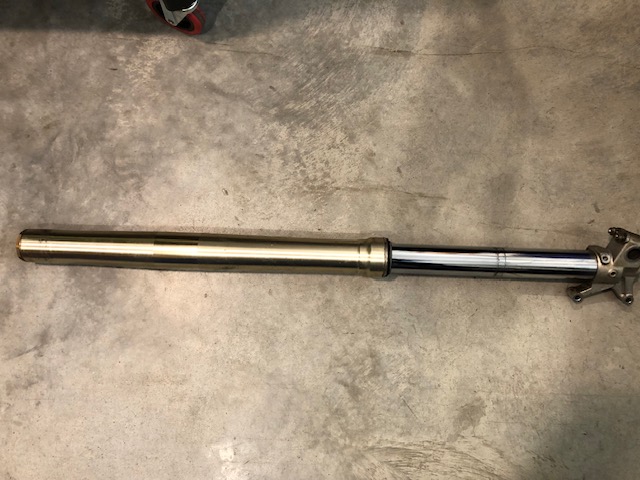

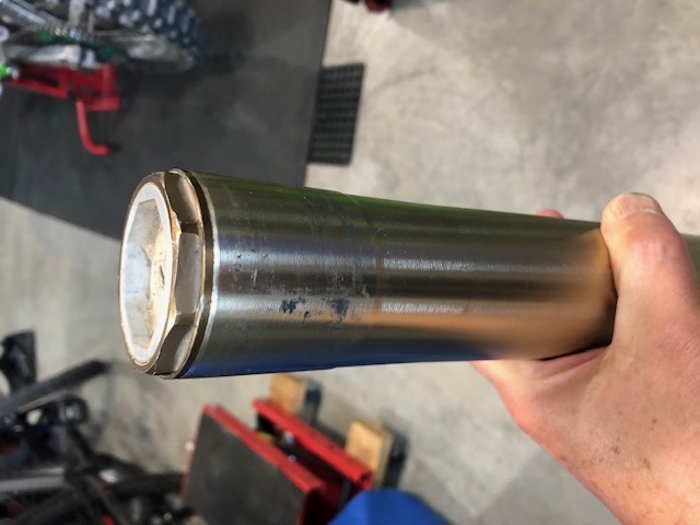

Here are a few pictures of the fork I have. At the moment all I have is the forks. No triple clamps or wheel.

That is not 2003. EDIT: Are they from KYB? The caps look like KYB. Yamaha?

When I bought them I was told they were off a 2003 KX250. But who knows????? Thats what I'm trying to find out. I googled that MENL code but could not come up with anything. I'll see if I can email KYB and find out

Look at 2005 and newer YZ125 and YZ250 forks on eBay to see the caps. Someone will show the bottom part with the letters. The cap looks like that. I have a 2005 KX250 and a 2007 YZ250. They are not from a KX 2-stroke.

Congratulations. You almost stumped me. Thank you for the challenge. I think they are from a 2009 Honda CRF450R.

I knew they were closed chamber forks by the removable quick change base valve at the top, and compression adjusters on top vs bottom. Didn't know what make/model at all though!

"Your googling" is the reason we are all still in this thread a week later. :-) It's 2009 CRF450R (not X, not 250, etc.) Look on eBay at the 2009 CRF450R forks. It has MENL-L on them.

I looked at those pictures again on ebay. I had looked at them but had not seen the code but I see said the blind man. My apologies and thank you.

...to his deaf daughter. I was just ribbing you on that. I did find one bit of info by searching "MENL-L" in quotes, which led me to the pictures on eBay. I don't get much luck when searching the general web for parts details. I am glad we got it figured out.
