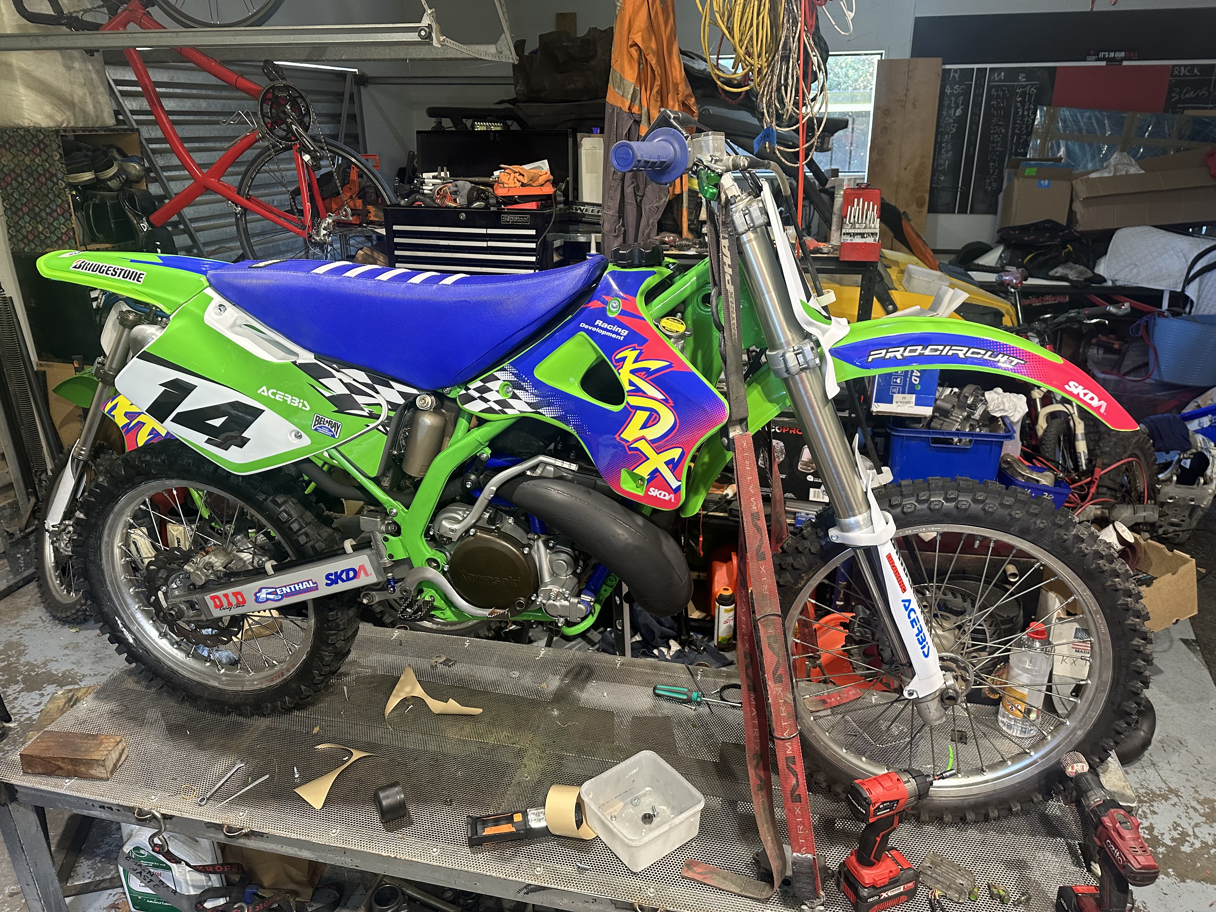

Hi guys and girls. I know this is a long shot but does anyone have a wire diagram for a 250sr. Even a clear one that is in Japanese that I could get translated to English.
We seem to have everything going into the cdi power and trigger signal but there is nothing coming out. I have 2 different cdi and both are the same. We have tryed to make the most basic wiring loom as I’m not going to run lights or anything else as I built it for vintage motor cross
Any other suggestions would be helpful as well
