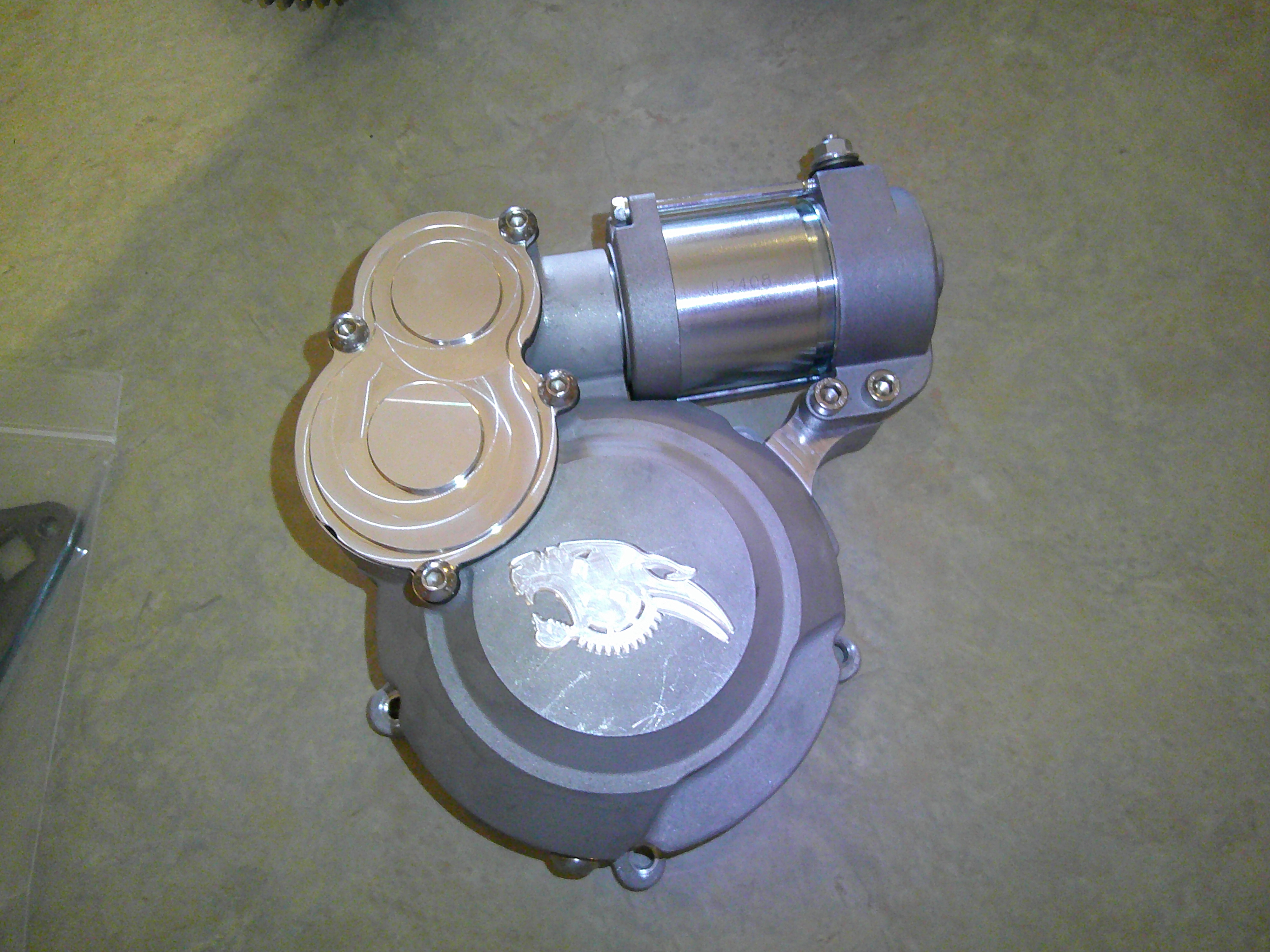

It will probably be 30 days before I can get going on this as I have some other things going on. I'll take pictures of what I get accomplished as I go.
If the moderators wish to change anything, go ahead. I need all the help I can get.

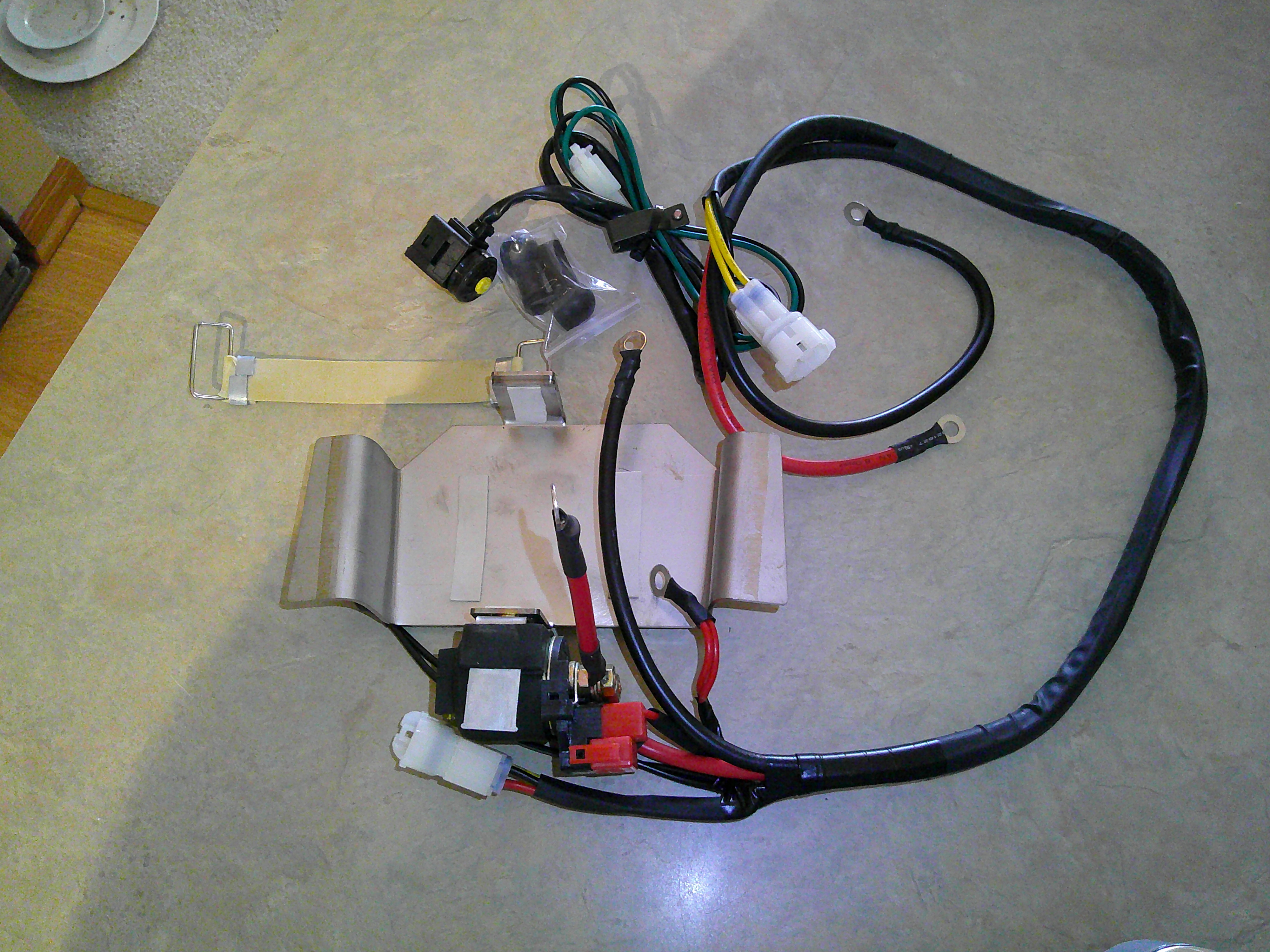

Electrical/battery tray is designed to be used with the airbox lid off. CDI must be relocated. I had to turn mine as the wires were a little short.
Battery tray just sits there. The seat holds it down.
Re: Panthera E-Start Photos.
Posted: 01:28 pm Oct 23 2024
by Molly's 70

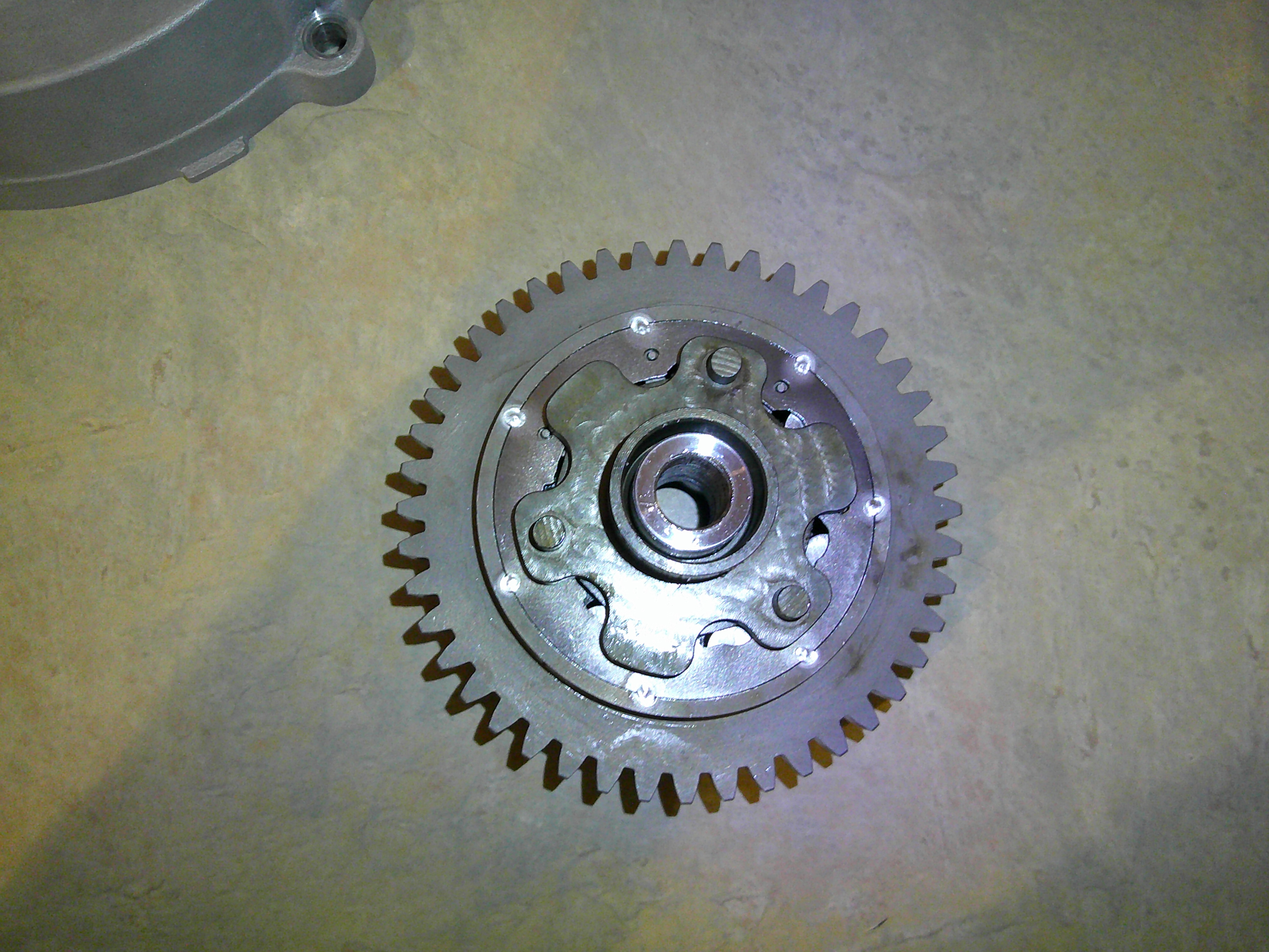

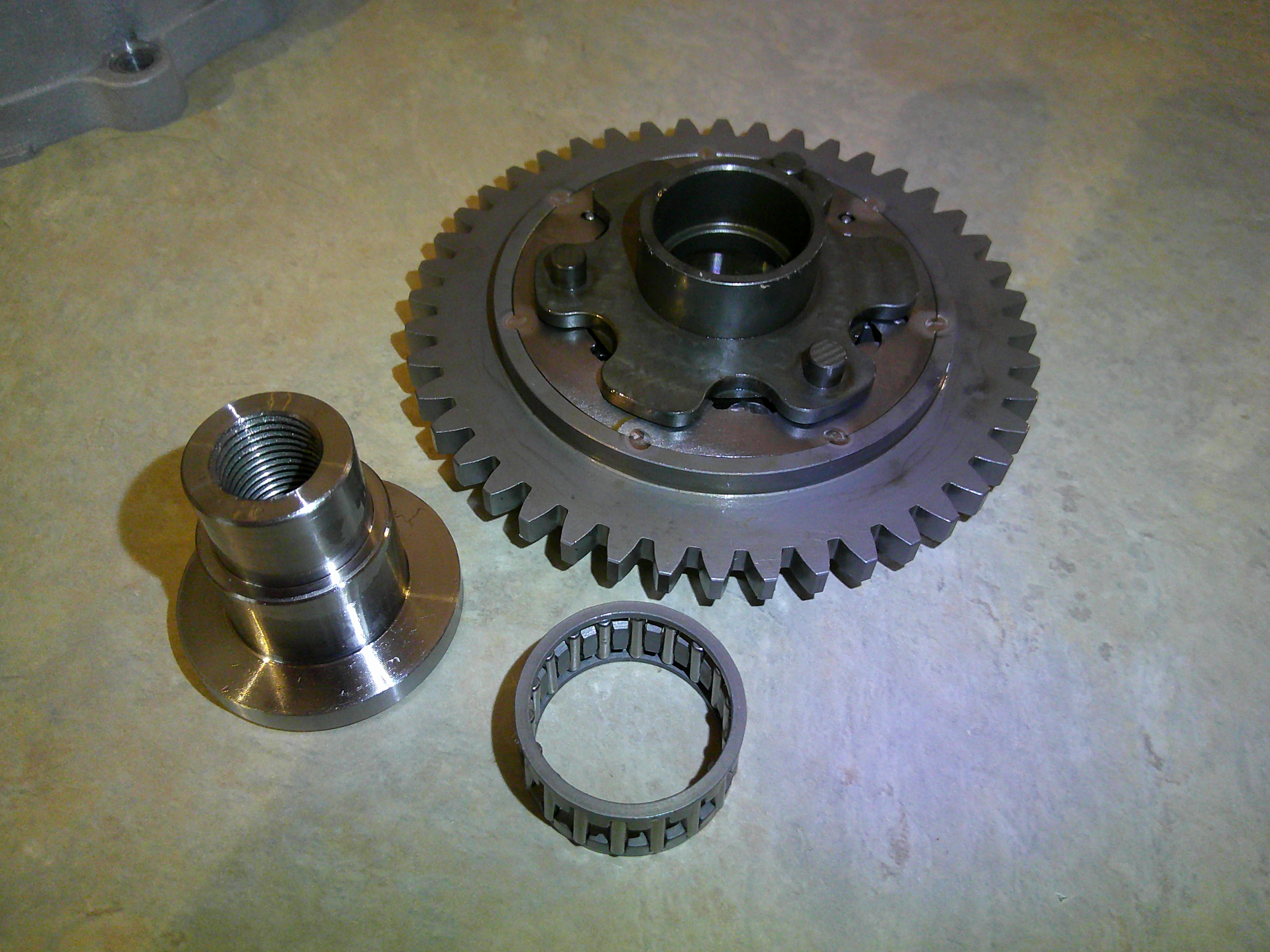

No need to remove the flywheel, just the nut. Install the one way sprocket, bearing and new fastener. I will torque it with the supplied tool & my torque wrench.
Make sure to get the 3 pins into the flywheel. It will sit flush. Then install the other parts pictured. It's really pretty straight forward.

Dang it. I loaded the pictures in the wrong order. I'll get better at this.
Battery will be here today. I think I have a charger for it.
