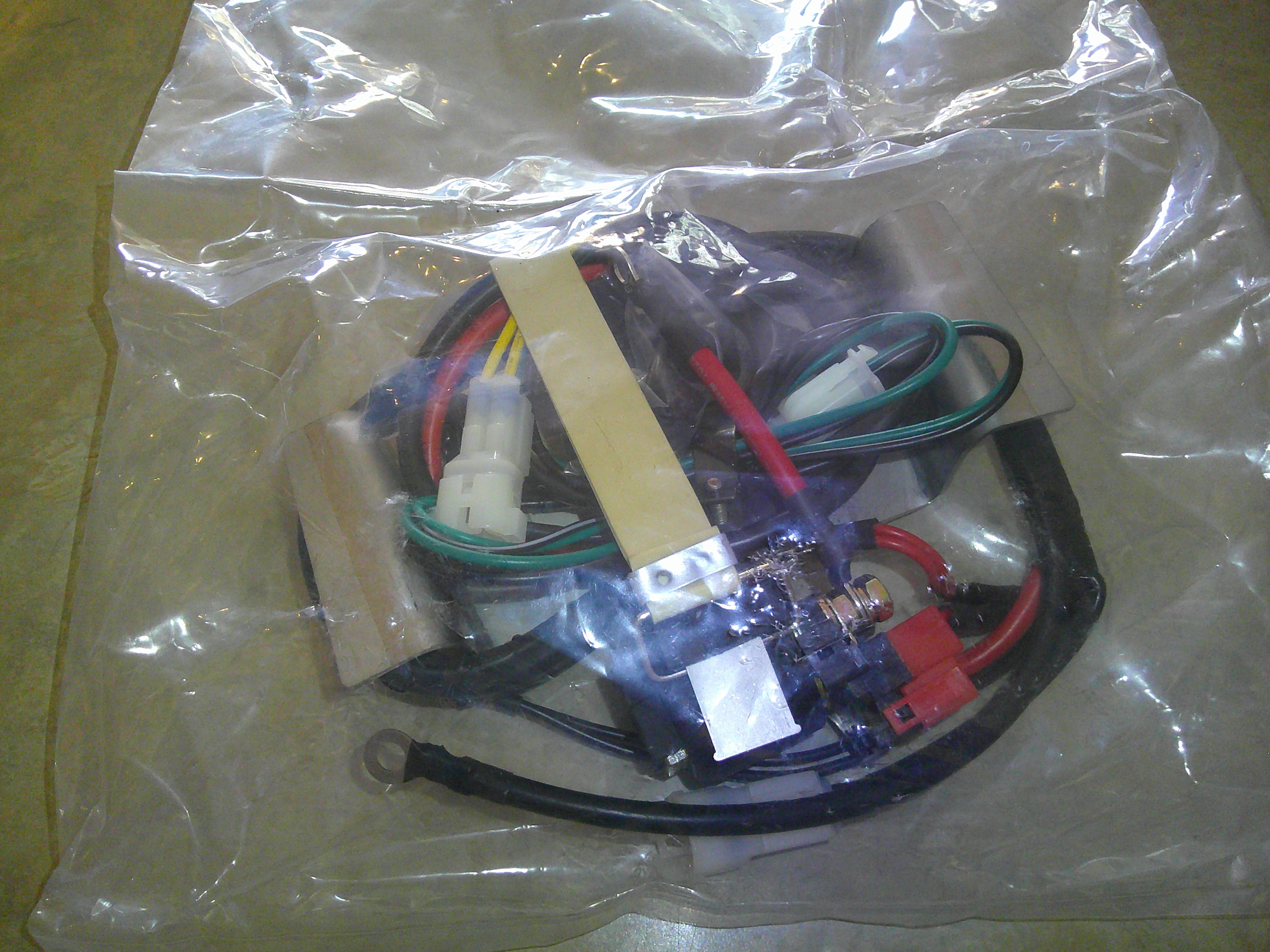

It will probably be 30 days before I can get going on this as I have some other things going on. I'll take pictures of what I get accomplished as I go.
If the moderators wish to change anything, go ahead. I need all the help I can get.

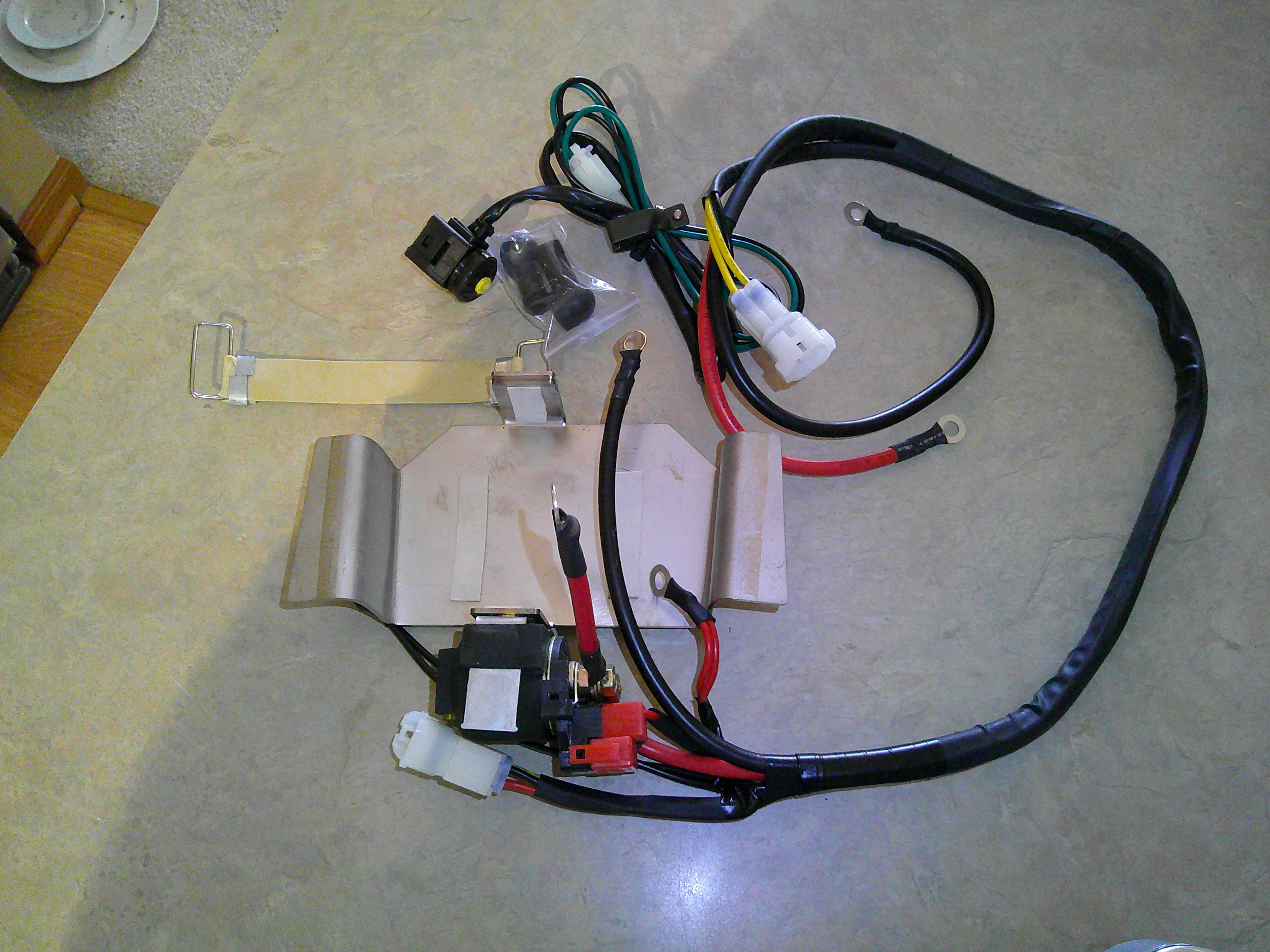

That kit looks super sweet. Thank you for sharing the pics here with the members. I'm eager to see you get it up and working.

Nice pics, very cool to see some shots of what actually comes in the kit. Will definitely be watching for updates when it goes under the knife!

Molly, it's awesome you initiated this post that interests so many if us so deeply! It's three times awesome that you posted.supurb photos! Hooray and the parts are beautifully fabricated.

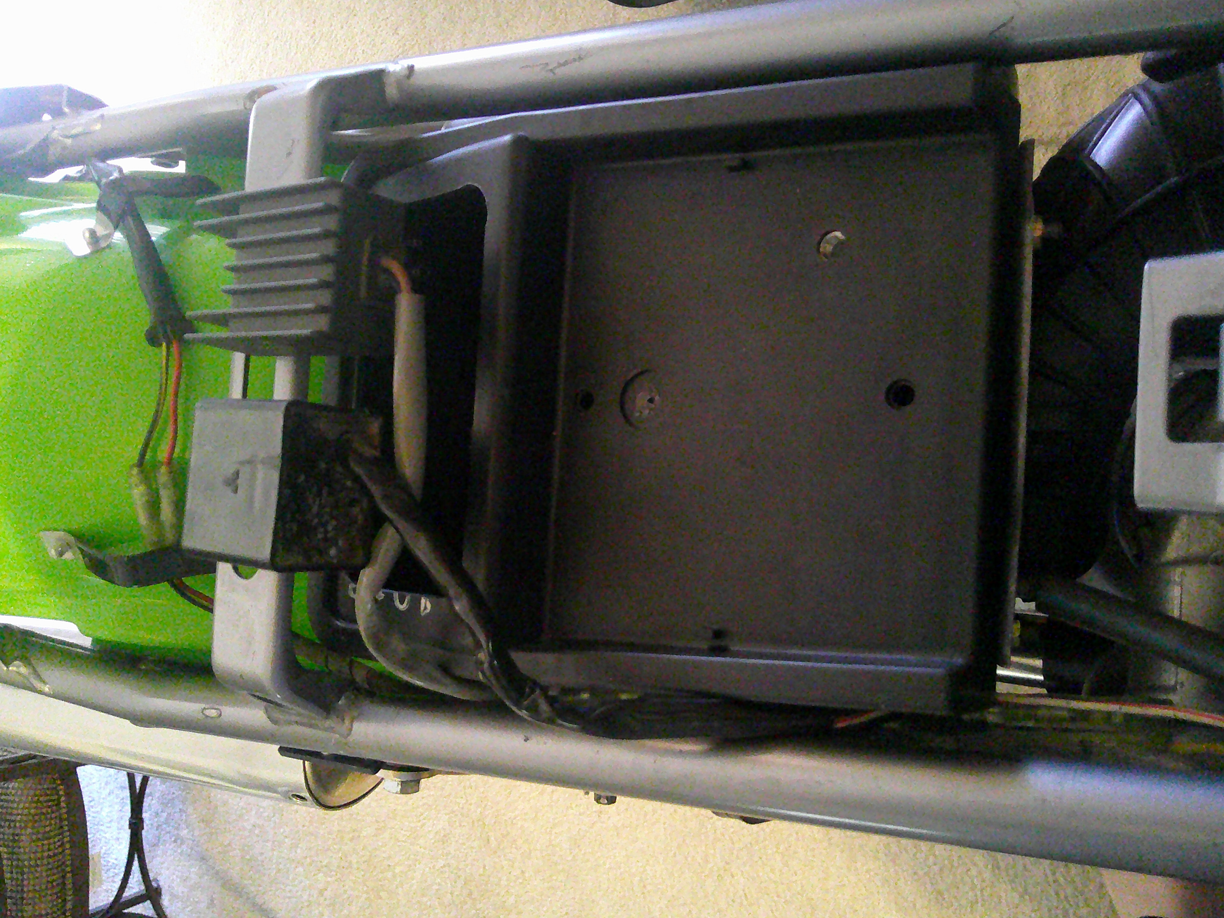

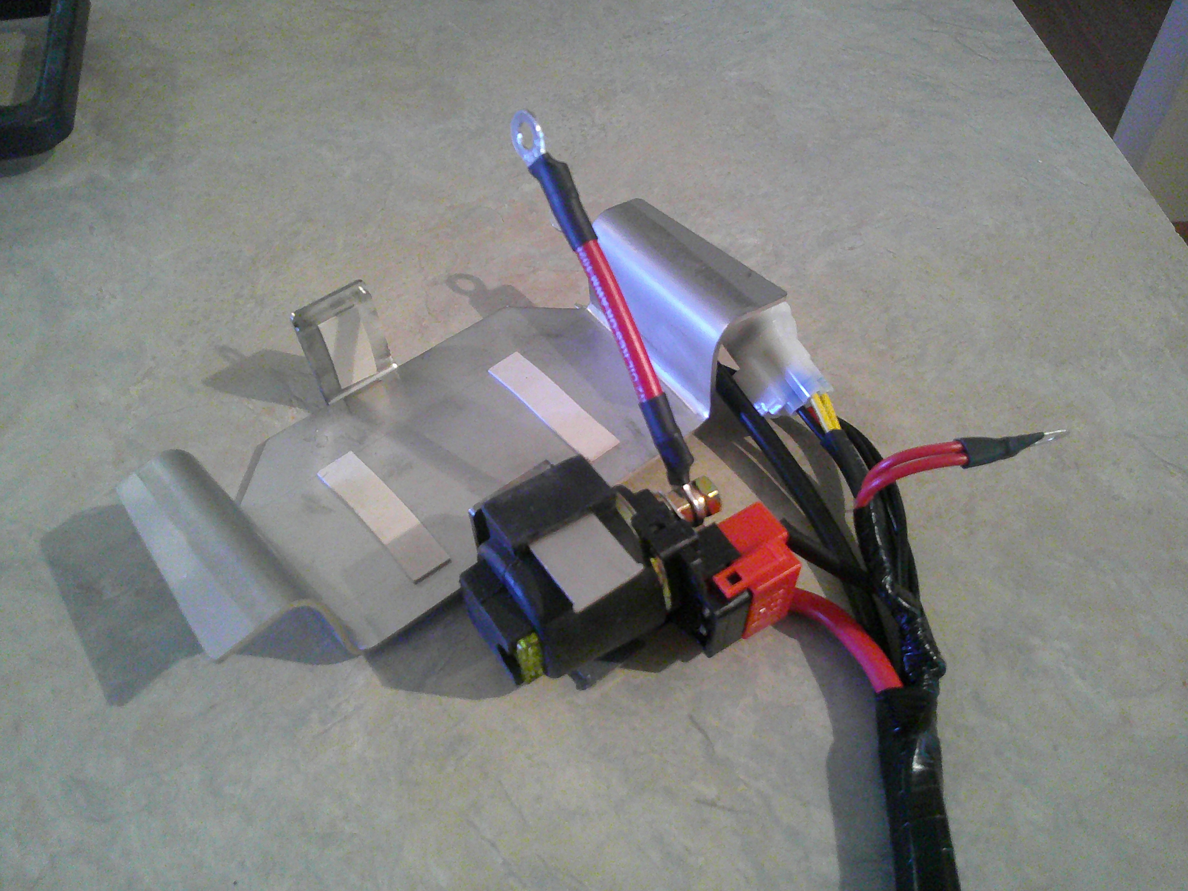

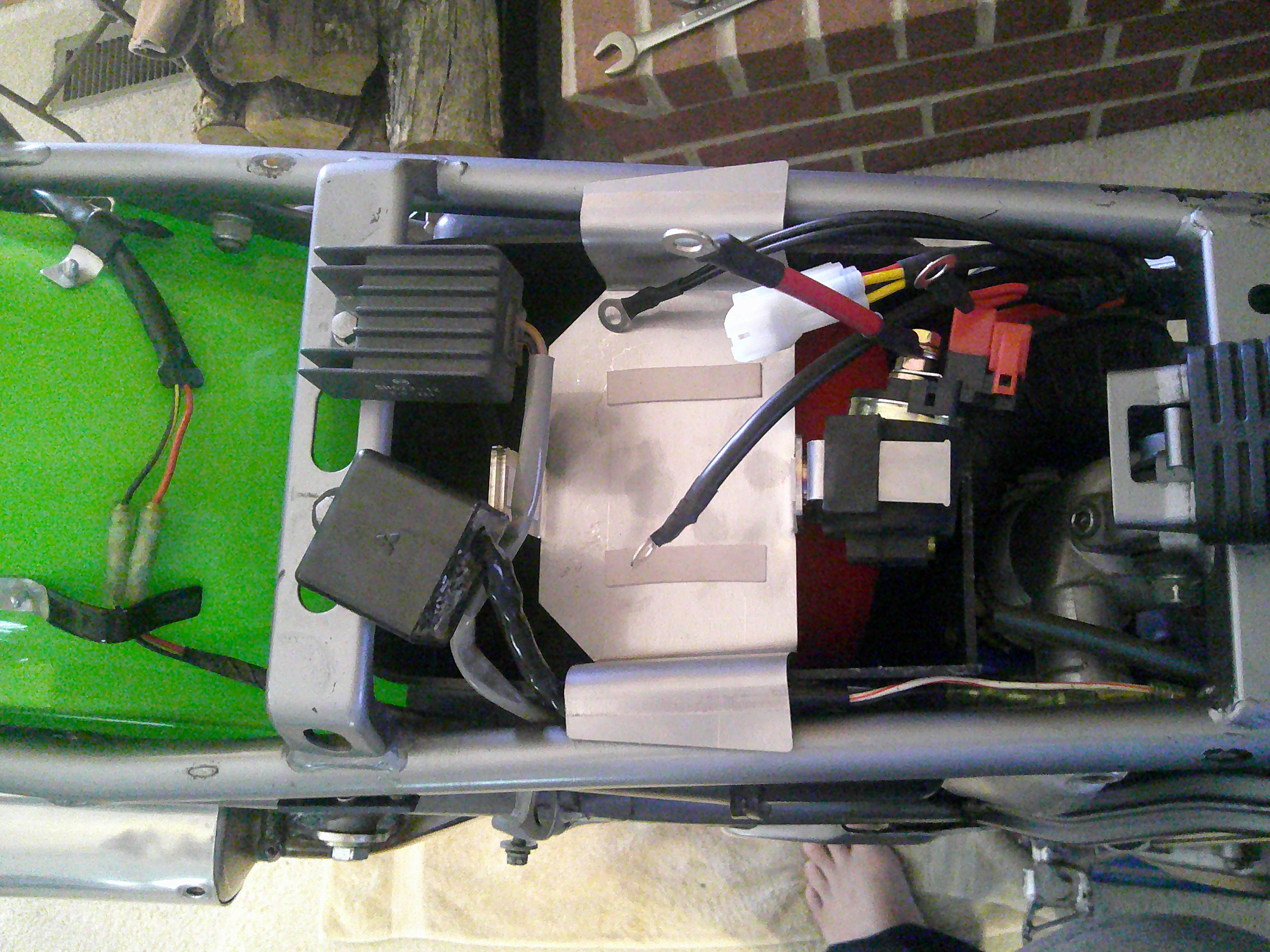

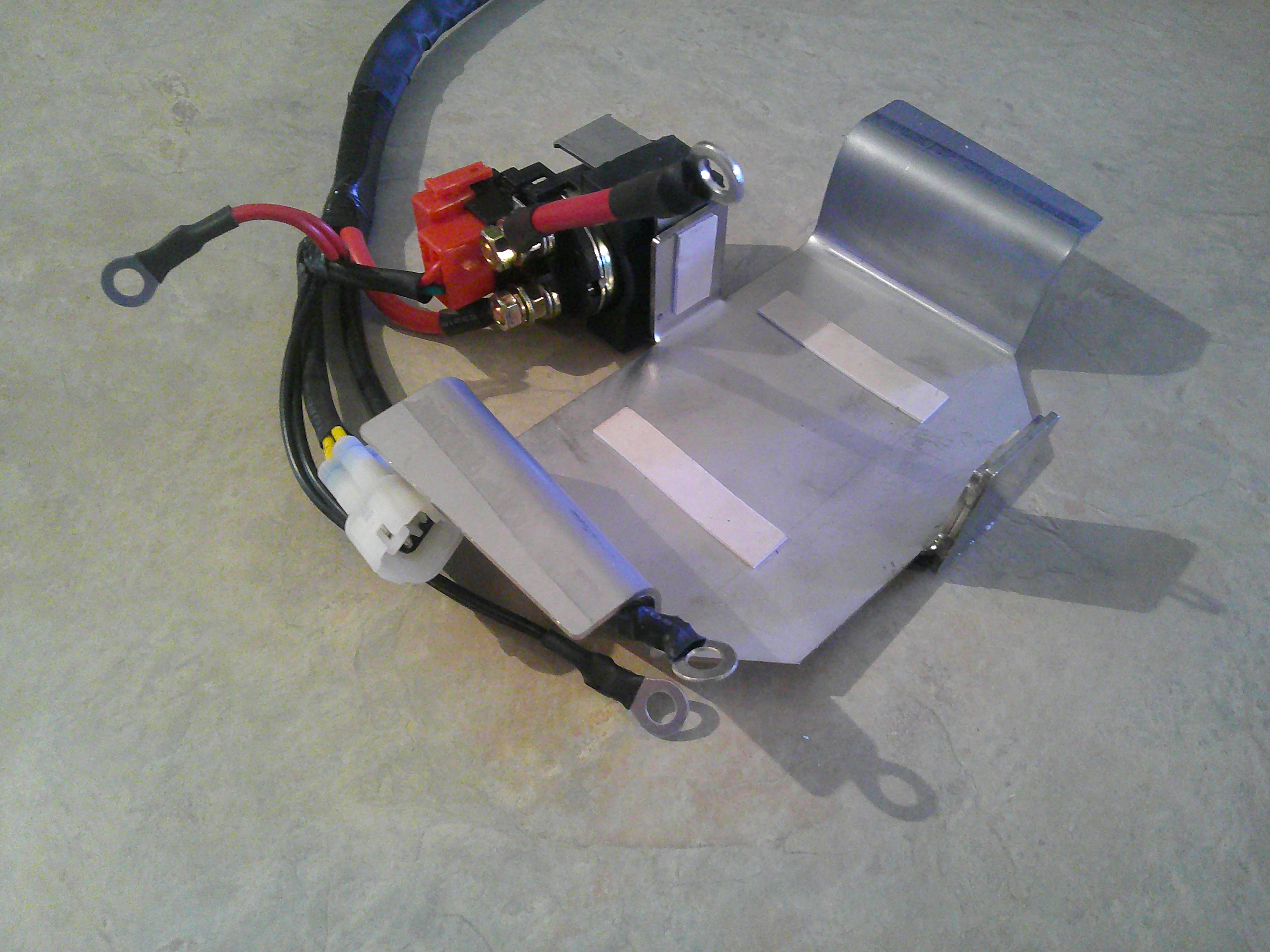

Electrical/battery tray is designed to be used with the airbox lid off. CDI must be relocated. I had to turn mine as the wires were a little short.
Battery tray just sits there. The seat holds it down.

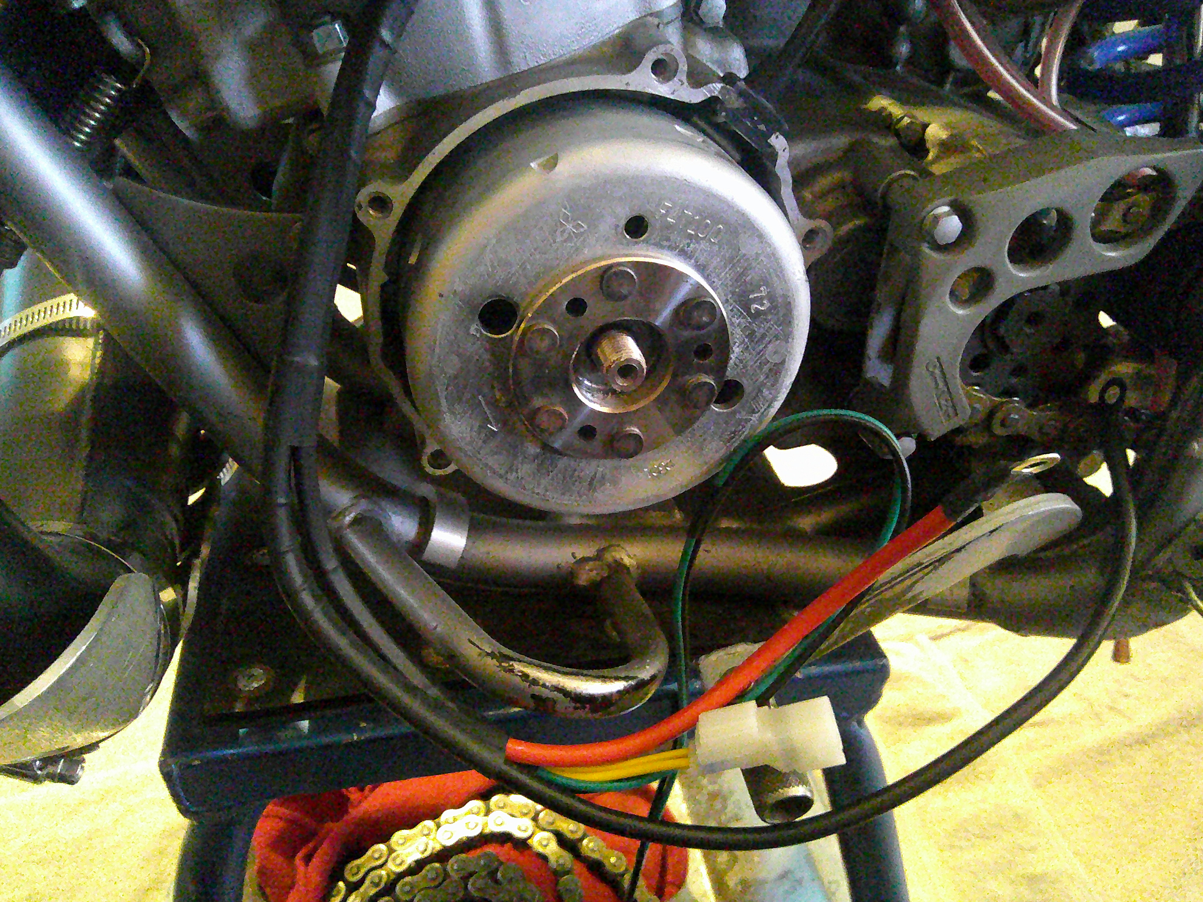

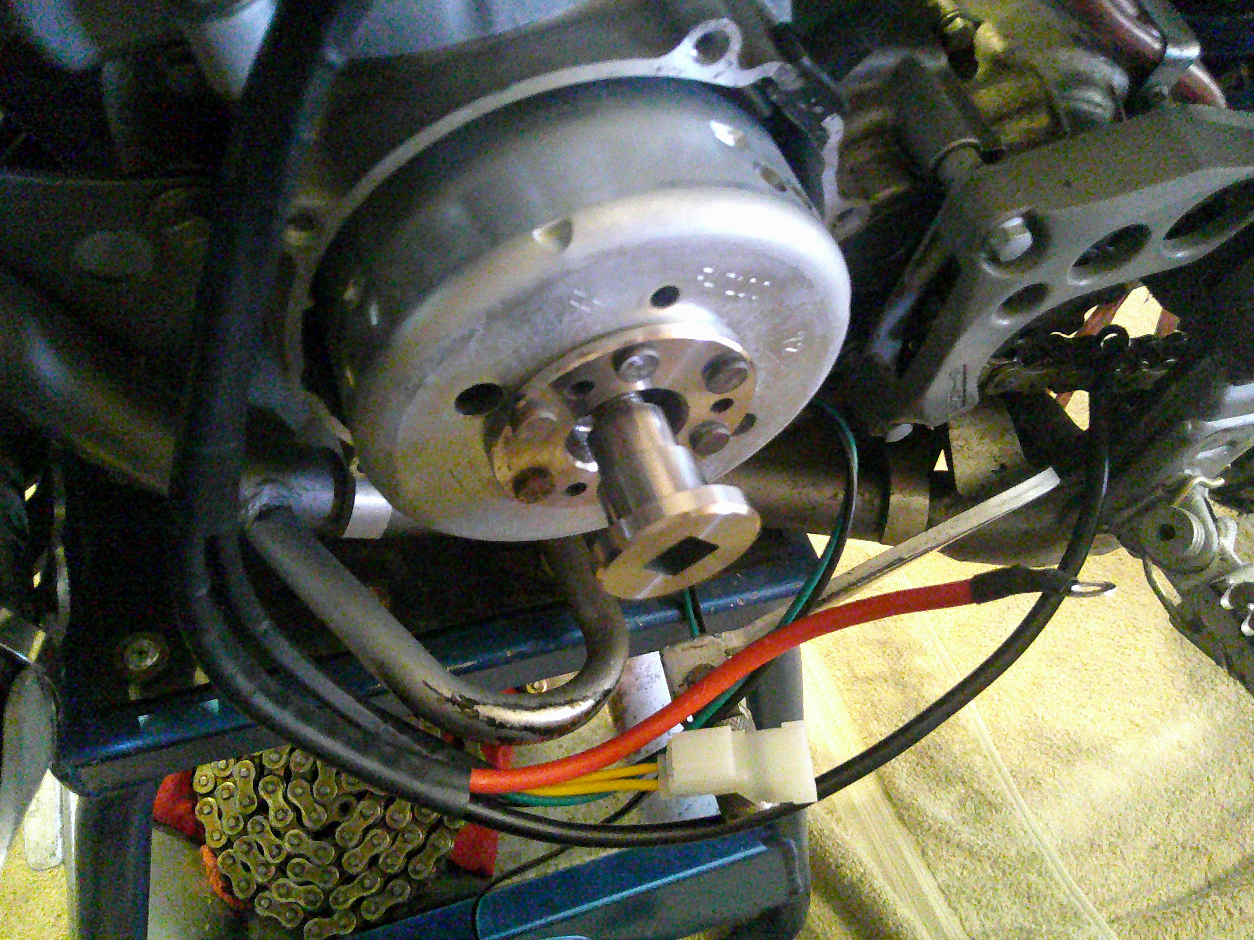

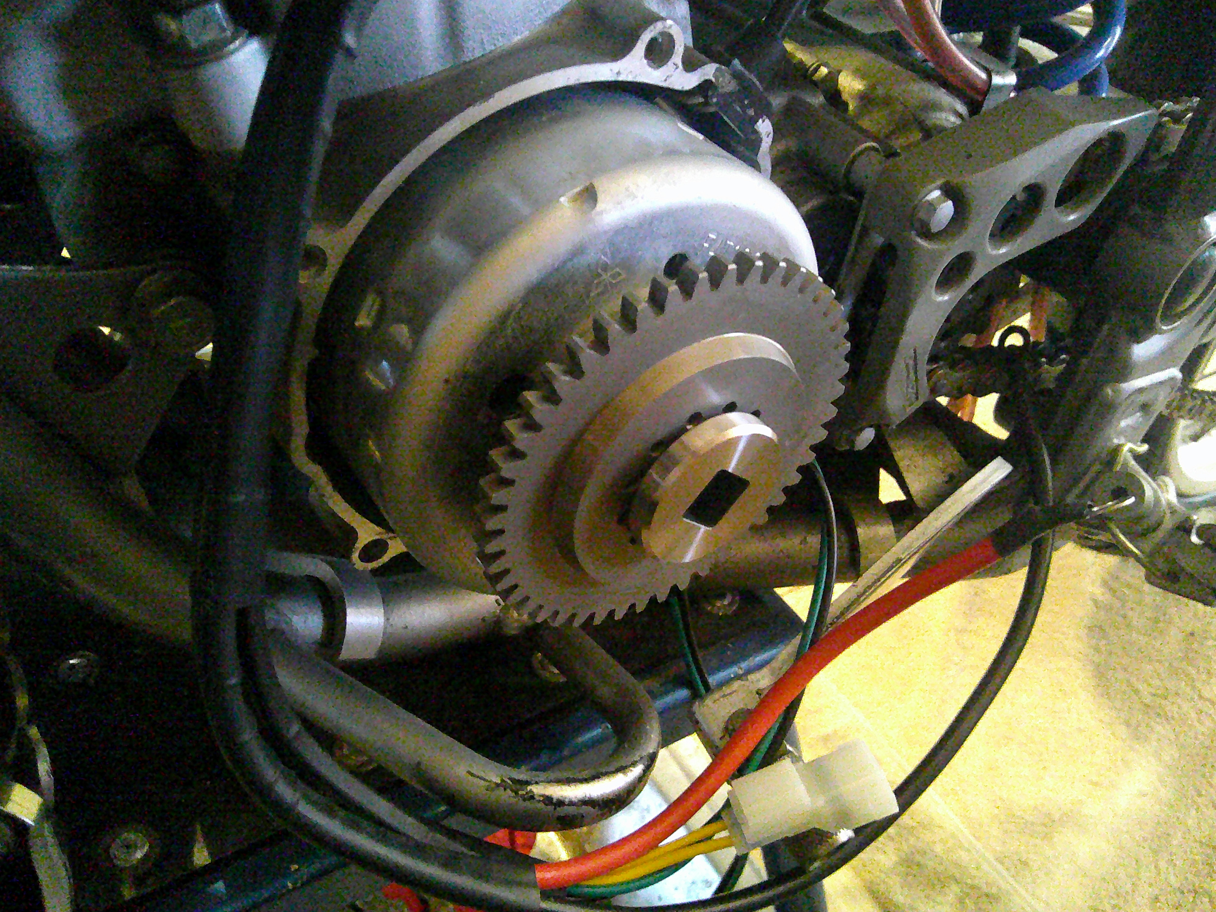

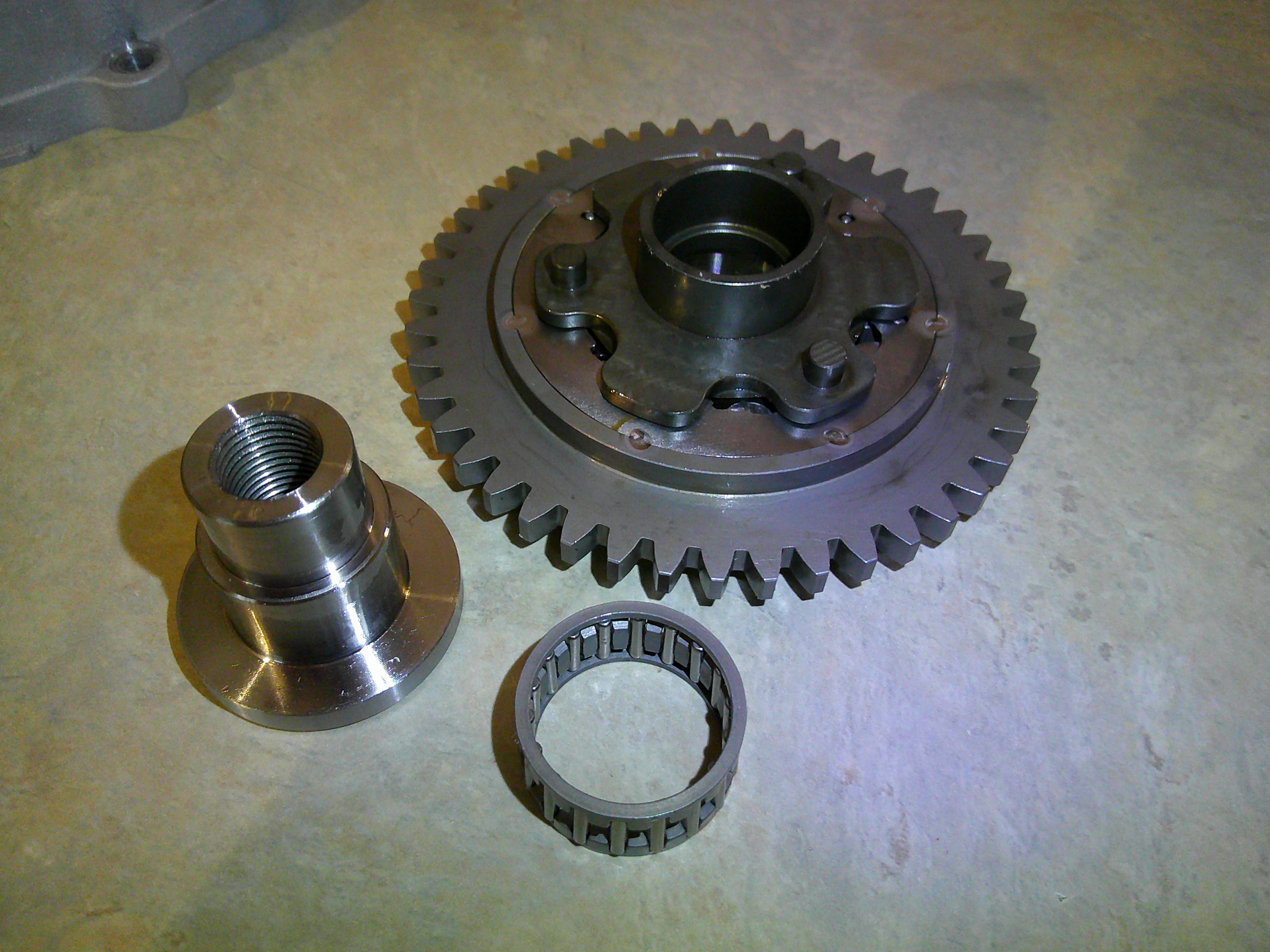

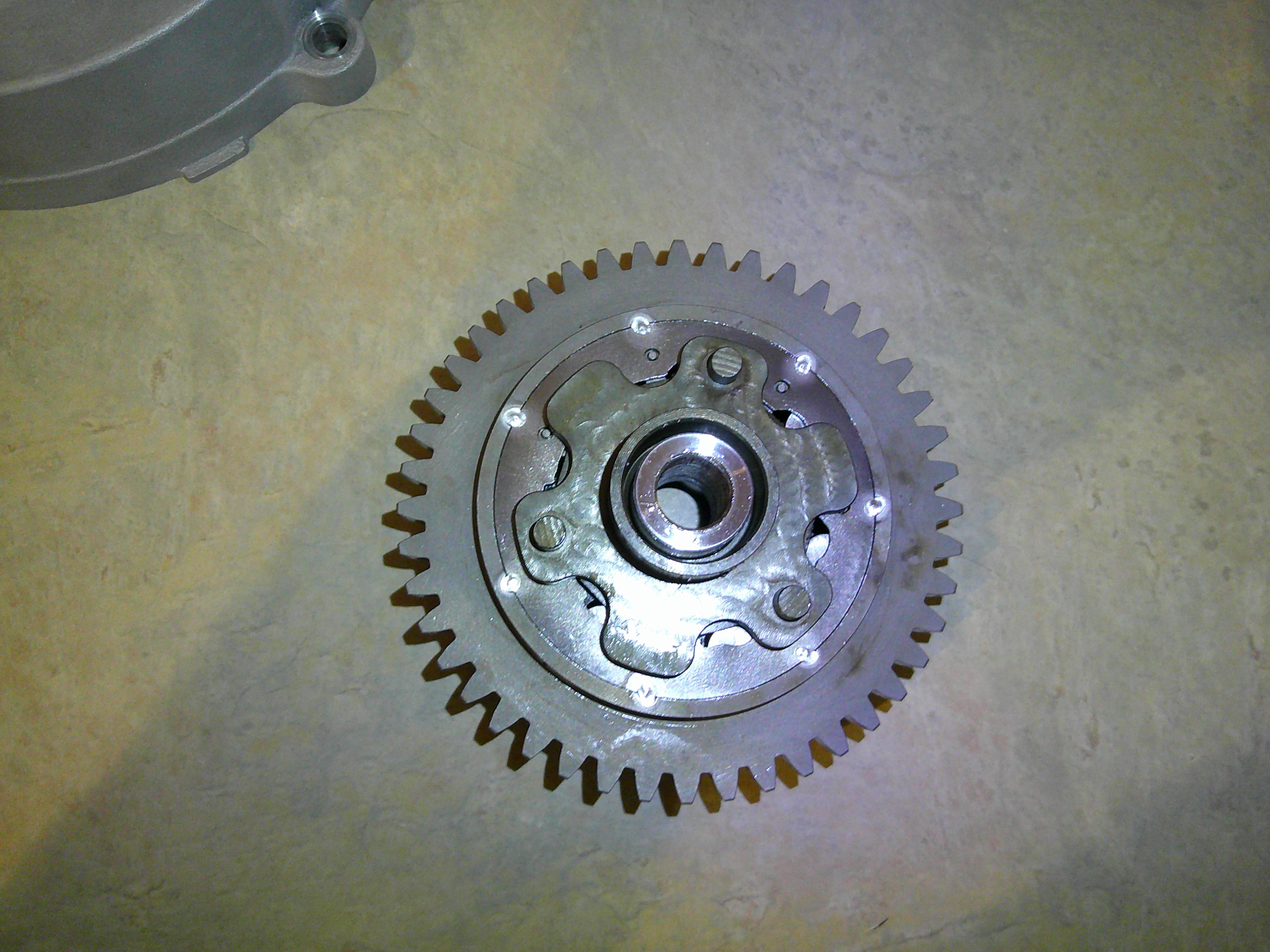

No need to remove the flywheel, just the nut. Install the one way sprocket, bearing and new fastener. I will torque it with the supplied tool & my torque wrench.
Make sure to get the 3 pins into the flywheel. It will sit flush. Then install the other parts pictured. It's really pretty straight forward.

Dang it. I loaded the pictures in the wrong order. I'll get better at this.
