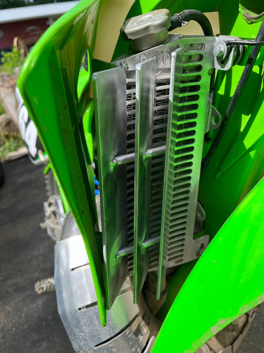

Here's a photo I saved (I believe from a KDXRider member) of what really should be done to the Devol radiator guards if using them with no plastic louvers. I'll try and check this week to see if the OEM louvers fit still, with the Devol guards, but I believe the answer to that is no.
It really helps direct the airflow (which is partially blpcked by the forks) into the radiators to have these in place. The Devol guards are a lifesaver at times, but also a hindrance to low speed cooling.
This winter, I should either learn to TIG weld, or use my MIG's spool guns with aluminum wire, to add these aluminum louvers to my both pairs of my Devol guards, or else modify them to accept some plastic OEM guards.

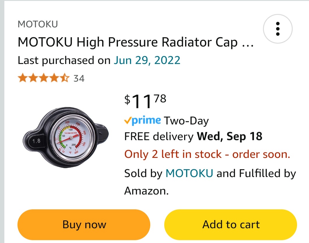

I ride steep technical mountain tracks in Central California. It's tough on the machine (because I can only go slow!). My DRZ 400S has a fan that sometimes runs. My KDX 220 was designed & manufactured without a fan. It gets pretty hot sometimes. I've seen a little bit of hot water / steam a few times. It happened more early on because the previous owner removed the coolant system expansion tank. I bought a replacement OEM tank & installed it. This helped a little bit.
At least one rider (racer, actually) installed a fan (Moonstomper, I think) on a KDX. Of course, to do this requires adequate battery and on-board charging system. Not that difficult to do.
Anyway, I use radiator caps in my DRZ and KDX that incorporate a temperature gauge (photo below and link https://www.amazon.com/gp/buyagain/sear ... _bap_m_srh).
My KDX also has a Vapor Trail Tech with a temperature gauge fed by thermocouple. The thermocouple came with the Trail Tech and is installed in the coolant piping at the location that coolant exits the engine. Here's the forum link for this: viewtopic.php?f=86&t=25268&hilit=thermocouple

I, too, am running a thermometer type 1.8 Bar radiator cap, and have been since overheating the one and only time (badly stuck in quicksand type strip-mine soda ash clay mud runoff) 1.5 or 2.5 years ago. It's nice to have so I know when I need to get the bike moving faster ASAP or take a break if it's all slow going ahead.billie_morini wrote: 05:16 pm Sep 16 2024 I ride steep technical mountain tracks in Central California. It's tough on the machine (because I can only go slow!).

No issues with those amazon caps? I was looking at them but the reviews on the ones I saw didn't give me a warm fuzzie
- Posts: 547
Re: Relatively easy to overheat?
Chopperpilot: the Amazon screenshot & link provided by me (above) is the very radiator cap I'm using on my DRZ & KDX.

I think the Amazon caps are the exact same as the Tusk versions which also look exactly the same as the Mylers Radiators version.

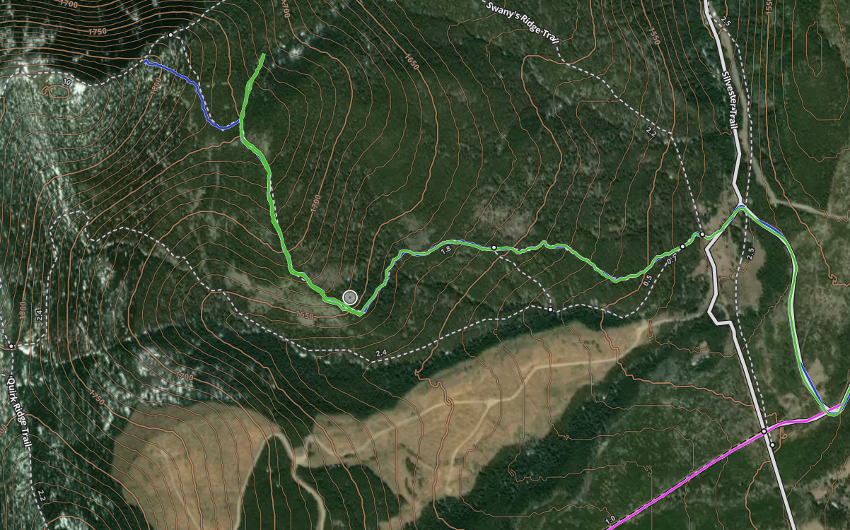

The dot on the Map is where we stopped for the pic and a rest. Where the blue line ends is where we boiled over the 2001. About 5900 ft elevation (topo lines are listed in meters on the screen capture) Cooler weather and elevation and humidity did have the 2001 stalling though, may be jetted a bit rich........... may try some waterwetter in it, ran that in my old CR500

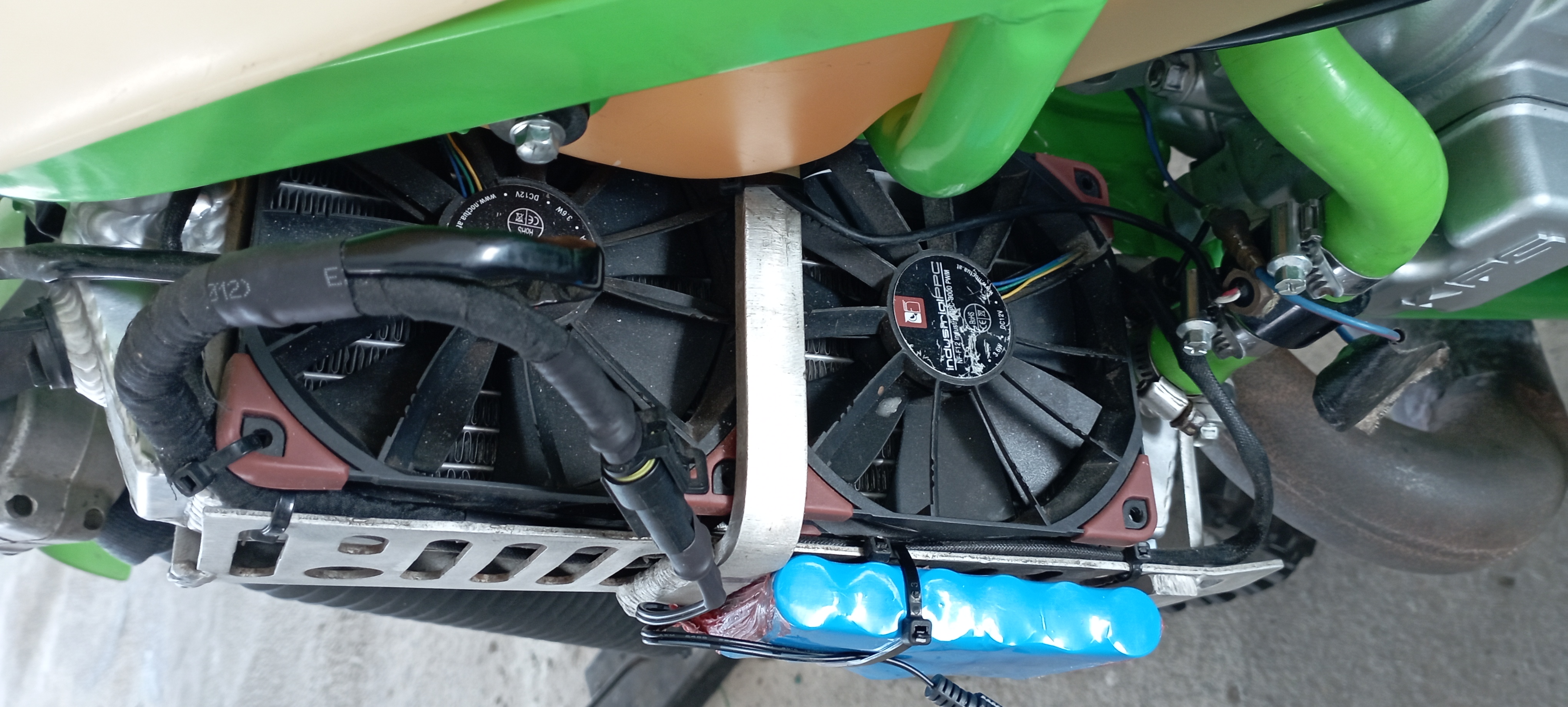

My fan set up

That's a neat setup kdxdazz - I'm already running a big lithium battery pack in the "tool bag" that I have wired up to a USB cable to make sure i don't run out of power for GAIA GPS on my phone. I might have to look into something like that this winter. It would have lots of power to do it......

How waterproof are those fans?
I suppose you could run them off the bike's aftermarket 12v rectified DC system and a small battery as well, right?

The fans are noctua industrial ppc computers fans, basically the best computer fan money can buy, I forget the IP rating , they are shower proof but not waterproof from memory but the 24 volt versions run underwater
There's probably lots of ways they could be run but given I am electrically incompetent this is the system I came up with
They flow 200cfm but it's over the whole radiator surface, you basically can't run an off road bike in the Thai jungles here without a fan
They only come in 120mm and that size is very difficult to fit on a kdx, 100mm would be ideal
