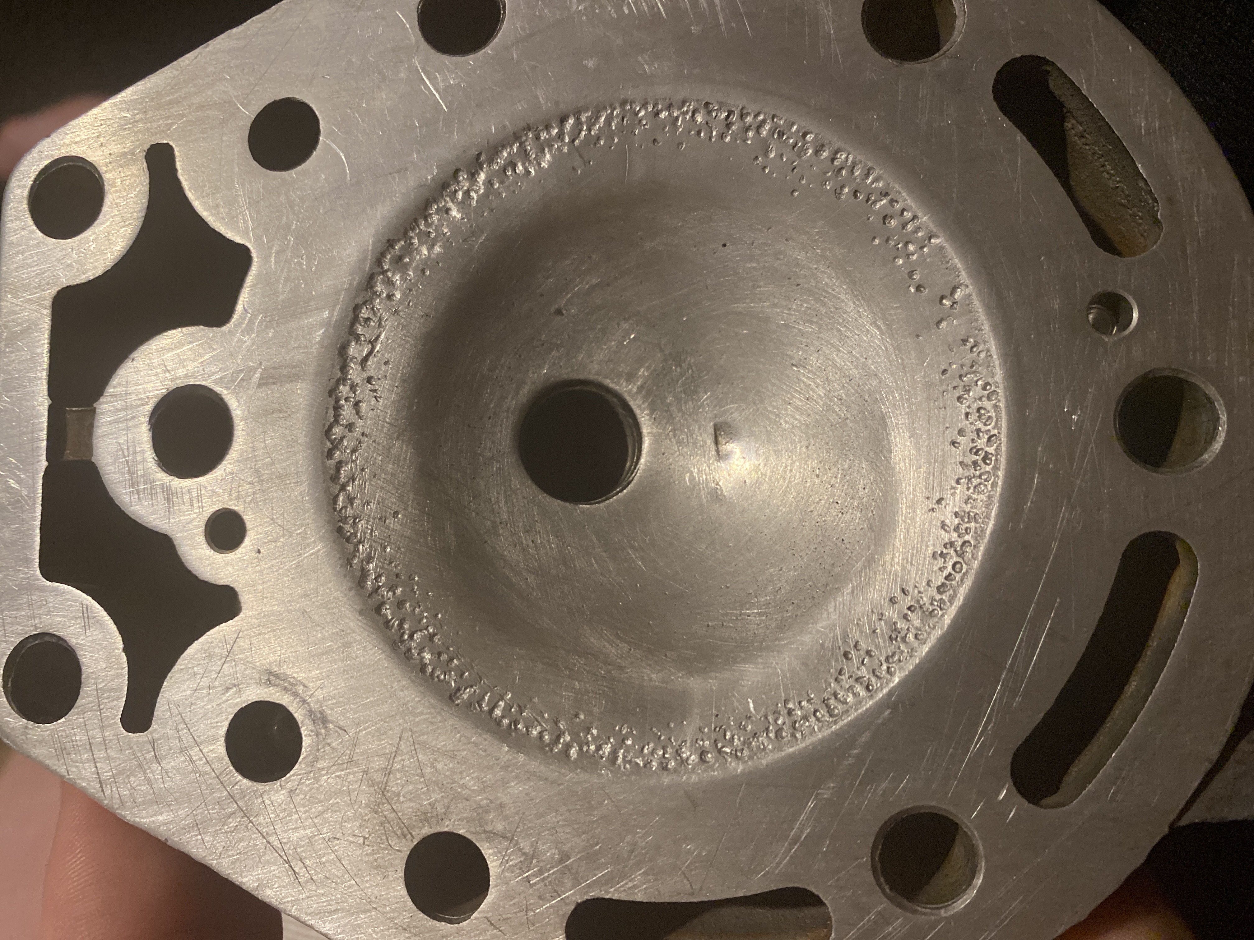

Anybody know what this came from and can I ride it like this I smoothed it out a bit but maybe it did that from using the wrong cheap 15 dollar piston I bought I need to smooth it out a lil more but what about the inside

the mechanical damage is caused by detonation ("pre-ignition"). Detonation is the most common 2-stroke engine damage. Your pboto shows a textbook example.
Two things cause it and you can have one or both.
1) Fuel octane (too low)
2) Compression (too high)
No, you cannot run an engine with that head the way it is. More mechanical damage will occur and at an increasing rate. Do it long enough and, "boom!" You can destroy top end, bottom end, and even crankcase. This is not theoretical or exaggeration. It's 1st-hand information obtained through road racing.
There are two solutions and additional note.
1) Use higher octane fuel (without ethanol)
2) Decrease compression (fatter head gasket or non-milled head)
Note: Make sure correct spark plug range is used.

It wasn’t too much compression bc it was a bad head gasket and also I used 87 and had this bike for about 3 years now it barley happened this last time after I put a cheap piston in it and I think it wasn’t meant to even go in my bike but also I don’t like my water pump was working either bc the radiator is bad so I’m replacing everything now especially the bottom end

That head is toast and cannot be reused. Well, technically, it could be saved but that involves welding and then reshaping the chamber which the cost is just not worth it.
Now, it might not be because of the piston itself but rather possibly an air leak(s) after doing the top end. A leak down test is always a good idea after doing a top end.
Also, I freakin don't care what anyone says but I'll only run 91 octane or above in any bike I own. It's worth that little bit more in cost as extra insurance against detonation damage like you have.

All those cavities are the pennies you saved by not buying premium. If you get it rebuilt, use premium.
