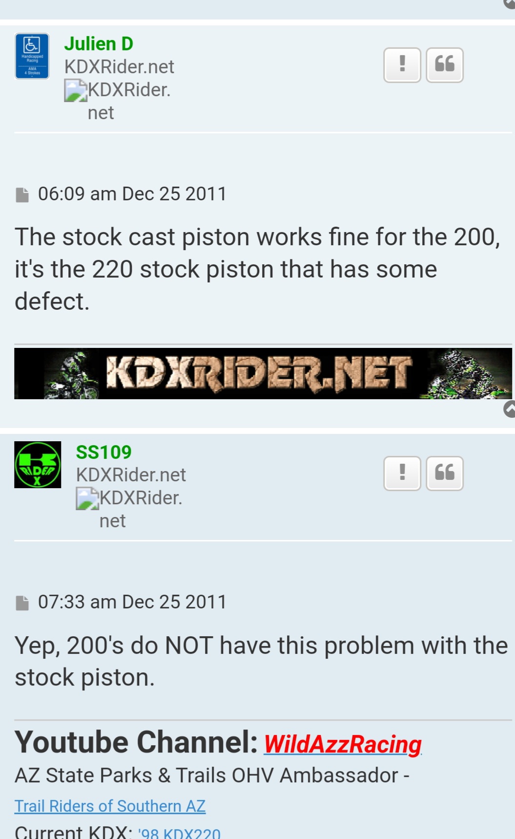

Spruce & Jimmy, two forum "authorities" clearly indicated in 2011 that KDX 200 cast piston is okay. I'm pasting a screenshot of their back-to-back posts herein.
Screenshot_20240824_154503_Free Adblocker Browser.jpg (259.24 KiB) Viewed 21783 times

billie_morini wrote: 05:52 pm Aug 24 2024 Spruce & Jimmy, two forum "authorities" clearly indicated in 2011 that KDX 200 cast piston is okay. I'm pasting a screenshot of their back-to-back posts herein. Screenshot_20240824_154503_Free Adblocker Browser.jpg
I've heard that as well, but only for the 220. I figured I'm just going to return the rings and buy a Wiseco piston.
Figured I'm already pretty deep into this bike money-wise, whats a little more, yknow?

Just KDX220R with piston concerns
