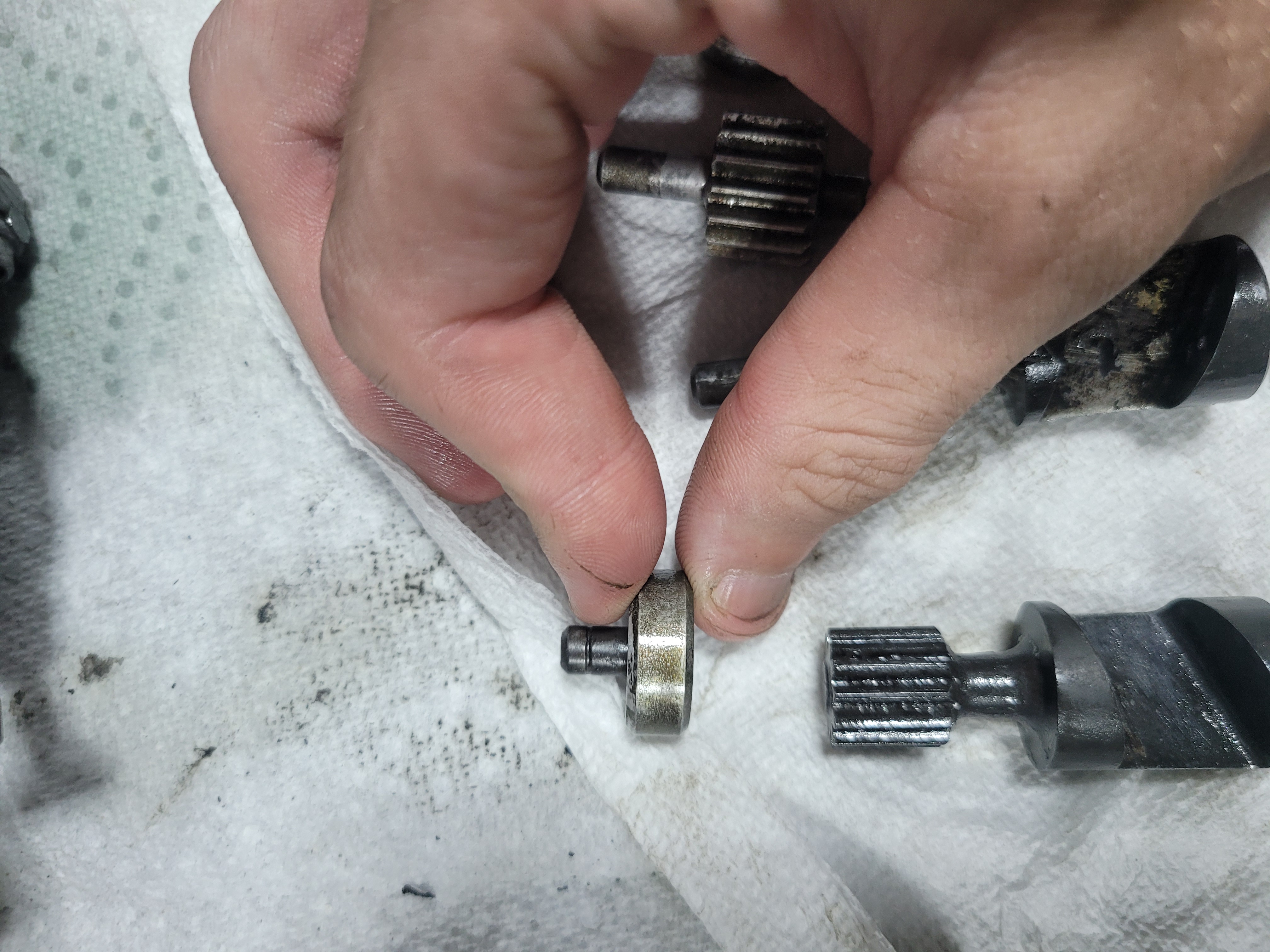

Hi, all. Sorry for another post, I'm still trying to learn about these bikes. I finally have my kips valves clean and I noticed online everyone has a rod sticking out of the top of both power valves, and mine does too, except the one is not attatched to the power valve, it is seperate. I know that probably is a terrible explanation, but the pictures are below.
When I took it apart they were like this, and as far as I could tell the valves were opening and closing properly. I never actually looked up the exhaust, but the lever on the side was going in and out when it was revving up. Is this how that is supposed to be? Or do I need to buy a new powervalve? I hope not, but if I have to I suppose I will.

- the top rod is seperated (broken?)
- 1722550721382879017970075521129.jpg (3.04 MiB) Viewed 15046 times
Re: Possible broken part off of KIPS power valve (92 KDX200E
It is broken.

You can mix them up, just keep in mind the aluminum one will likely fail before the used steel one. Normally they break between the gear and the valve, don't see many of them fail that way. It was still working as that part on top that broke off is basically the guide pin in the bearing block that it fits through.

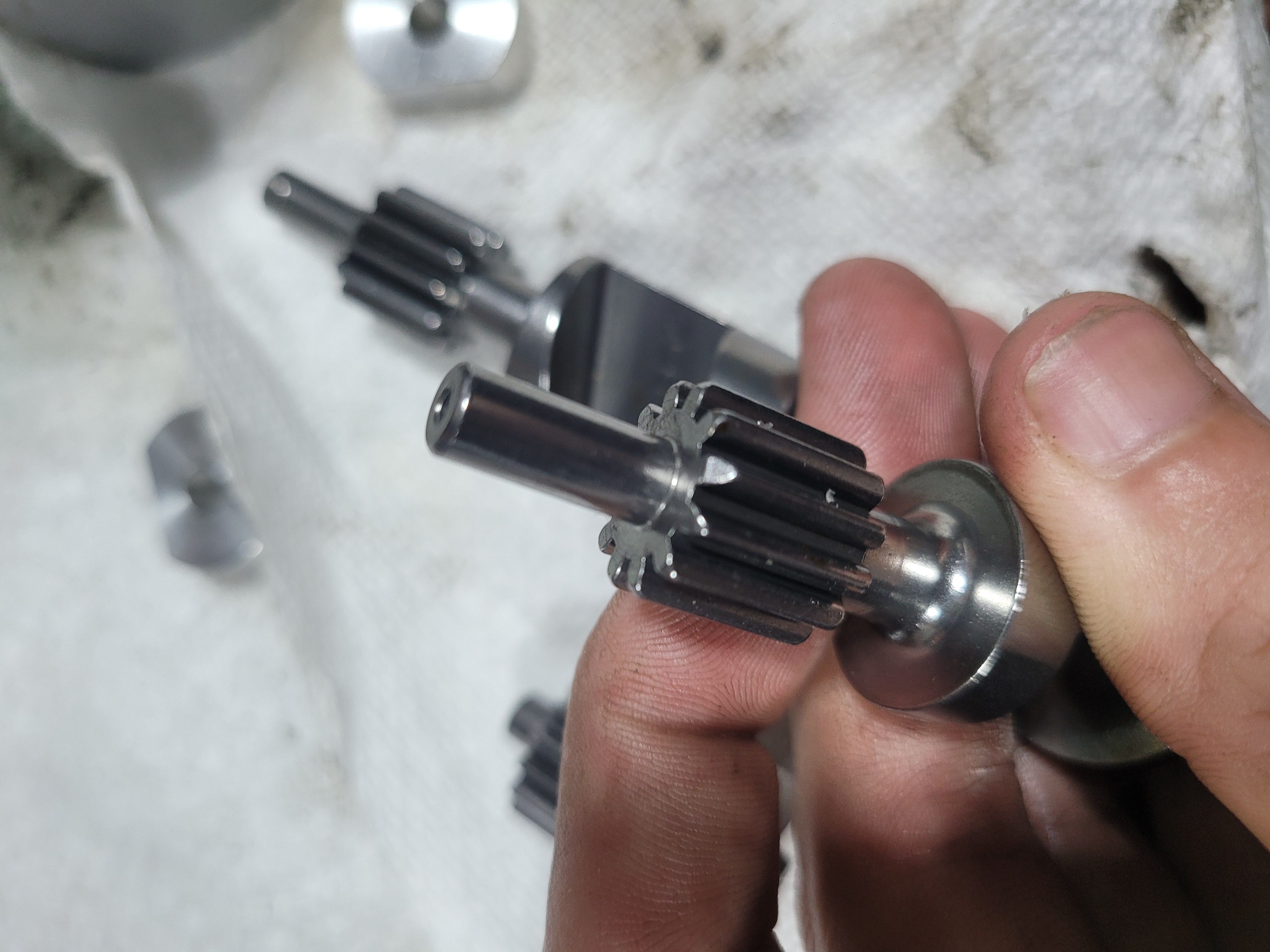

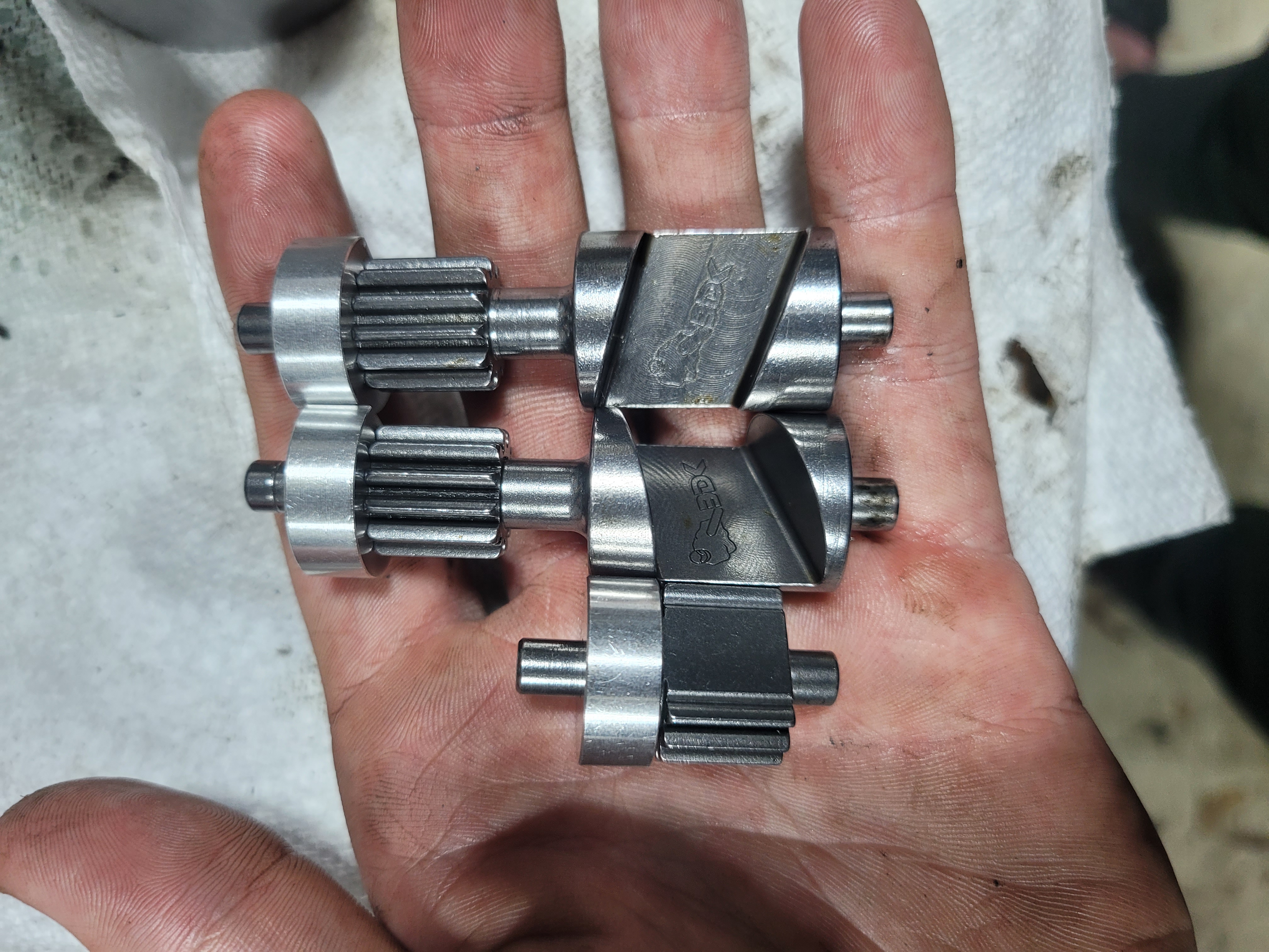

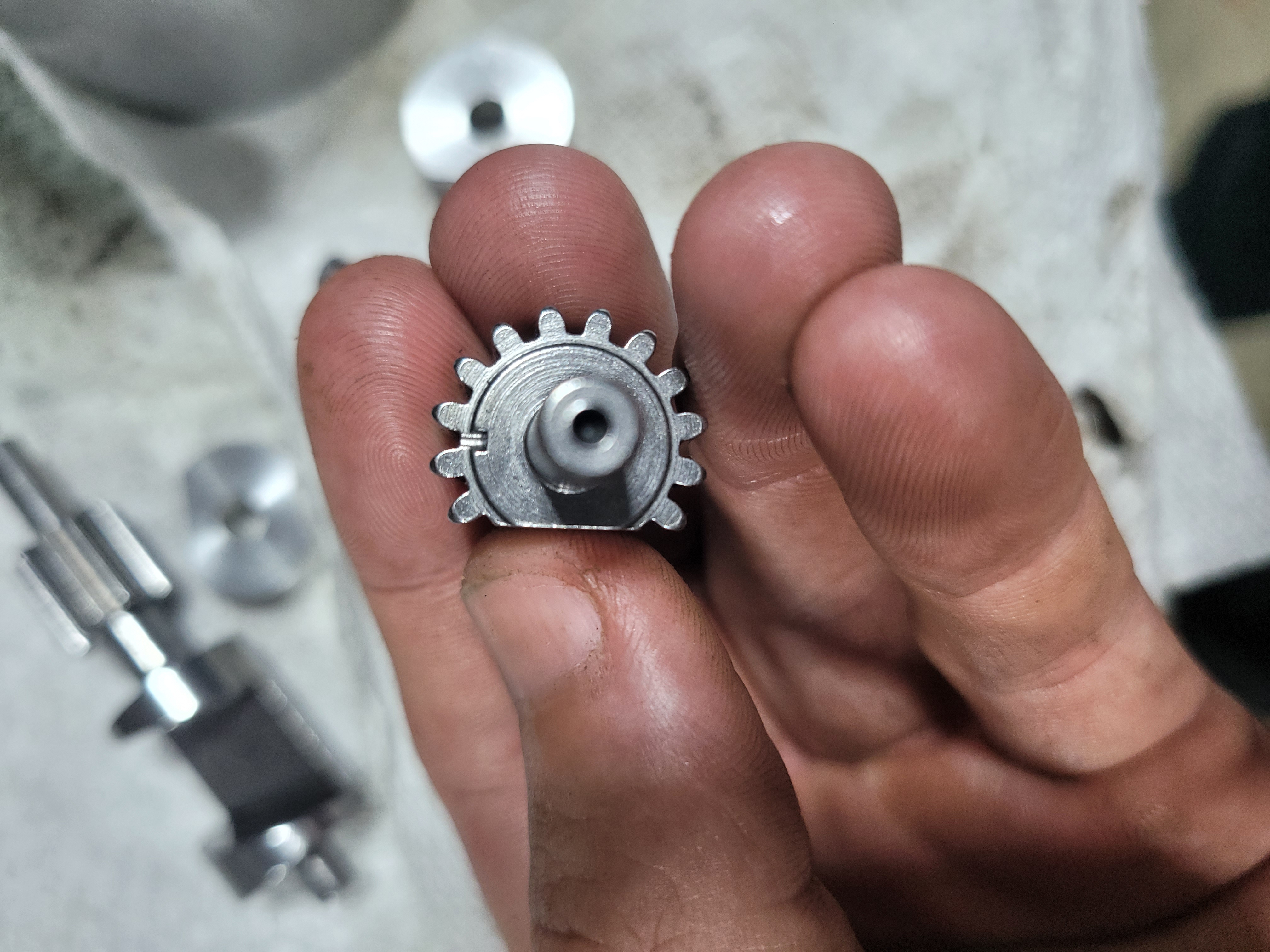

The valves seem to be very well machined. The only thing that is different between the OEM valves and these (other than being steel) are the timing marks, which are noted by a little smoothed edge on one of the teeth of the gear, and in the idler gear it is noted a tad differently.KDXGarage wrote: 05:45 am Aug 07 2024 Post some pics for us of the parts. It is really great they make them still!
Other than that they are the exact same as far as I can tell. They look great. If there is anything else you guys want me to post I will! I will also post once I get them timed in the cylinder.
DAMN! That is some solid steel sex appeal! Thanks for the pictures. They look terrific!

Spruce, many thanks for your photos & notes for these mew parts. The parts look fantastic!
