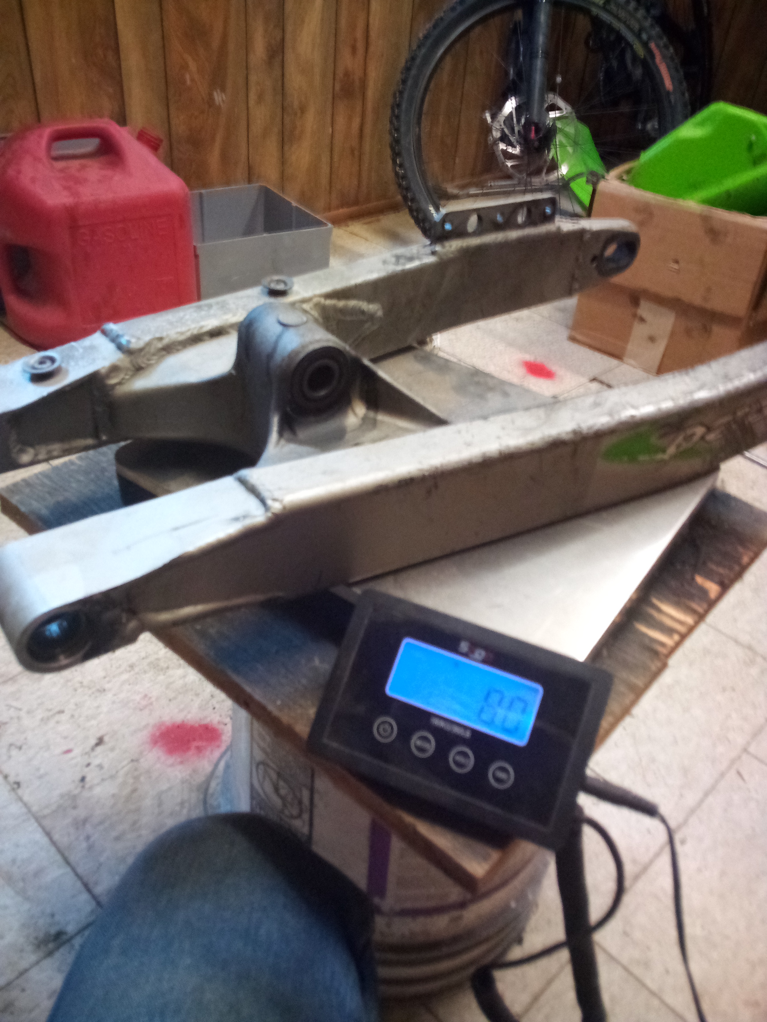

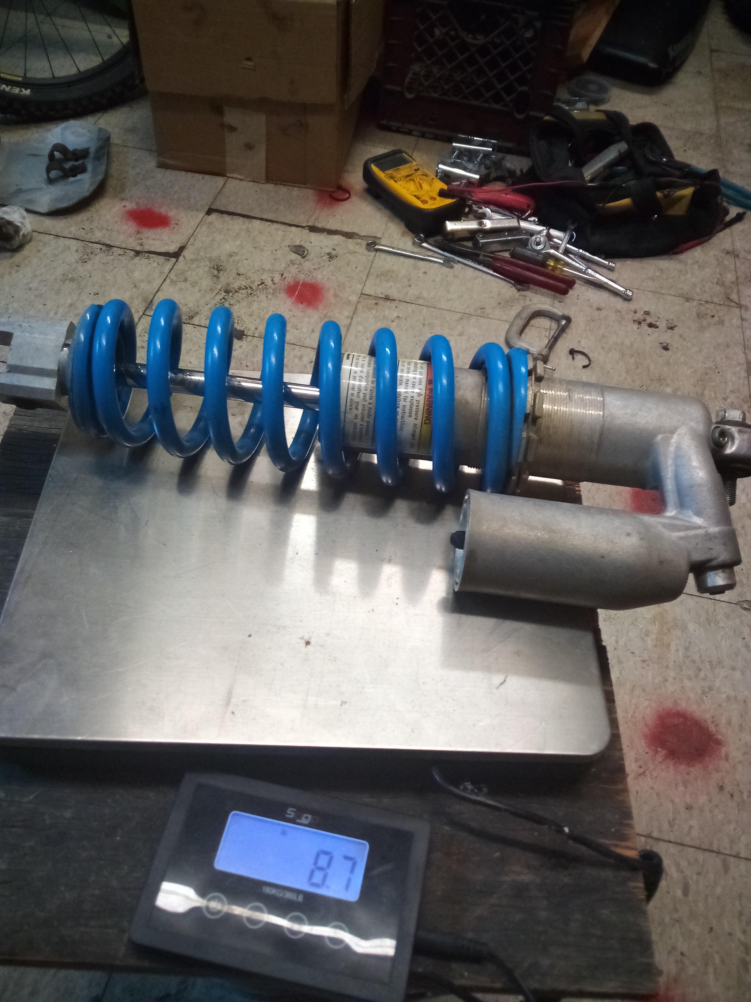

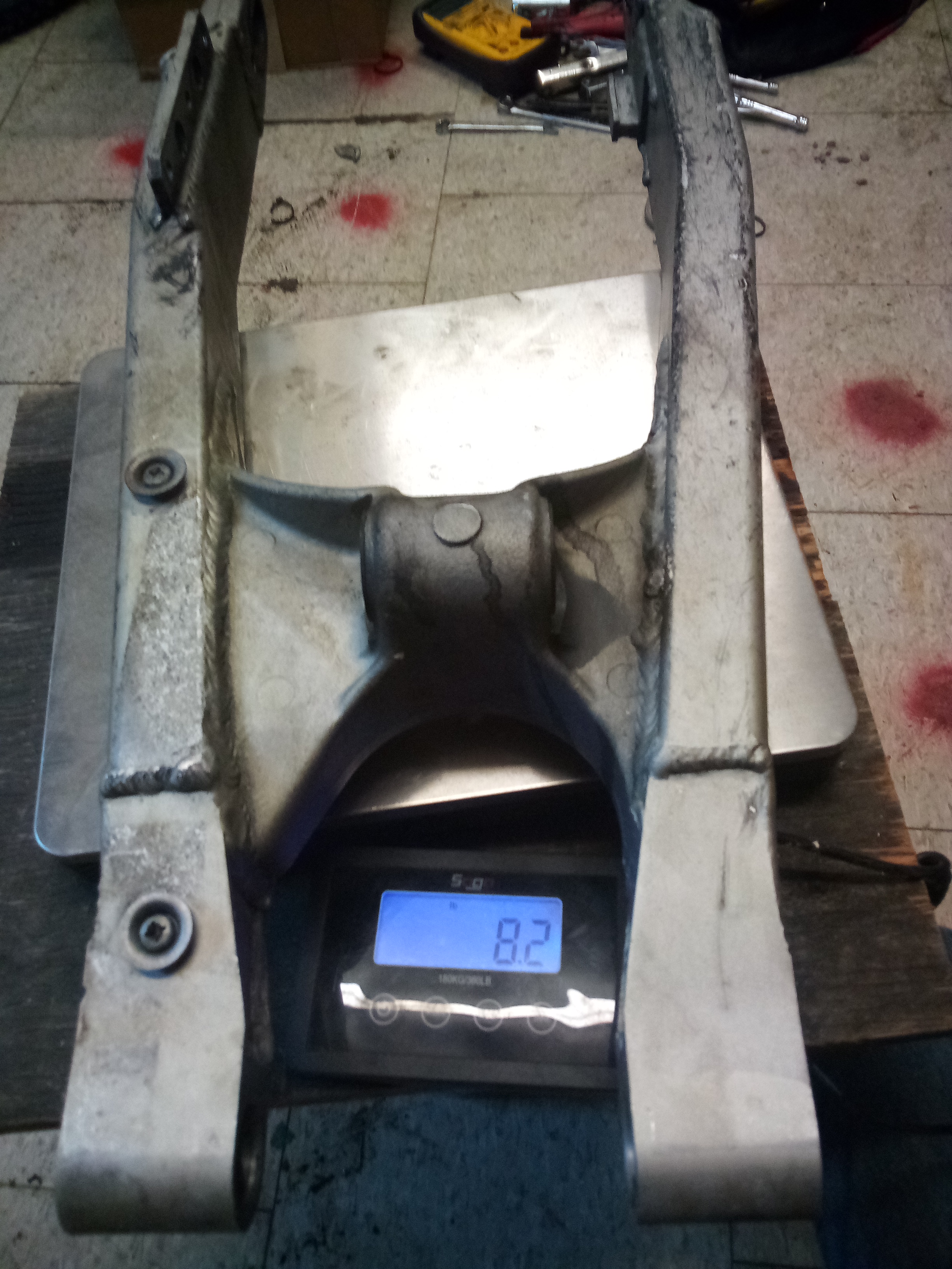

- RearFenderAssembly.jpg (2.12 MiB) Viewed 13374 times

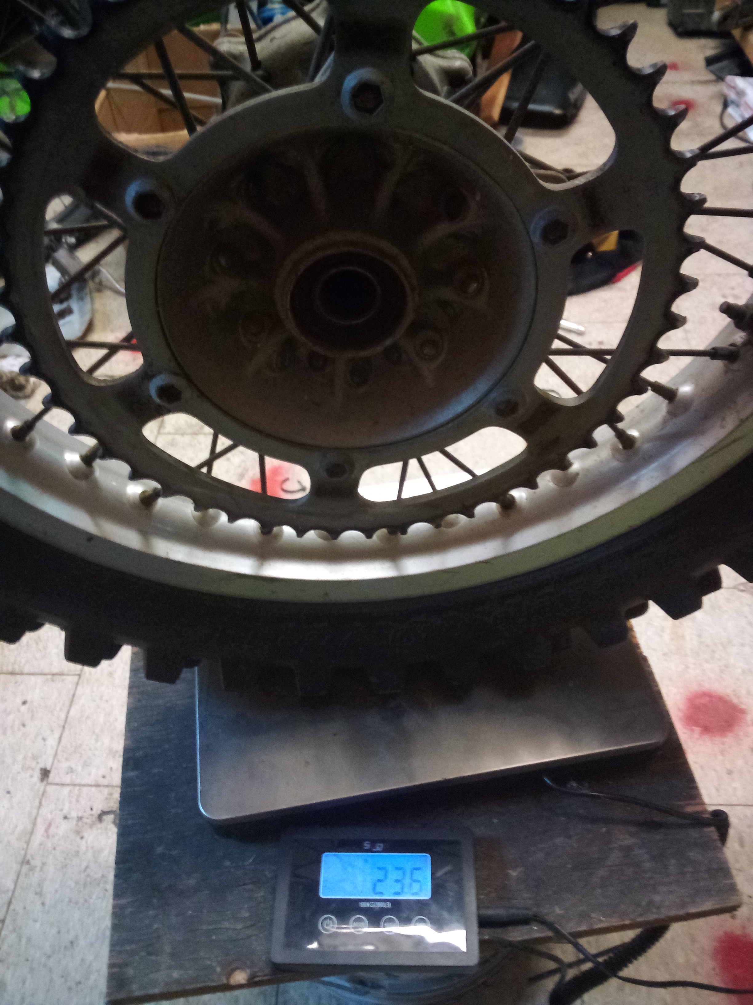

- RearWheelTireSprocket.jpg (2.24 MiB) Viewed 13374 times
- ShockwithSpring.jpg (2.17 MiB) Viewed 13374 times
- Swingarm.jpg (2.2 MiB) Viewed 13374 times
- Swingarm2.jpg (2.09 MiB) Viewed 13374 times

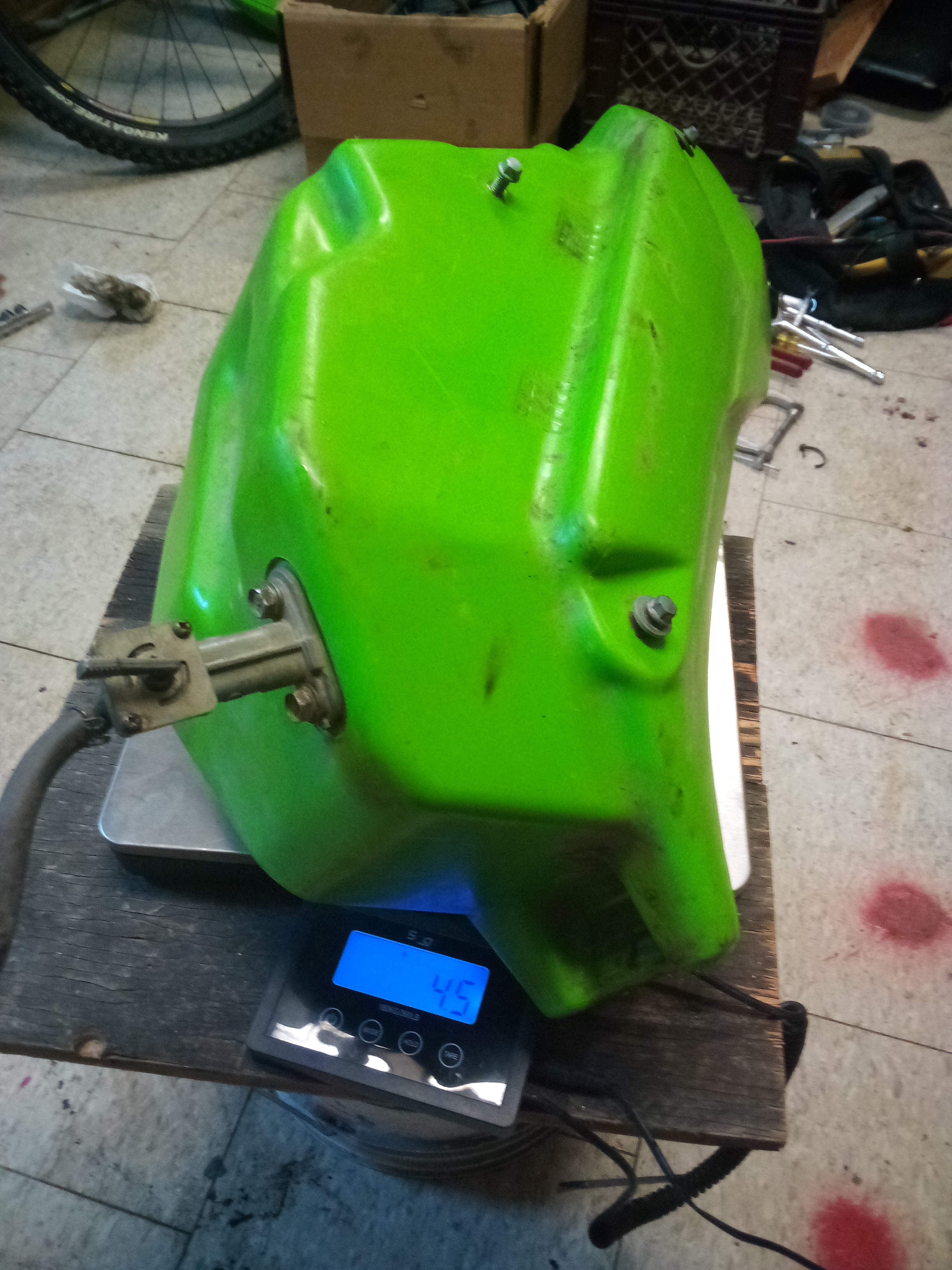

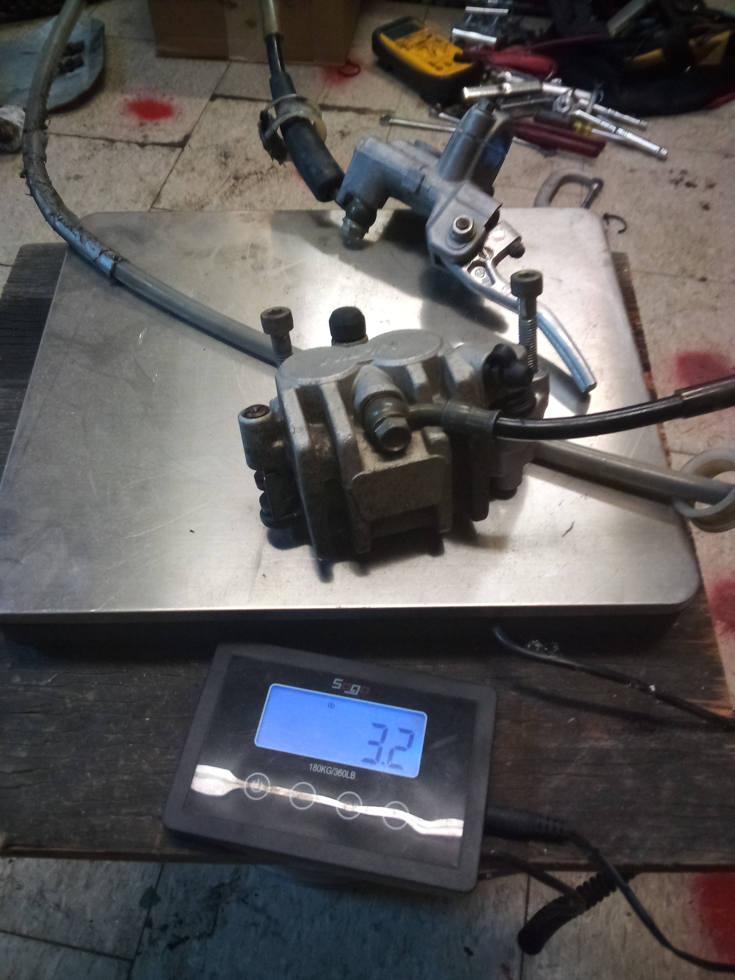

- FrontBrakeAssembly-hose-lever.jpg (2.13 MiB) Viewed 13373 times

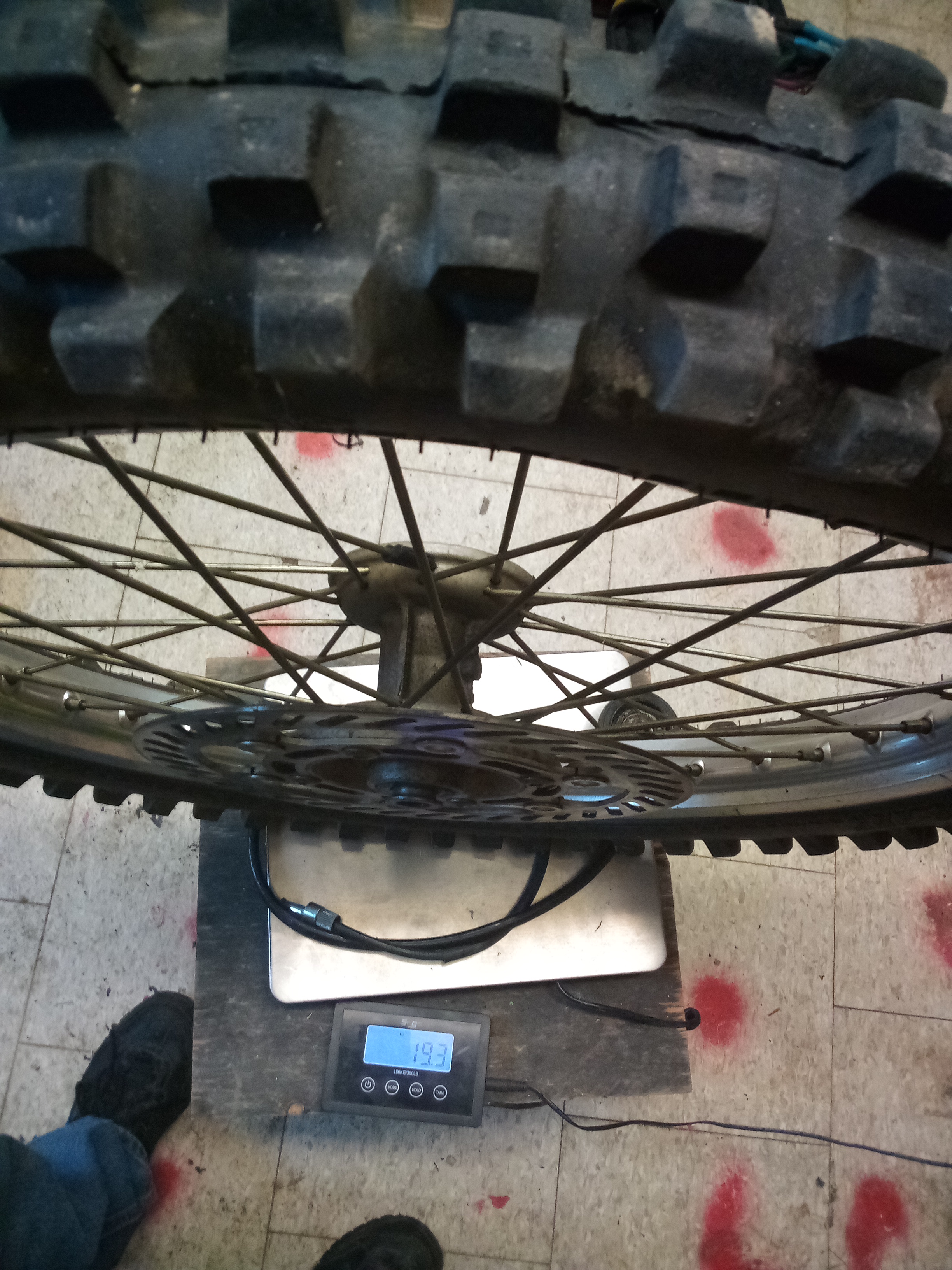

- FrontWheelwithTireTube.jpg (2.29 MiB) Viewed 13373 times
- GasTank.jpg (2.19 MiB) Viewed 13373 times
- RearAxel.jpg (1.81 MiB) Viewed 13373 times

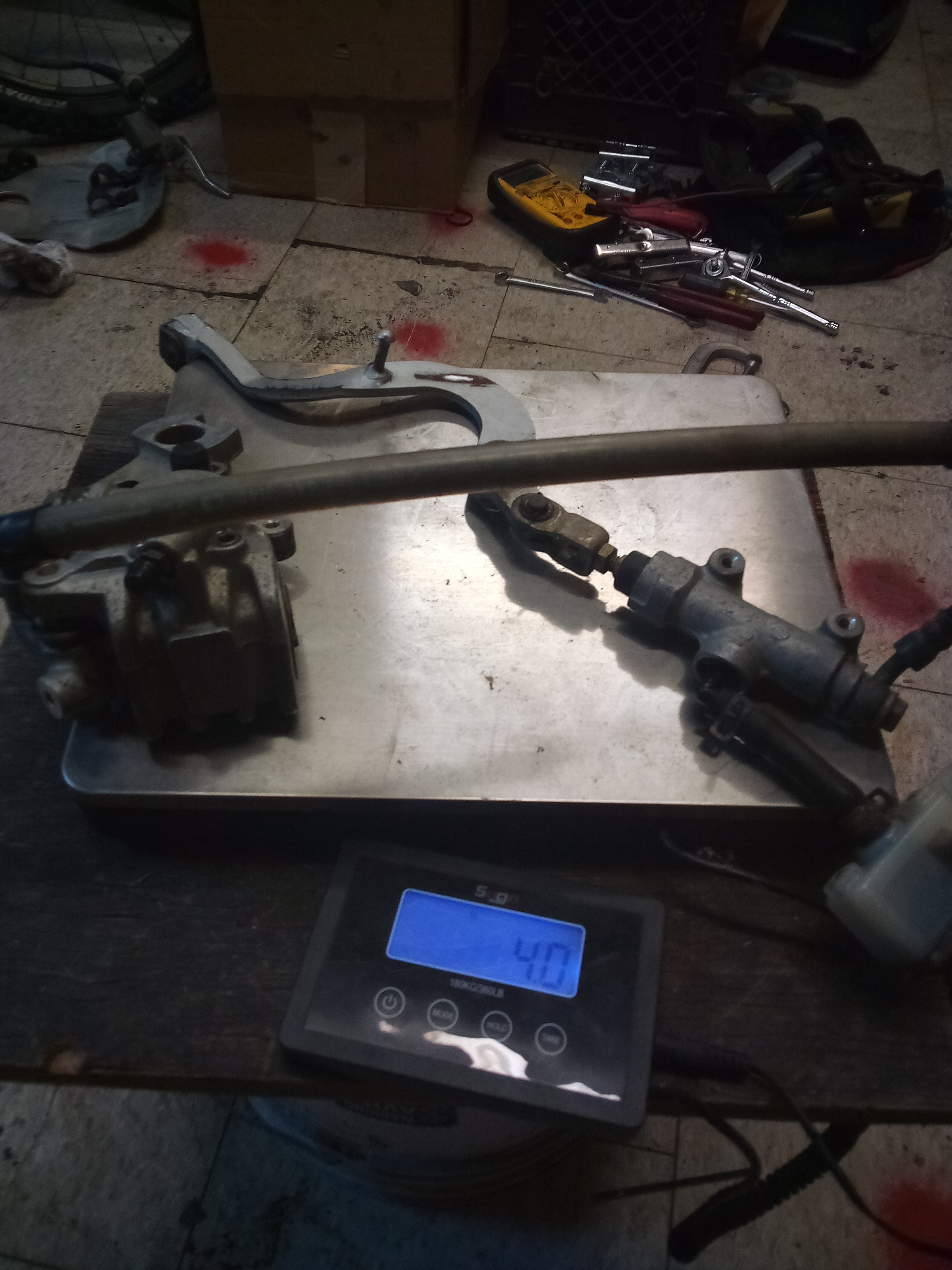

- RearBrakewithHose-Pedal-etc.jpg (1.84 MiB) Viewed 13373 times

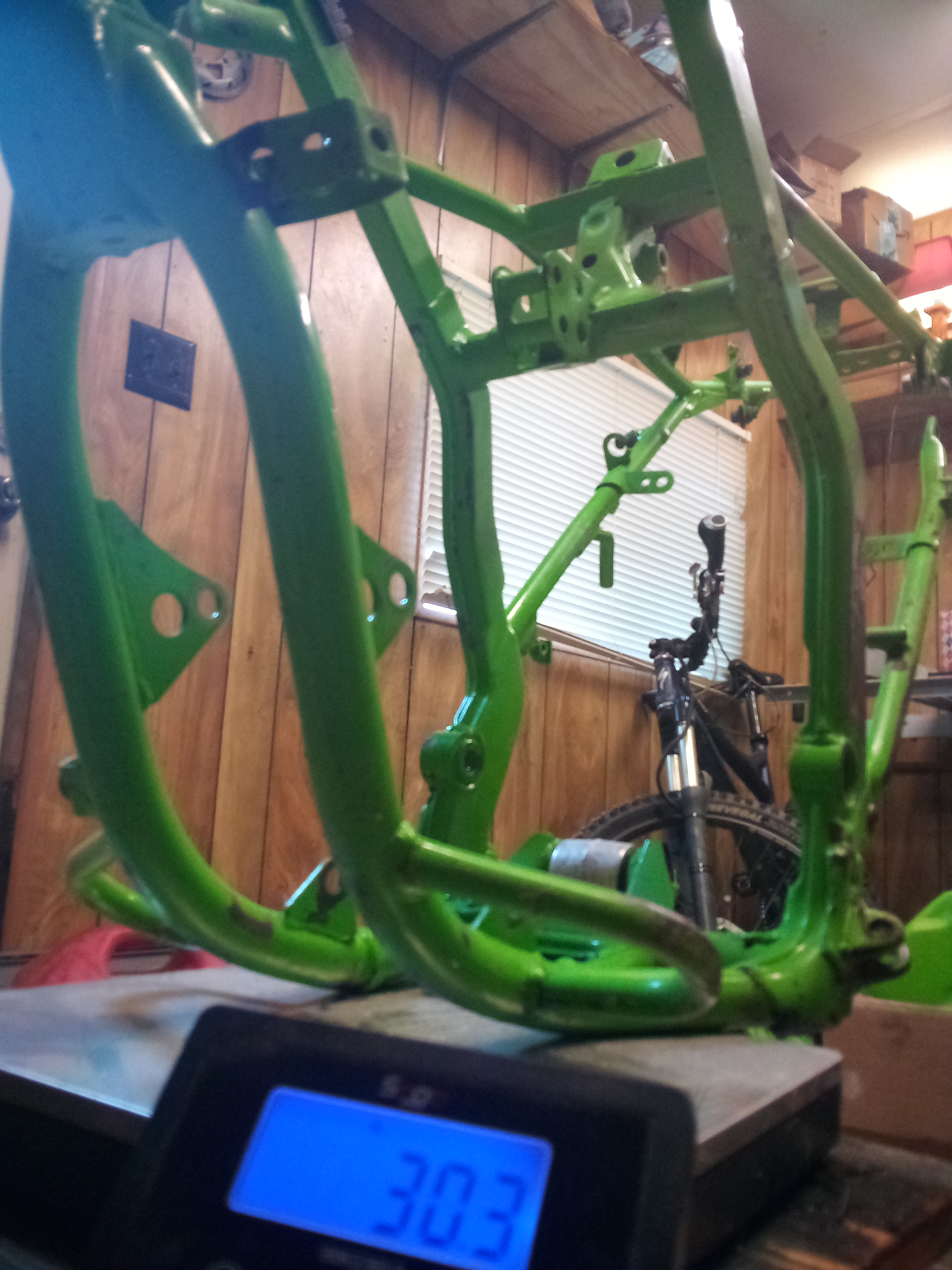

- Frame.jpg (2.26 MiB) Viewed 13373 times

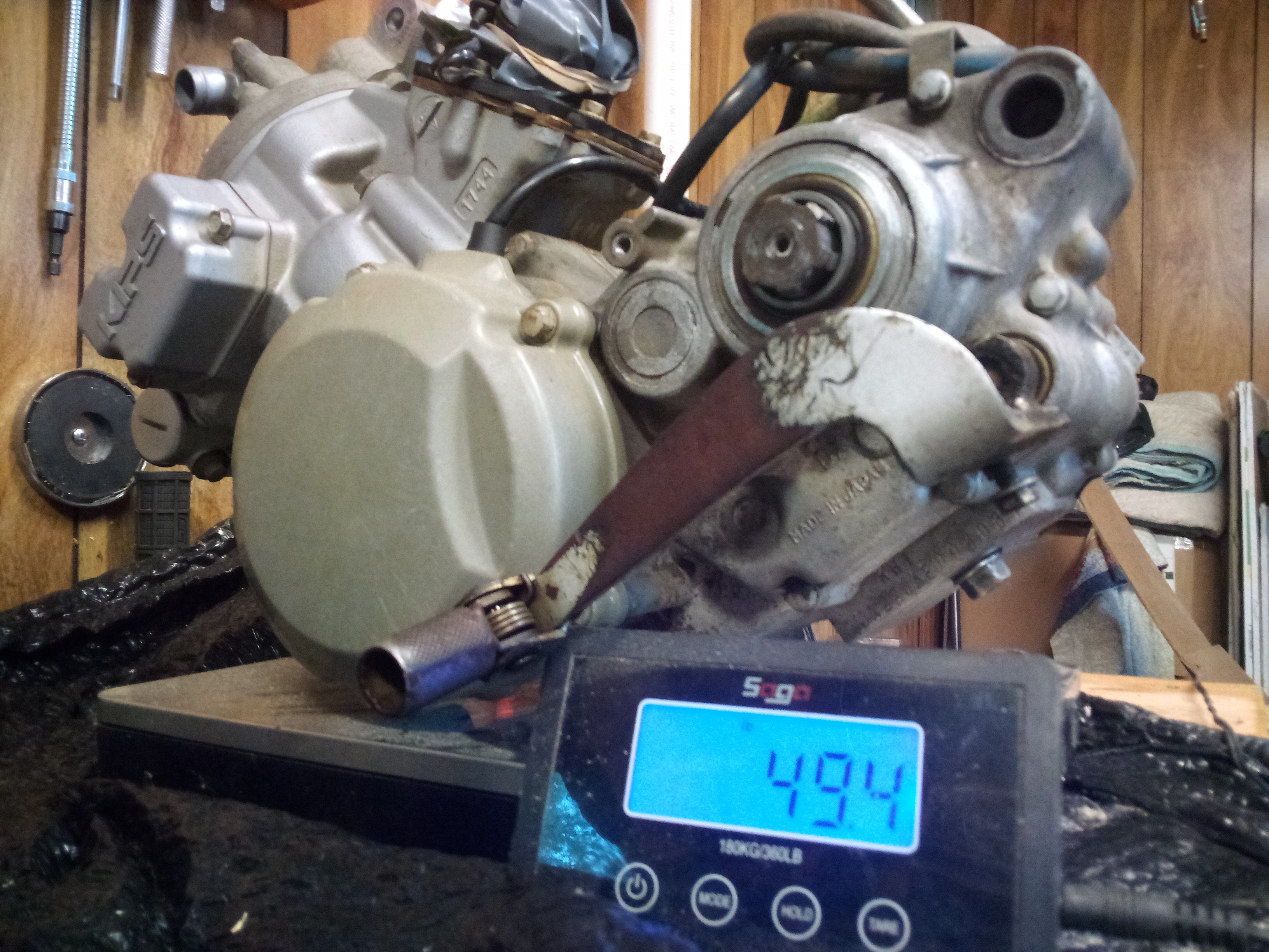

- Engine.jpg (2.53 MiB) Viewed 13373 times

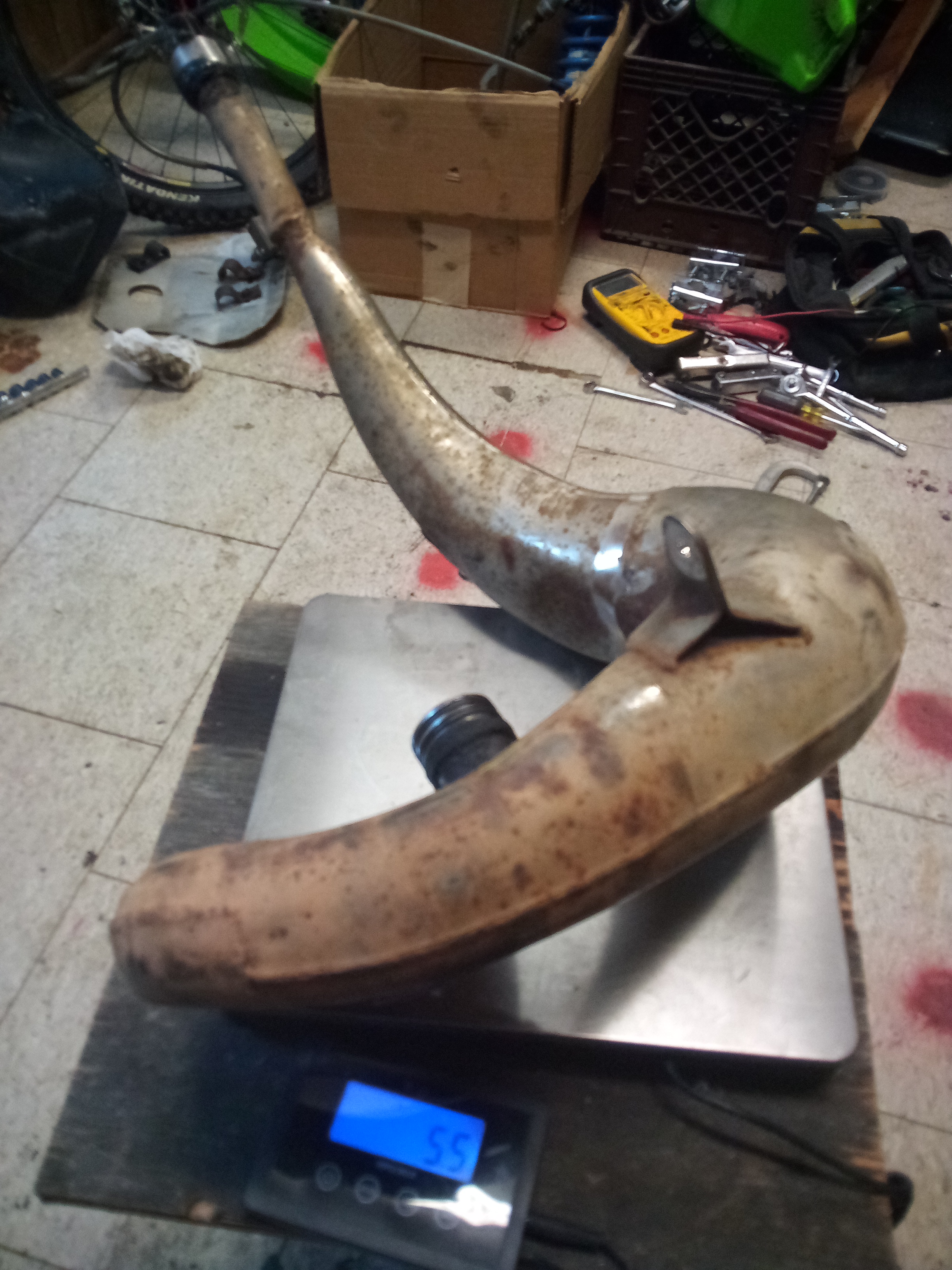

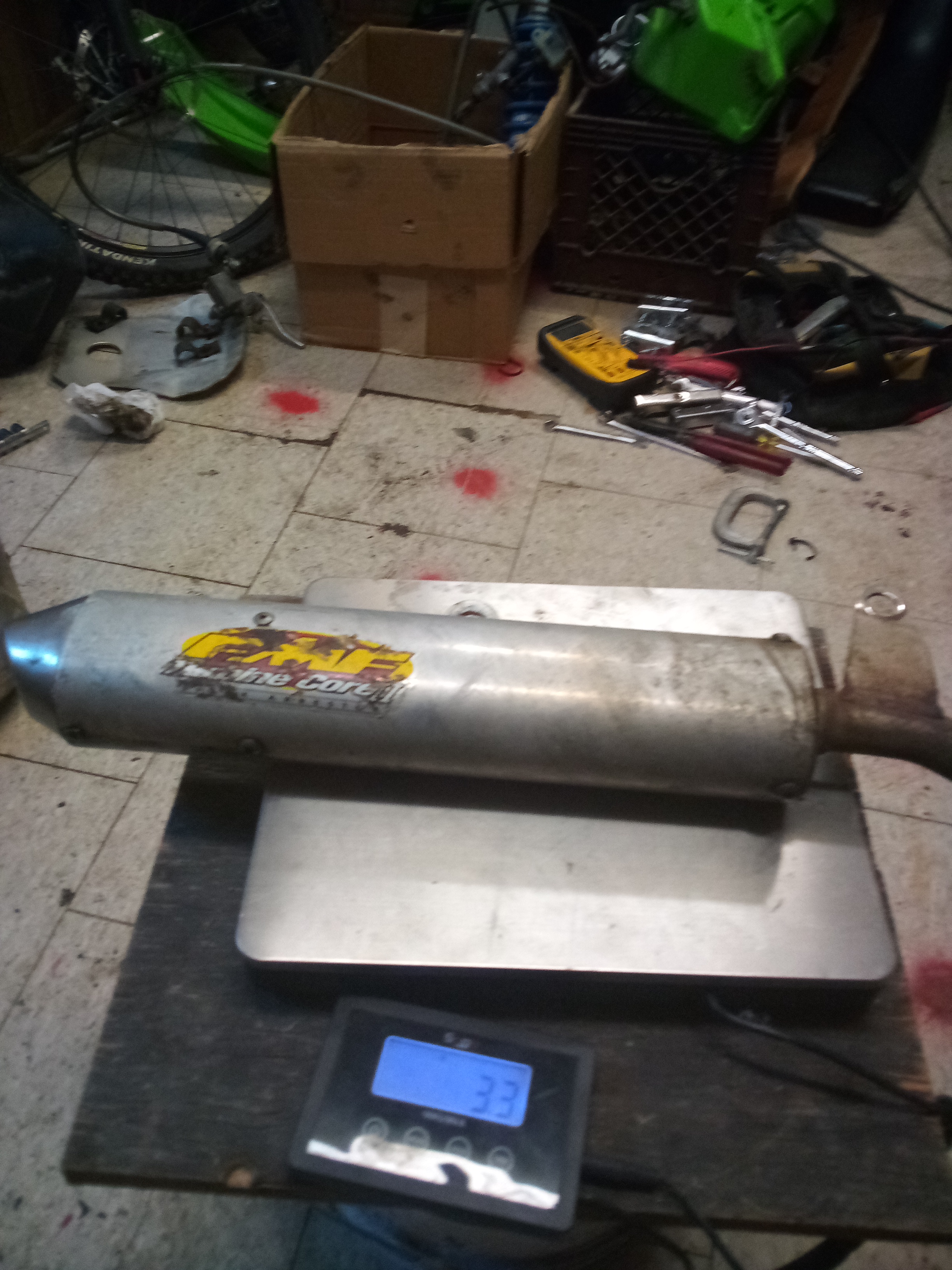

- FMF_fatty-Torque.jpg (2.1 MiB) Viewed 13373 times

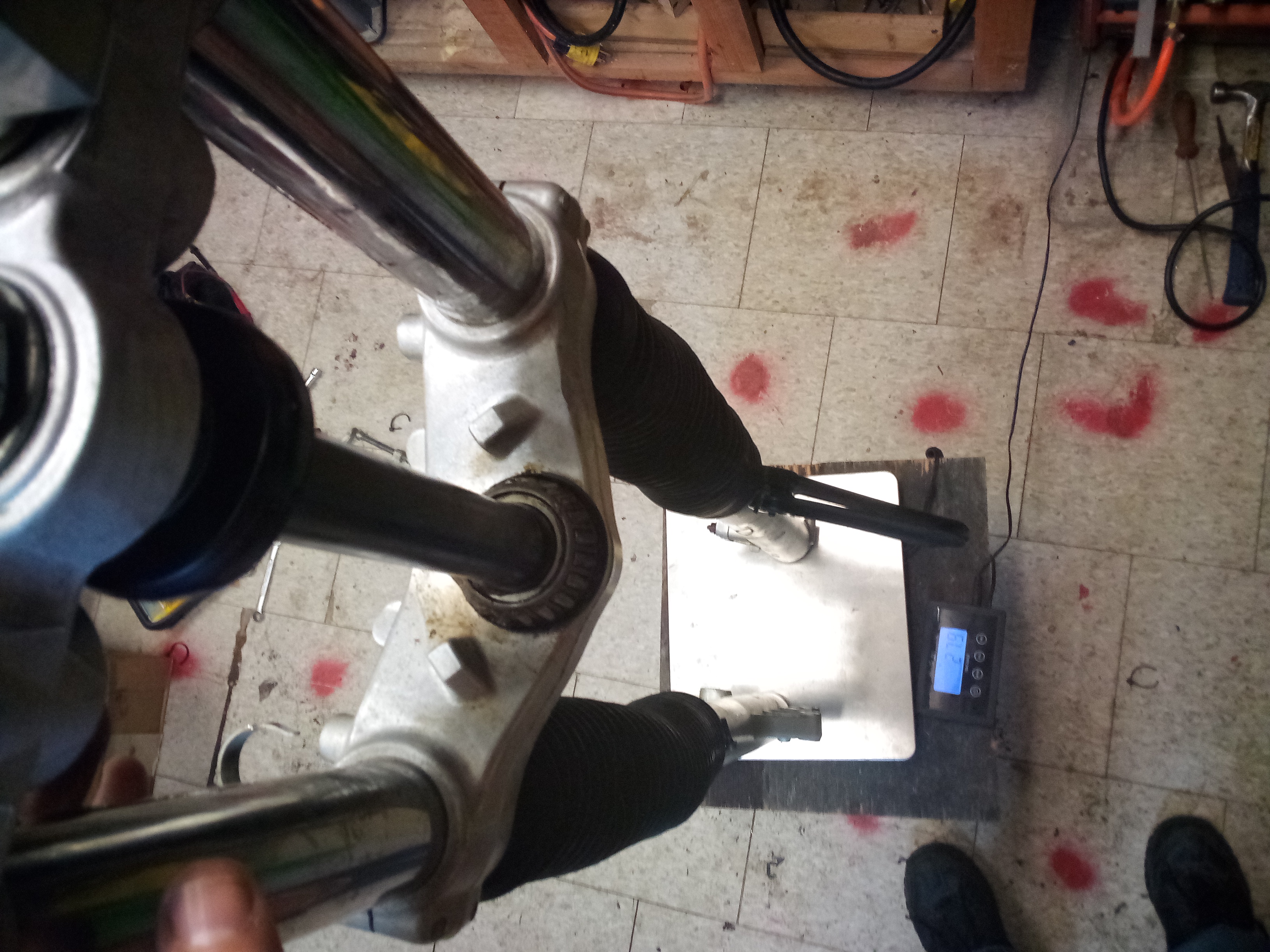

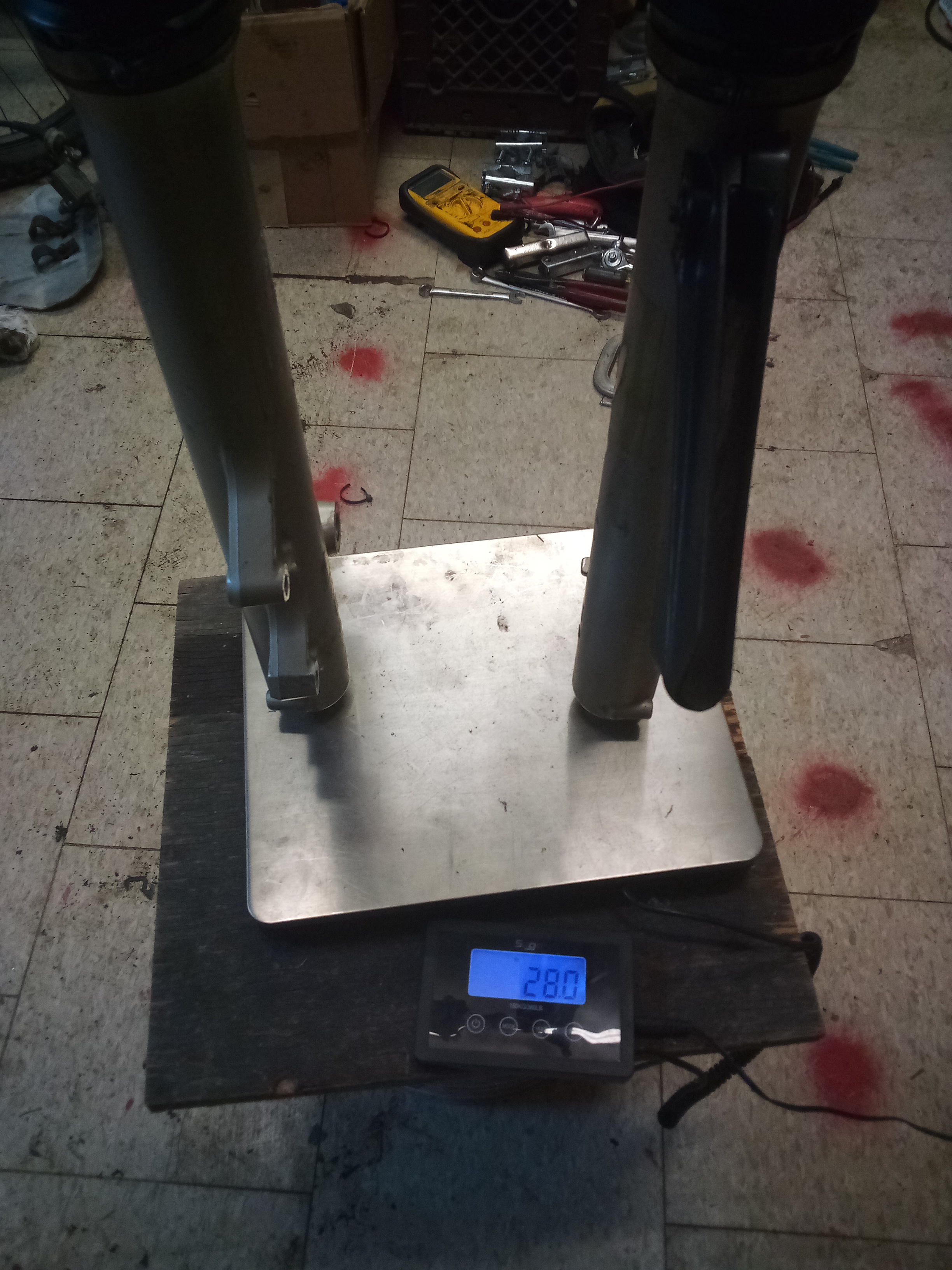

soup-n-sandwich wrote: 08:34 am Jul 21 2024
During the disassembly I weighed each part on a shipping scale which is accurate to 1/2 pound.
One note here is that I purchased 2009 KX450 Kayaba fork and it's 4.8 pounds lighter than the stock fork. Both weighed with triple clamps, hardware and oil.
Wow, 43mm old school 1980's 1st gen design cartridge forks + triples (yes I'm referring to the 1995-2006 forks) weigh 4.8lbs MORE than a taller and much larger diameter tube size modern 48mm closed chamber fork?!?!?
That's AWESOME! THANKS FOR THE COMPARISON!!!
Heck, I might be able to get my KDX to be closer to 17lbs lighter than stock with that info, and I hadn't even considered putting the original forks on the scale. I'd been telling people I was trying to drop 15lbs off my bike to lighten it up and help to compensate for ADDING WEIGHT with skid plate, pipe guard, and a larger diameter taller modern fork swap!
I'd noted that the aluminum VStrom steering stem (same as the RM125 but taller like the KDX's) swapped into the RM125 triples was aluminum and likely quite a bit lighter than the steel KDX stock steering stem...
Out of the Showa Twin Chamber 96-98 RM125 49mm right side up forks, I'd read in reviews that the '98 was lightened up vs the 96-97, so I picked up several pairs of these very desirable woods rider forks, so I'm excited to see the difference. I'll hopefully be stripping down my '99 220 in August for a major rebuild and finally fitting the '98 RM125 forks and modern Showa shocks to it, although I think I may put all the titanium parts I've been acquiring, + some aluminum parts, onto my '97 220 that I've been riding for 4 seasons since retiring the '99 temporarily.
So the stock forks + triples with oil weigh 27.9lbs - 28.0lbs? I see both those weights in two different pictures.

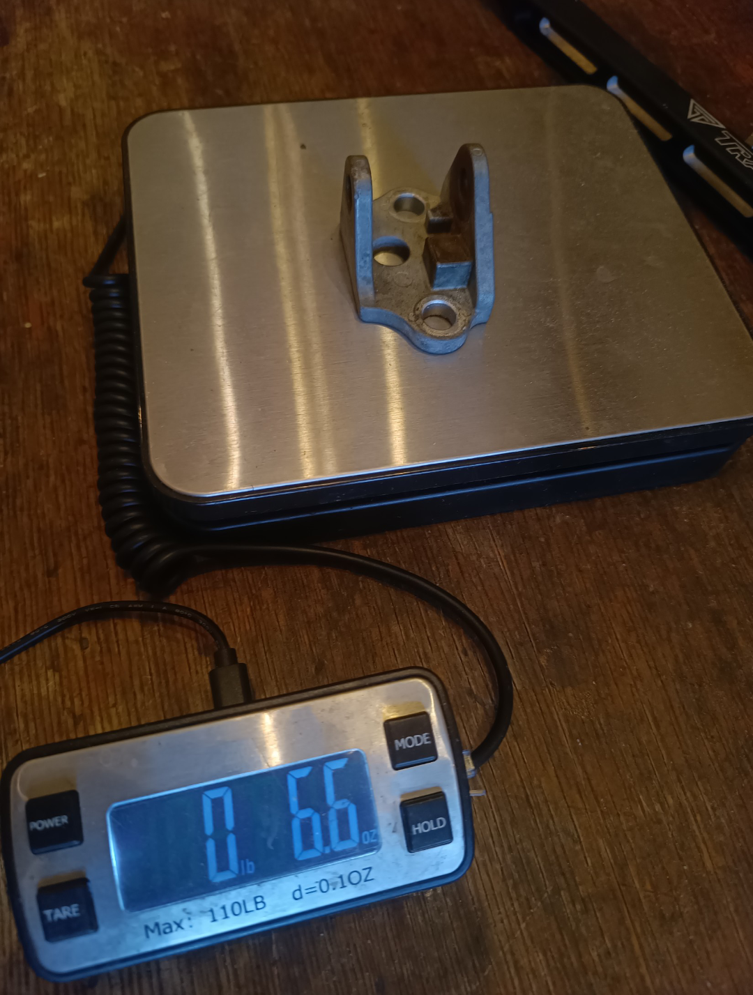

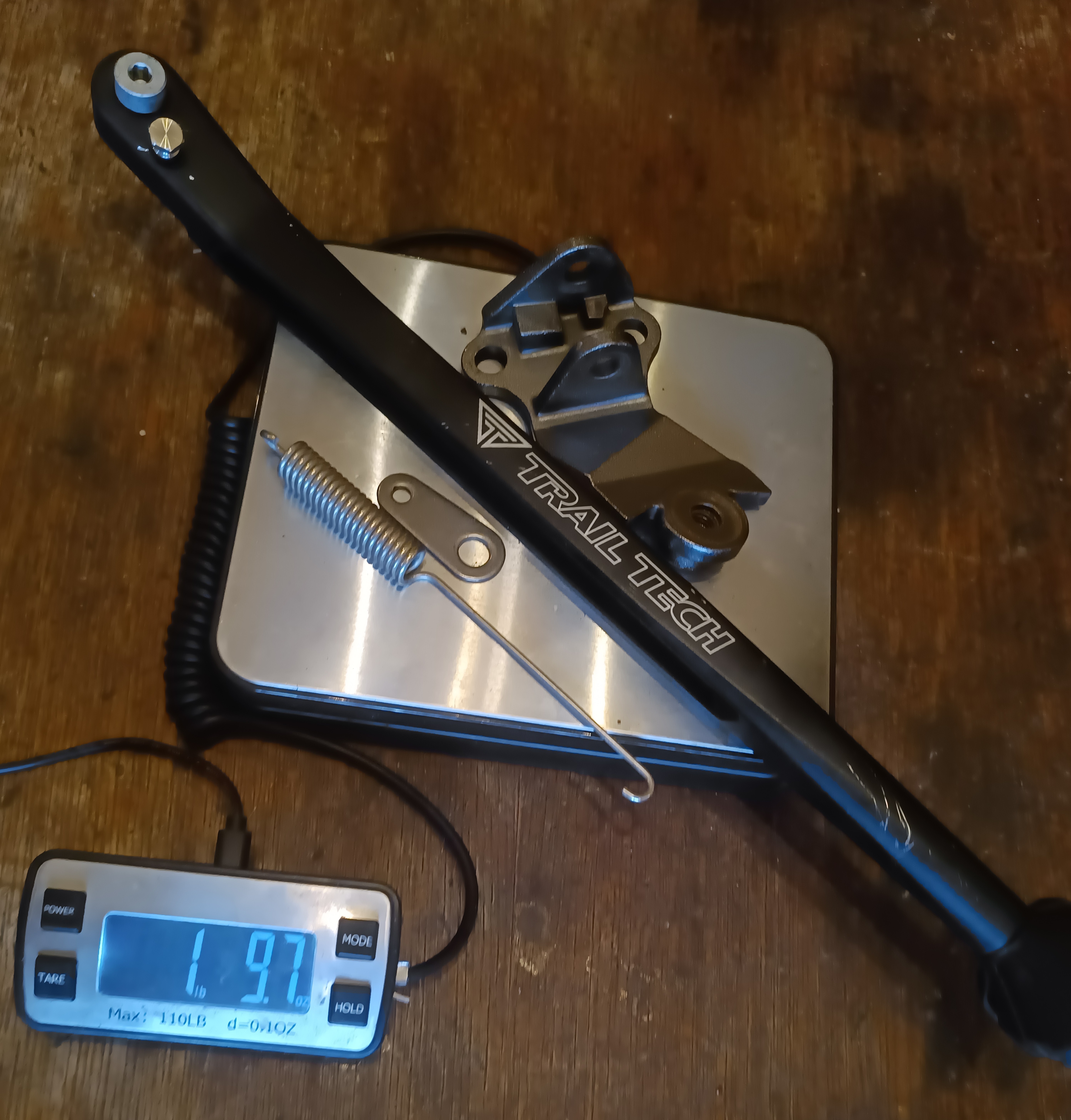

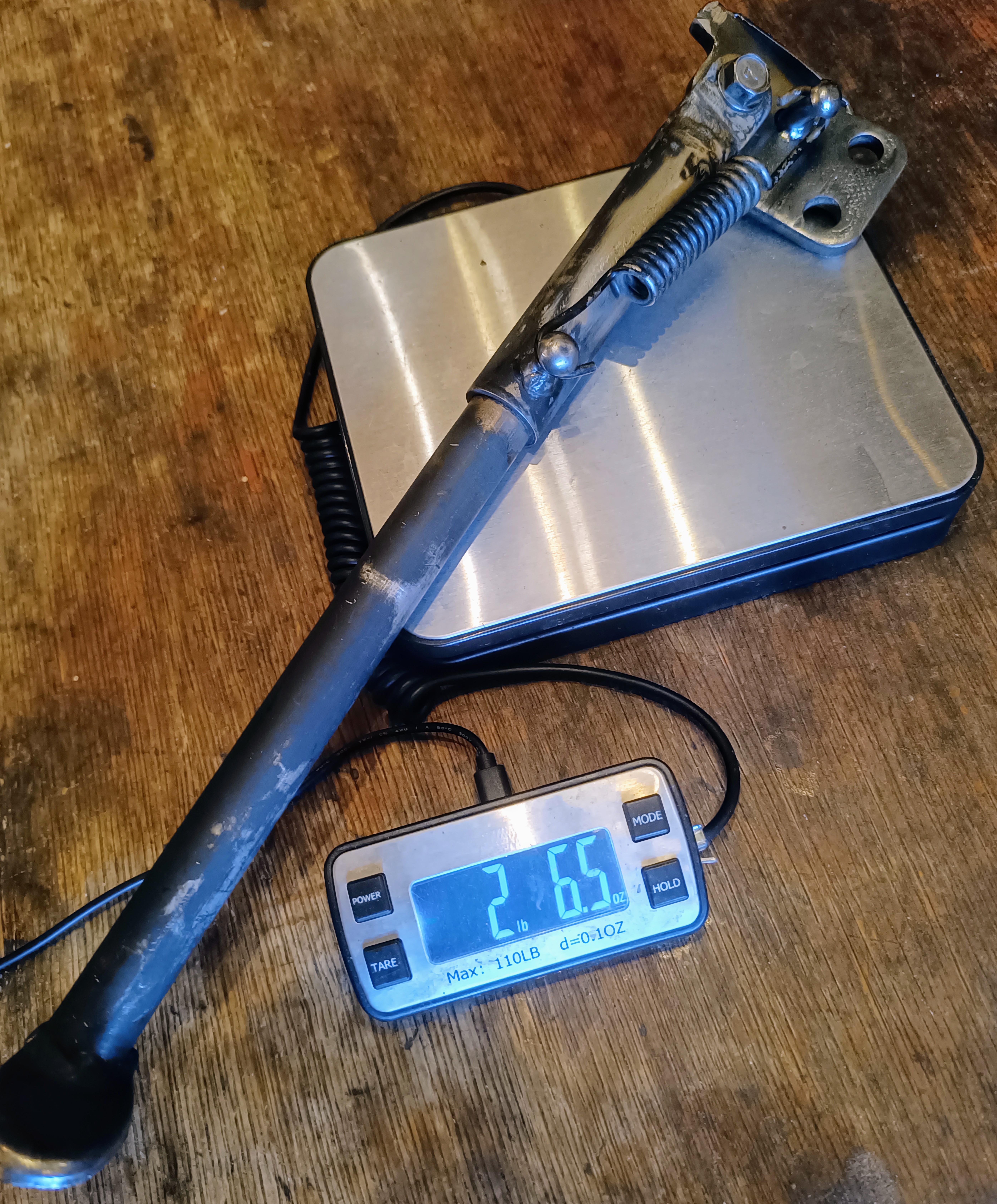

Stock KDX kickstand with mounting bolts:
2lbs 9.2oz (picture on scale iswithout the two large mounting bolts)
Trail Tech billet aluminum kickstand and bracket:
1lbs 4 oz*
*(Trail Tech bracket with integrated footpeg mount for aluminum frame YZ250/YZ250F etc. = 1lbs 9.7oz minus the right side YZ bolt-on footpeg bracket 6.6oz = 1lbs 3.1oz estimated for a steel framed YZ125 2004 & older version Trail Tech bracket)
So the Trail Tech billet kickstand conversion will drop yet another 1lbs 5.2oz off the KDX200/200, while being a MASSIVE upgrade in functionality and liability reduction, as the stocker is NOT an enduro bike kickstand whatsoever, and can snag roots and brush when on it's side sliding down a gnarly steep hillside, making it a BEAR to retrieve one's bike after a get-off...
I may convert my KDX frame to have welded in sleeves to mount Yamaha aluminum frame YZ footpeg mounts, in which case they make Titanium versions of these to shed more weight... Although the Trail Tech YZ aluminum frame footpeg + kickstand mount combination bracket would make things incredibly easy! I may just use that YZ A.F. bracket and chop it up and weld it to the KDX frame like the stock factory KDX220R kickstand mounts on, a design the off-road models would have been significantly better off with...
The fork weight reductions really surprised me on the mid-2000's and up modern 47mm-48mm-49mm forks weighing the same as the KLX300 inverted 43mm forks and presumably about the same as the '91-'95 KX125/250 43mm forks... I may now keep my hoards of 49mm Showa Twin Chamber right side up '98 RM125 forks just for one of my two KDX220's and run a 2008+ CRF250X or 2006+ YZ250 2-stroke triple clamp set and some 2009-2010 KX250F Showa 47mm Twin Chamber forks or 2008+ CRF250X 47mm Showa Twin Chamber forks on the bike that ends up with the extensive amount of titanium hardware on it... I'm fairly certain that this iteration of my KDX will really feel close in perceived weight to the modern center spine frame woods bikes... while retaining the awesome woods bike geometry of the KDX's (& the '94-'02 KX125 which is very similar with 0.5 degree steeper steering 26 vs 26.5* and more ground clearance on the KX125, with only a hair longer swingarm '97-'02 KX125 which is perfect if you do steeper technical slow hill climbs).

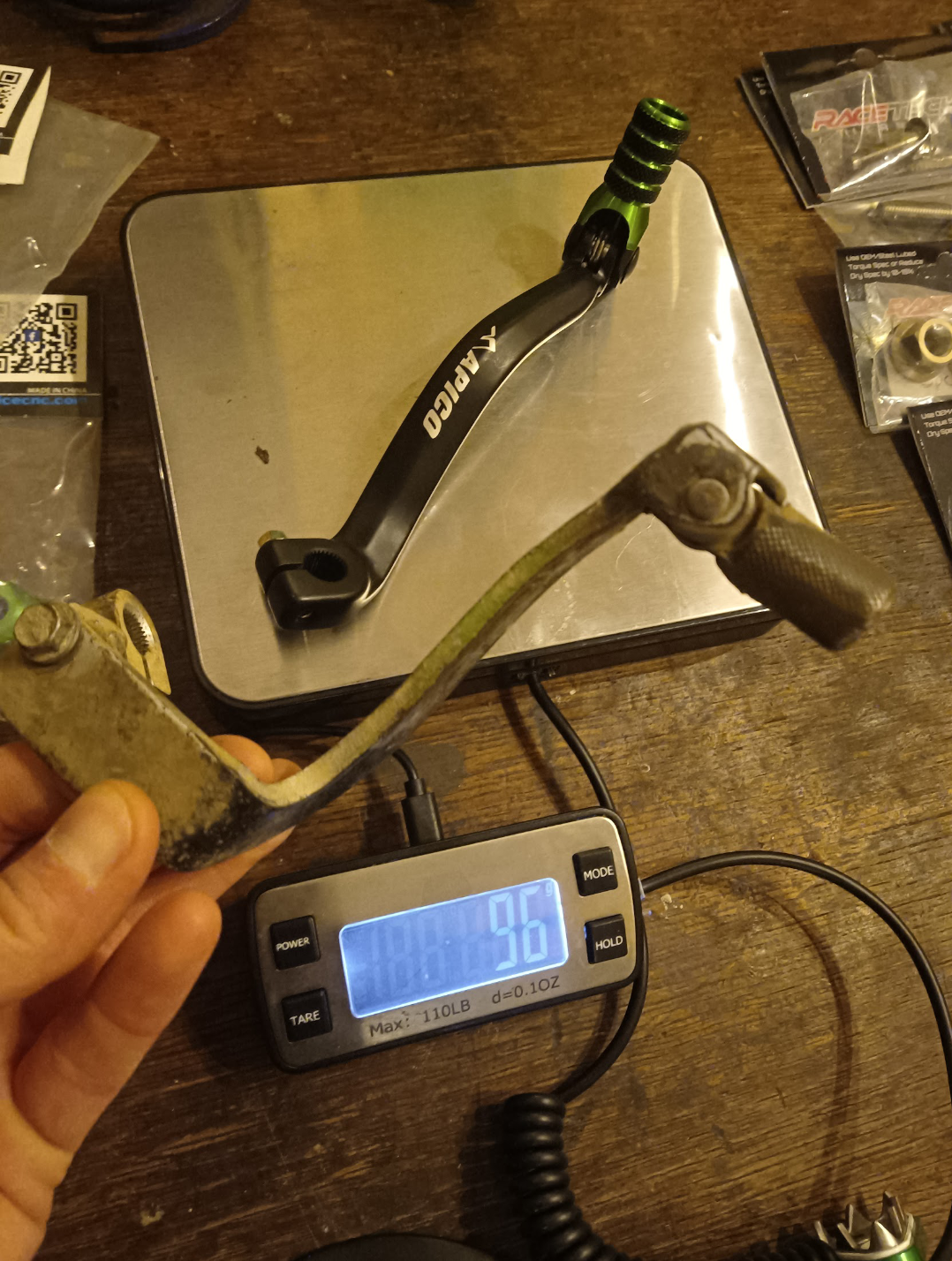

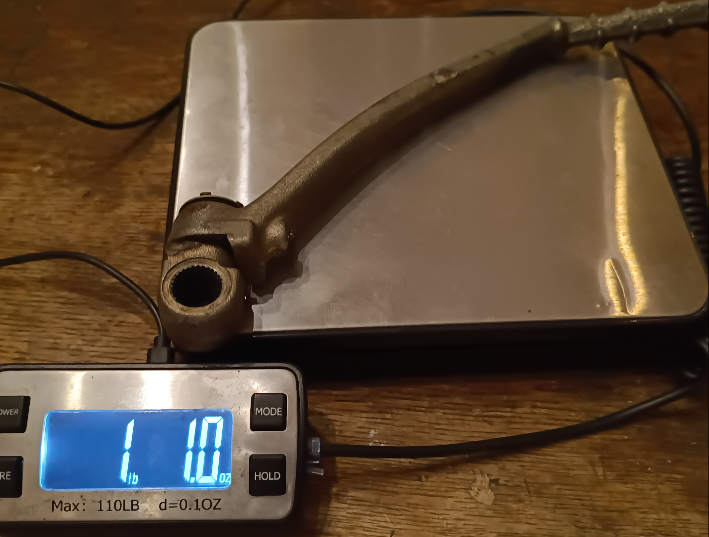

Here's the comparison between the goofy awkward and very wear prone stock KDX Kickstarter lever, versus the popular KX 125 shorty kicker upgrade using the KX250 splined portion with the lever from the KX 125...
The KX125 lever/250 knuckle shorty combo is literally half the weight of the stock clunker.

Chuck78 wrote: 04:27 pm Aug 05 2024 Has anyone weighed a KX125 frame (with seat subframe) to compare to the KDX200H frame weight?
Anyone done this yet?
I still haven't cracked into a full rebuild & major upgrade of my '99 KDX220 yet, but I'm still slightly considering picking up a '96-'98 KX125 chassis for a hybrid build, IF it's noticeably lighter than a KDX200H/220R frame...
I've asked the only seller on all of eBay woth a KX125 frame AND seat subframe if he'd weighed them for shipping yet, and if that'd be a possibility.
It's in the year range I'd be looking for, so there could perhaps be an impulse buy going on here if it comes back a fair but lighter than the 30.3lbs that the original poster soup-n-sandwich here is showing... No swingarm or linkage or seat etc though, so it'd be a pieced together bike, meaning probably more of the full titanium hardware type custom builds for me
If it doesn't end up being any significant amount lighter (less than 3lbs difference), I'd still perhaps look for a complete '97-'98 KX125 needing full rebuild, to possibly build a '97 KX139X or '98 KX134X out of, as the engine is the heaviest difference between a KDX200/220 & KX125...
I do recall several people stating that the KDX200/220 hybrid builds only end up at around 5lbs lighter than the KDX. I don't know if that's a KDX with a fork swap, but there's an easy 6.5lbs to 9.5lbs weight savings to be had on a '95-'06 SOLELY by swapping on an aftermarket exhaust (-4.5lbs+) and doing a good 1999+ KX or other modern fork swap (1.1lbs - 2.3lbs on a closed chamber fork swap, 1lbs-4.5lbs savings on an open chamber KYB fork swap).
The aluminum KX brake pedal and shifter lever shave about 1.1lbs off vs stock KDX steel versions, the KX seat subframe doesn't extend out as far in the rear, the '99+ seat gian is classic modern seat that's not for full time sitting or all day riding comfort (half the thickness of fiam, saves up to 1lb,), & far more of the KX bolts have dished out race spec heads to shave probably 0.75kbs more off the bike... & the KX triples all have aluminum steering stems, so shave another 0.85 lbs off, as well as the 2.2 gallon fuel tank being slightly lighter and never allowing the KDX's 2.91 gallons (0.60 gallons extra fuel weight all up high)....
Also, the KX frames are missing the KDX's case saver frame hoops...
So those are things which total up to about a 5lbs difference there...which leaves me wondering if it's really worth it? Perhaps, the '96-'02 KX125 geometry has a much higher ground clearance at 15"+ vs the KDX & 2003+ KX @ 13.75" or so, & the steering angle is even steeper on the '02 & earlier KX125 ('90-'02? definitely '94-'02) @ 26° which makes for a very excellent fast sharp steering for tight woods riding. The '97-'98 swingarms are slightly longer by an extra chain link I believe, and taller. That'll help the short wheelbase and steeler steering angle on the steep hill climbs since that's the KDX200 & '94-'02 KX125's only weak point in the chassis geometry handling - steep hill climbs. Handling everywhere else in the woods is super crisp and responsive...
