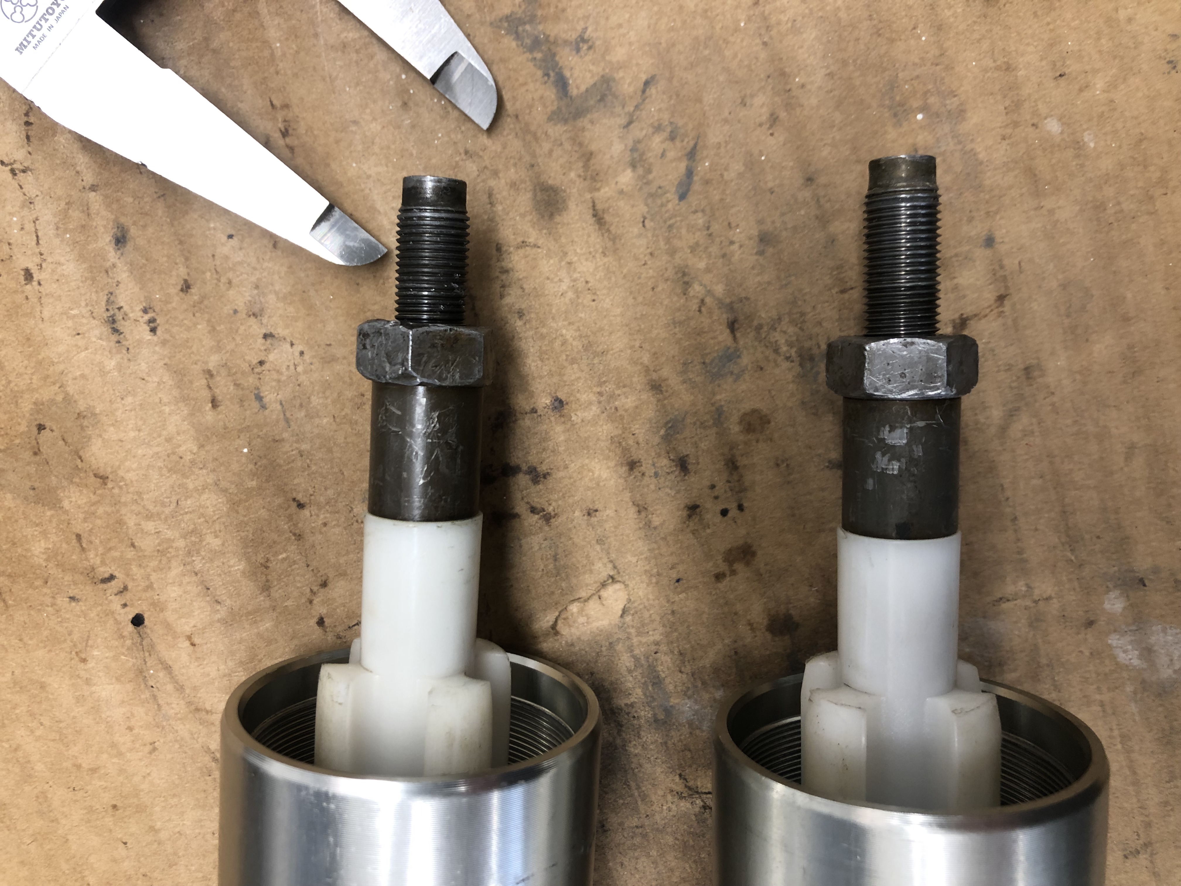

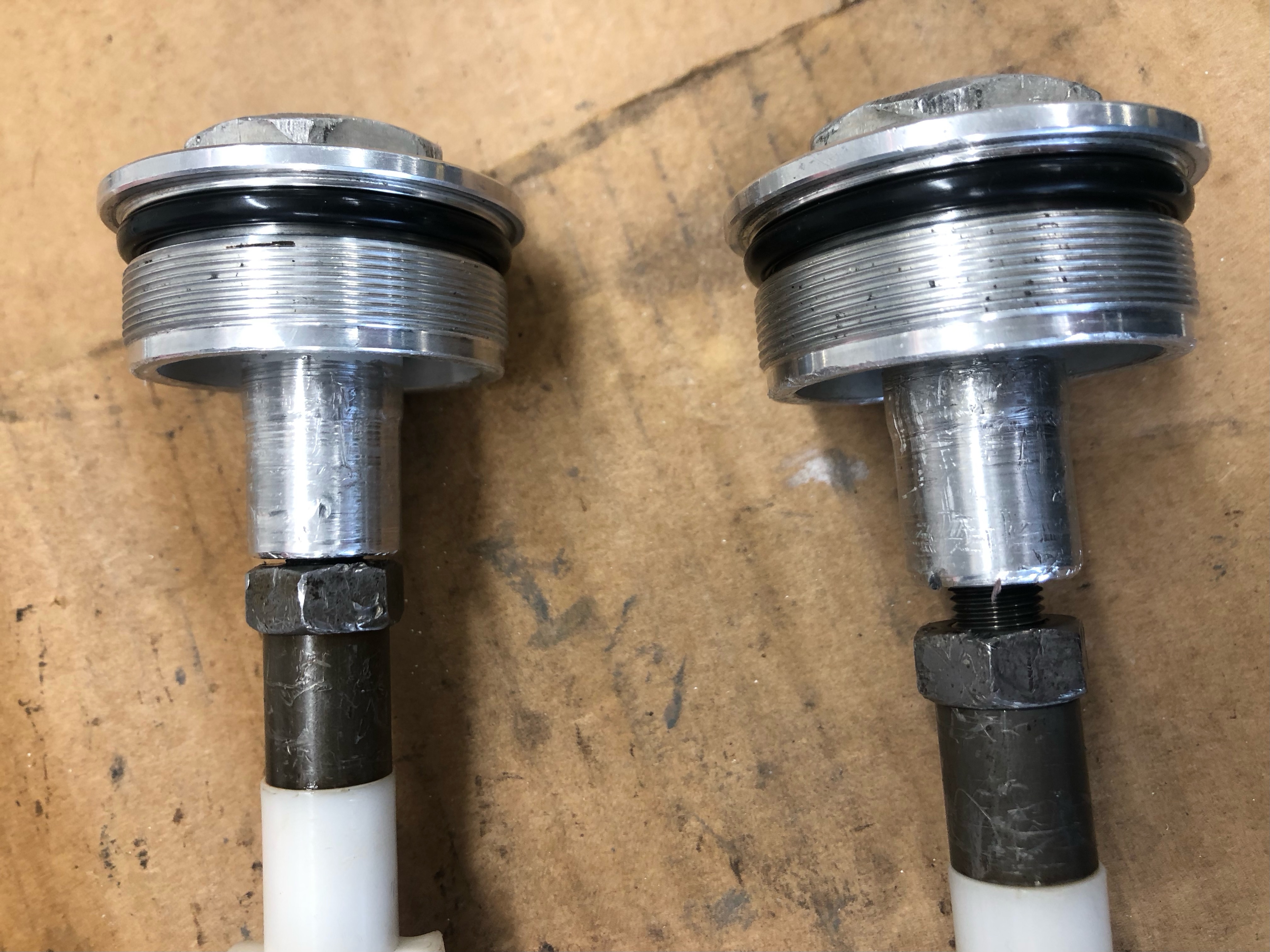

While removing seals, I noticed different lengths of the threaded end, one side is 18.5mm the other is 22.5mm, does this matter or inconsequential?

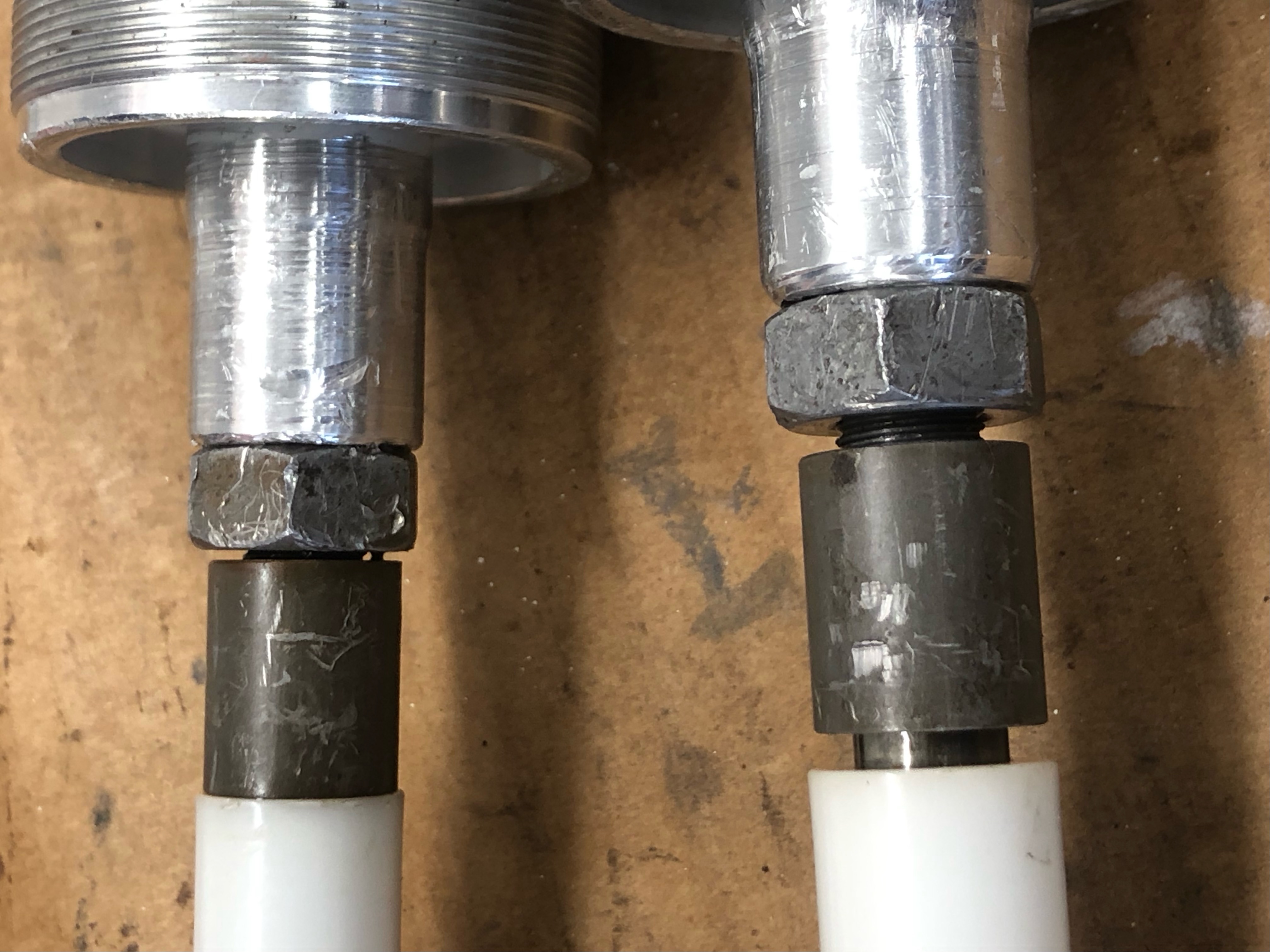

Hey guys just to confirm: The alloy fork caps should NOT bottom out on the fork rod when wound on, correct? Picture below shows fork caps bottomed out, and not securing against steel nuts. (Also shows that the threaded section is longer on one than the other.)

If that applies to KLX300 forks, then there is too much threaded rod shown above. I can't back off the nut as that would then loosen the steel collar\spacer that's against the white plastic spring guide holding it all firm.
So how does one reduce the amount of thread protruding beyond the nut? So I can get the cap to screw down against the nut? Is there some other adjustment at the other end of the rod, at the valve end perhaps?
The fact that the top photo shows different lengths of thread makes me think that a previous owner has messed with it somehow...

Chamfered end goes up on the nut, by the way.
Someone has scratched the hell out of it.
The nut is not supposed to hold that spacer and guide firm. Any damage inside the fork cap threads?
EDIT: What is the length of threading on the top of each rod after removing the nut and spring guide?

Nope, fork cap threads are good. Yeh someone has had a good chew on it for sure.
When you say the "chamfered end goes up on the nut" you mean the nut winds up against the fork cap like this pic?

Ok roger that cheers. But in my situation, if I did that, as shown in the photo above, it would leave that metal collar\spacer fee to slide up & down on the rod, surely that can't be by design?
I also have a screen-grab of 06/07 KLX250 forks from youtube which shows no clearances, which is what I think it should look like, yeh?

There has to be a touch of room or the nut would not have room to tighten up against the fork cap.
When you take the cap, nut and spring guide off, is the threaded portion the same length on both?
I know the spring guide is made of plastic. The collar is steel, correct?

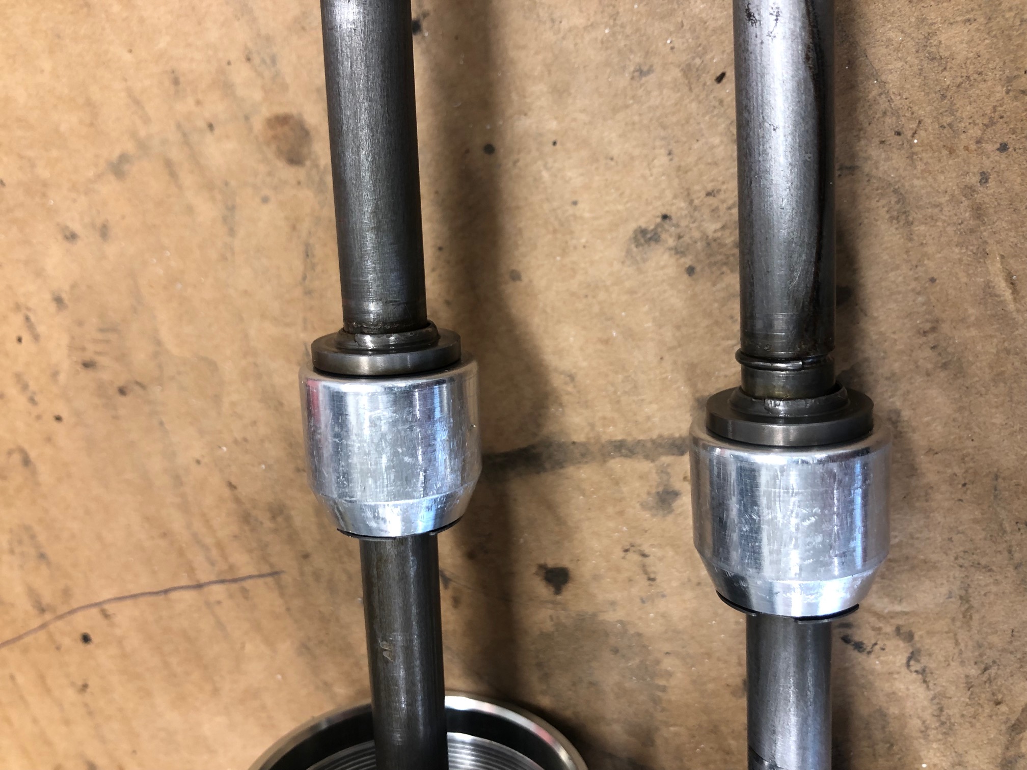

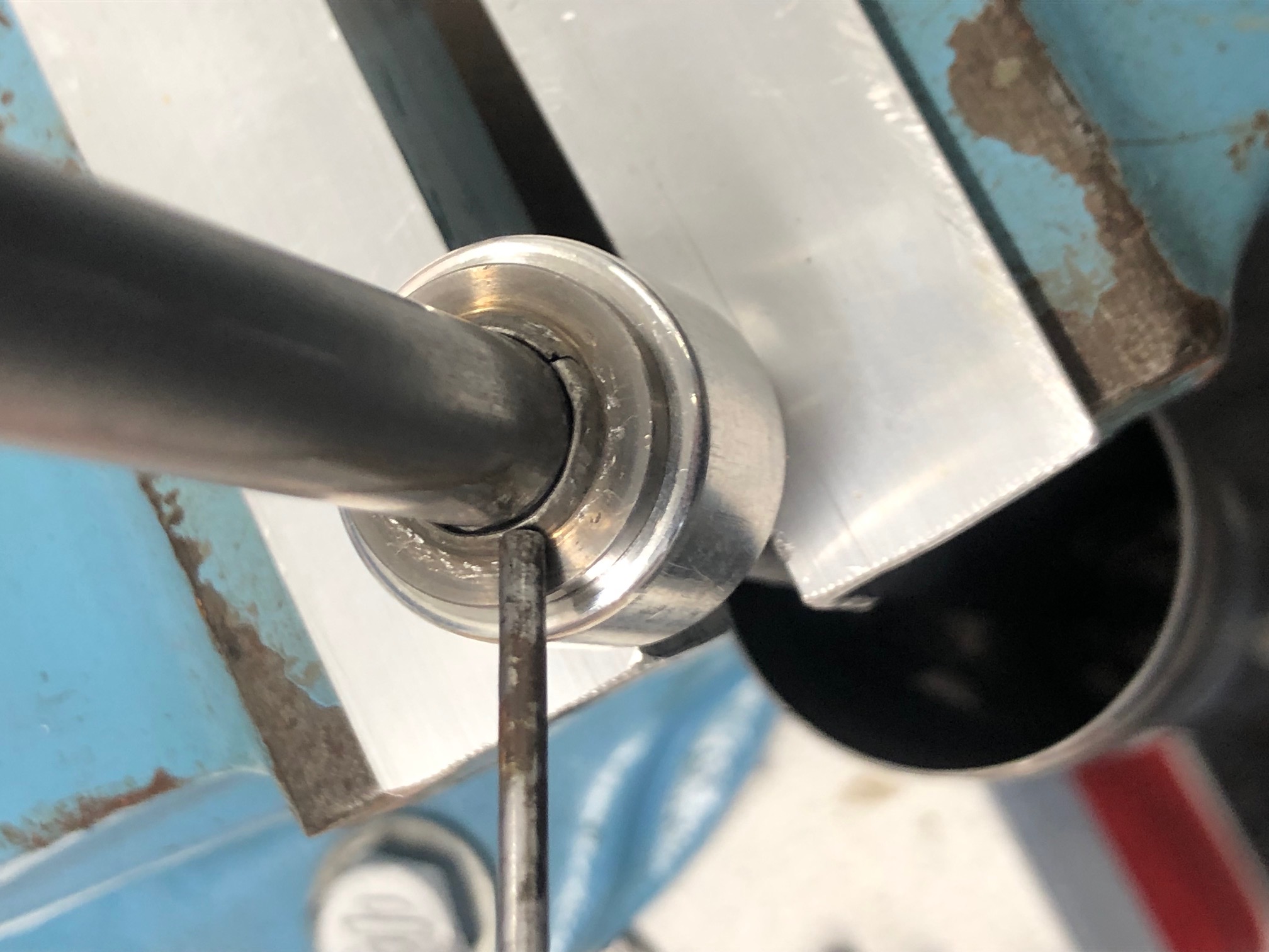

Right, all sorted man. As you suggested, I checked thread length which is fine. What had happened was alloy bush\stopper thingy that the plastic spring guide sits on had come away from the retainer\circlip, which explains why I had additional thread at the top end.
So I tapped the bush back over the circlip and peened down the "flared" end over the circlip (you can see some fracturing), so it wouldn't pop back out again. Hopefully that should do the trick.
Maybe that steel nut was wound down too tight on the top end of the spring guide, causing excessive pressure on the bush, therefore the bush eventually came away from the circlip, who knows...
