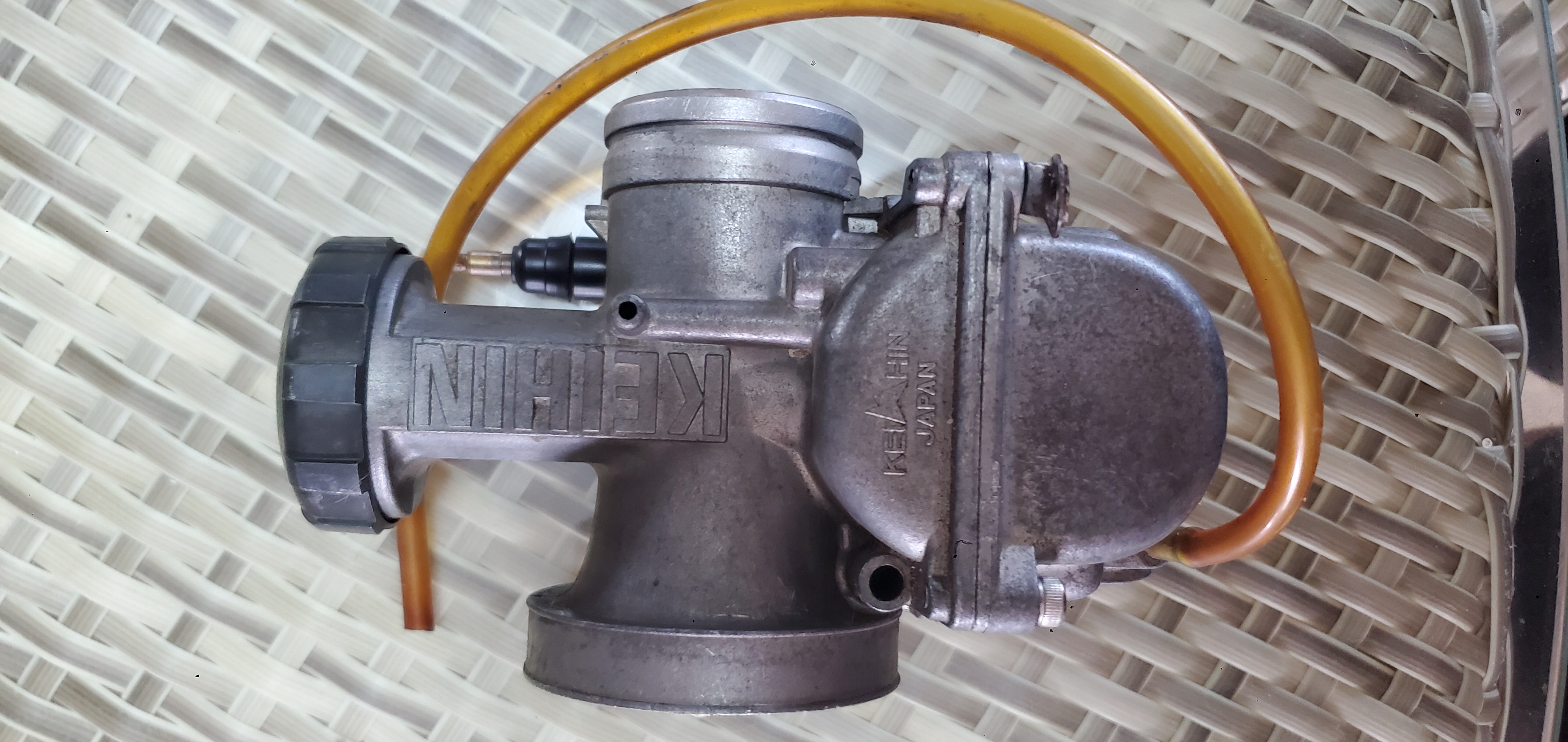

Re: 250 starting problems
Im not sure what kit to order. the markings on my oem carb are PJ 150AFHChuck78 wrote: 10:59 am Jul 13 2024 You just need a float needle and float bowl gasket for the OEM carb, and definitely a good idea to change out the jet block gasket with a genuine OEM Keihin part, not aftermarket. It's not shown on the Kawasaki parts diagrams, but it's there. You just have to order it from Sudco, Jets R Us, or JD Jetting to get a guaranteed genuine Keihin part.
Can you post a picture of what you are seeing so we can see it too? Instructions in my signature.

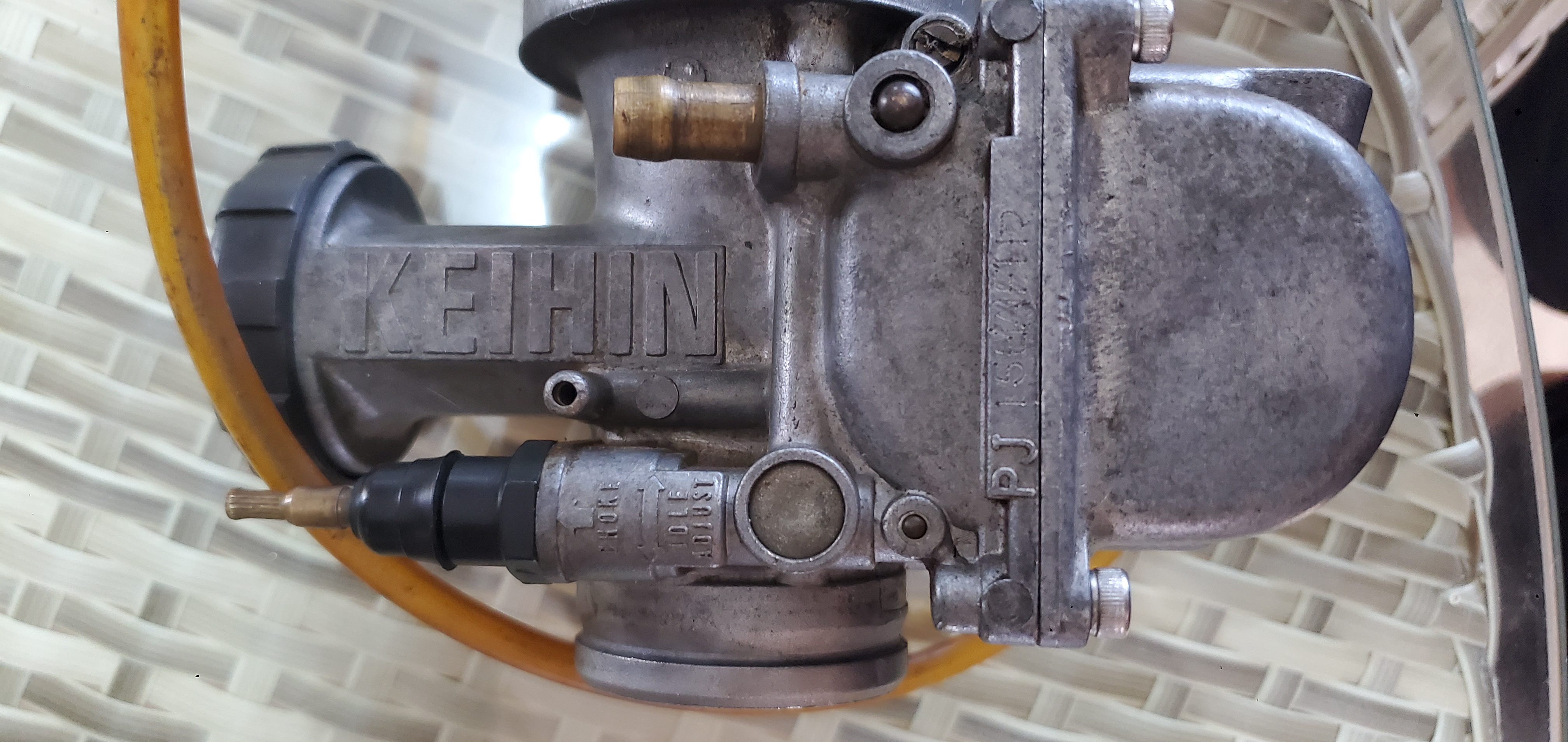

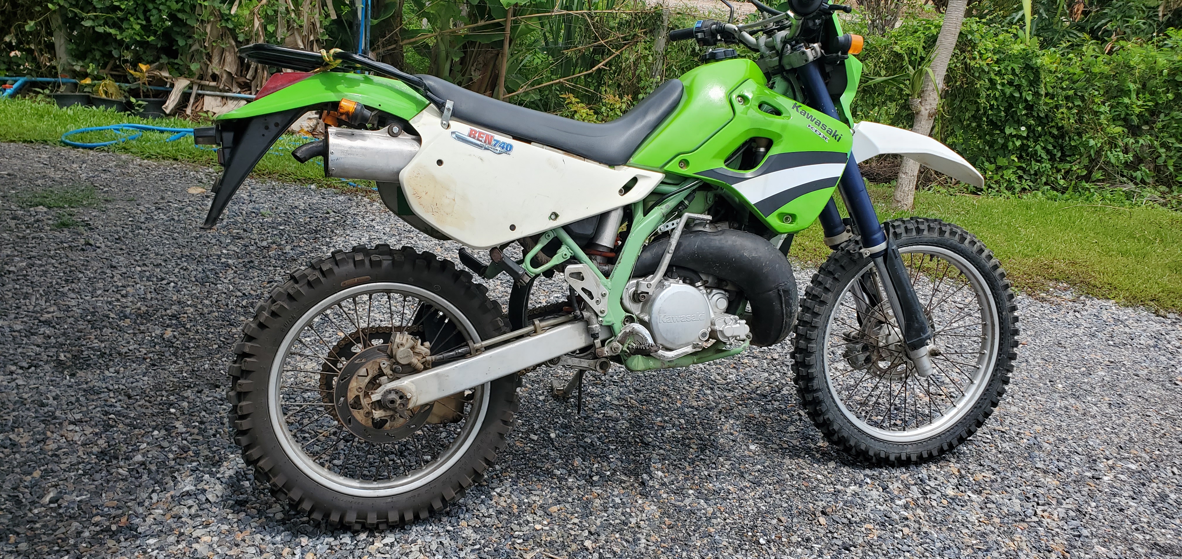

My local mechanic says I need new float bowl gasket. I would prefer a full repair kit. Not sure which one to buy.KDXGarage wrote: 02:24 pm Jul 14 2024 Can you post a picture of what you are seeing so we can see it too? Instructions in my signature.
Did that bike come stock with a PJ carb? In the USA, our KDX's had the PWK from 1988 onward.
What year and exact model is it?
Do you have a VIN or frame number you can post? Thanks. A place called impex has parts diagrams.
Is this a KDX250SR?
The parts may be different between an offroad model PWK36 & an SR street legal model, but the type of parts needed will be the same,float needle and float bowl gasket, perhaps jet block gasket.
I dont know if this sr. the graphics are different than the sr's that I have seen here. But it is street legal..turn signals etc..Chuck78 wrote: 06:33 am Jul 15 2024 Is this a KDX250SR?
