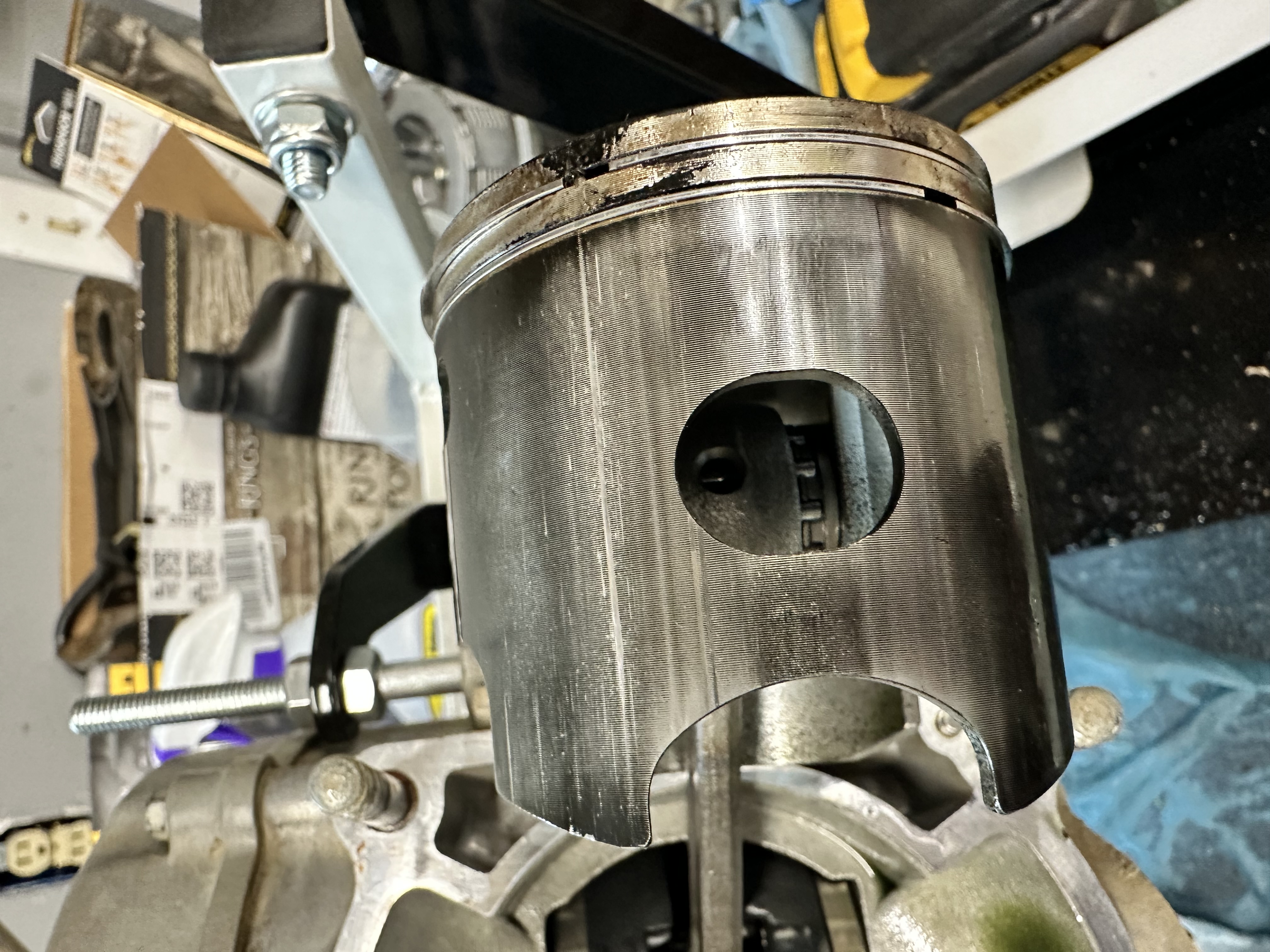

Had a buddy bring me his 220 for a complete re-seal/ new bearings/ top end etc.
His bike has had the Fredette porting done, and RB carb and head mods done.
Initially he brought it over due to having issues tuning, and finding “oil” in the stator area. ( main seal bad)

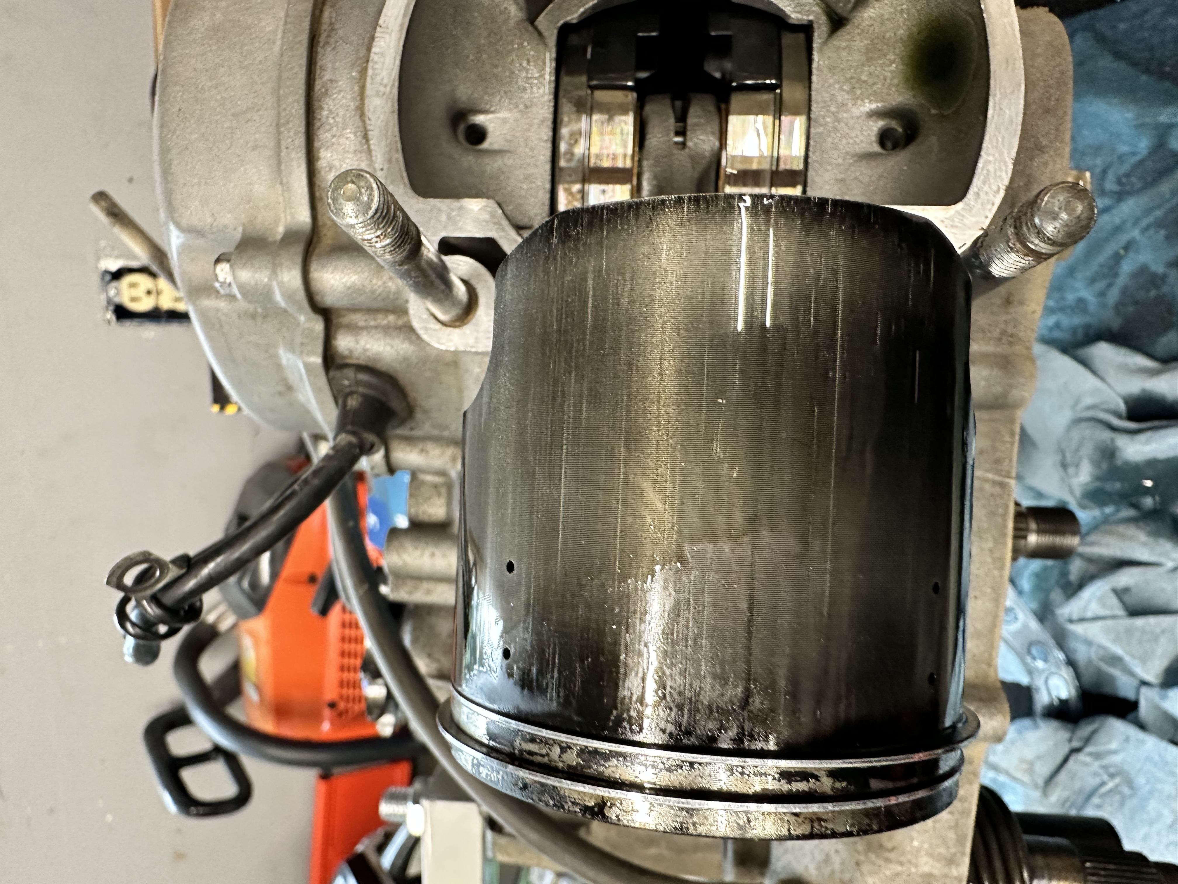

Needless to say, I was a bit surprised when I pulled the jug off of the lower end. He was told by the PO that he had “just done the top end”. 🤦‍♂️ He has only put maybe 6-8 hours on the bike since he got it.
Found a pretty big spot where the plating failed, and needless to say, the piston is done!

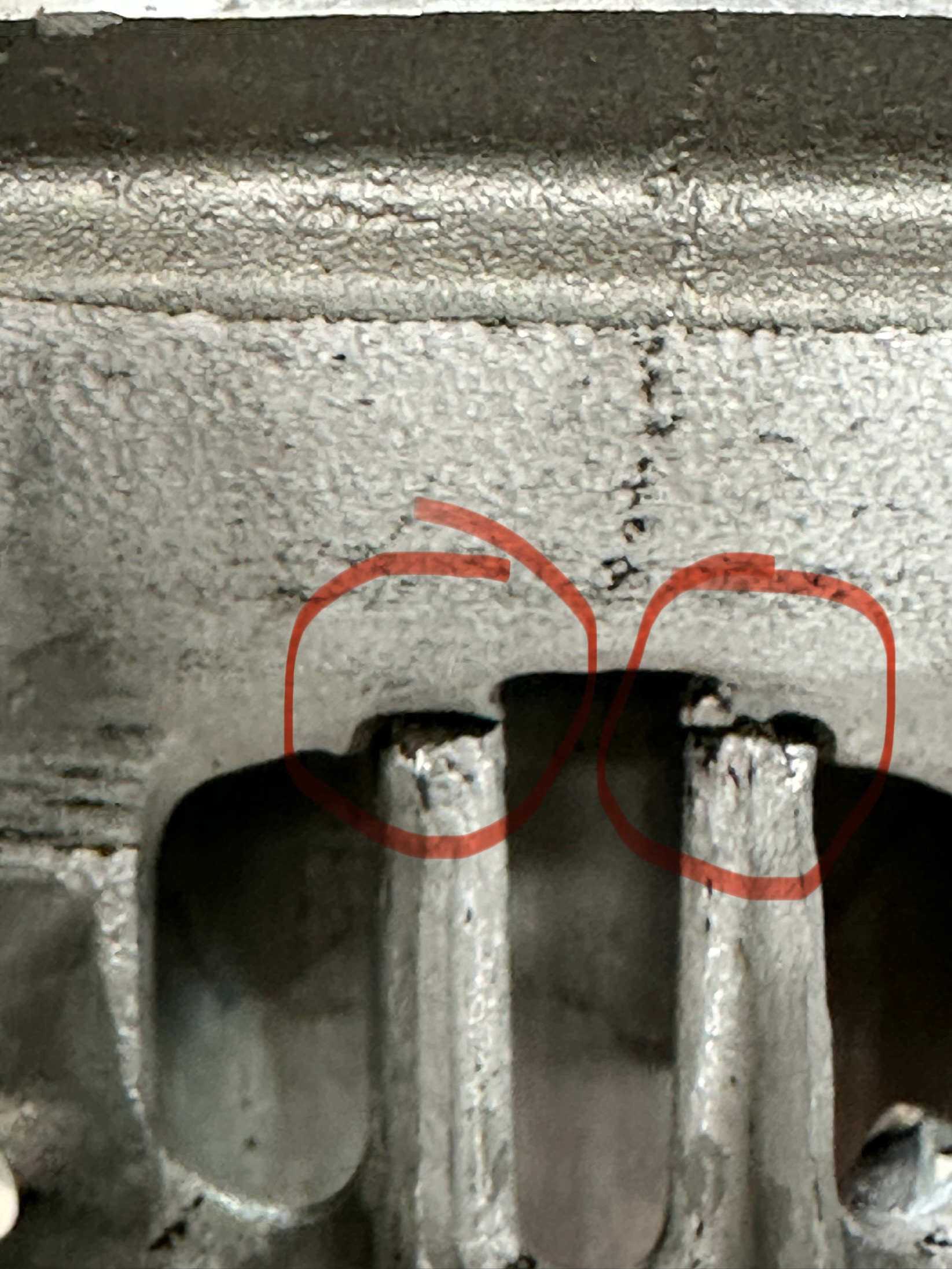

His jug was also cracked in the same spot that my 200 was, but way worse. Unsure if this is a result from the material removed when the porting was done, or what. He’s currently looking for a replacement jug.

Cylinder can be saved. I had a crack in my 220's cylinder and Millennium welded it up and replated it.
Re: PSA: don’t skimp on top ends!!
DAMN
Do read up on their welding and repair options.
