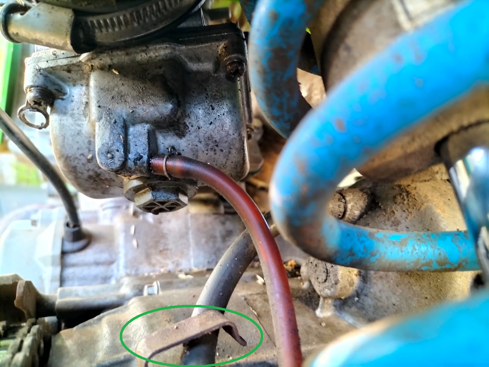

Re: KDX200 fuel lines
huh, i got it !! so, i have only 1 fuel line, the one on ther buttom
- carb3.jpg (230.02 KiB) Viewed 3716 times
- carb2.jpg (178.59 KiB) Viewed 3716 times
- carb1.jpg (158.87 KiB) Viewed 3716 times

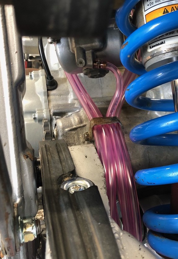

There are two more, one on each side. One runs down through the ring washer on each side.
Here's a picture.
Here's a picture.
so i just let them "fall down" like the one i have under the carb?
Do you see the ring on the left rear carb bowl screw? There is supposed to be another one on the right.
I route all hoses though the retainer shown in your picture. There is supposed to be another ring on the carb bowl.
Yep, have all mine going thru that clamp as well.

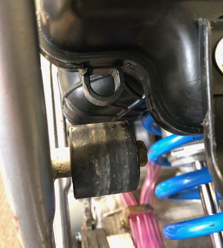

Also, what's the purpose of that lug hanging down from the airbox?
