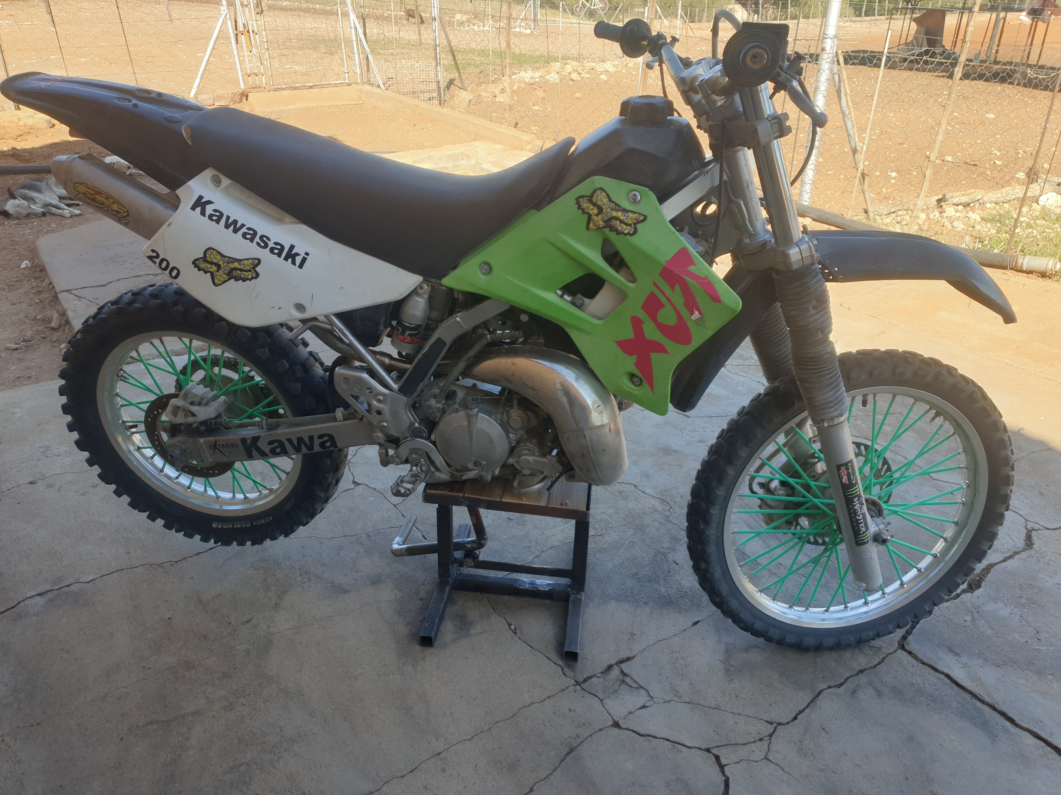

Hi all, Im new to the forum and I was looking for some advice.
I've had an '05 KDX200 since 2020, but only had like 5 rides on it since. At the beginning the bike was way too tall for me. I'm 160cm and weigh between 50-55kg. I've already lowered the forks and the screws on the shock back then, but I still have to kind off hang off the side to stand on the ground when stationary and I usually have to hop on when I pull away. It does also make moving the bike around or loading it very difficult.
I just redid the top-end, which seemed like it was neglected by previous owners.
Slowly busy fixing the bike up with new parts and so-on.
What more can I do to lower the bike to a comfortable height? I read somewhere about lowering links, but they are pretty hard to find around here in southern africa.
Also interested to hear about any other mods you would suggest for a lightweight rider like myself? Any advice and insights would be appreciated.
