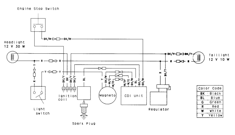

Hi all, I’m after a 1991 250 wiring diagram including the cdi, rectifier, lighting, turn signals etc. have searched for days without any success. Any help please 🙏

All I have is the US spec KDX250 diagram but here you go if it will help. I suggest trying to find a factory manual for your particular version.
