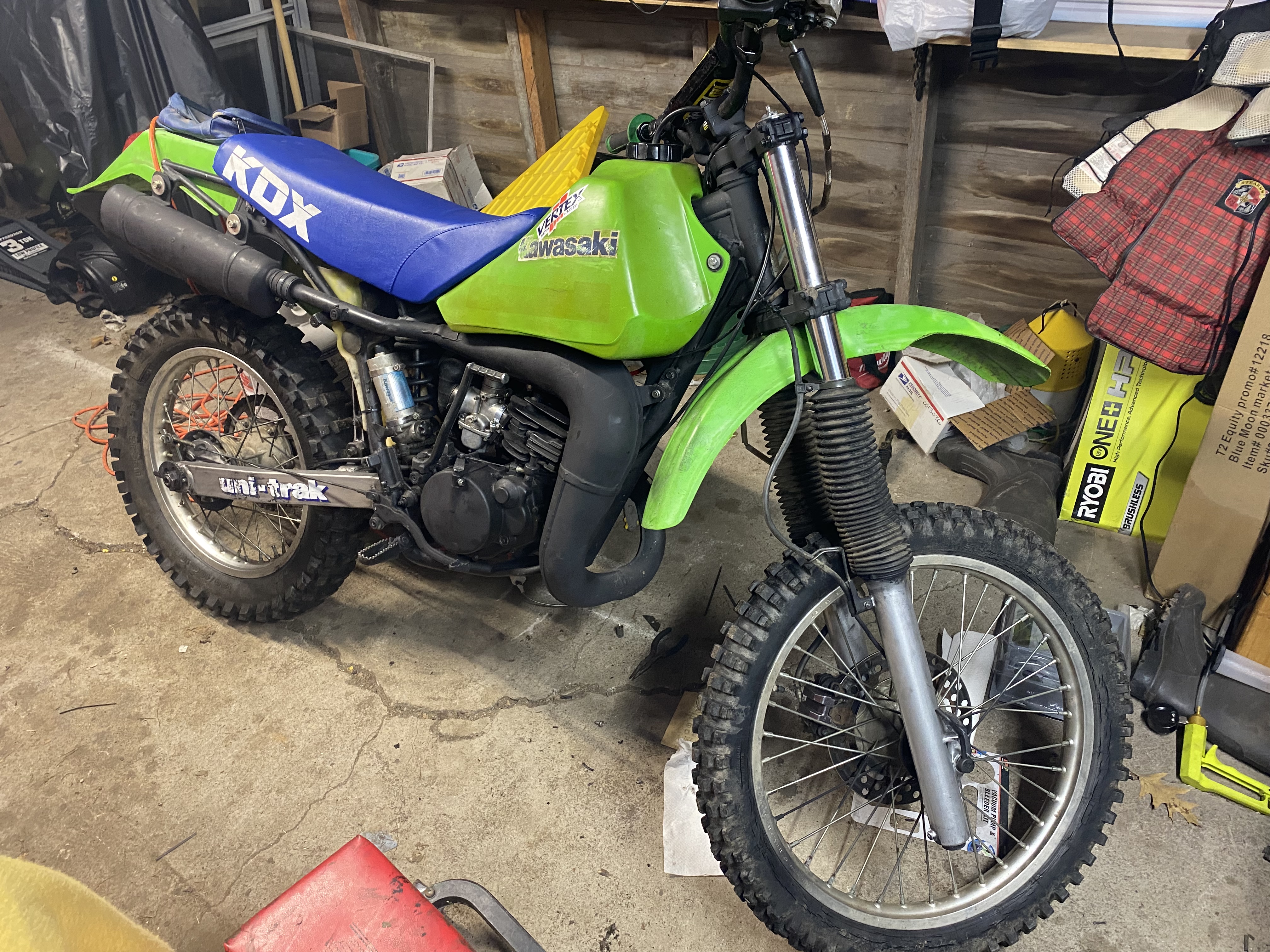

I’m new around here and I just picked this 1987 KDX up last week and I’ve got some questions for the smart folks here.
First: I pulled the pipe on this bike after I got it and the cylinder and piston look ok, and the bike has really solid compression according to the compression tester in my leg. That said, there is one vertical mark on the cylinder that caught my eye, and I think after this season I’m going to want to do a top end and re plate that cylinder. Most of the sources of pistons for these bikes say they’re the same for our c series bikes as the newer ones, is this right? I don’t want to stick the wrong piston in it, but I also wouldn’t mind a newer coated piston.
Second: I see RickyStator sells a 65W lighting coil for these bikes, would that get me into the range needed for a 12V conversion. My understanding is that these come with a 35W lighting coil from the factory? I assume a regulator is needed to do the 65W and 12V?
Lastly: The flywheel magnets. Seems like I’m going to want to address these sooner rather than later. Looks like I should be encasing them in epoxy, does anyone have any pics of this process from when they did it? Is it really just as simple as filling the voids between the magnets and calling it good, or is it more involved than that?
Anyways, glad to be part of the air cooled kdx crowd!

Welcome to kdxrider.net. Congratulations on the '87 KDX200.
As far as Wiseco pistons, 1986 - 2006 are the same.
Ricky Stator once told me that they sell a regulator to go with the updated stator. It was 12 volt, so headlight and taillight would need to switch I guess.
There is a post here from a Mr. Swinehart, I think. May he RIP. He actually had some magnets made. I think his posts showed the encasing of the magnets.
Again, congratulations on the '87. Grease the swingarm and linkage fittings!
