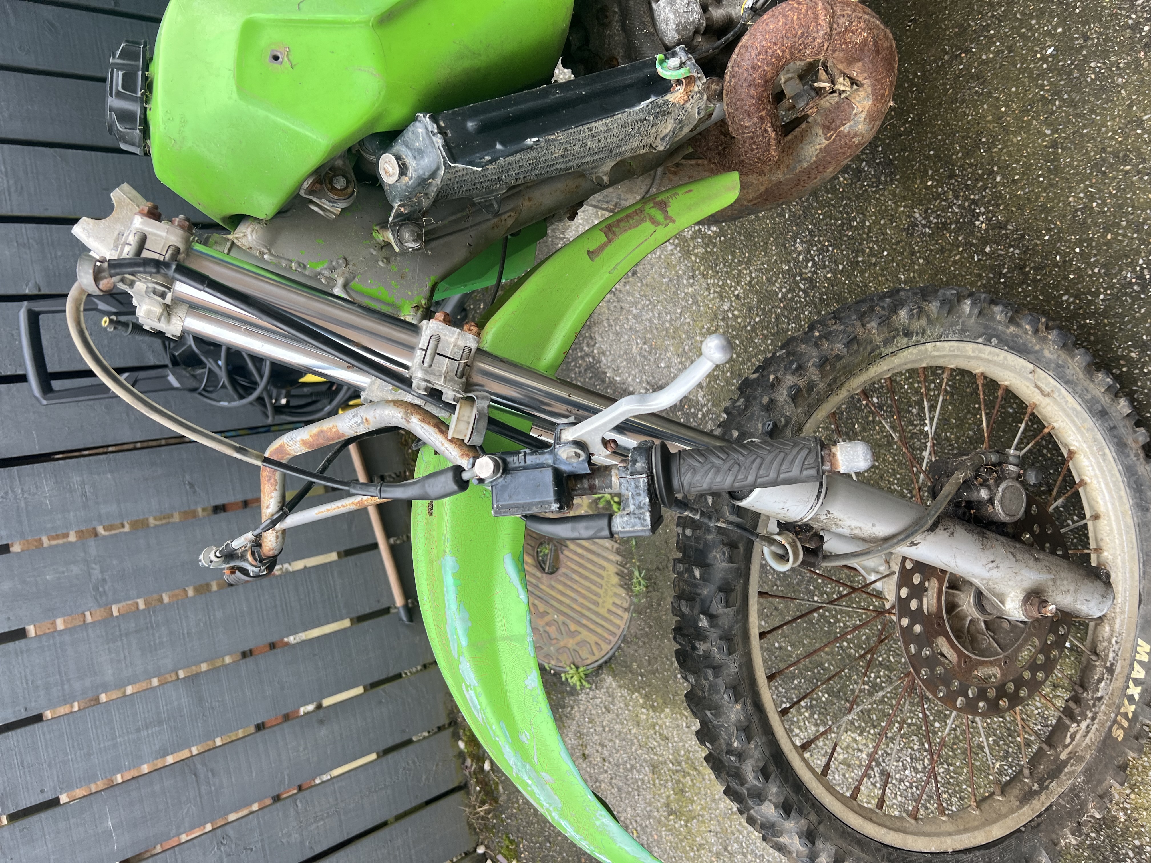

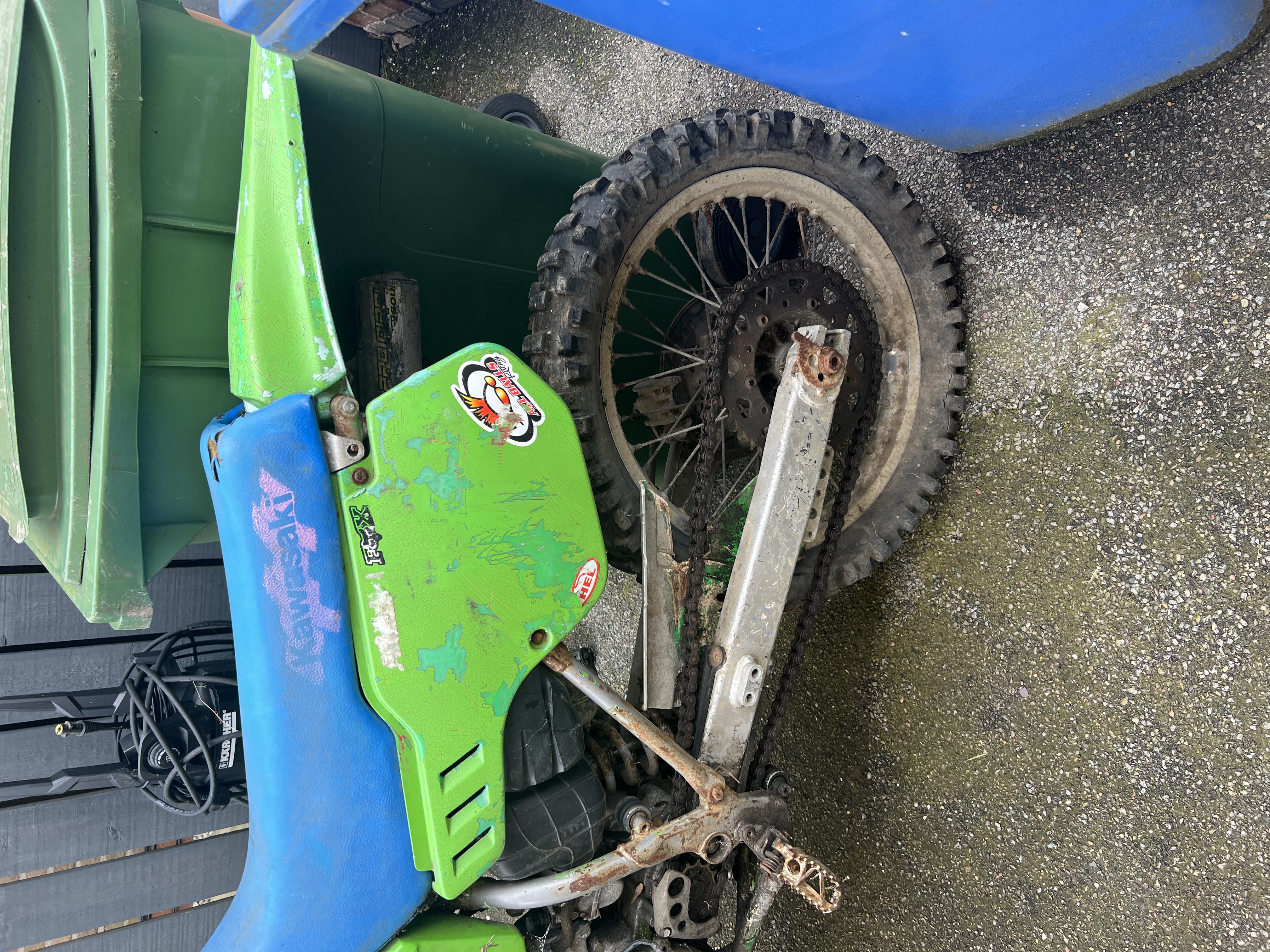

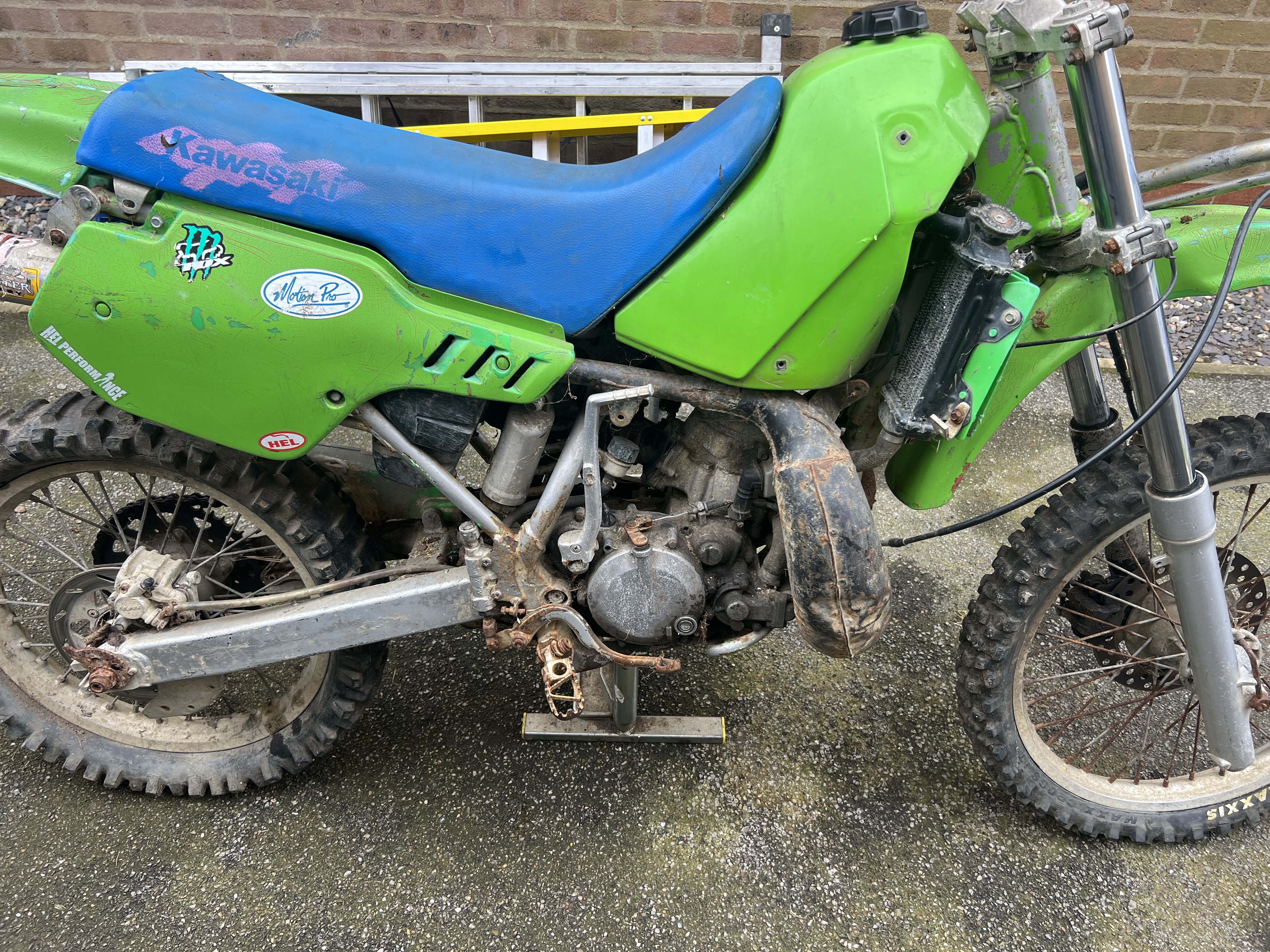

Not the best condition , I have a 1990 and 1996 so had the chance of this for the engine
- IMG_8315.jpeg (4.7 MiB) Viewed 30050 times
- IMG_8317.jpeg (3.63 MiB) Viewed 30050 times
- IMG_8318.jpeg (4.91 MiB) Viewed 30050 times

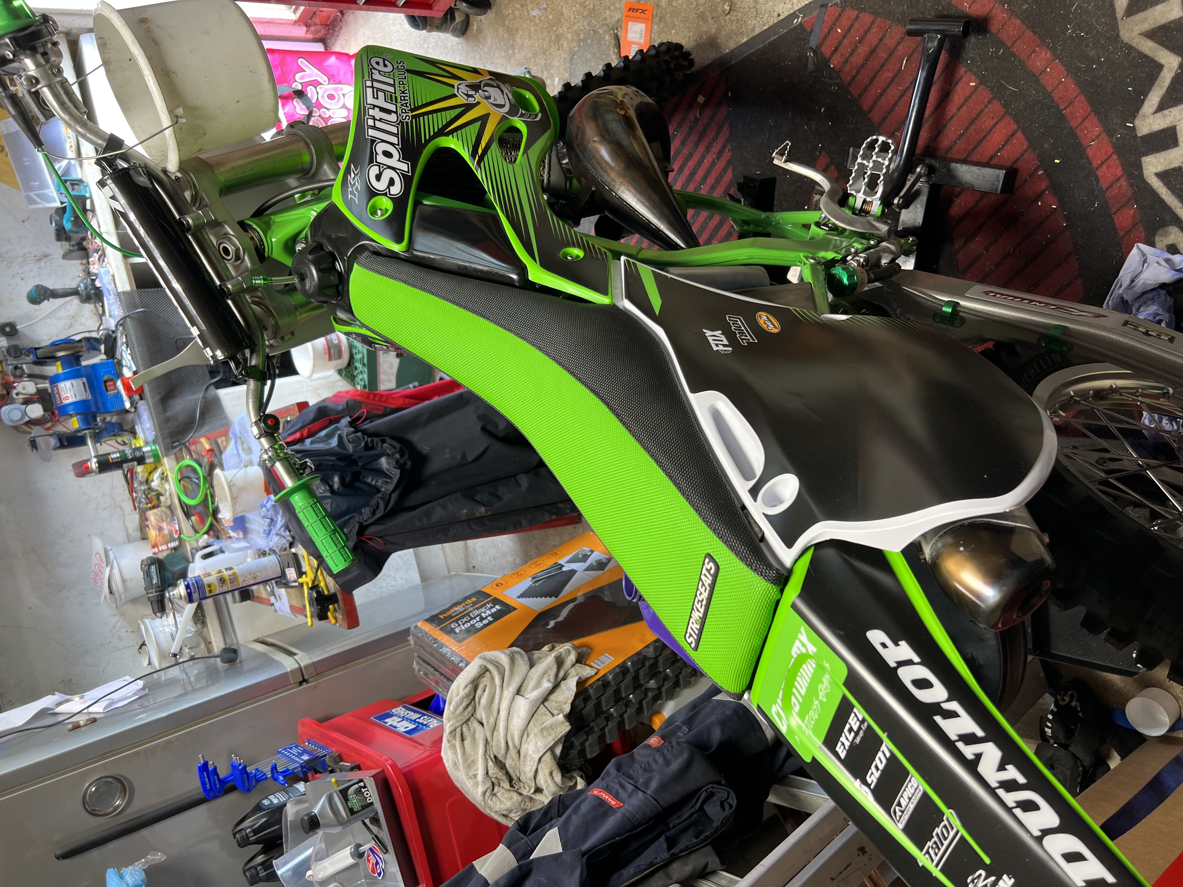

Going to strip and rebuild the engine and put it in this 2000 kx frame

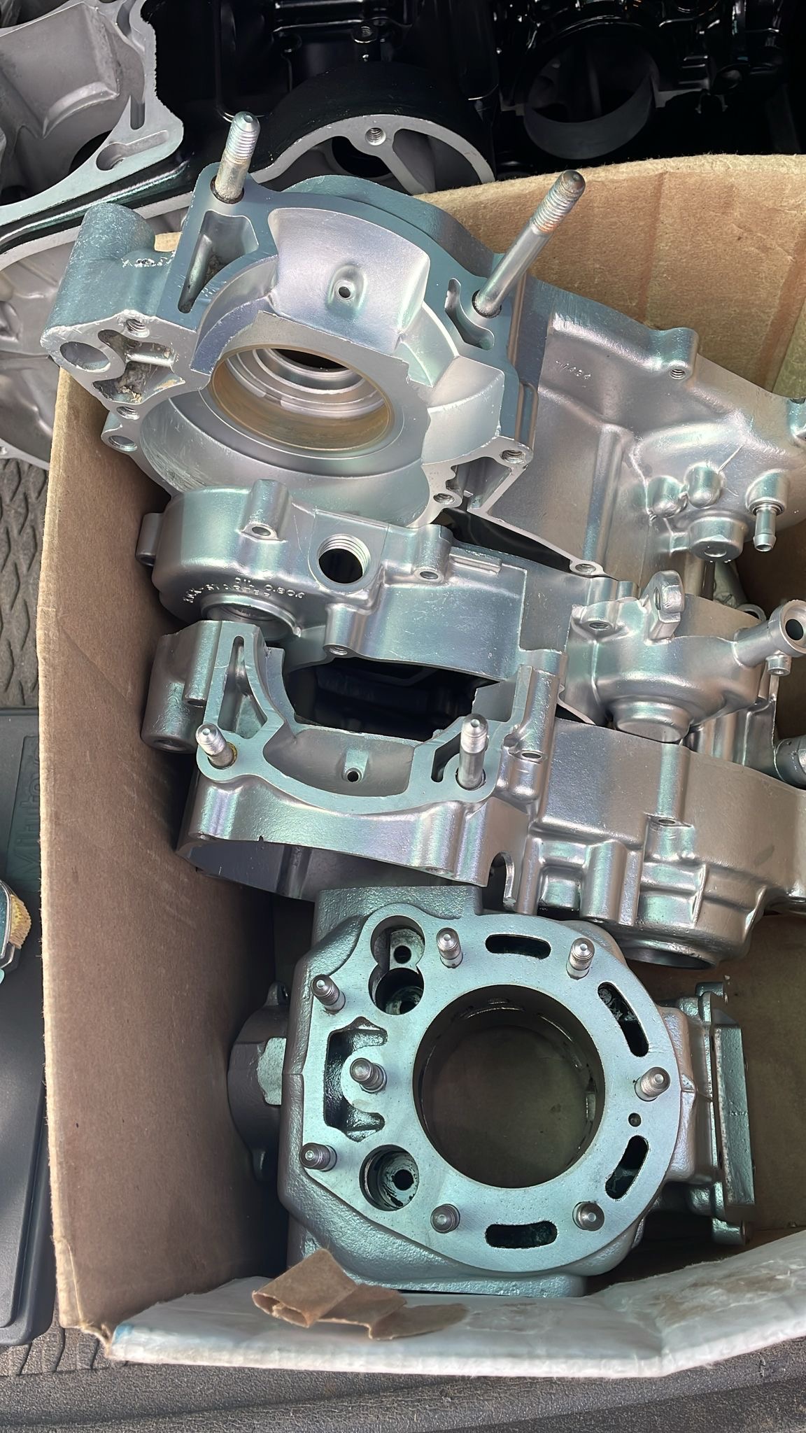

Cases came up nice on the 200 engine , just waiting on bottom end then that can all go back together

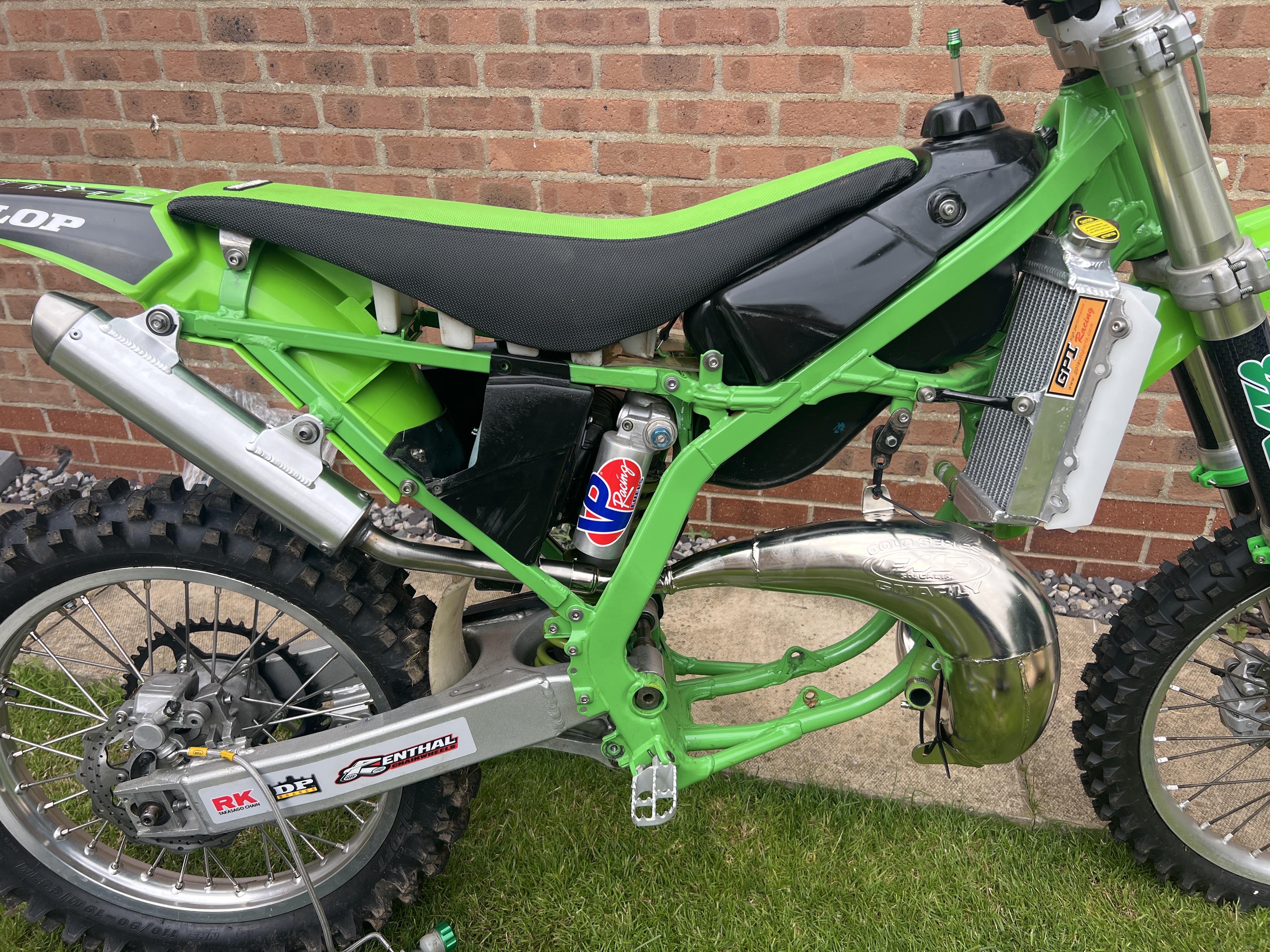

[/img]exhaust and pipe arrived just waiting on engine rebuild then can get it all lined up along with mounts welded
- image.jpg (4.19 MiB) Viewed 27834 times
Re: Kdx 1990 kx2000 fitment
Looking good. Keep at it.

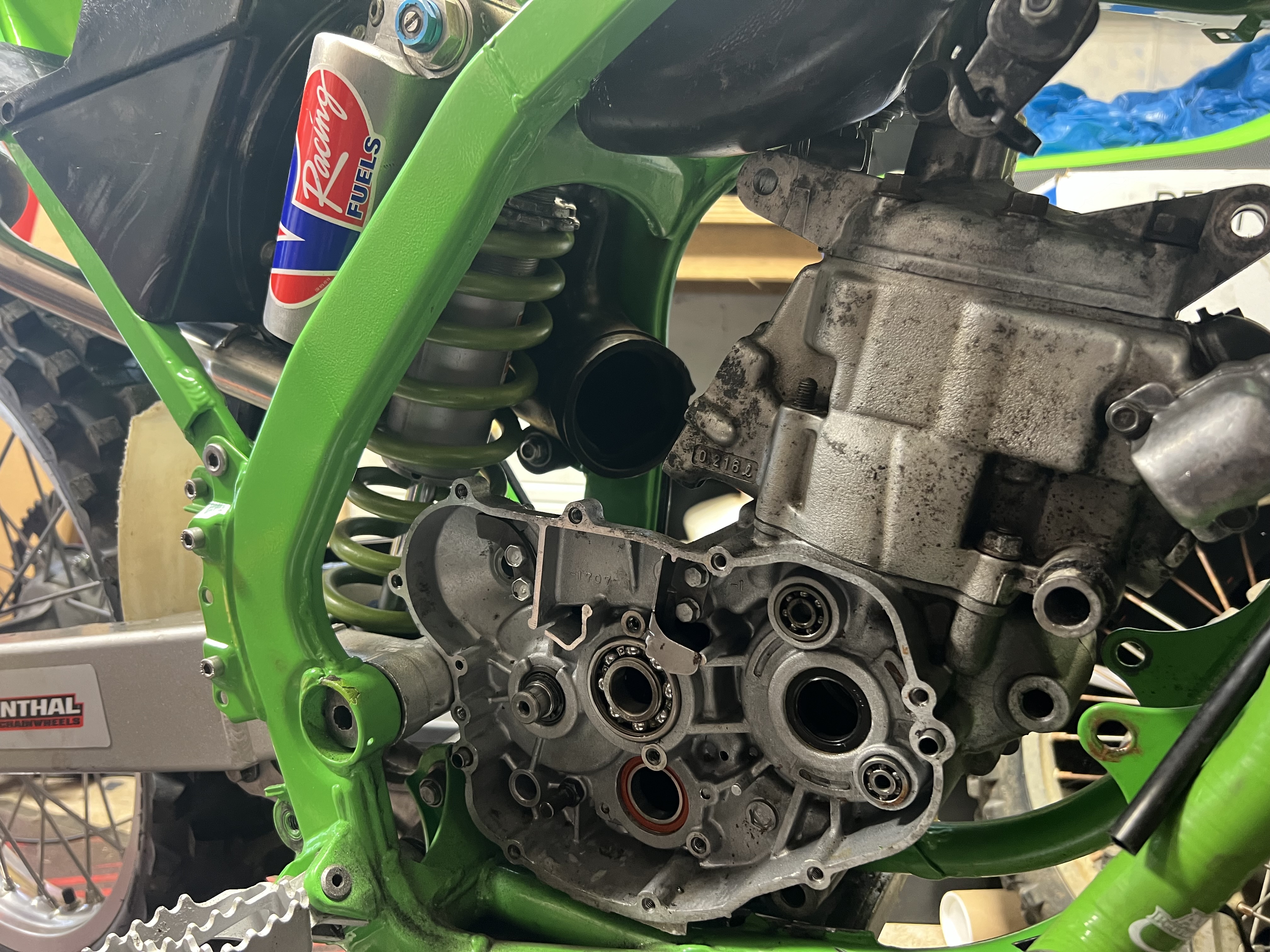

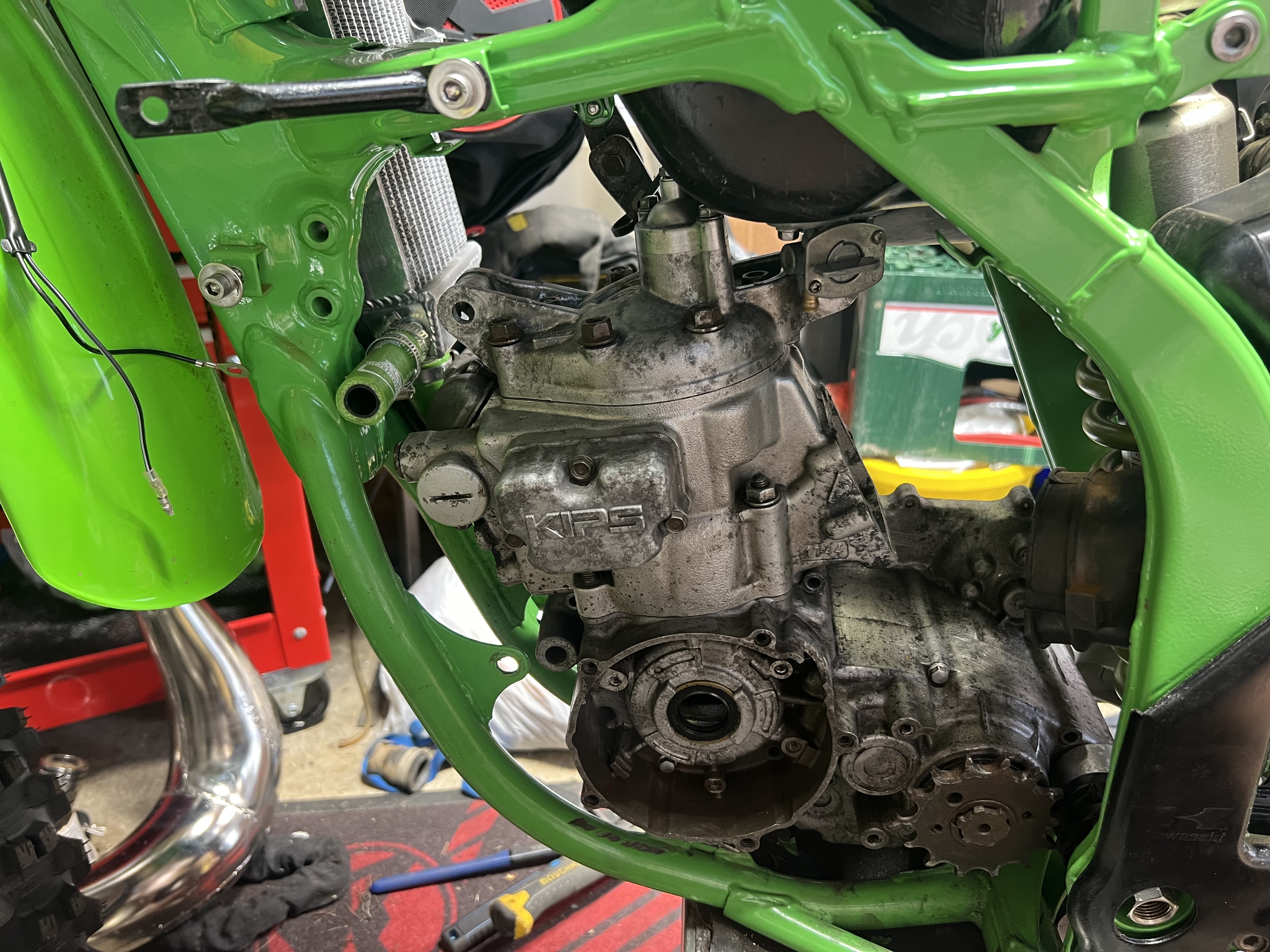

Got the engine in today, had to open up the cases to 17mm and take 5.5 mm and 7mm off the swing arm , going to have a day on it tomorrow to get everything lined up
Cool. Keep it going.

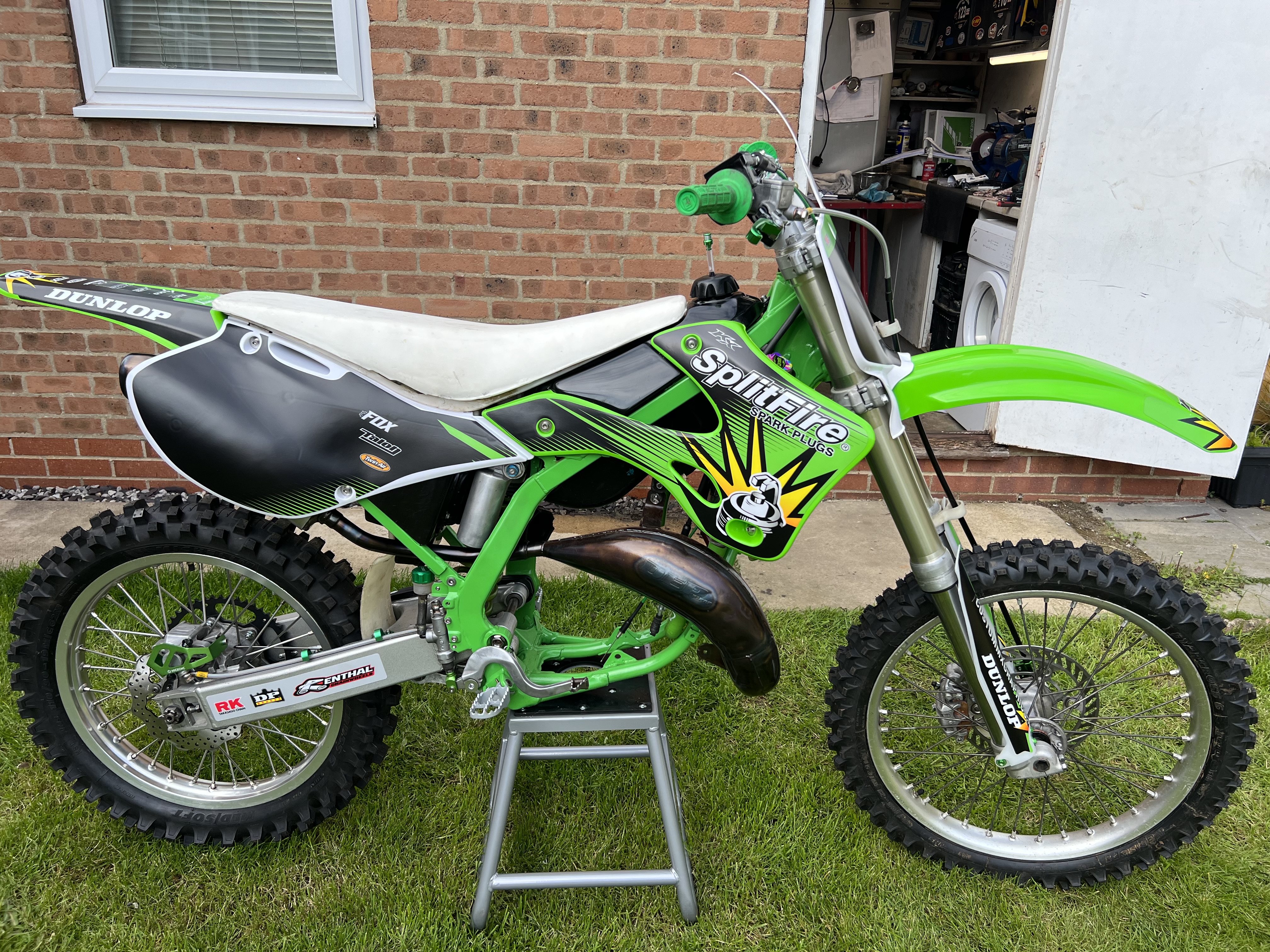

Well everything has started coming together, mocked up the kx airbox with kdx 220 air box rubber with aluminium plate mod to get the correct offset
- IMG_9280.jpeg (2.73 MiB) Viewed 26895 times
Looks good to me!
- Posts: 547
1fletch: photo of engine cases & cylinder shows beautiful parts. Like diamonds and other precious stuff!
