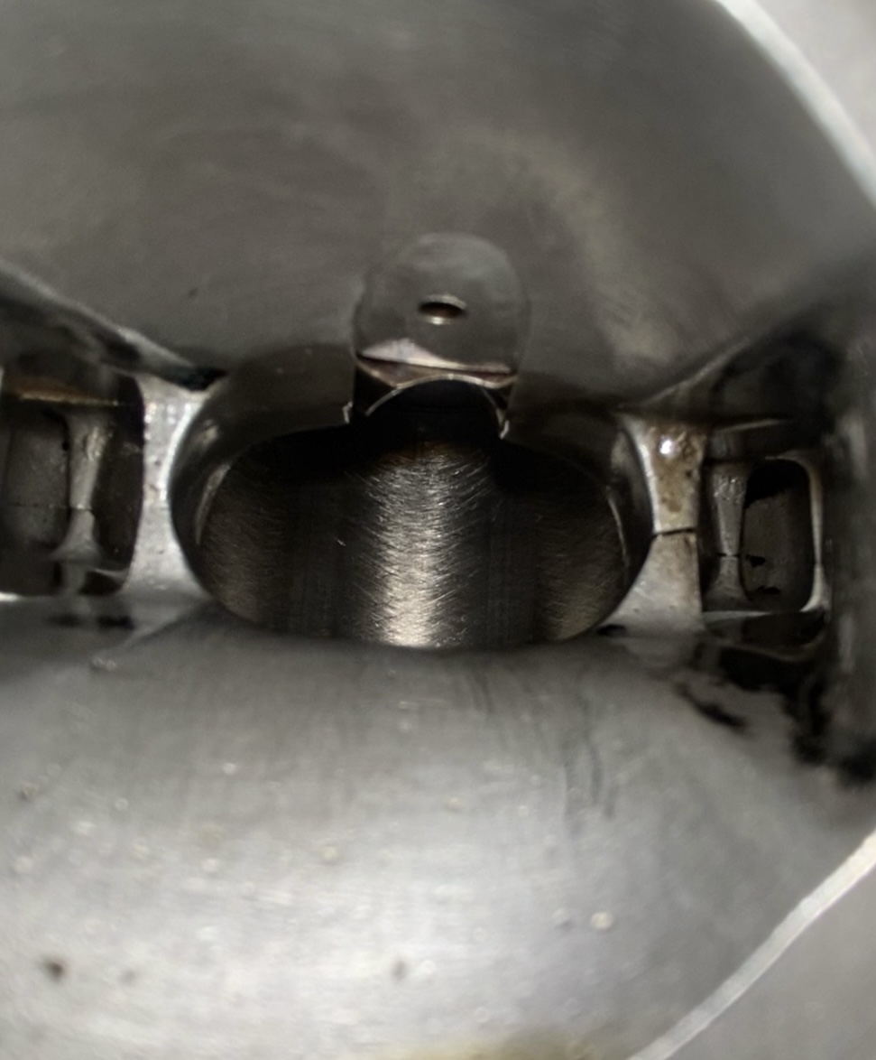

Hey SS109. Since you are pretty familiar with the e series kdx I had a question for you. I have all of the kips timed correctly by corresponding all of the dot with the shaft all of the way out. The center valve however is a little crooked and appear to be off like a half tooth. There are 12 teeth on the center valve gear so that’s 30 degrees and this seems off by less. Does this look normal?SS109 wrote: 05:50 pm Jan 30 2024None taken!John_S wrote: 06:29 pm Jan 29 2024 No offense SS of course. Everyone’s got their ways of doing it.

Hmm, that looks a little odd. I would probably pull it apart and see if a burr and/or some carbon is causing a little binding. Plus, to make things easier, I always assemble the KIPS with the cylinder off the engine and test it at that time before reinstalling the cylinder.

Yea, everything is completely clean/no binding. It’s not that it’s binding but like the main shaft can be pulled out alittle further after the center valve is lined up. and I know if I bring it another tooth back I can tell it will still not be centered. Based on a feature I have built into my iPhone i can tell it’s rotated past being centered by about 6-7 degrees and, if skip back a tooth (30 degrees) on the center valve it will be even more crooked just in the opposite direction. That would in turn based on my calculations be about 23-24 degrees of rotation off center.SS109 wrote: 10:09 pm Apr 23 2024 Hmm, that looks a little odd. I would probably pull it apart and see if a burr and/or some carbon is causing a little binding. Plus, to make things easier, I always assemble the KIPS with the cylinder off the engine and test it at that time before reinstalling the cylinder.
