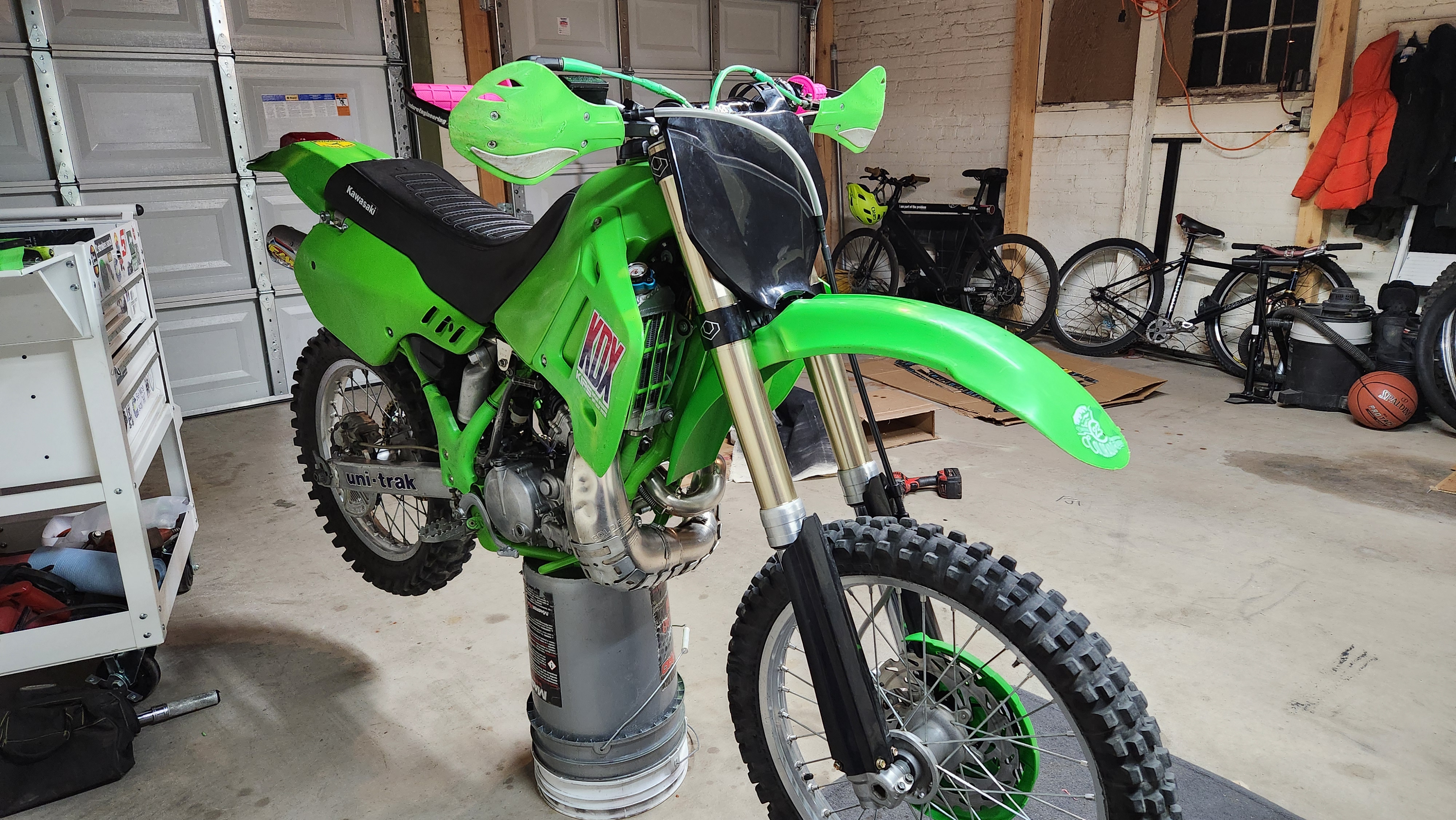

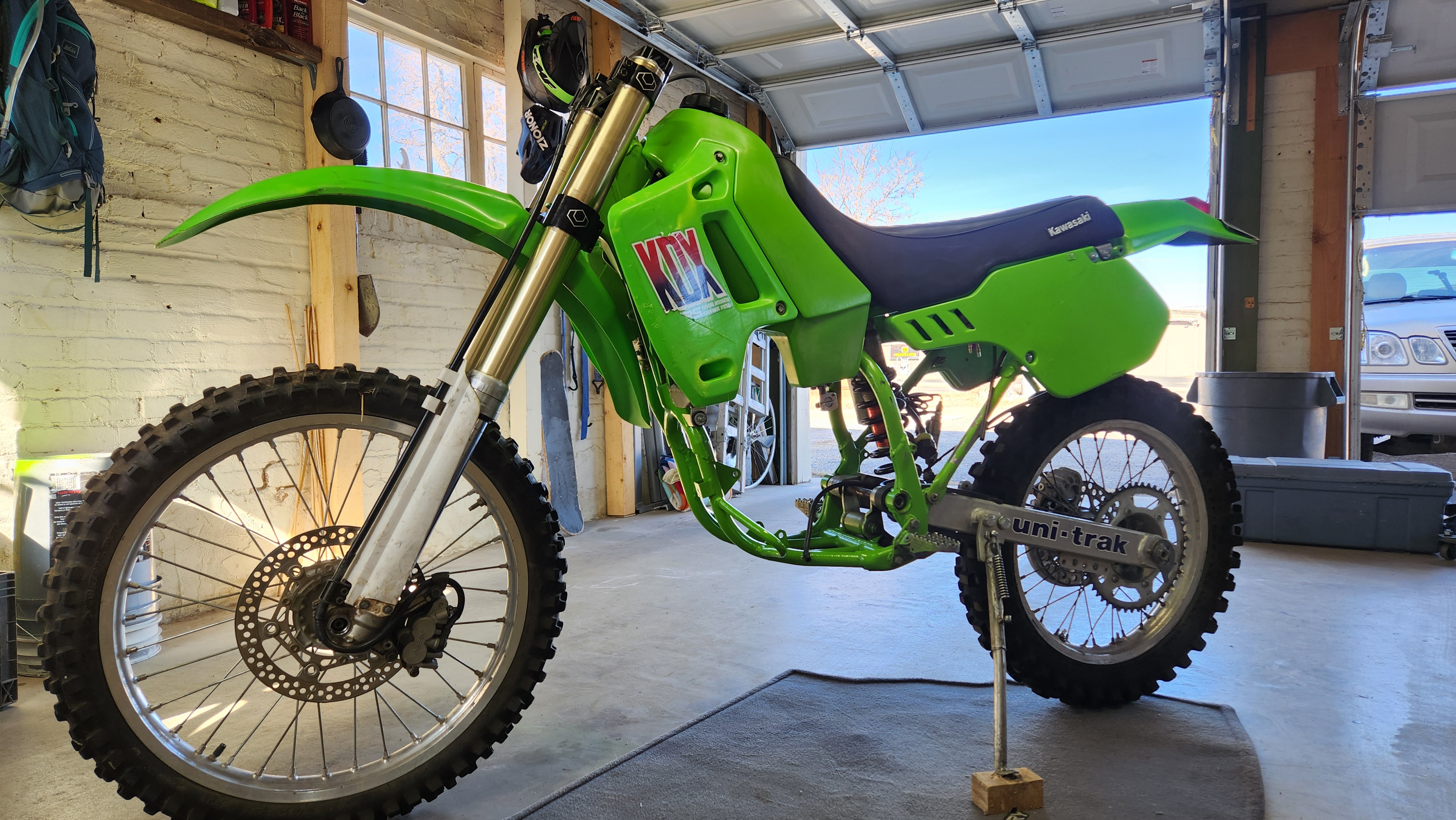

Just wanted to share where I'm at with this, maybe it could help someone else.
All the parts came with the bike, not sure where the triple clamps were sourced from but they had a KDX stem installed already. I'm just seeing how things fit up and it all seems pretty good. I'll be pulling them back off and doing the stem bearings and fork seals. I also plan on using a CR brake hose to eliminate the wacky front brake hose routing.

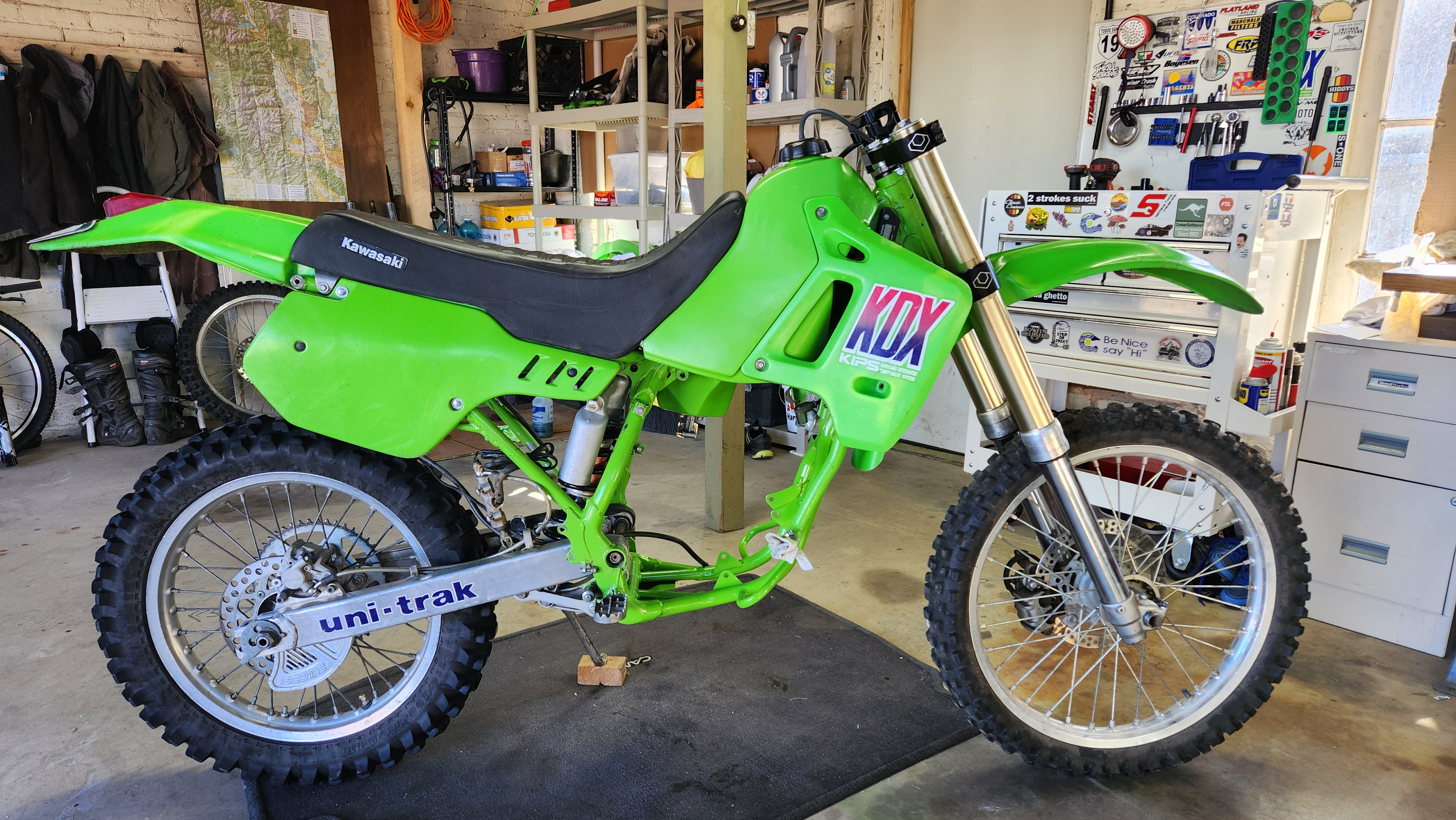

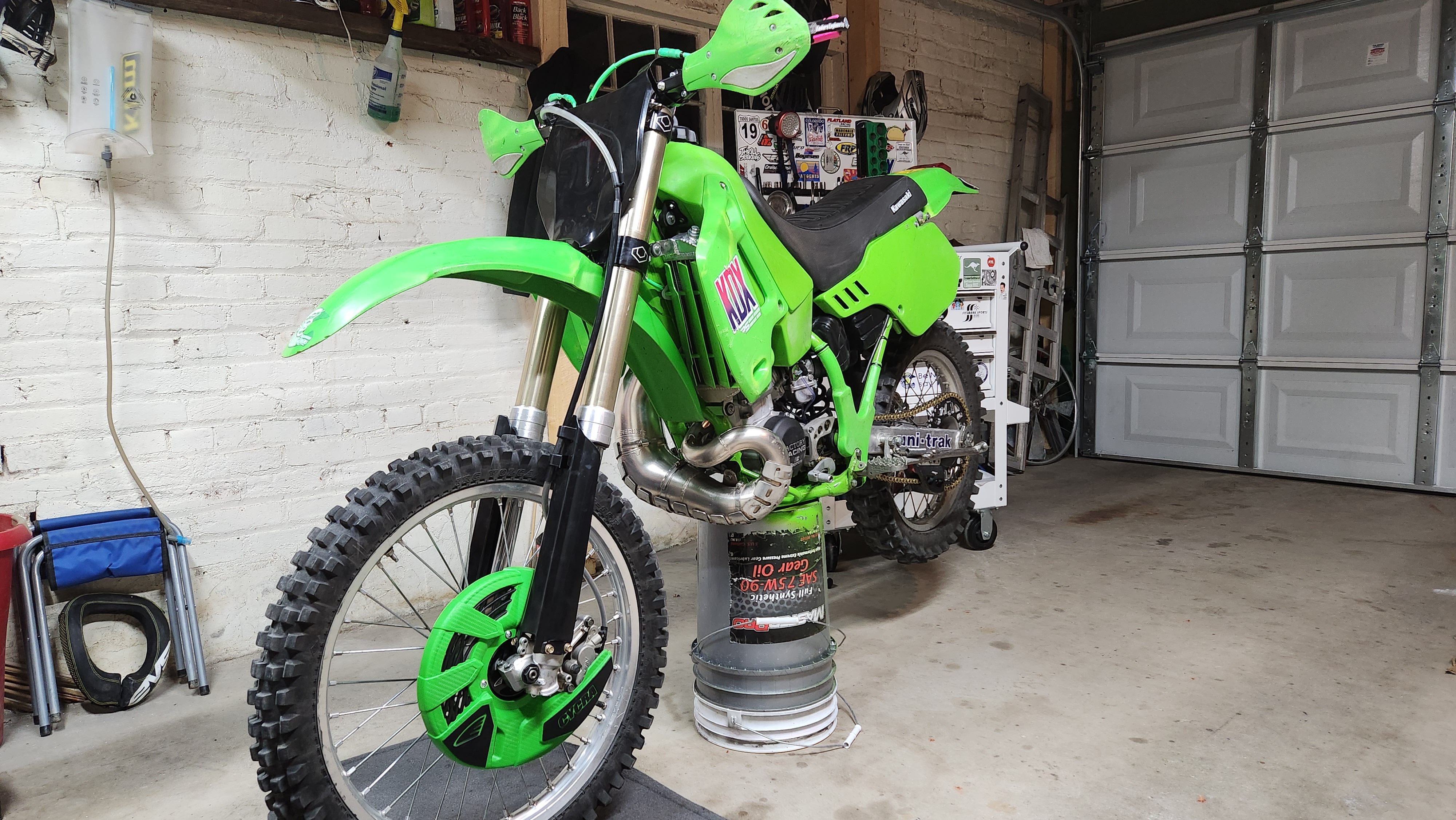

Couple more pics, they clear the tank and radiators just fine.
- 20240128_105423.jpg (2.95 MiB) Viewed 13953 times
- 20240128_105352.jpg (2.58 MiB) Viewed 13953 times
