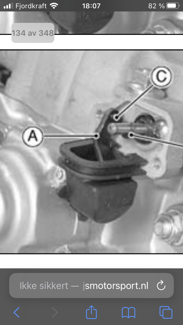

Hi! Sorry to bother if this is a topic elsewhere, but I didn't manage to find an answer I am looking for.
I unfortunately unscrewed the lever (a)
My question:
How does one put this back in its position (is it aligned with the rear e-clip? ) ?
-1991 KDX250SR (japan mod).

Later KX model but give a good idea how to install. About 20min into this video.

Yes, thanks! That's the way I fitted it now.

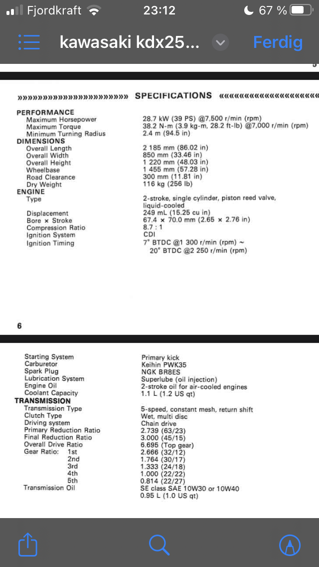

Changed mj to 160, and pj to #40, needle in 4th groove. Still rich on low rpm, but it idles nicely.
Yes I know mj 128 is lean (with no lid on the airbox), but it's stock size along with #42 pj.
The carb is 35mm pwk. It's not a KDX250 (US version, which has a 38mm and different jetting and piston etc).
