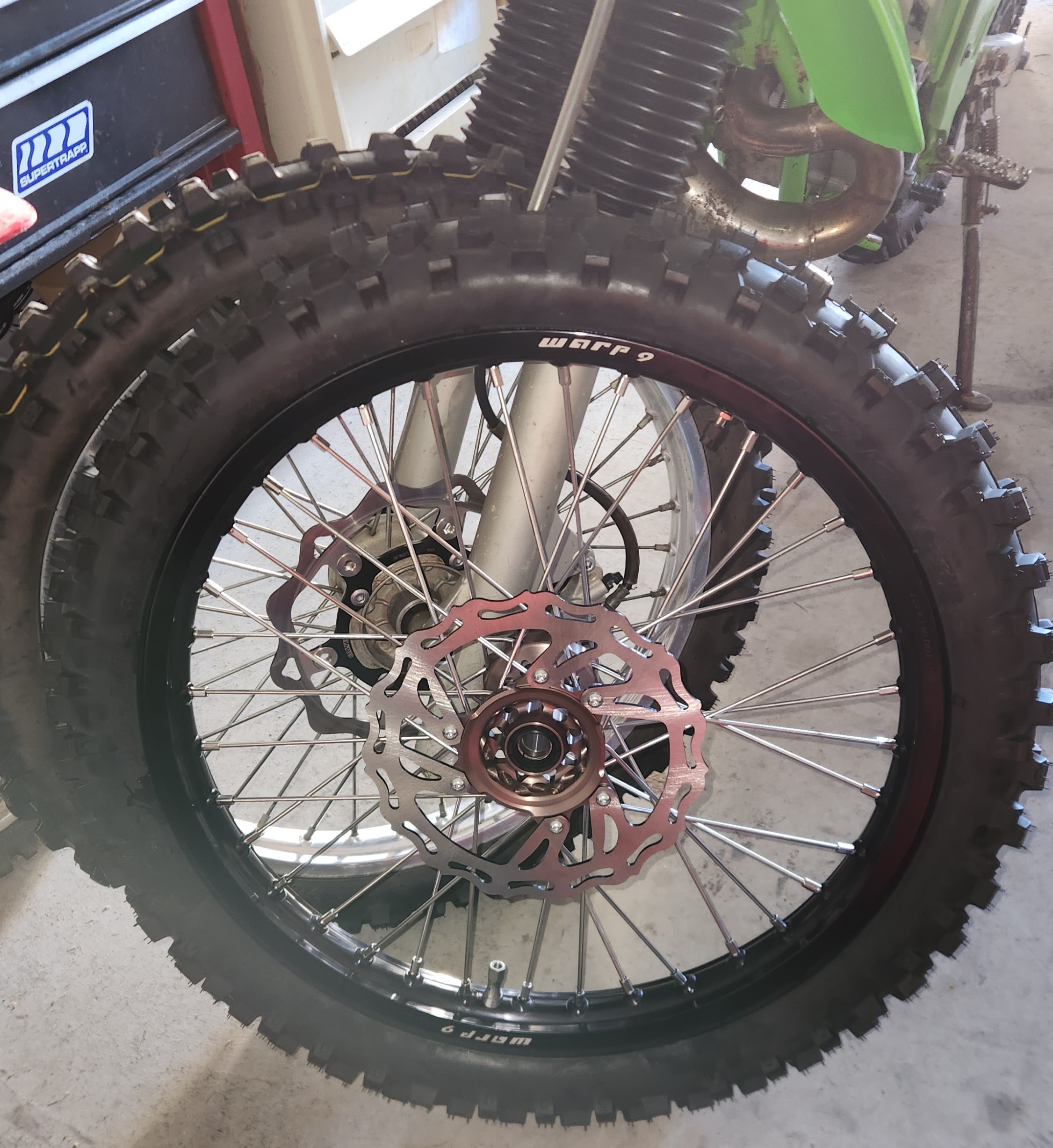

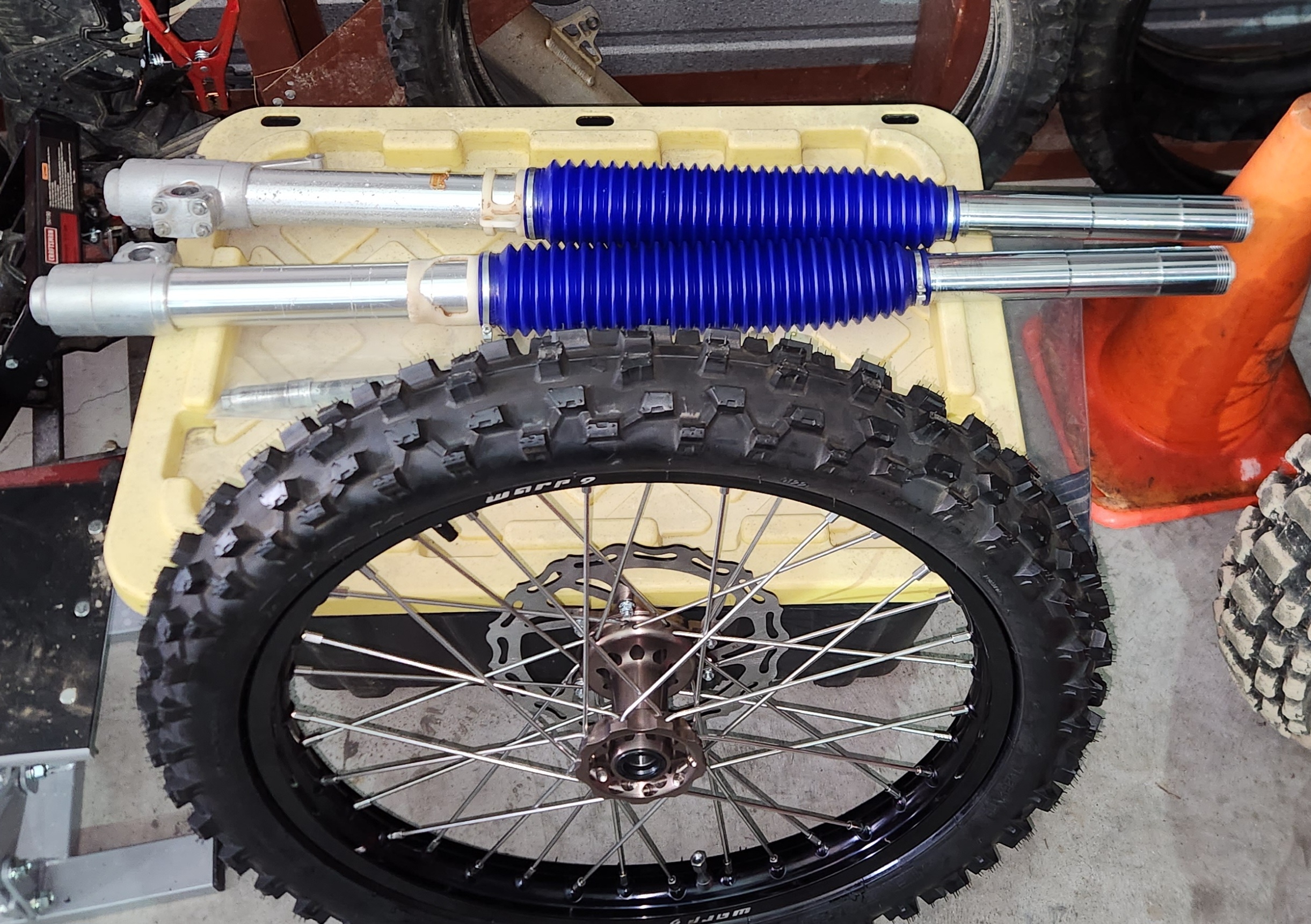

I got my new warp 9 complete front wheel in. It is a xr400r wheel. I will be installing the xr400 forks and wheel over the weekend. I found UFO plastics in Italy had a sale on plastics, so I ordered side plastics and rad shrouds and frame guards. She will be almost new! Tired to add picture of wheel, and got an error, file too large.

Re: New front wheel!
Posted: 12:35 am Jan 12 2024
by Ewbarger
There we go. Had to cut the photo down!
She gonna be sweet looking when I'm done!

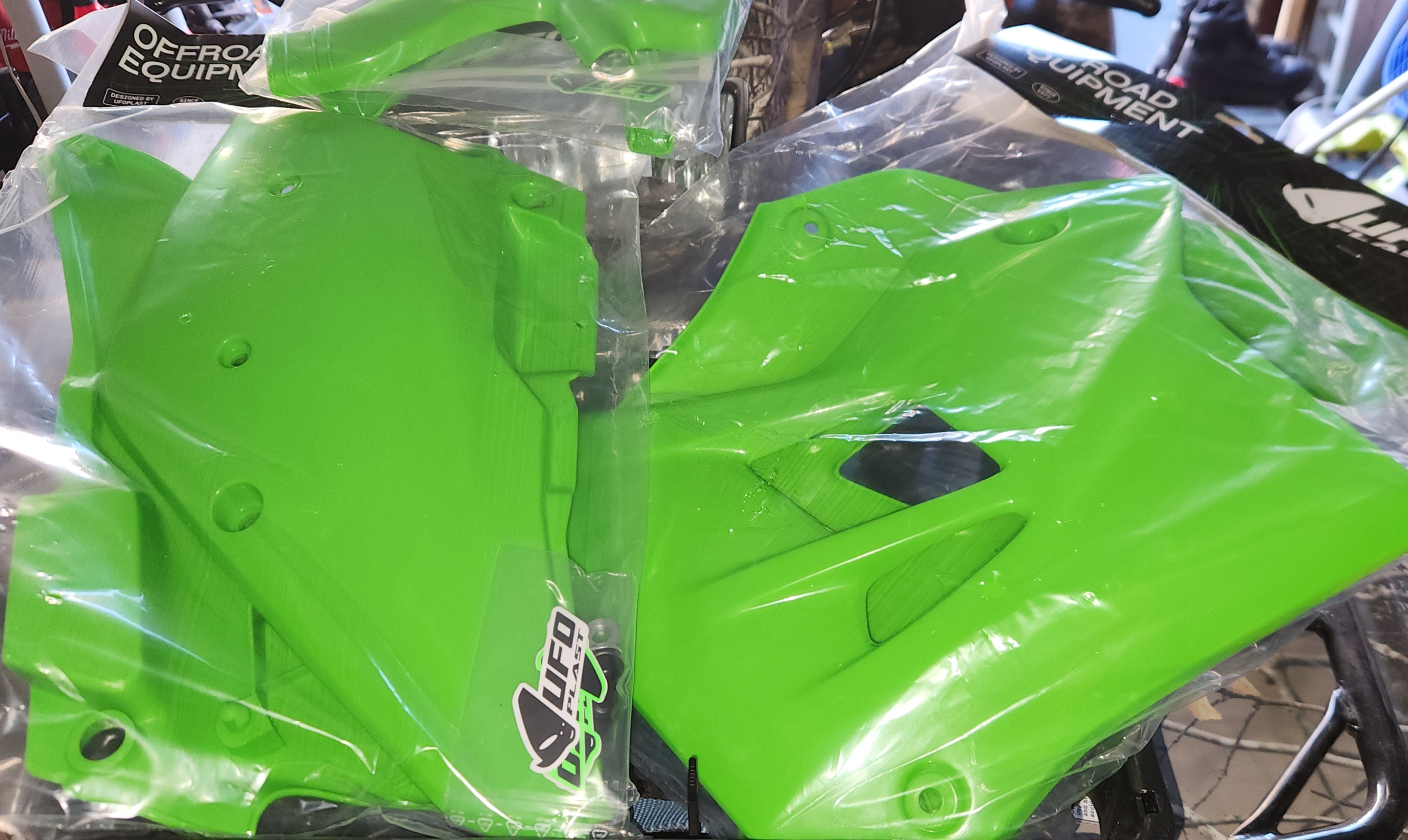

New UFO plastics came in Friday. Ordered Monday from Italy, they had a sale ,30 for side covers, 30 for shrouds, and 12 for frame guards.

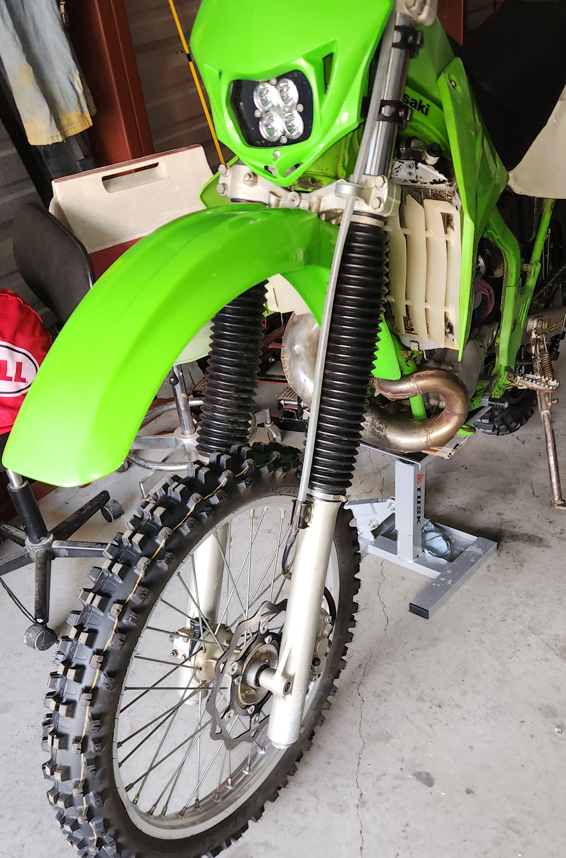

Here is a before picture

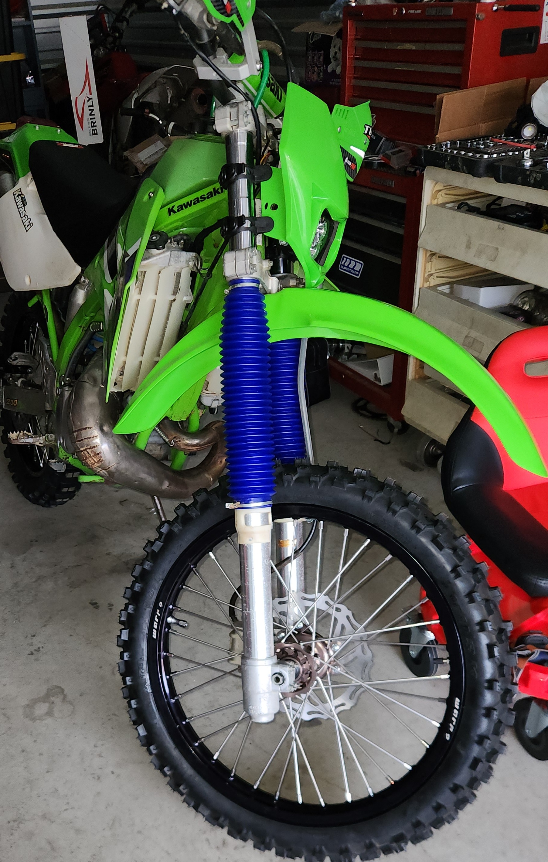

by Ewbarger
And after. XR400R forks, New Warp 9 XR400R wheel.

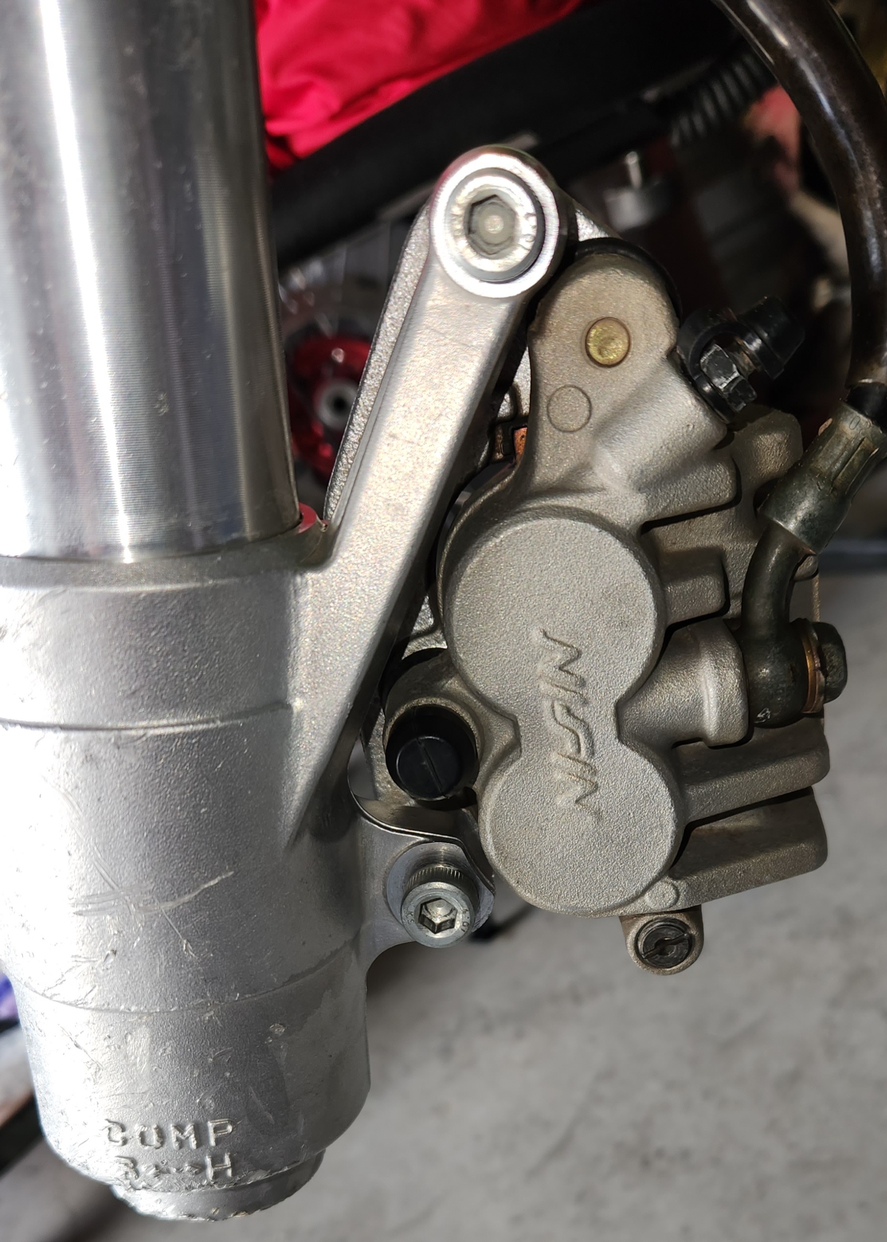

by Ewbarger
KDX caliper bolted right on.

Posted: 01:13 pm Jan 28 2024
by SS109
Looks sweet! :supz:
