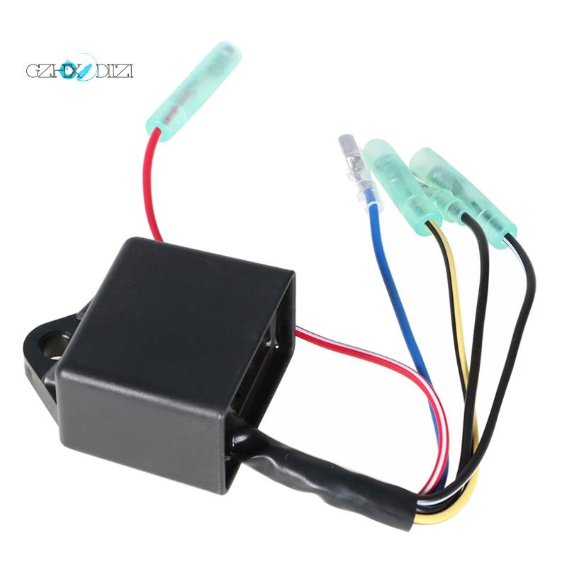

I have a 93 KDX200 (Blue USD Forks) with literally no wiring, it was in pieces. I think I'm missing a CDI as diagrams suggest a 93 should have one. I do have the coil, the Regulator (two wires, fitted in top of airbox) but also have the item in the picture, its bolted to the frame behind Rad next to the coil. I assume its a rectifier of some sort - but confused why it would need one if there is already a regulator? Maybe someone can tell me if I need this item at all.
Bike will only be used in the woods so I want it wired really simple. No ignition switch, no lighting (but I could get 12v off the regulator if I want a light in the future) Just want to get spark to get it going. I can wire a kill switch to ground the coil to stop it.
If anyone can suggest a simple wiring diagram to achieve this I would much appreciate. Stator is a 4 wire version. I don't want to guess at wiring colors and damage any components!
I've added a pic of the CDI I will have to use, its a Chinese knock off of one for a 95 up KDX200 , cant source one specifically for a 93. maybe some wires different but hopefully enough for a spark...
