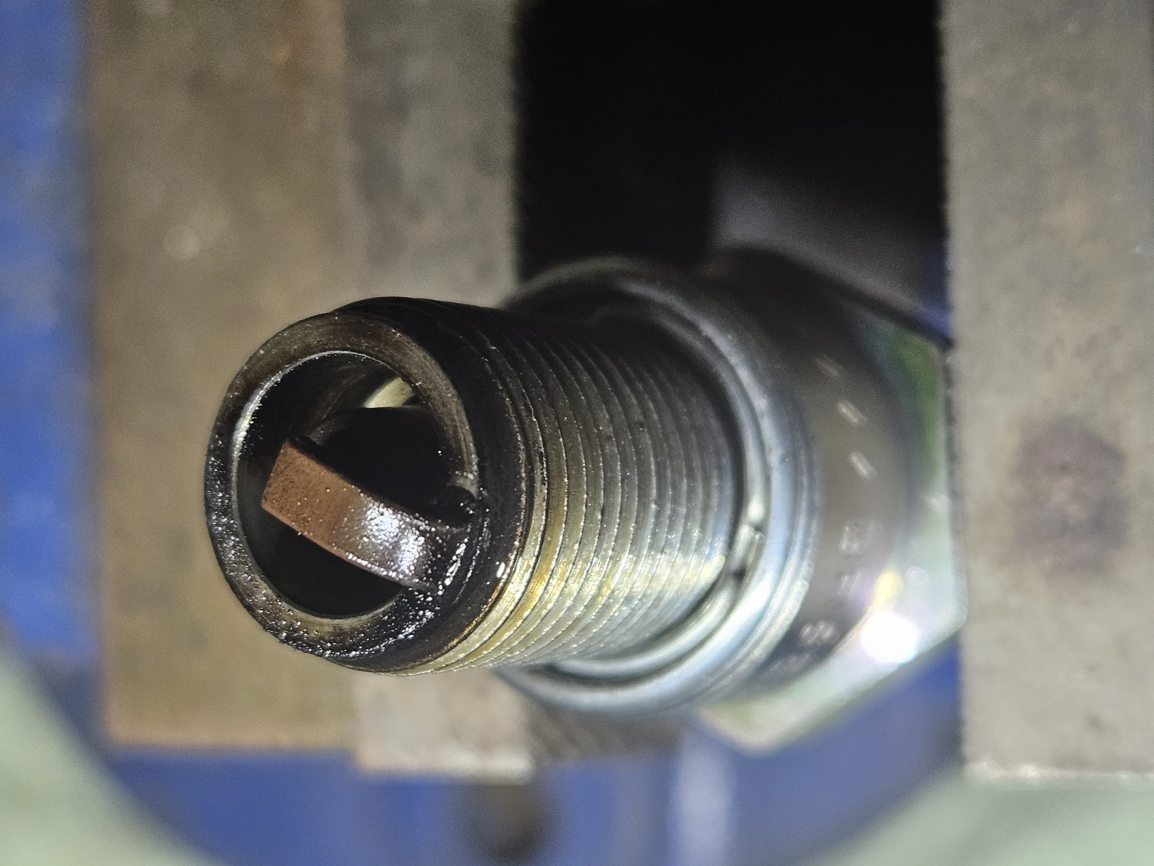

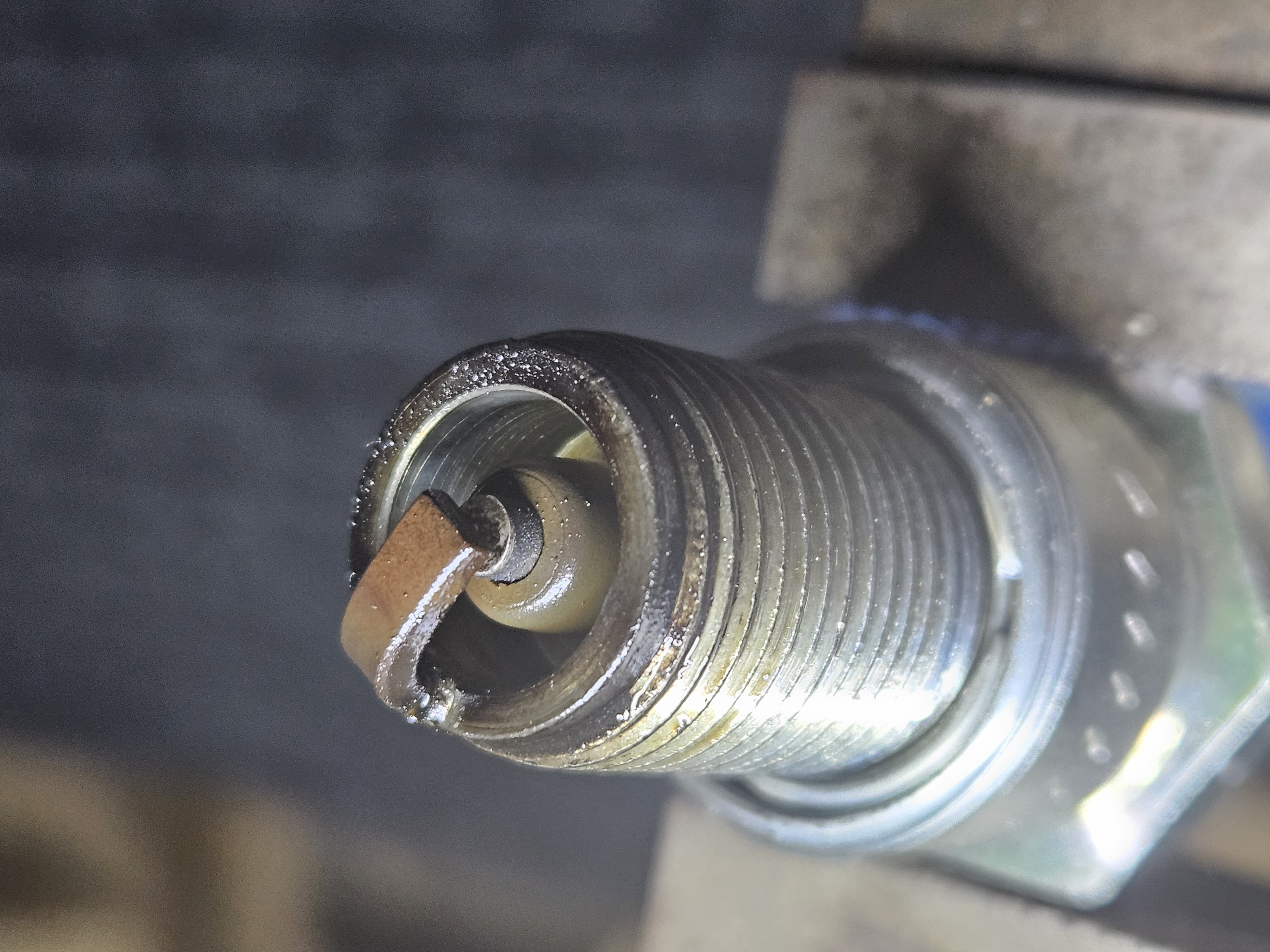

Hmm, maybe you should just R&R the right side case cover and throw all new gaskets and seals on that side and see how it goes. How's your plug look? Do you foul plugs? Does it excessively smoke?

The plug has never fouled on me. I'm running on the same plug for a few years now.SS109 wrote: 04:59 pm Nov 26 2023 Hmm, maybe you should just R&R the right side case cover and throw all new gaskets and seals on that side and see how it goes. How's your plug look? Do you foul plugs? Does it excessively smoke?

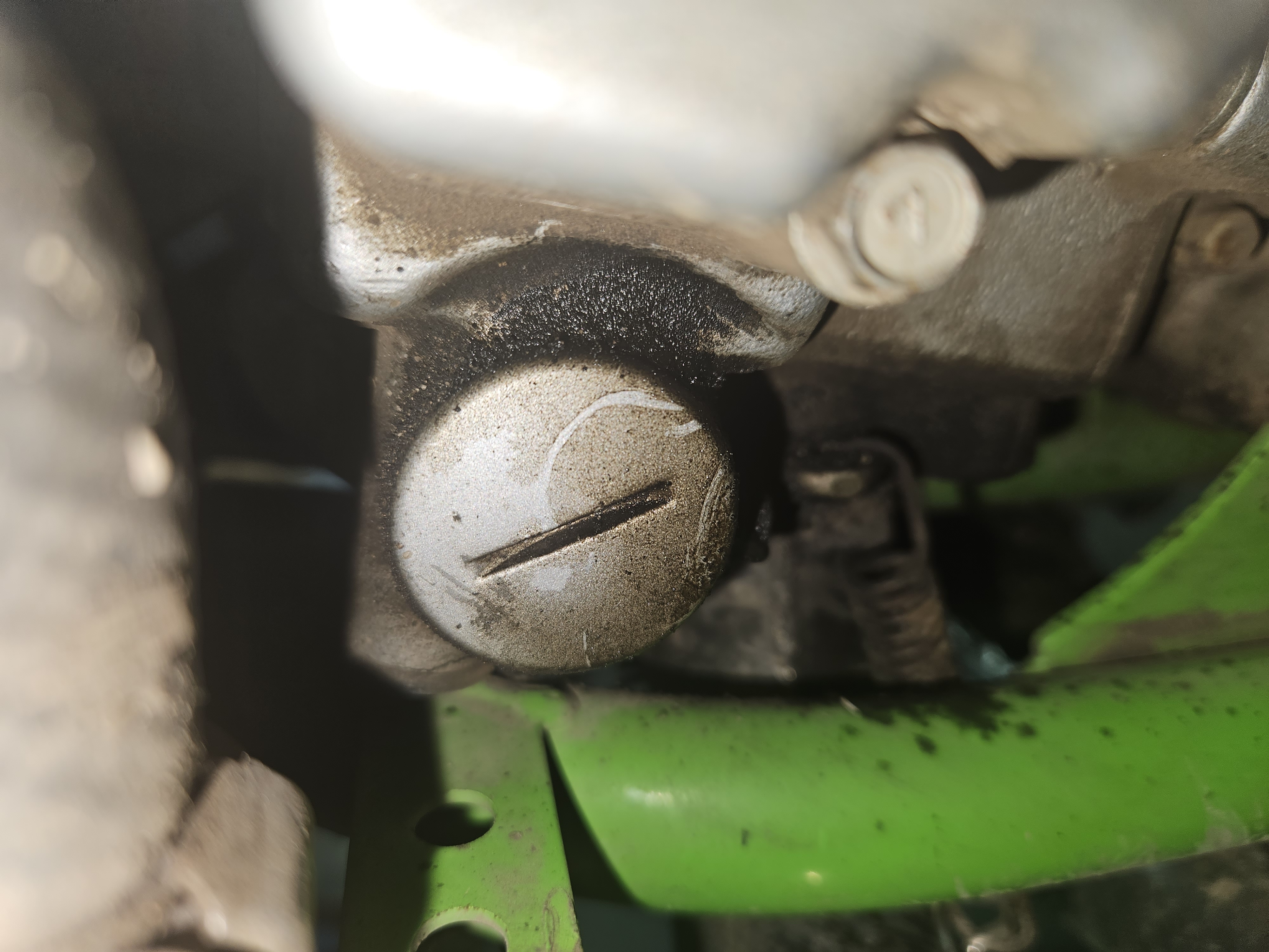

Hope you are right, I will proceed this way for now. Also I wonder if I would be able to see if a seal is leaking by taking off the clutch cover side of things first. I just want to stop any leaks. The KIPS cover is also leaking.kdxdazz wrote: 08:15 pm Nov 26 2023who ever wrote about the pressure of the leaking seal doesn't know what he is talking about, the gearbox is vented and never pressurized, i would just change all the external seals and enjoy it, cheap and easy, if you do a rebuild later down the track then the seals are already changed anyway, then you only have crank seals to changestnd wrote: 03:54 pm Nov 26 2023 Hi,

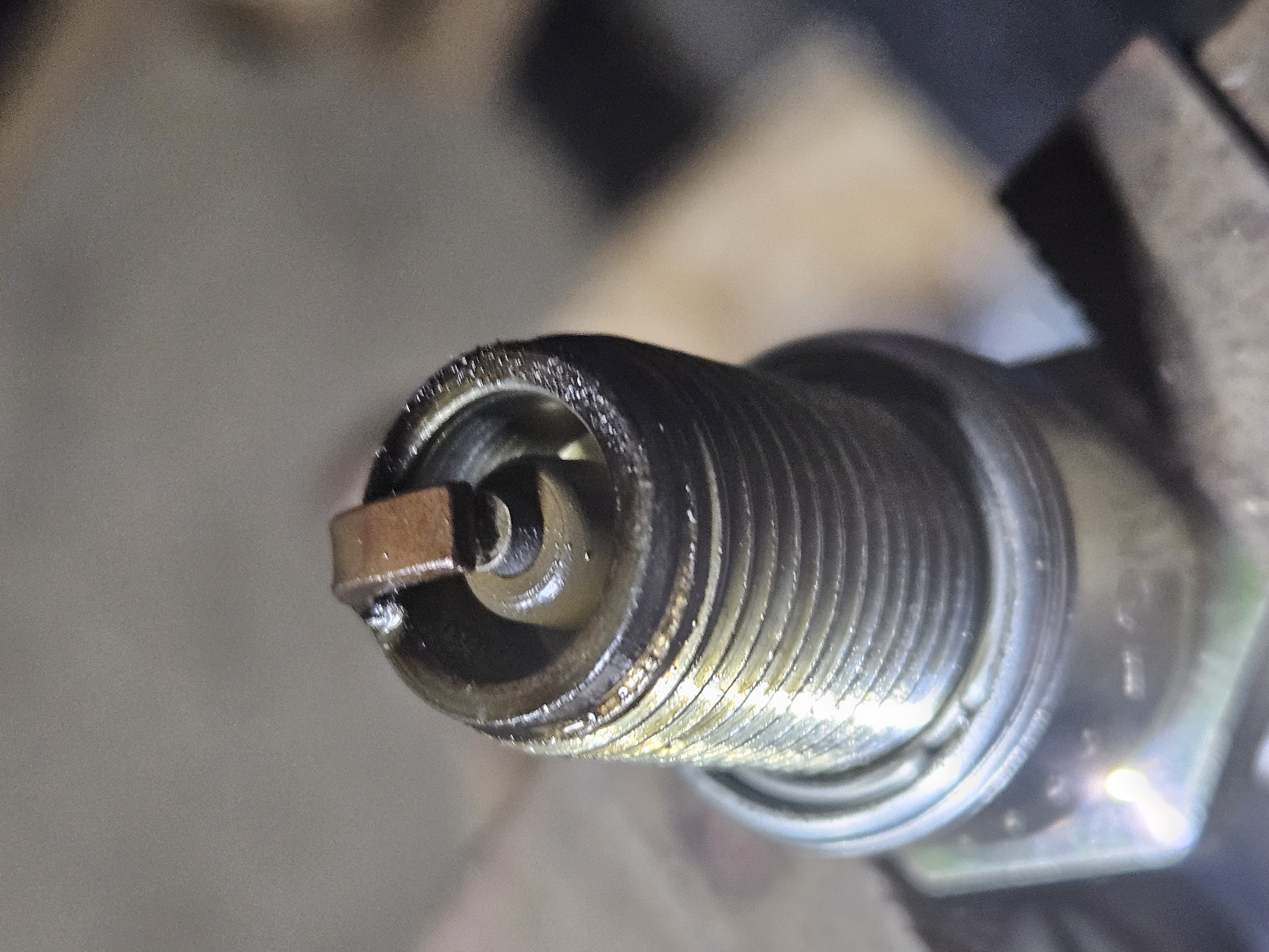

I know pictures can be deceiving but are those little globs of aluminium on the plug?

I will double check, but pretty sure it is just carbon deposits. I zoomed it too much with a flashlight on it.kdx633 wrote: 04:09 pm Nov 27 2023 I know pictures can be deceiving but are those little globs of aluminium on the plug?

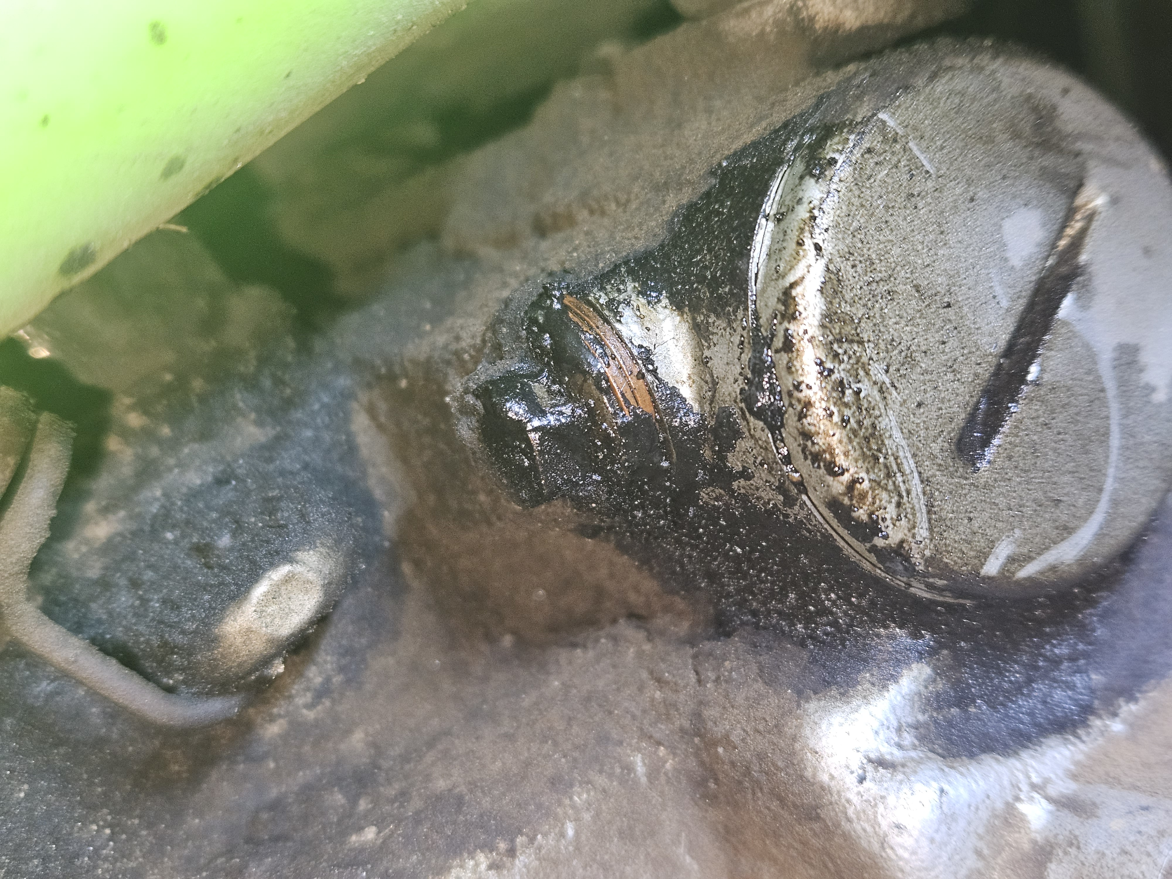

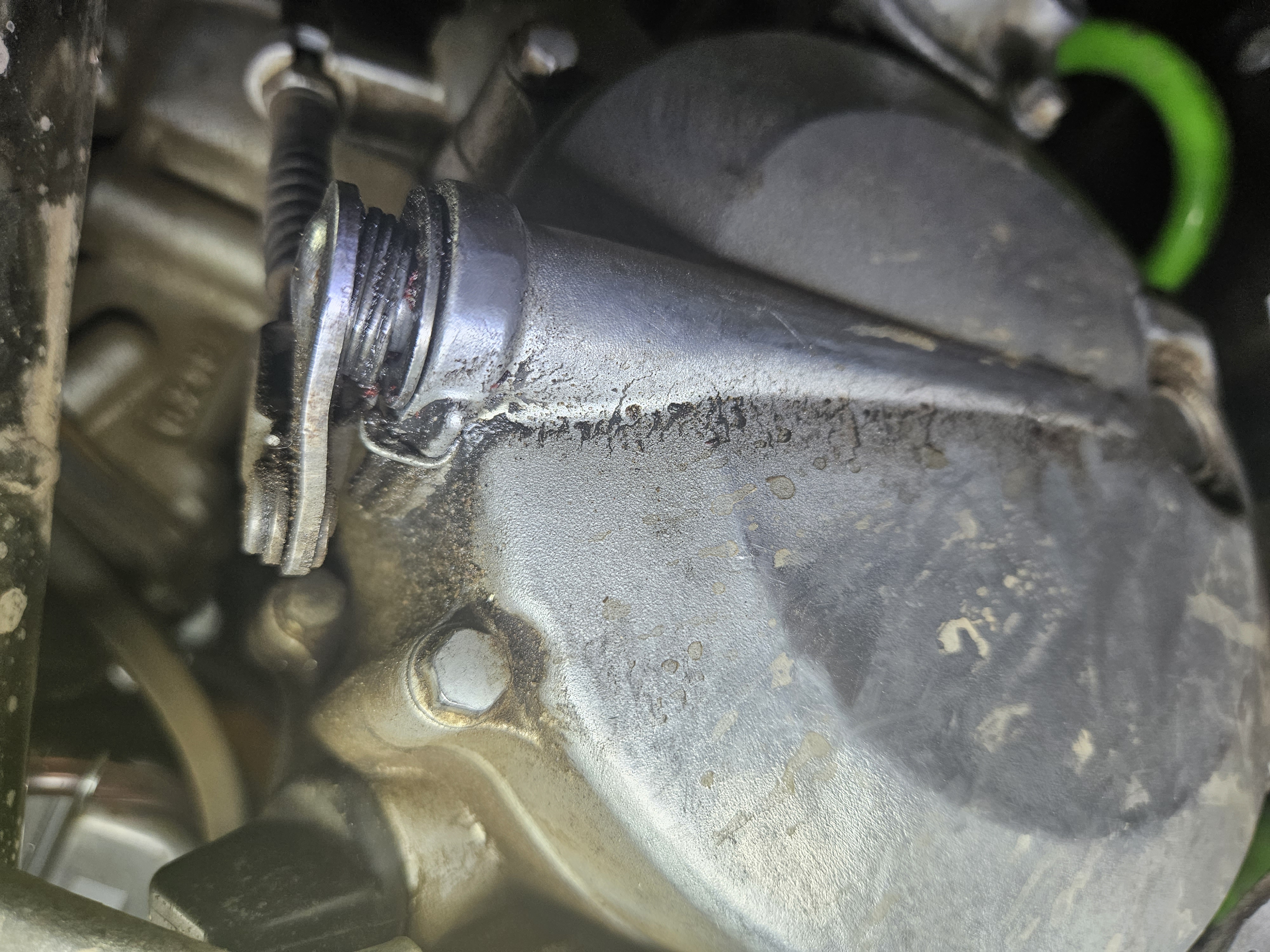

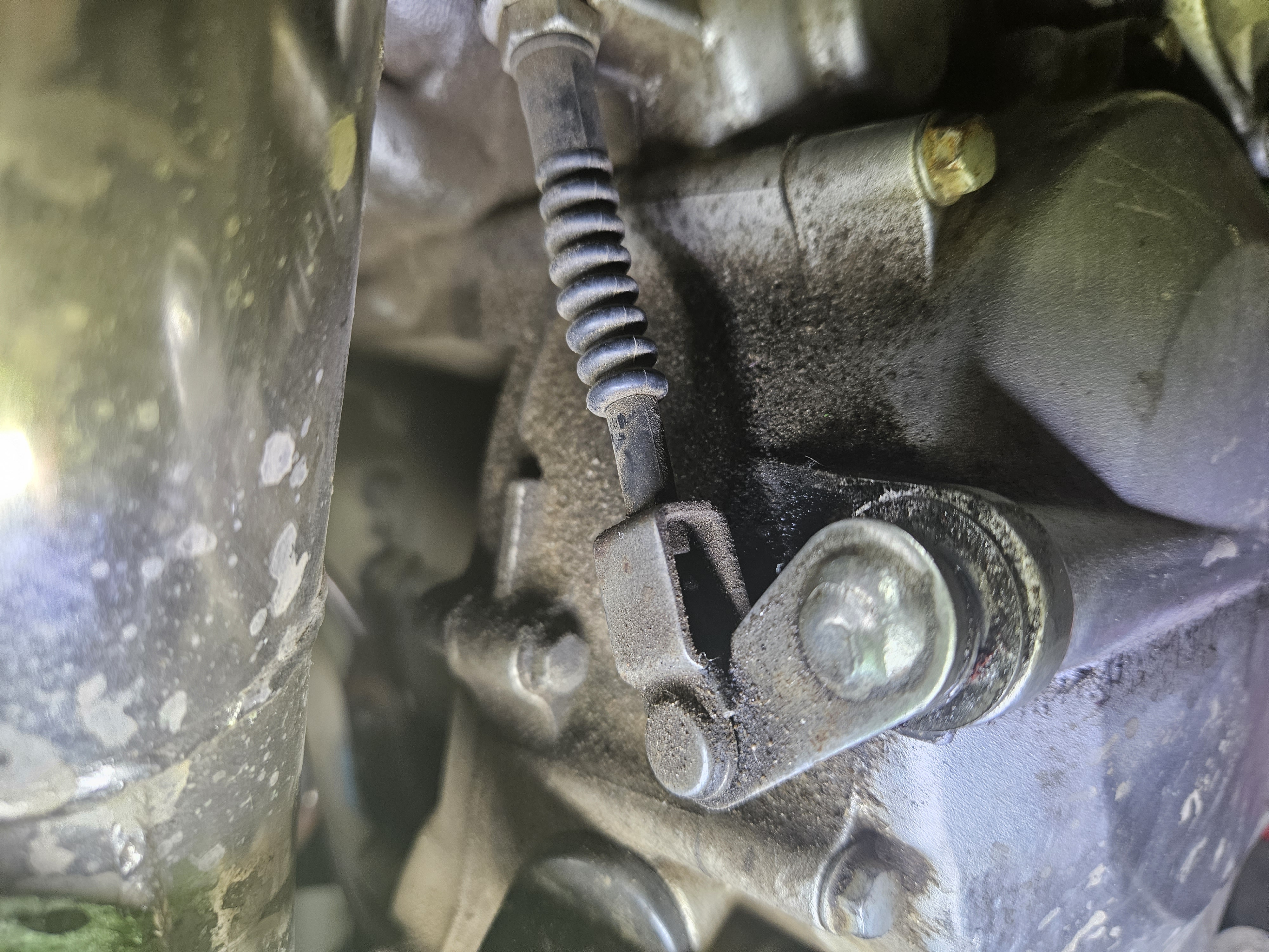

The clutch actuator leak is a simple seal. The leak around the KIPS cover on the LH side of the engine is also an O-ring. Just looks like the bike has not been given preventative maintenance for a bit. With 150 psi compression IIWM I would replace those seals like SS109 and kdxazz suggested and ride it until it really needs service.

Thanks for the advice. Do you know what the seal on the clutch actuator is? Looking at the fiche I don't see any seal. Found it. 92049-1262bufftester wrote: 06:46 pm Nov 27 2023 The clutch actuator leak is a simple seal. The leak around the KIPS cover on the LH side of the engine is also an O-ring. Just looks like the bike has not been given preventative maintenance for a bit. With 150 psi compression IIWM I would replace those seals like SS109 and kdxazz suggested and ride it until it really needs service.

Yep, and the O-ring for the other side is 670B2022stnd wrote: 07:35 pm Nov 27 2023Thanks for the advice. Do you know what the seal on the clutch actuator is? Looking at the fiche I don't see any seal. Found it. 92049-1262bufftester wrote: 06:46 pm Nov 27 2023 The clutch actuator leak is a simple seal. The leak around the KIPS cover on the LH side of the engine is also an O-ring. Just looks like the bike has not been given preventative maintenance for a bit. With 150 psi compression IIWM I would replace those seals like SS109 and kdxazz suggested and ride it until it really needs service.
