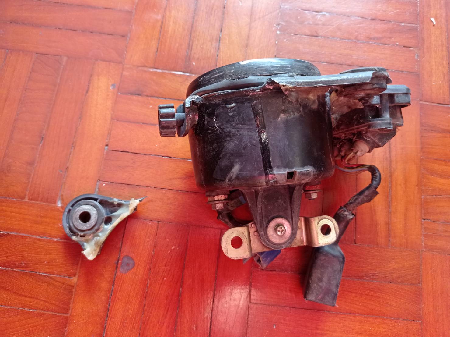

unless the previous replies know something i don't you can't just move it up or install longer bolts, the instrument cluster is bolted and supported at the front of the top triple clamp as can be seen in the photo, the 2 mounting points that bolt to the risers are there to position it,not to support it thats why they are rubber damped and if you just use those points they will snap as can be seen in my photo, its possible you could make up a new lower mounting bracket but as you raise the instrument cluster it also brings it closer to the front of the triple clamp due to the angle of the risers, anything is possible i guess but you will need to be in contact with a skilled fabricator, also you will need to know how much slack is available in the speedo cable, my guess is much less than 2 inches

Thank you for pointing out my mistake and sorry, unfortunately all we got on the 220R was a single little trip meter that mounted to the top bar clamp so it could easily be moved around, was trying to work off that never seeing the 220SR cluster lower mount..kdxdazz wrote: 07:55 pm Nov 02 2023 unless the previous replies know something i don't you can't just move it up or install longer bolts, the instrument cluster is bolted and supported at the front of the top triple clamp as can be seen in the photo, the 2 mounting points that bolt to the risers are there to position it,not to support it thats why they are rubber damped and if you just use those points they will snap as can be seen in my photo, its possible you could make up a new lower mounting bracket but as you raise the instrument cluster it also brings it closer to the front of the triple clamp due to the angle of the risers, anything is possible i guess but you will need to be in contact with a skilled fabricator, also you will need to know how much slack is available in the speedo cable, my guess is much less than 2 inches

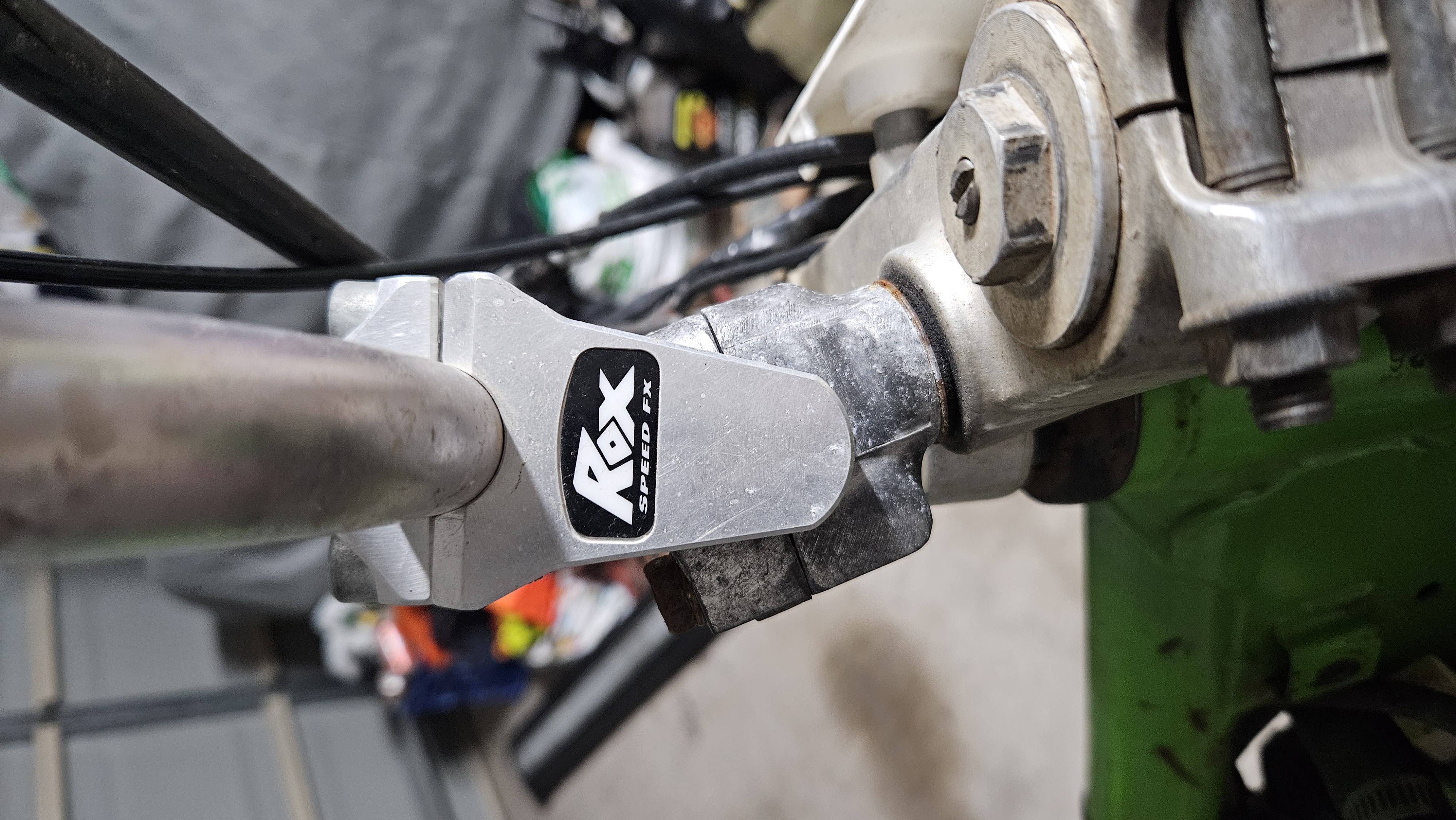

Re: Anyone have bar risers on their SR model?
I am also 6 2 and I fitted these. The work well and made it much more comfortable for me to ride
