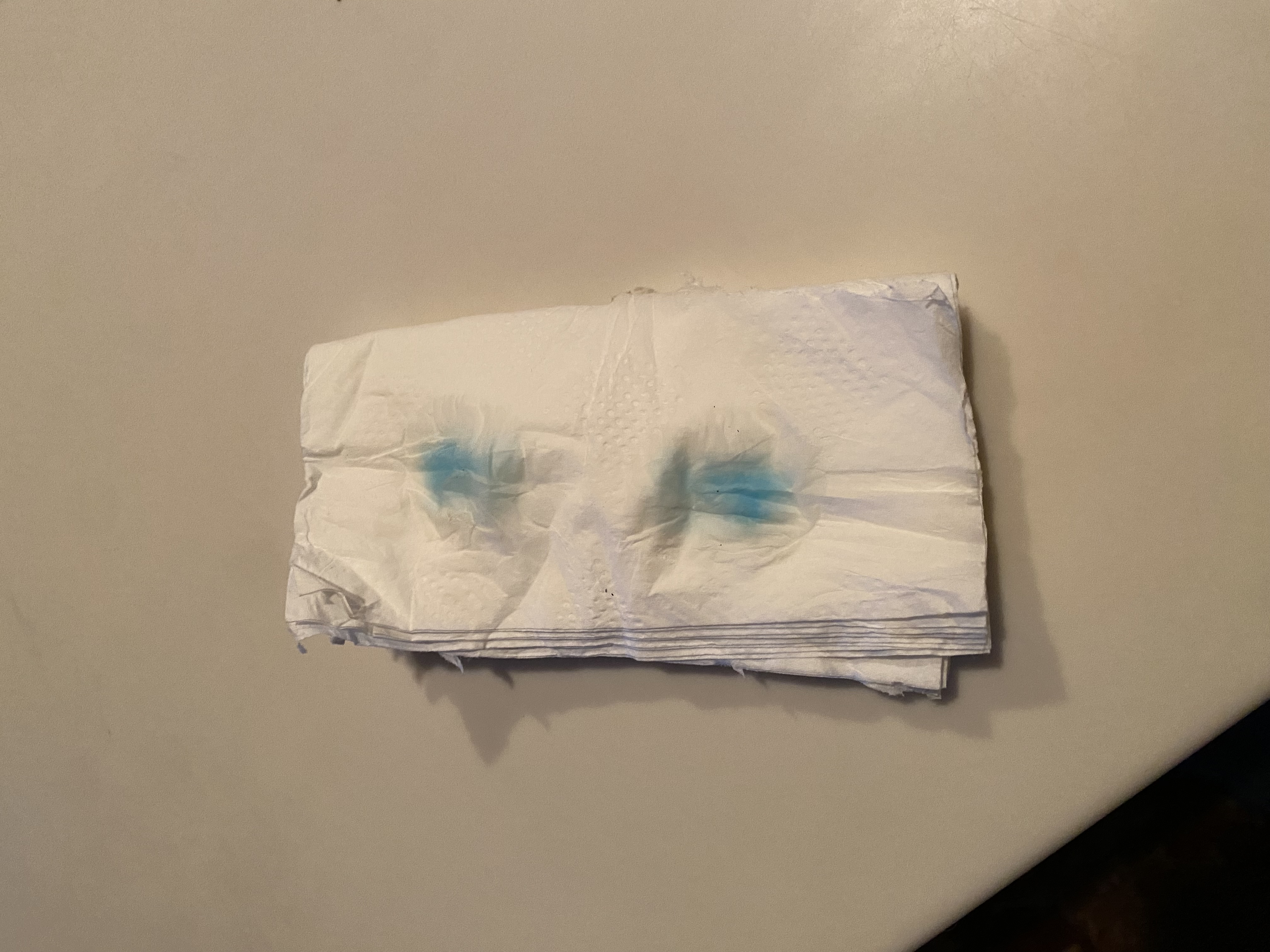

          No problem, glad to see the part is still available. I just took it for a 15 minute ride around some fields and trails.. Anyways I taped some napkins to the overflow vent hose and this is what I saw. Their is in fact coolant coming out of the overflow vent, even with the coolant level below the low marking. Got on it hard a few times and I smelt no coolant from the exhaust, smells good like a 2 stroke should. The hotter the engine gets/harder I ride , the less it smokes which is related to the way I have it jetted. Still confused about seeing some air in the system when cracking the bleed screw earlier. I think I’ll keep riding it and see if the coolant level in the tank reaches a stand still.

          Re: E Series coolant reservoir loss
          How is the overflow hose routed?
          Hopefully it is just leaking there and not internally.

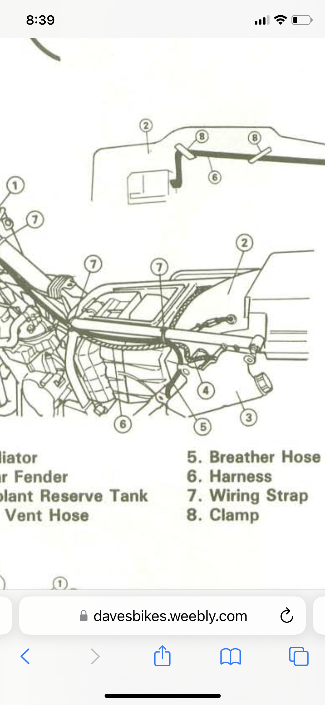

          Good question, just looked at the routing diagram. #4 is the breather vent hose. It looks like it makes its way up the frame toward the gas tank. Mine is routed down toward the left toward the swing arm. Maybe that’s part of the problem. Not sure where the vent hose should actually end if going up the frame.

          JZ05220r wrote: 07:42 pm Oct 16 2023 Good question, just looked at the routing diagram. #4 is the breather vent hose. It looks like it makes its way up the frame toward the gas tank. Mine is routed down toward the left toward the swing arm. Maybe that’s part of the problem. Not sure where the vent hose should actually end if going up the frame.
          The overflow hose(#4) from the tank runs over the top of the rear fender just behind the rear airbox bar out the right side of the frame, you can sort of see it in that photo, I don't remember where it went after that. If you have the tank might as well use it, just keep a small amount in it and it will draw the coolant back and forth. If you get in a slow section and the engine starts to overheat the coolant flows into the tank, get onto a logging road the engine cools down, draws the coolant back. I don't think I add even 2 ounces a year in riding.

          Oh yea… you can prob see how I was looking at the diagram now but your are right it does go right over the rear fender along the bar behind the air box. I agree I’ll probably keep it. I’d really like to know where the hose continues outside of what the diagrams showing.
          I will bet one crisp dollar that your radiator hose pointing down is the cause. I think I did it that way and suffered myself many years ago.
          Look in the OEM service manual for how a new bike has the hoses routed. I do not mean by the routing diagram, but by looking at the pictures where they are working on the bike with the seat off. I have done this before to learn how it was when new.
          EDIT ADD ON:
          Look at the shock linkage arms pictures. It is ran in front of the right dog bone.
