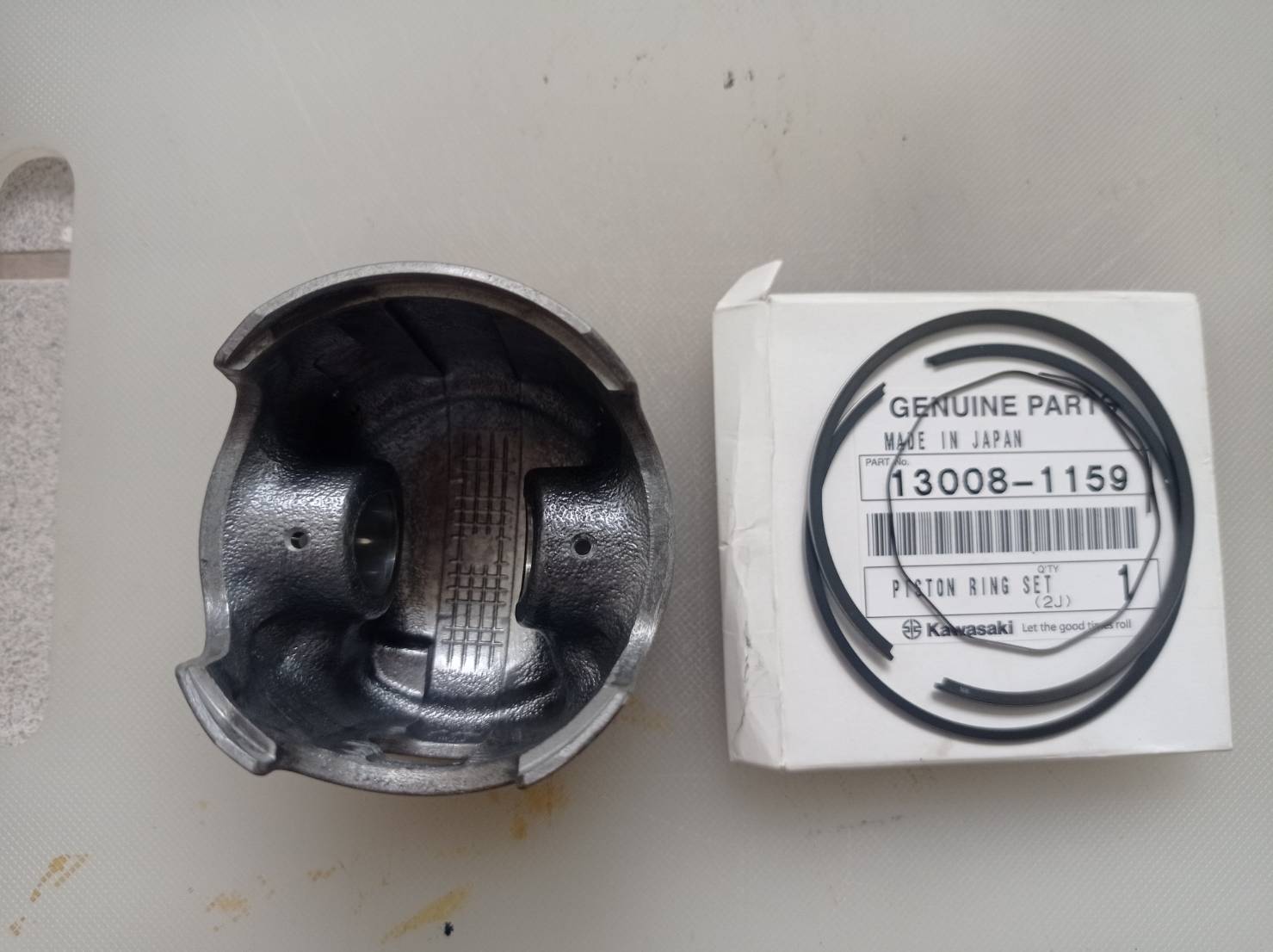

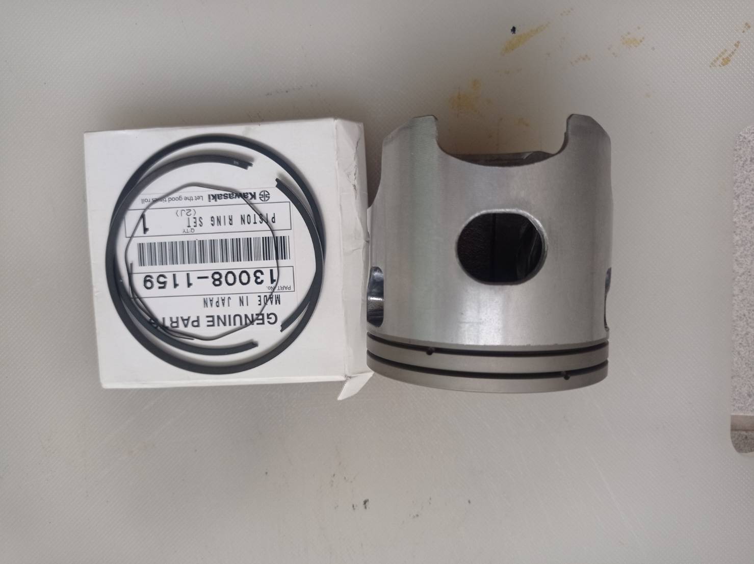

kdx220r and SR are the same piston and rings accoring to part number, i think its only early model kdx200 that the sr piston was different and im assuming thats just compression ratio
i'll be one of those rare guys that will be putting the stock kdx220 piston and rings back in, i have 2 kdx220sr's. as you may know from my videos i don't like forged pistons in hot jungles so opted for the cast piston but i meticulously deburred and chamfered the stock 220 piston and feel condifent i have solved at least 60 percent of the cracking issue

kdxdazz wrote: 08:11 pm Oct 15 2023 kdx220r and SR are the same piston and rings accoring to part number, i think its only early model kdx200 that the sr piston was different and im assuming thats just compression ratio
Thanks for the reply and Info king. I will order a 220SR Wiseco piston kit and when I get it I will add some comparison photos on both for the forum so people can find it in the future
