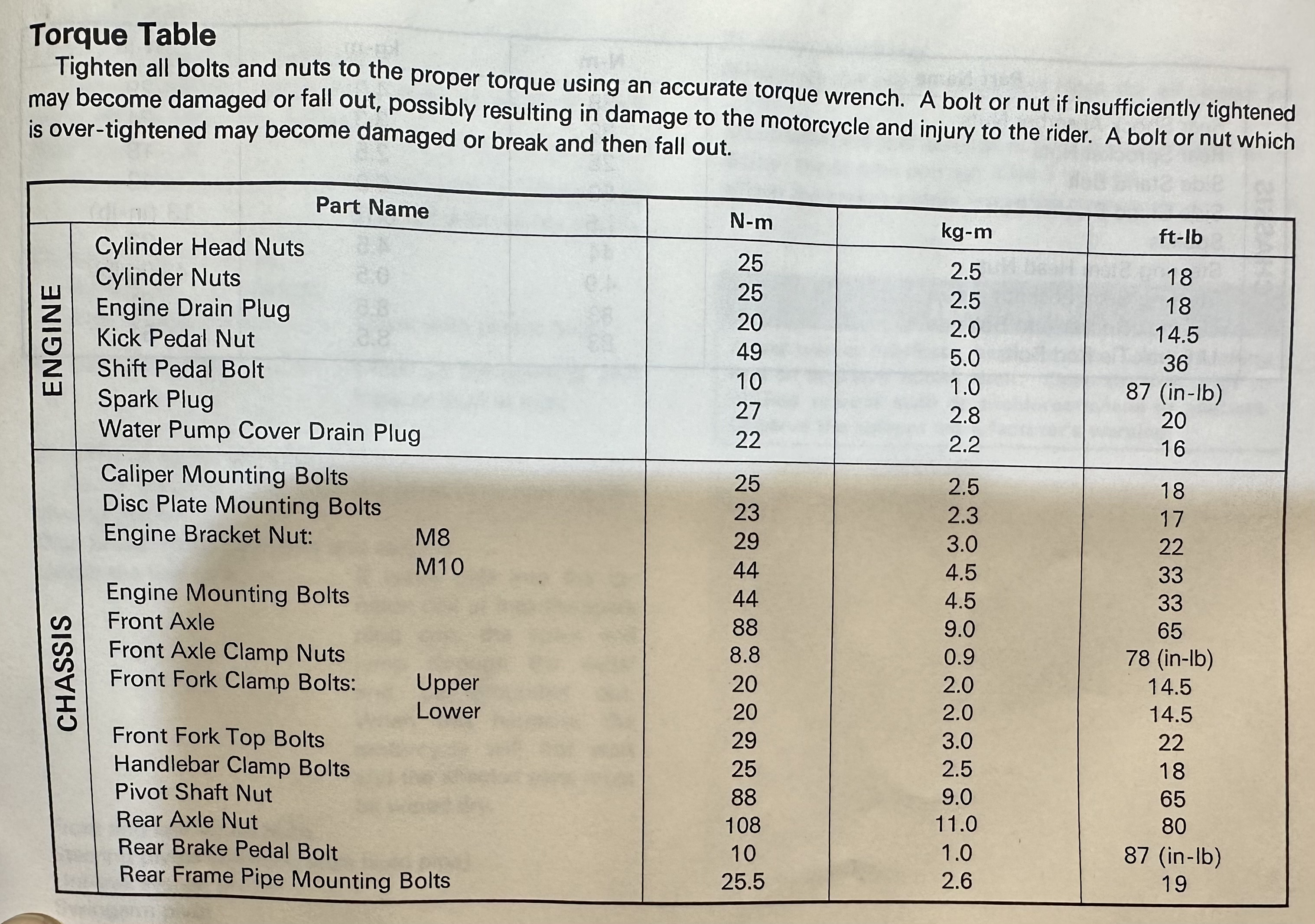

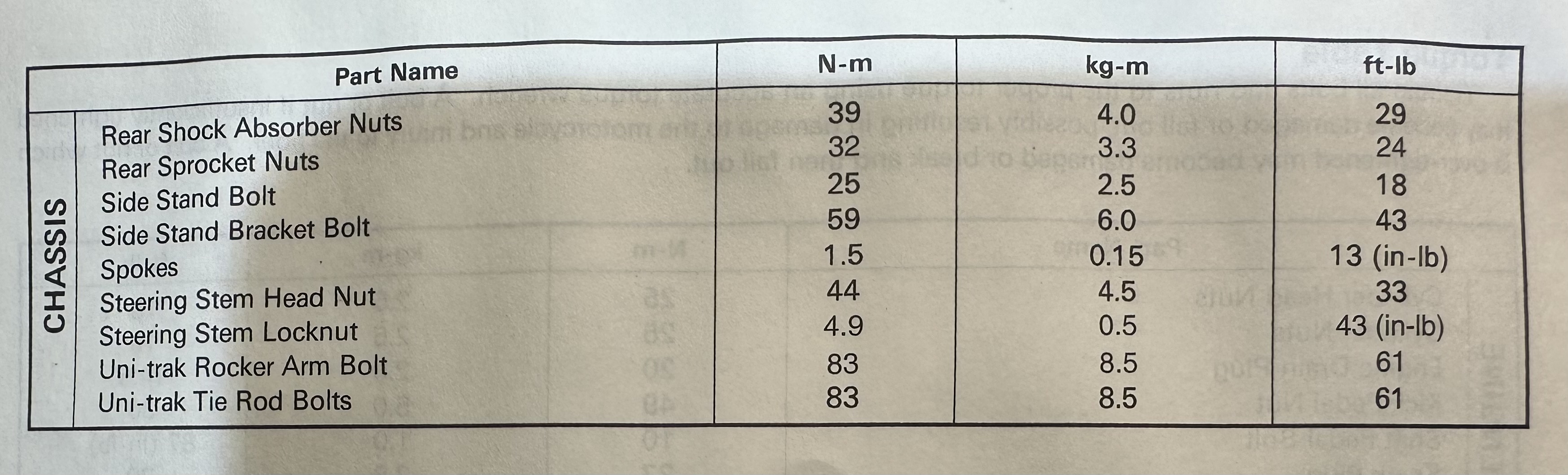

This is from my owners manual (2002 KDX 200)
- IMG_1964.jpeg (804.54 KiB) Viewed 6340 times
- IMG_1963.jpeg (1.46 MiB) Viewed 6340 times

Thanks for posting, Paul!
