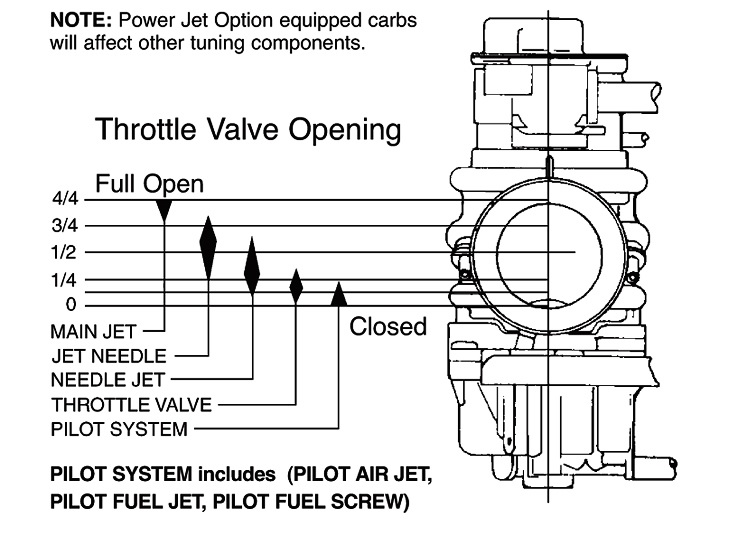

One thing I forgot to mention, the last 2 times I rode the 220 to test jetting (which now is at 135/35), it runs very smoothly at WOT, but in between (half throttle) it seems to stutter a lot and is not smooth. After just ten minutes of riding there is carbon on the plug. It idles just fine. Which makes me think, considering this diagram, that it has something to do with the needle (as someone mentioned before). I think I'm going to pull it out again today and take a look. Any thoughts?

That sounds like what mine would do if I lowered the needle clip one position. Idle and wide open good with a stutter in between. Try raising the clip one position at a time and test ride. Once you’re happy with the mid range it would be good to do a full throttle plug chop to make sure the 135 main you’re running is safe. It sounds like you’re almost there.
If it’s in clip 3 go to 2 and don’t be afraid to also test in 1. You may go back to 2 but it’s good to know what each feels and sounds like.
