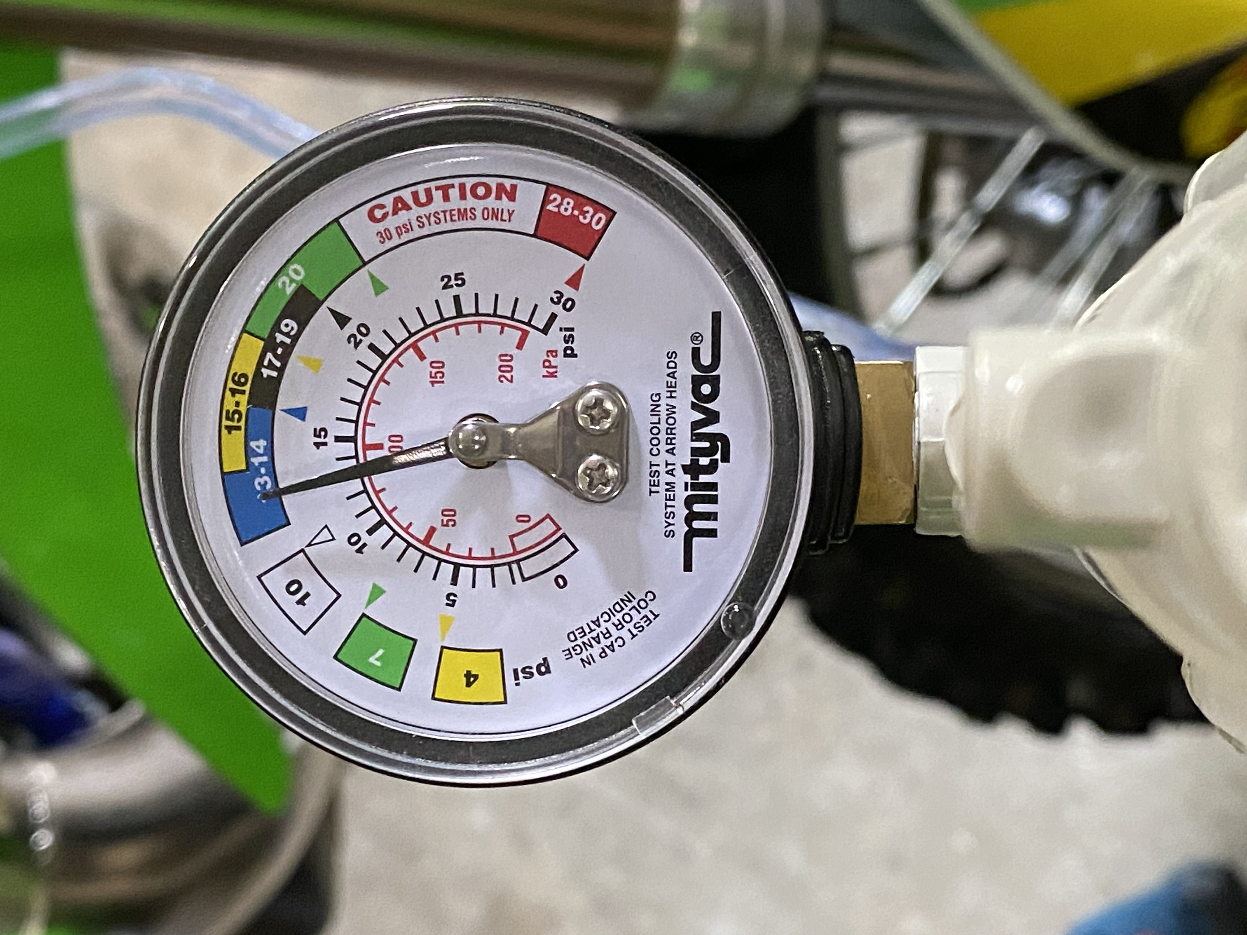

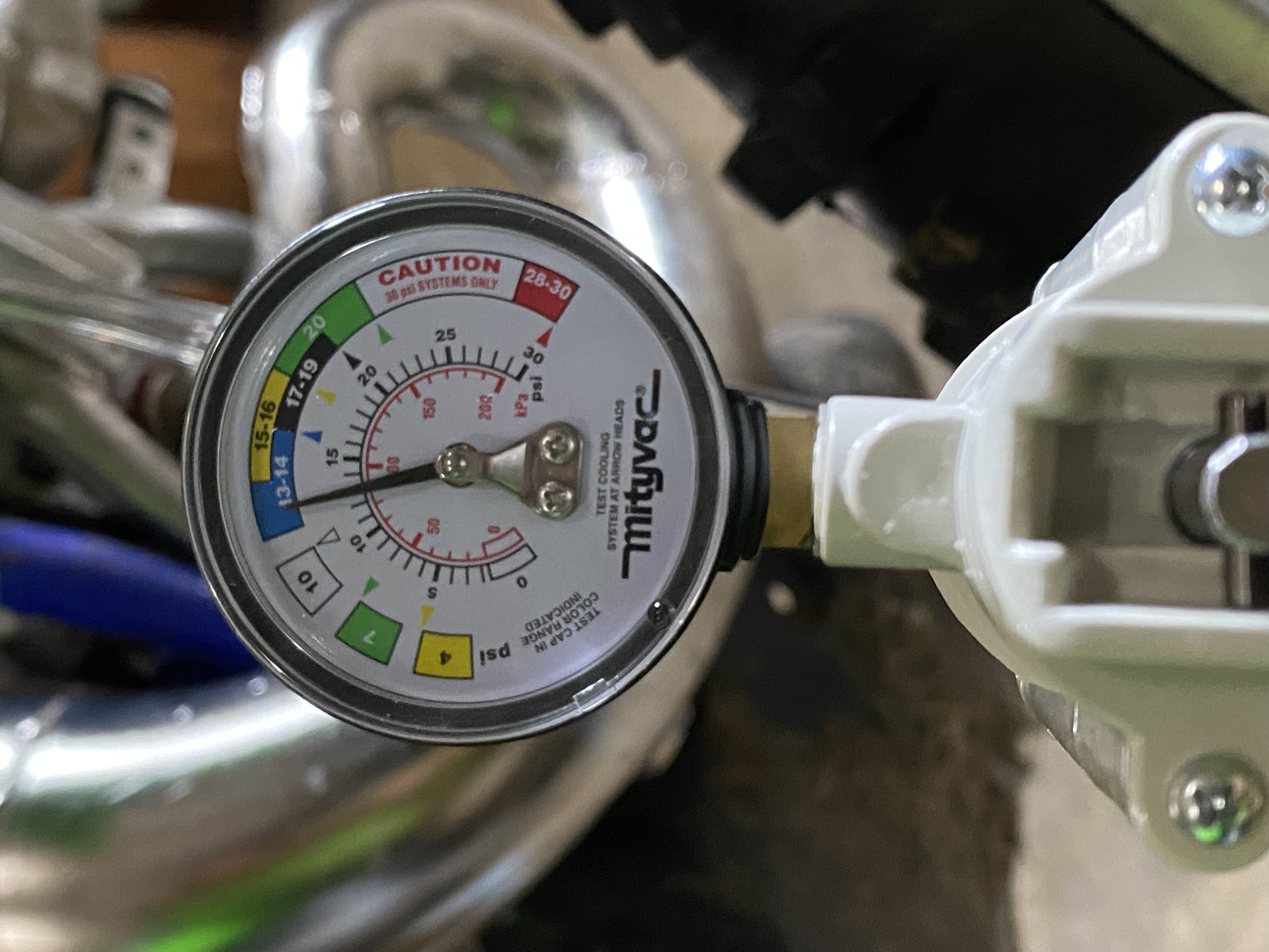

I was able to finally throw on a new oem headgasket to the kdx 220. I used my new mechanical torque wrench to criss cross tighten the cylinder head nuts in stages. I took a picture of the gauge pressurized to 14 psi before and after 5 minutes with bike off. There was a drop as you can see. I then did the running test and the needle is vibrating on the gauge. My god, this is just getting ridiculous. I swear im worried about ever touching another headgasket on any machine in the future at this point (I have went through numerous head gaskets and lapped the cylinder head trying to solve this issue) Not sure I’ll ever find out why because it just makes no sense to me. Very disheartening. https://youtube.com/shorts/NhxcP6uavA8? ... qxplNPFmnE

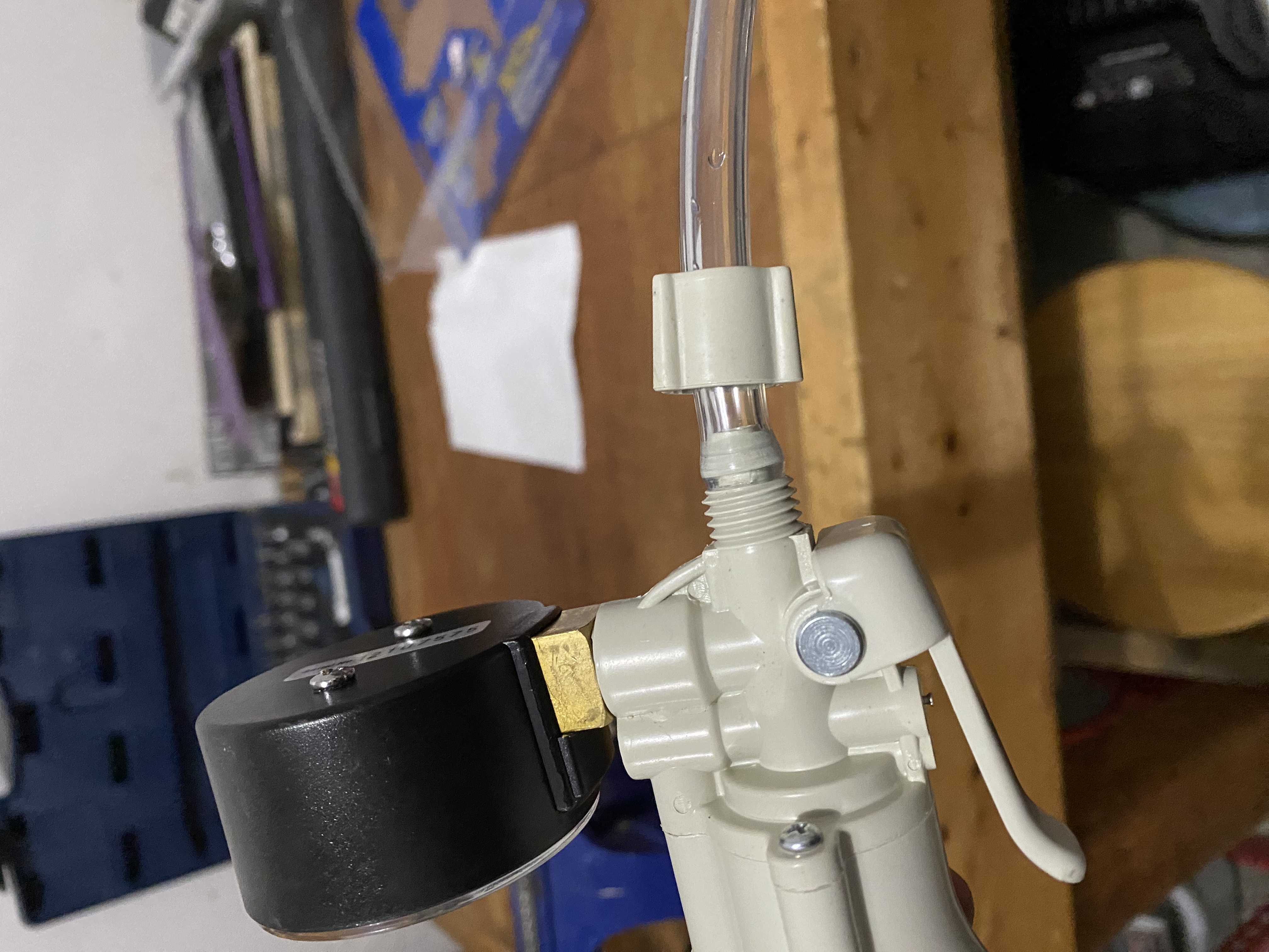

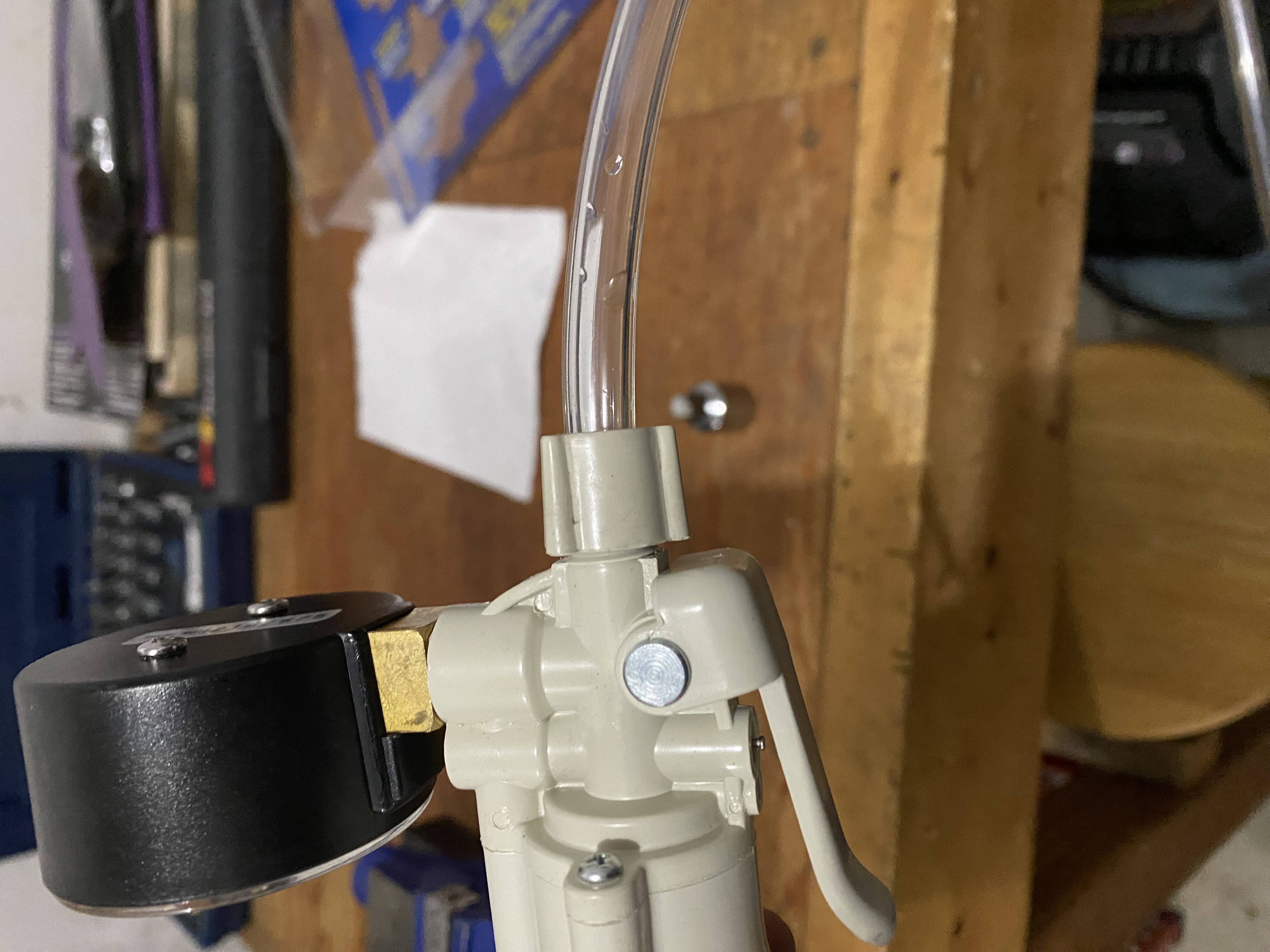

How do you have the mityvac hooked up?
Did you perhaps test the gauge itself, with a length of tubing plugged off on the end?
Post a photo of your gauge hookup, as I'm curious for my own testing purposes in the future.

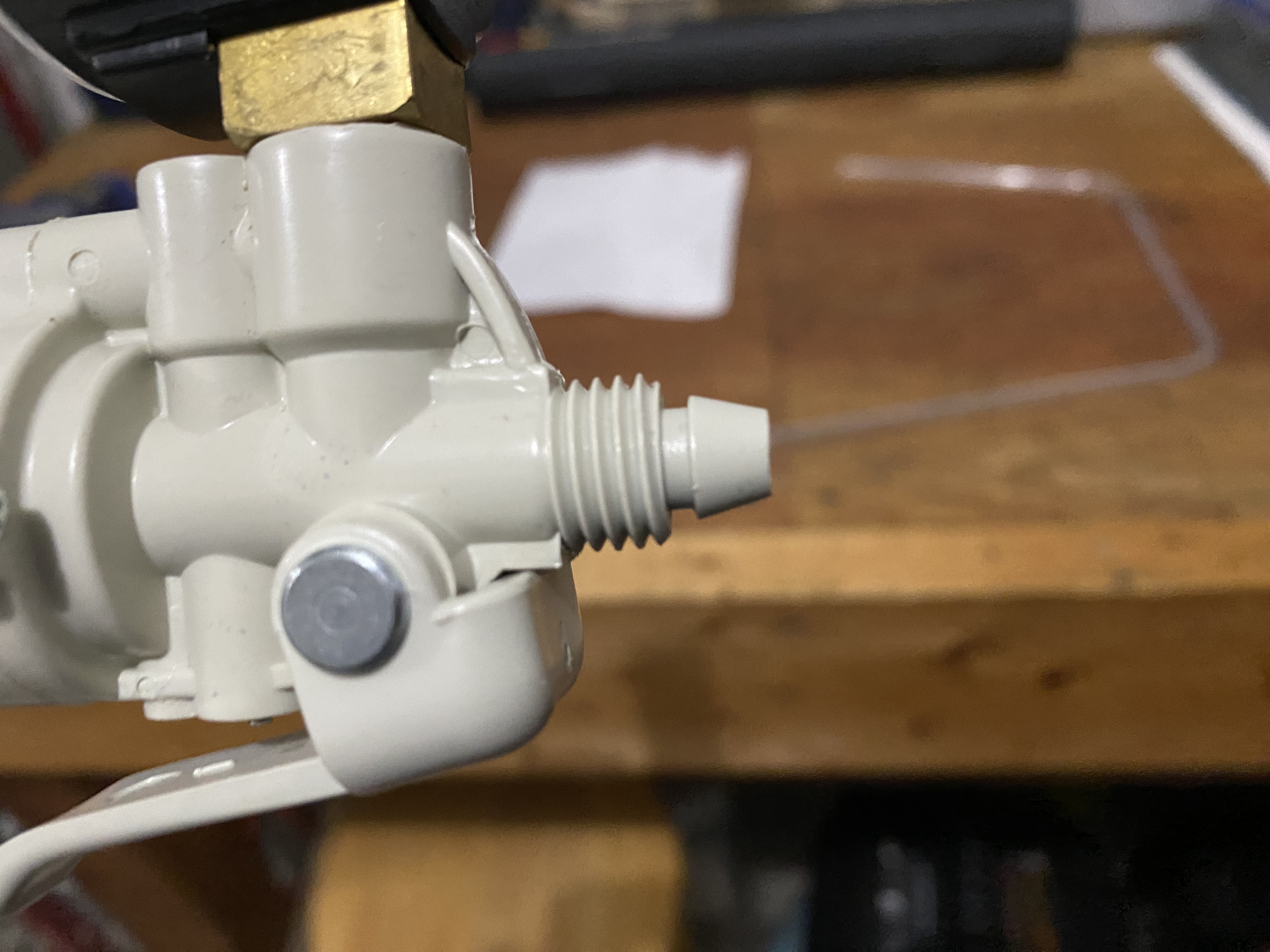

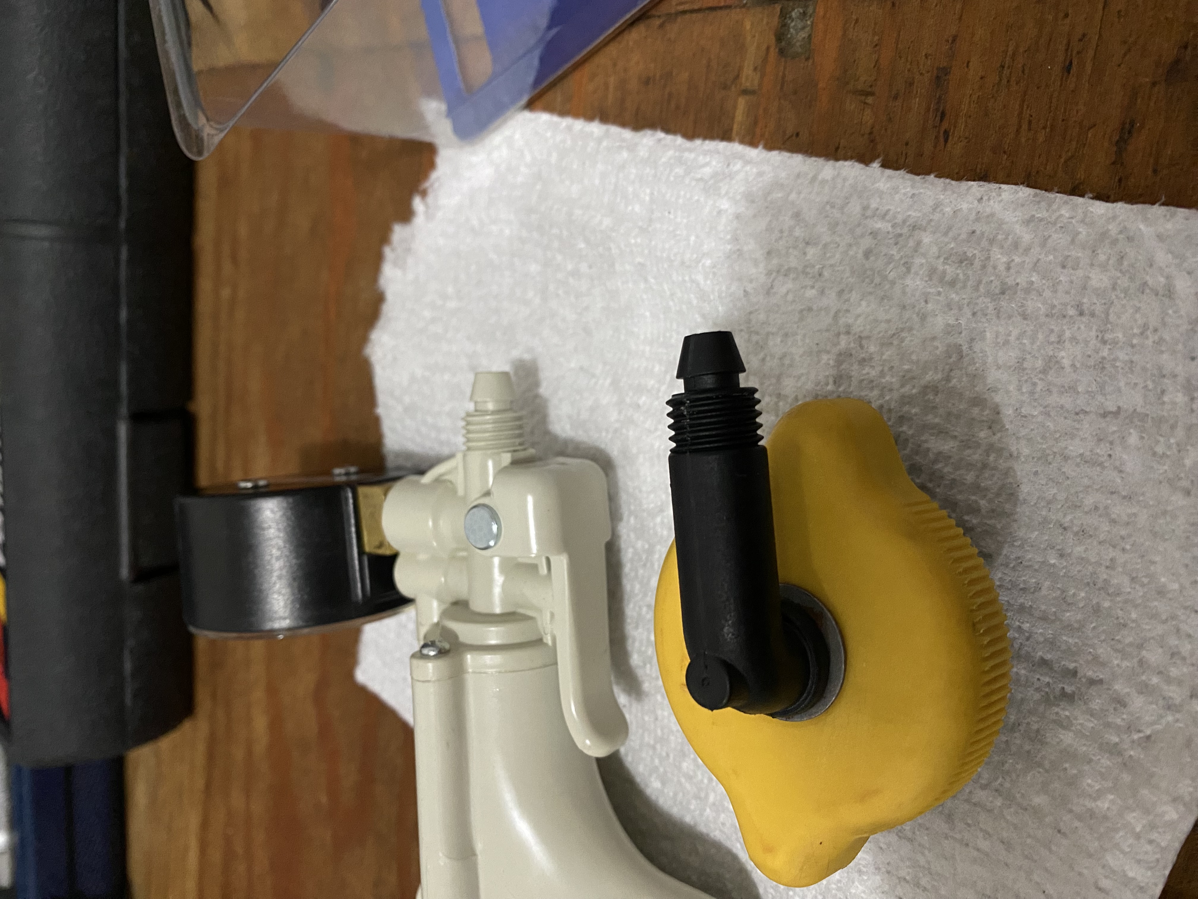

Here’s your pictures. They are compression nut fittings.Chuck78 wrote: 04:53 pm Sep 22 2023 How do you have the mityvac hooked up?

Ahhh.... I see! You've got a special test port radiator cap... I wasn't interested in the mity vac hose fittings, I thought perhaps you spliced in a test tee in place of one of the KDX coolant hoses...
Is that a Mity Vac motorcycle specific radiator cap test fitting? That would be useful to have....
- Posts: 610
Re: Kdx cooling system test with mityvac
Yea it is the fitting that comes with the kit. I just ordered a 5/8” x 1/4” x 5/8” t fitting. I’m going to cap off one of the 5/8” inch ends, and connect the other 5/8” end to the spout on the cylinder head using a hose. Then I’ll connect the clear hose coming from the mityvac pump on the 1/4in section. I’ll cap off the spout coming from the water pump cover and then test on the bench.Chuck78 wrote: 06:12 am Sep 25 2023Ahhh.... I see! You've got a special test port radiator cap... I wasn't interested in the mity vac hose fittings, I thought perhaps you spliced in a test tee in place of one of the KDX coolant hoses...

James - which one of the Mity Vac "small bayonet" radiator cap pressure test adapters fit our radiators? There's the MVA351 & the MVA352 (shallow). The 351 I might guess?????
- Posts: 610
The correct one is the MVA321, just confirmed.Chuck78 wrote: 09:30 am Oct 24 2023JZ05220r wrote: 02:50 pm Sep 25 2023Those are great ideas, I may try that, I have got one more headgasket I’m willing to put on the line. I love the idea of testing the cylinder off the bike. I could test the water pump seal in a similar manner as well. But no coolant in transmission oil anyways. ThanksChuck78 wrote: 12:15 pm Sep 25 2023 Also, I just had another thought. Looking at base gaskets and used KDX cylinders on eBay, you could potentially leave the head attached to the cylinder as is without touching it, remove the cylinder from the engine after disconnecting the power valve linkage pressure test the cylinder / head / head gasket off of the bike with water or coolant to look for any wet spots of coolant / water indicating any leakage. That would tell you exactly where your problem is. You could also just air test it and use dish soap water or some other type of soapy solution in a spray bottle to spray down all areas involved and watch for bubbling like you do when testing natural gas or propane piping, tires and inner tubes, etc.
