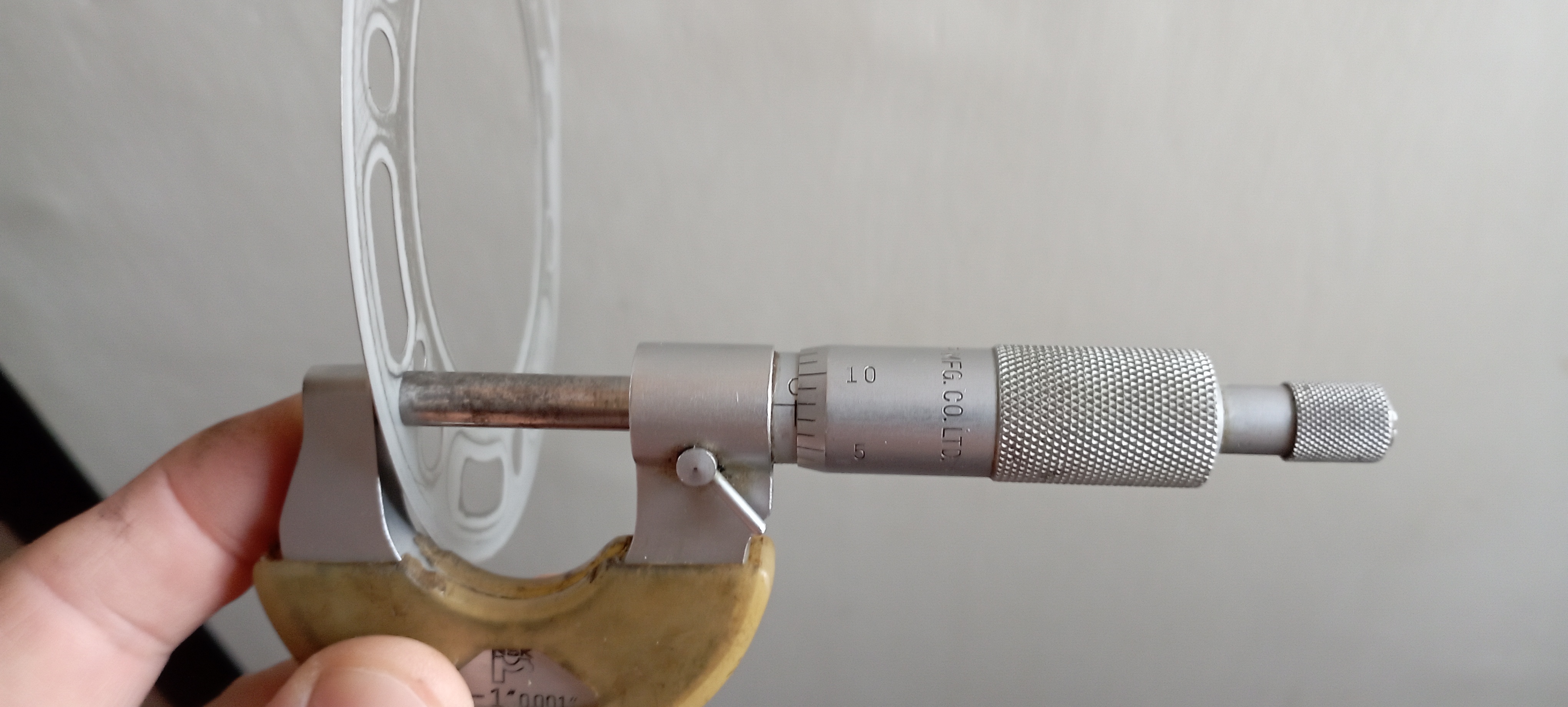

Re: Kdx headgasket thickness
OEM head gasket thickness with the silver coating removedChuck78 wrote: 02:30 pm Feb 08 2025 I came to the KDXR search function looking for the same info, being too lazy to go out to the shop and find an OEM gasket and measure it's UNcompressed thickness...
https://www.cometic.com/products/C7298
Cometic's 70.00mm KDX220 head gasket is stated to be 0.254mm or 0.010" thickness, rubber coated stainless steel (Multi-Layer Steel shim pack "MLS" gasket?) head gasket composition. They still list a 73.0mm bore composite head gasket (for the NLA steel sleeved 240cc big bore kits) even, as most everything that's not a frequent seller is made to order from Cometic.
Still curious as to the OEM head gasket thickness, if it's the same.
- IMG_20250209_171710.jpg (1.74 MiB) Viewed 6673 times
- Posts: 1175
Oh wow, I'm surprised to see you with inch sized tools, also surprised by the thickness.
After reading a lot of positive reviews here on the forums about Cometic gaskets who are based out of my home state here in Ohio, USA, I will probably exclusively by their top and gasket kits with their viton-coated stainless steel gaskets, as I think that will definitely be as good or better than OEM and seal coolant in much better. It says rubber coated on the website but I am assuming that is Viton.
Lol. I collect vintage micrometers so they are all in inches, I have 15 in my collection, Starrett being the highest value,Chuck78 wrote: 11:39 am Feb 09 2025 Oh wow, I'm surprised to see you with inch sized tools, also surprised by the thickness.
the OEM head gasket has a silver coating then on op of that there is a sticky coating, almost like wet silicone, I've reused this one many times by scrubbing it clean then using the lightest smear of three bond 1211 which is designed for head gasket use
