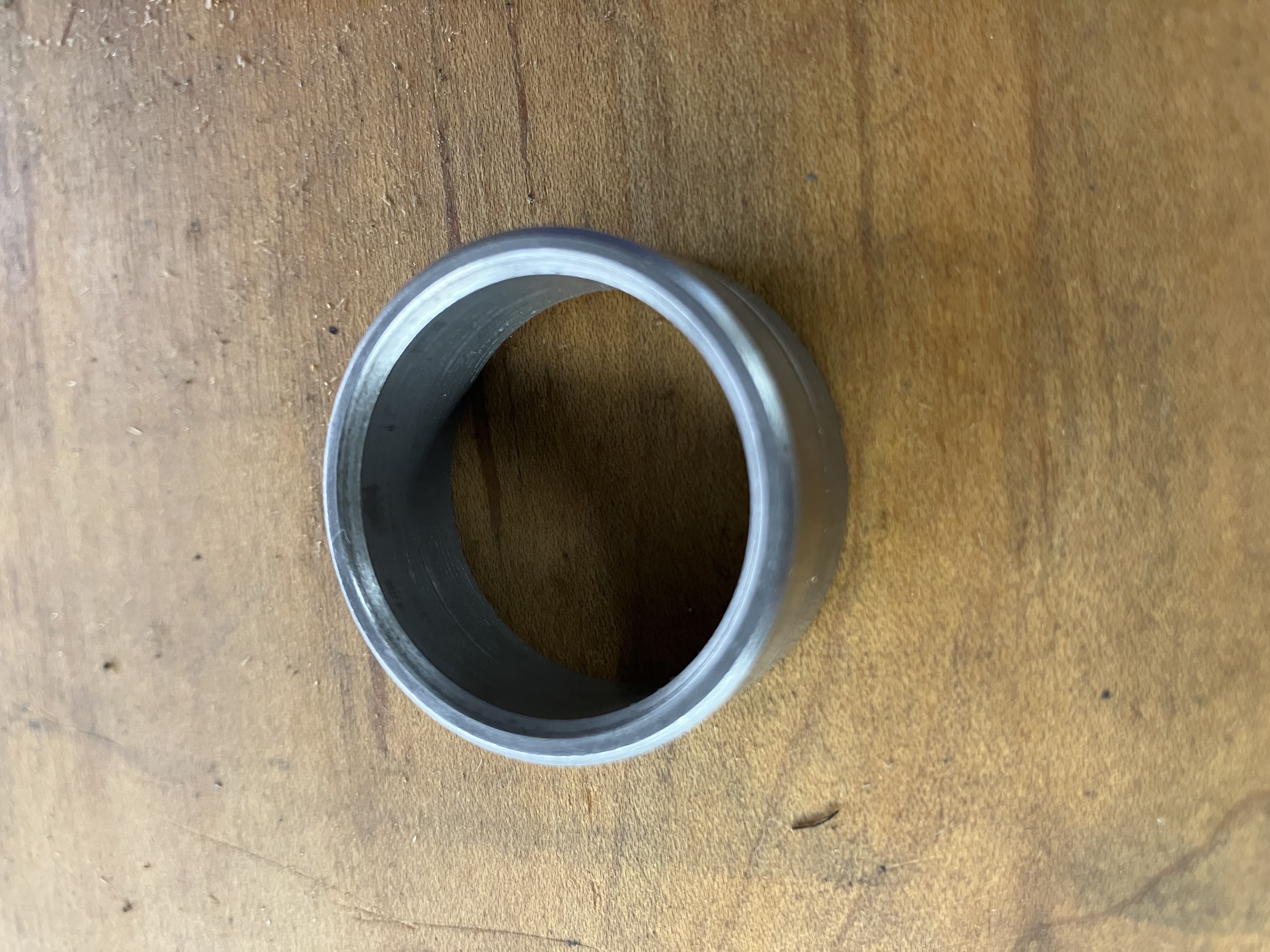

Here is a pic of the business end of the sleeve that goes into the seal. It does have an internal chamfer that could possibly be to accommodate an O-ring. I have looked in my hoard of O-rings and I don’t have anything that size that is thin enough to try.
The problem is that the parts diagram don’t show or list an O-ring so how do I determine the size needed?
I measured the outer edge of the splines on my 92 model and on my 87. It appears that they both have a 25mm shaft. I suppose I could order an O-ring for the 92
and see if it works it would have to be pretty thin to not interfere with the sealing lip on the seal against the sleeve.

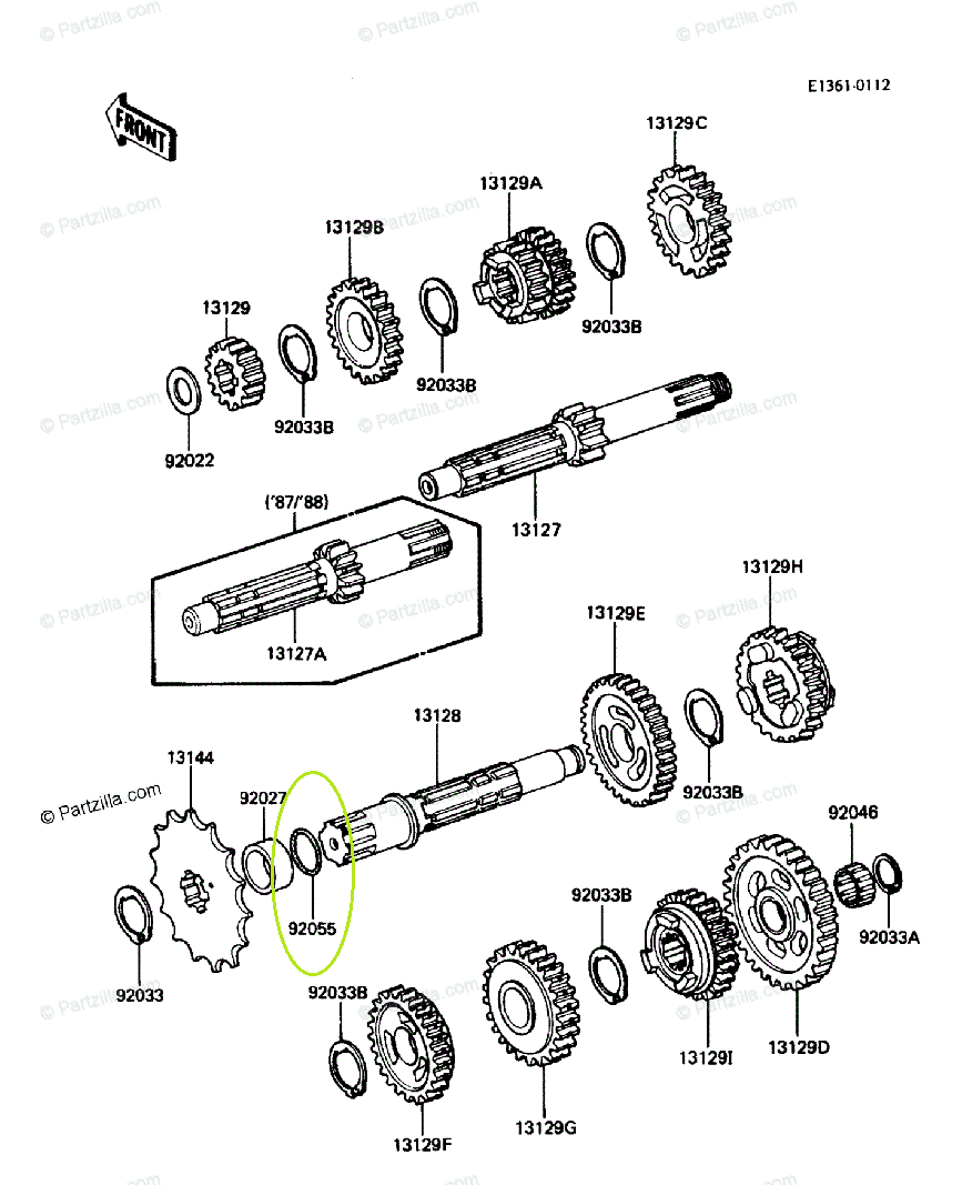

I posted a minute ago but don't see it showing up. Go to Partzilla.com and pull up the transmission diagram for your bike. Its supposed to have an oring.
Part number 92055-035 for the 87 KDX200
- Posts: 887
- Location: Florida
Re: 1987 countershaft seal debacle
Make sure to stick a small metal 90 degree or hook shaped pick in there and check that an old oring isn't jammed back there before installing the new oring.
Edit: It is the same part number for the 92 also. The 92 takes 2 orings and the 87 takes 1.

Hmmm. I’ll give that a try. I assumed the Kawasaki parts diagram would be accurate but maybe not. Thanks for the tip.
I took a close look inside when I installed the new seal and didn’t see any sign of an O-ring. I completely rebuilt this bike several years ago and I either used the Kawasaki parts diagram as my guide or if I put an O-ring in it has completely deteriorated.
When I ordered the new seal and that I installed it a few days ago I was actually surprised to see that according to Kawasaki it didn’t require an O-ring.

That collar / sleeve with the chamfer/taper ABSOLUTELY is designed to have an o-ring there, and will ALWAYS leak without it.

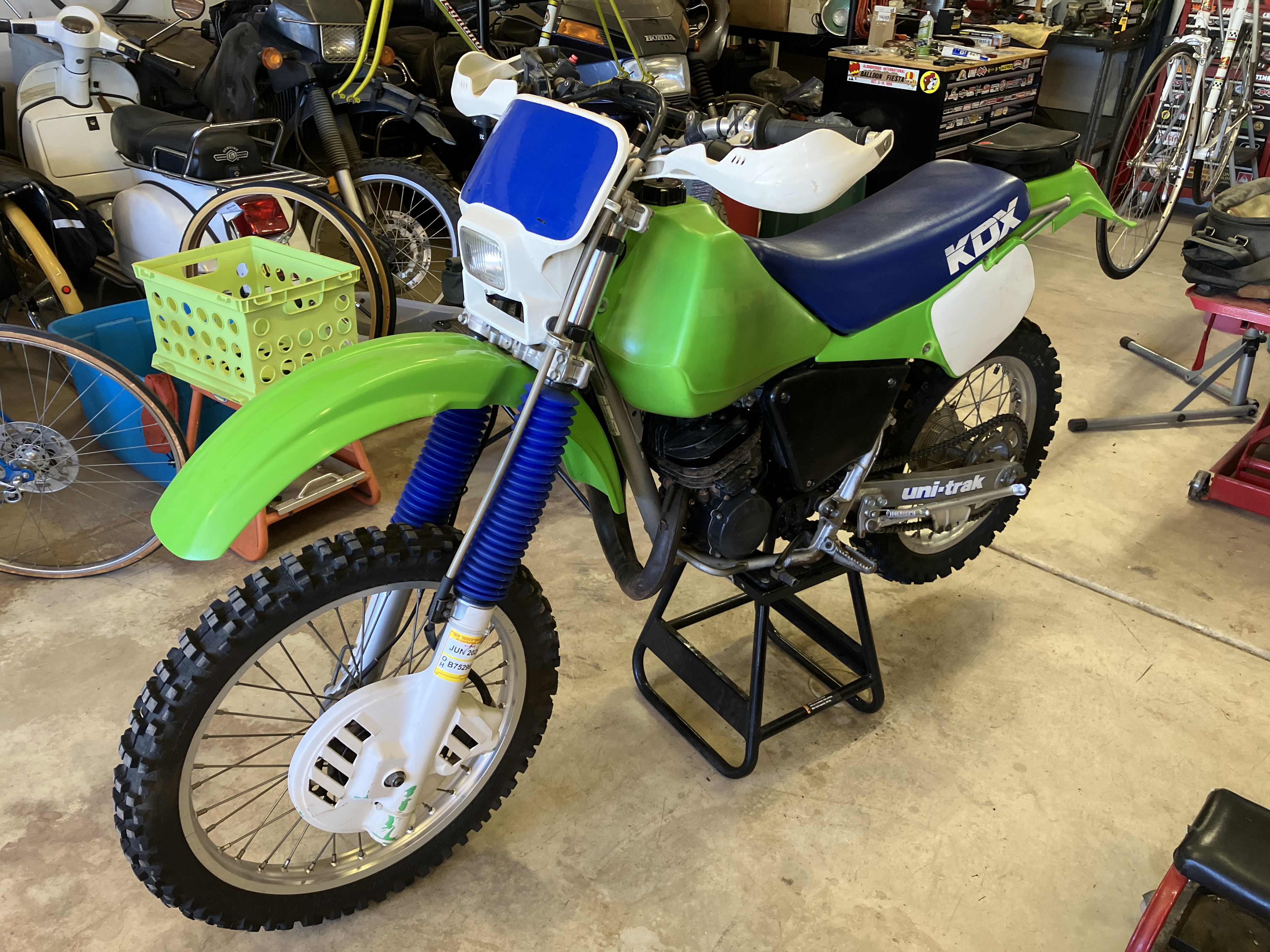

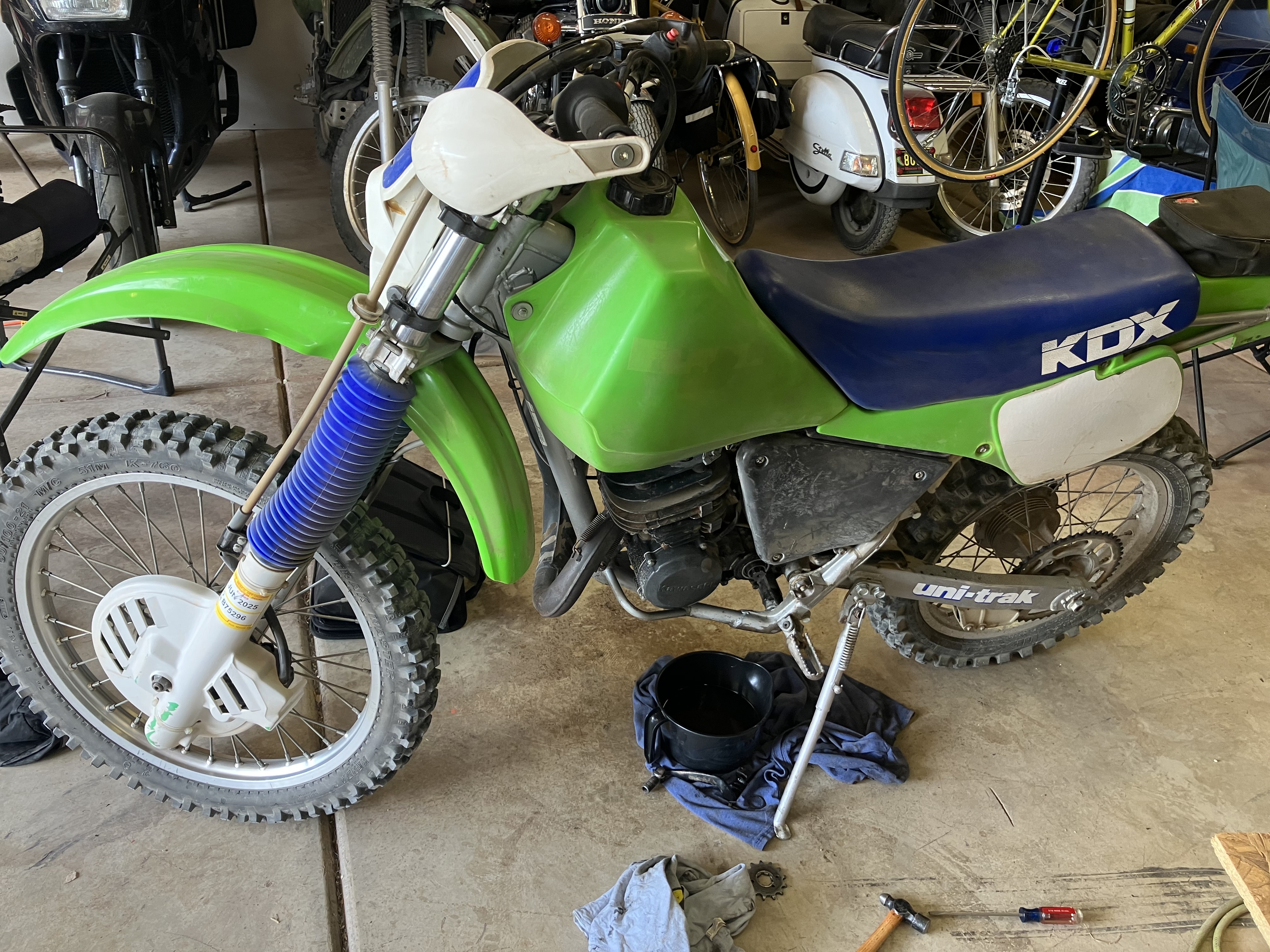

I actually hadn’t ridden this bike for quite a while. I moved from Oklahoma to New Mexico a couple of years ago and had to go through a lengthy process to get my KDXs registered in New Mexico. Oklahoma didn’t require registration for a dirt bike. I finally got the registration for both bikes and was able to get the off road permit that is required to ride an OHV vehicle on public land.
I finally took it to a local riding area. It hadn’t leaked a drop sitting on its stand but about halfway through the ride I noticed the leak. I was able to finish the ride keeping an eye on the sight glass. It did not disappoint. I was riding some pretty gnarly singletrack with a few riders on much more modern bikes and they were definitely impressed.

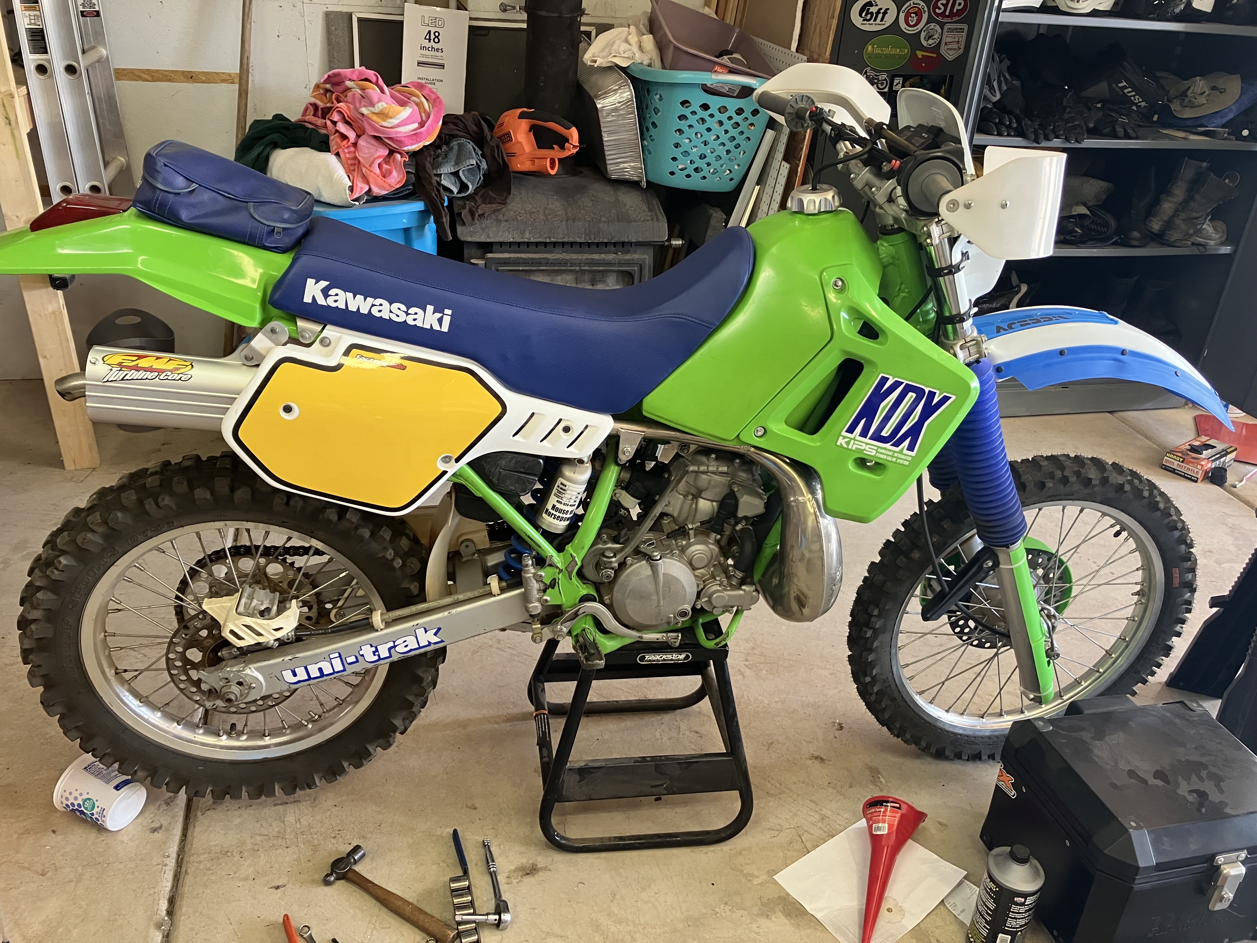

It’s an extremely capable bike and very easy and comfortable to ride. Next I’ll be taking my 92 model out on the trail for the first time. I finally fixed a pesky fuel tank leak and rebuilt the rear caliper and slave. Now I am just waiting to receive the Forest Service sticker and I’ll be good to go.
Thanks for the tips and setting me straight on the o- ring.
Here’s a couple of pics of my bikes waiting to be put to use.
