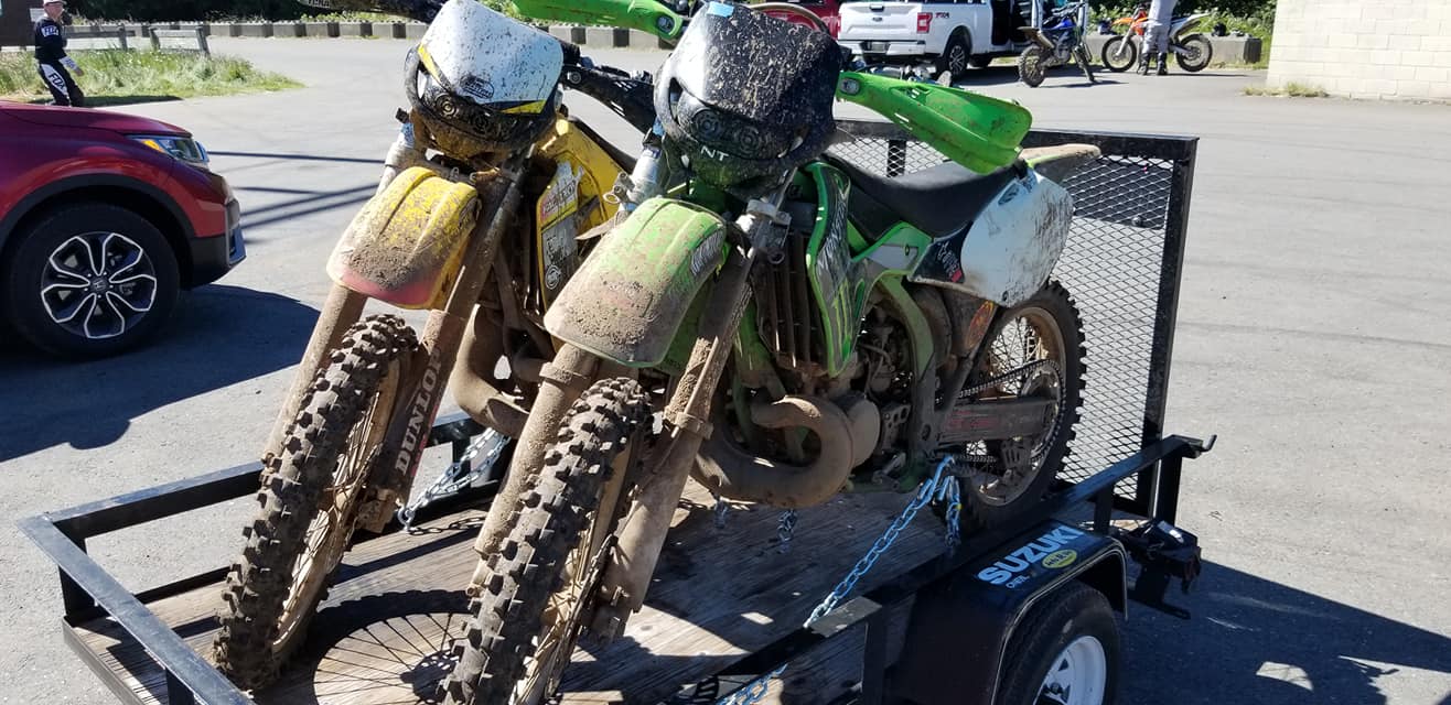

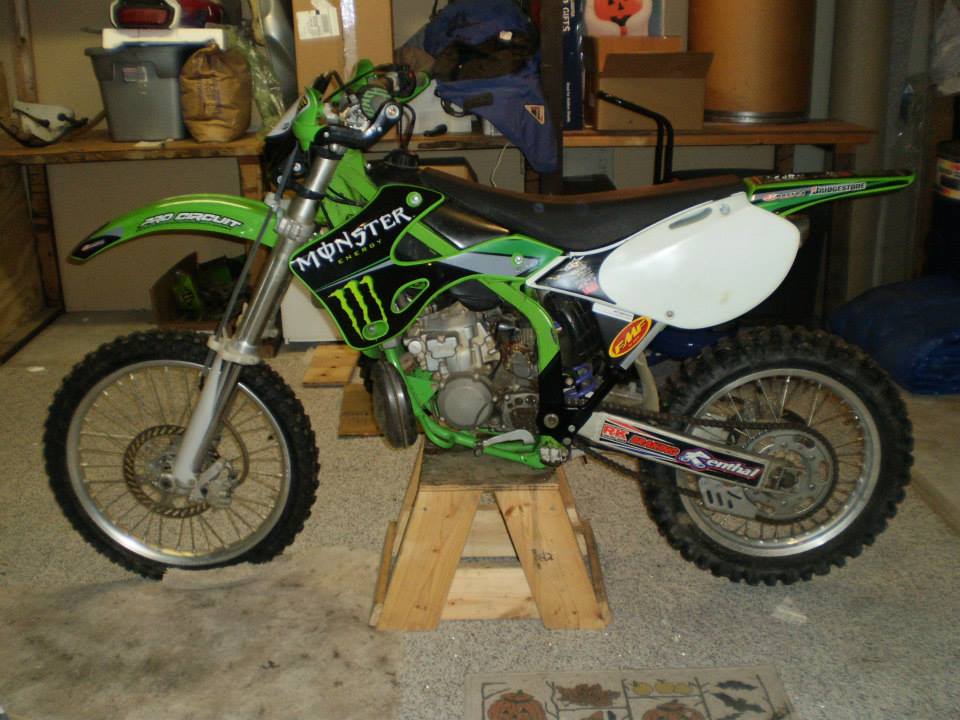

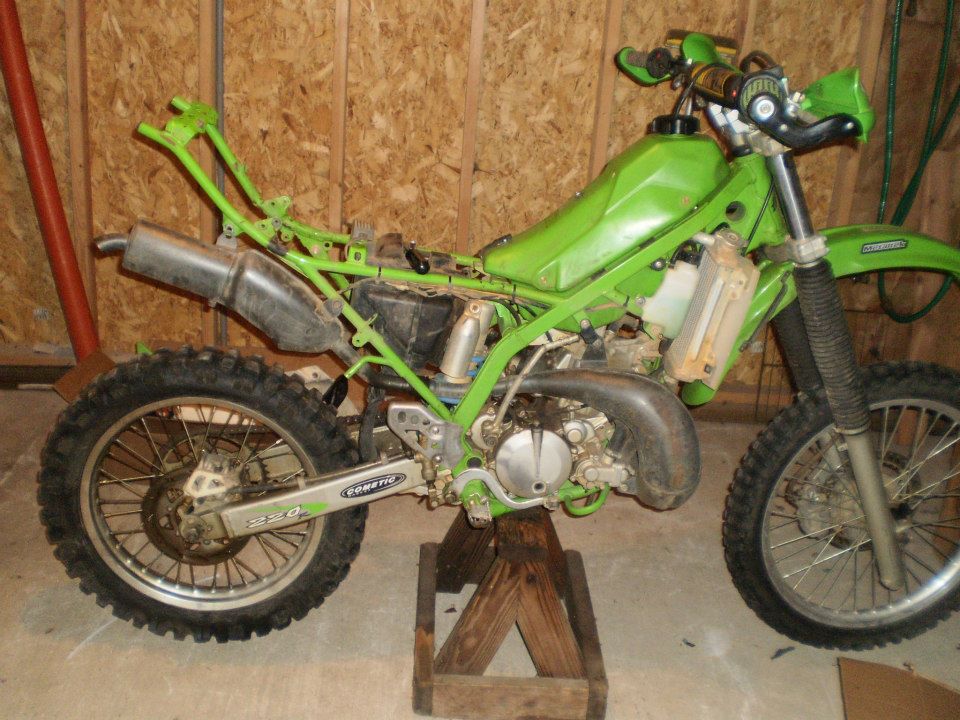

I have a KDX220 Hybrid built on a 2001 KX125 frame with 2001 KX250 forks. I had my KDX from day one for 10 years and loved it. A wreck that tweaked the back half of the frame led me to do a hybrid build. The hybrid definitely "feels" lighter, though it weighs nearly the same. The rake on that year is .5 degrees steeper than the 220 frame which in theory should make it turn sharper, but the wheelbase is half an inch longer on the 125 so on the trail it feels a bit longer than the KDX and doesn't turn quite a s tight. Part of that may be because I haven't modified my steering stops which would give me a little more arc on the fork swing, but for what I ride it's not really an issue. The easiest way to describe it is that on the KDX I always felt like I was sitting "IN" the bike, and the 125 frame feels like you're sitting "ON" the bike. I prefer it as it really coaxes you to stand more (the seat on the hybrid is thin and HARD, sitting for any length of time gets a bit uncomfortable, but that would be expected from a MX frame). Honestly you could spend the money on the suspension of the KDX and get nearly the same performance, but for me at least the hybrid just feels better. Its an entirely subjective thing. My son has a 98 RMX250 which is a lot like what a race KDX would look like, and he prefers the ergonomics of it, but he is also 5 inches taller than me so the bike isn't really set up for him. The hybrid doesn't really feel top heavy, but then I never really felt like the KDX was either. In the flowy stuff the slightly longer KX frame really shines, in the super tight woods the KDX really shined for me. At the end of the day the only question that matters is given the choice would I go with a KDX again or with the Hybrid, and for me the answer is Hybrid
Pics for because...
Pics for because...
- trailer.jpg (131.44 KiB) Viewed 36321 times
- hybrid.jpg (88.21 KiB) Viewed 36321 times
- 395510_10200346316010022_1102412439_n.jpg (134.11 KiB) Viewed 36321 times

Seeing your second and third photos back to back definitely illustrates why the KDX might feel more top heavy than a KX125 hybrid... compare where the additional fuel weight is carried... ALL UP HIGHER!
The fact that a fair bit of the fuel tank sits under the KX125 seat, versus on the KDX with the fuel tank sloping up dramatically and having all of the additional volume up high... I think the fuel tank sits lower overall on the 125 as well, especially considering how one of the hybrid builds that I read of had issues with the KX 125 aftermarket desert tank's petcock hitting the KDX 220's cylinder head.
It is now even more apparent why the H series KDX has issues fitting a standard Lectron carb, Smart Carb, etc... That giant sofa of a seat! The shock crossmember sits much closer to the carburetor in order to make room for the very thick cushioned comfortable seat...
I still have a third 220 engine and only two bikes, and it is nice having a spare, but it may still continue to tempt me! I think a woods ported 144cc big bore with woods valving and 18" rim may be the better answer as far as shedding weight for a lighter feel and a bike that's easier to pick up. But a modded 220 engine is just absolutely brilliant in the gnarly nasty terrain... Since I started lusting after a 144 woods bike for the weight savings advantage, I really began noticing how often I lug the 220 and how well it lugs... I think I'd really miss that if running a 200 or 144.
Honestly I think a 220 H-series engine in an E-Series KDX200 with 1996+ Showa Twin Chamber forks and shock or even stock shock with RaceTech Gold Valves and identical looking Showa 49mm conventional forks but open chamber DRZ400 versions lowered 1" internally might perhaps make a much lighter feeling ultimate woods machine... This is a hybrid of sorts as well... The center spine E-Series frame allows the gas tank to carry a significant amount of the fuel weight much lower than an H-series, and those 88-89 KX derived side covers look too cool... Maybe I'll also keep an eye out for an E-Series roller with bad fork and no engine... And adapt H-series radiators and engine to it (the engine is basically a direct swap).
