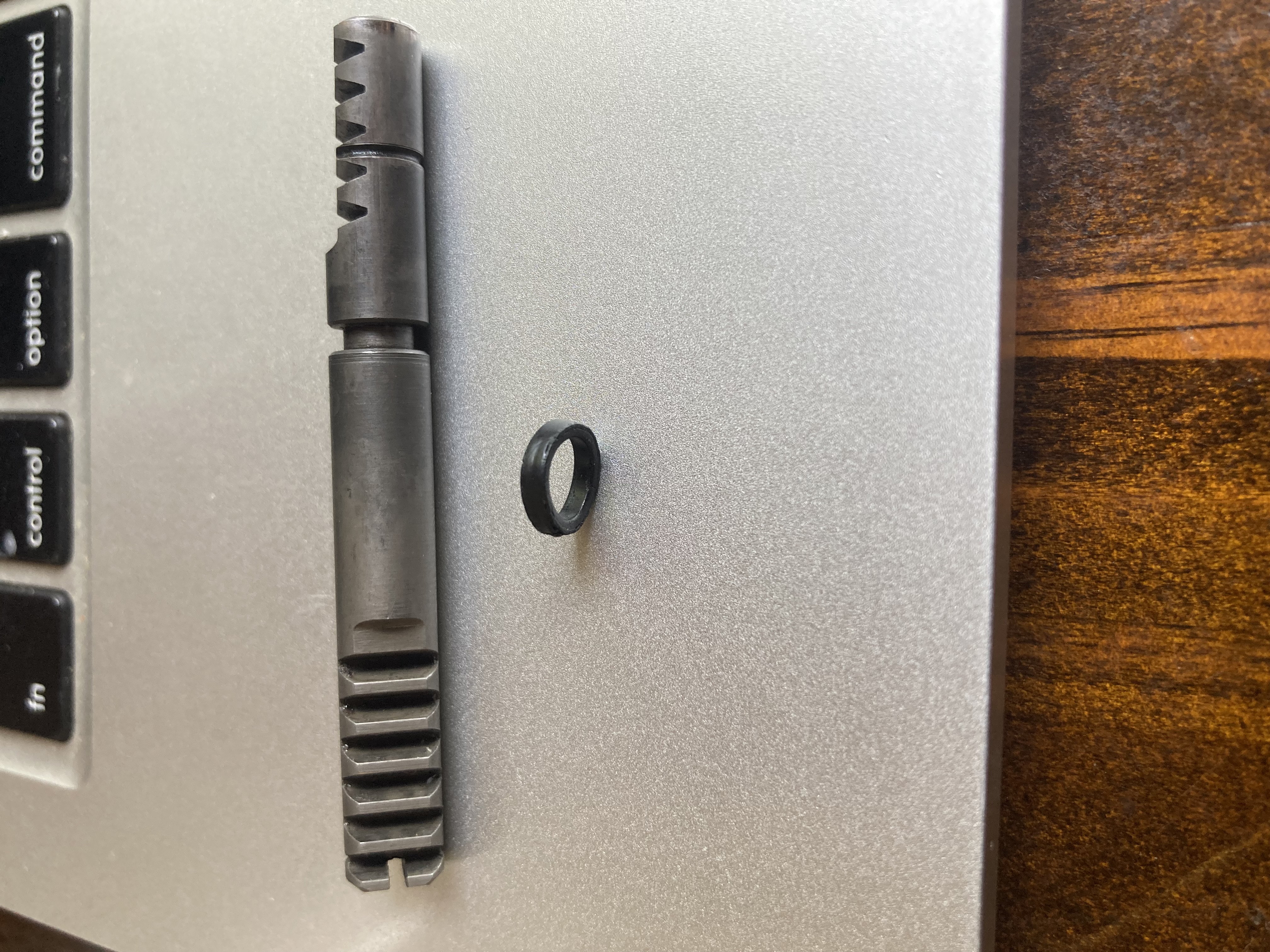

Posted: 11:28 am Jul 03 2024
by jamiethegiraffe

Here’s what I did that worked this time around:
Bought the smallest nitrile o ring I could fit over the shaft. Even with some stretch, the OD was still too large to fit the shaft bore in the cylinder. I used a bench grinder with a wire wheel to sort of “turn down” the o ring until it was just barely larger than the shaft. It made for a nice tight seal but didn’t make the power valve assembly bind up at all. Don’t forget to grease the “packing” as per the manual.
