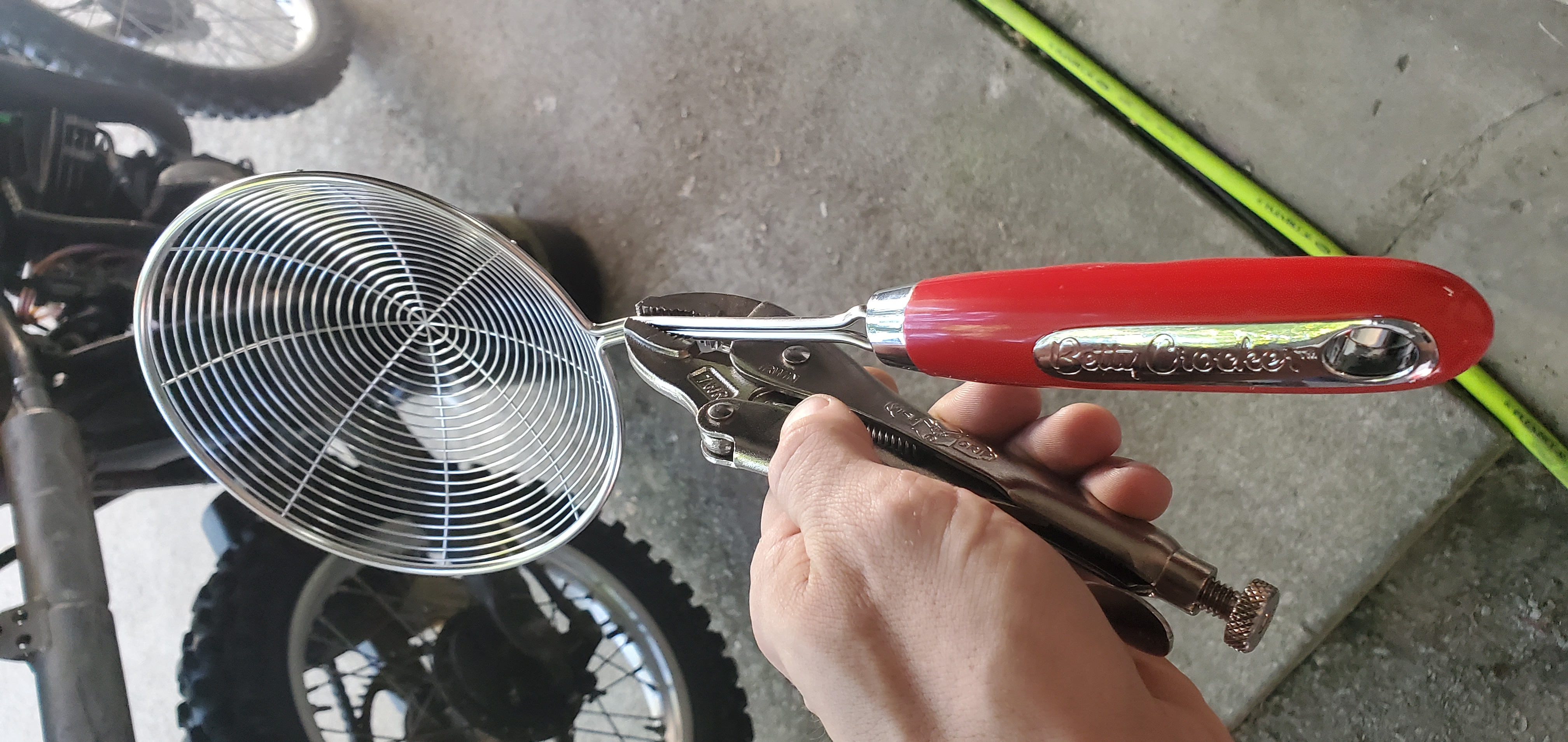

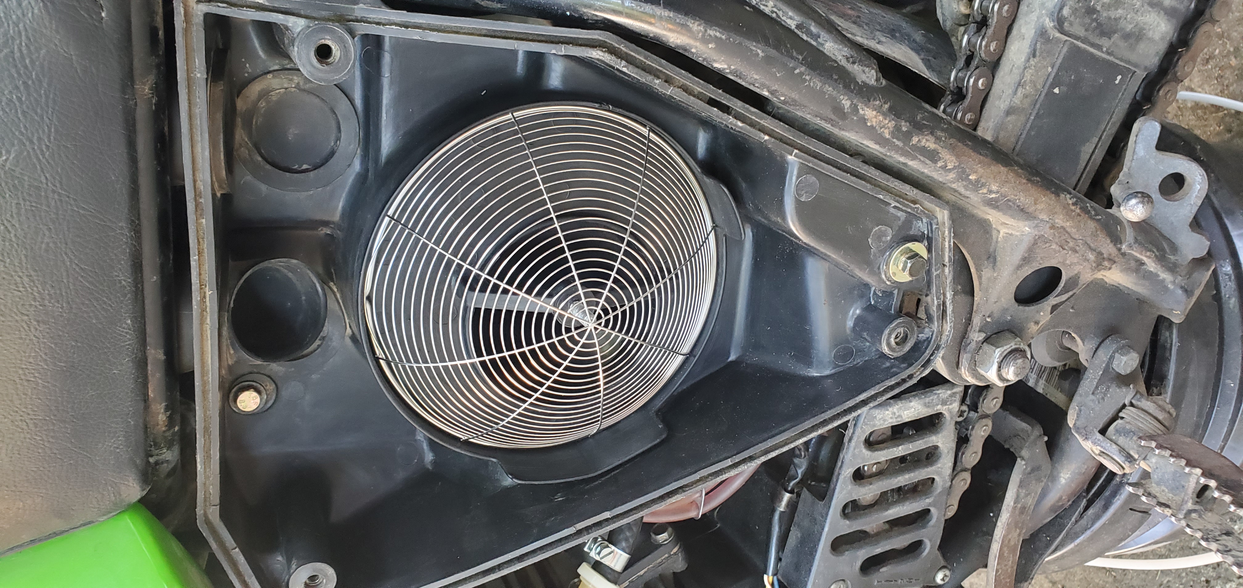

Steel mesh at Home Depot was stupid expensive so I figure I may as well see what the dollar store has for, well, anything. And well, sometimes my genius scares me haha, because I found the perfect filter cage with a little modification... not done yet and still waiting for the 82 cage-less UNI filter to show up but this is what I came up with, and it fits in the housing PERFECTLY! LOL...

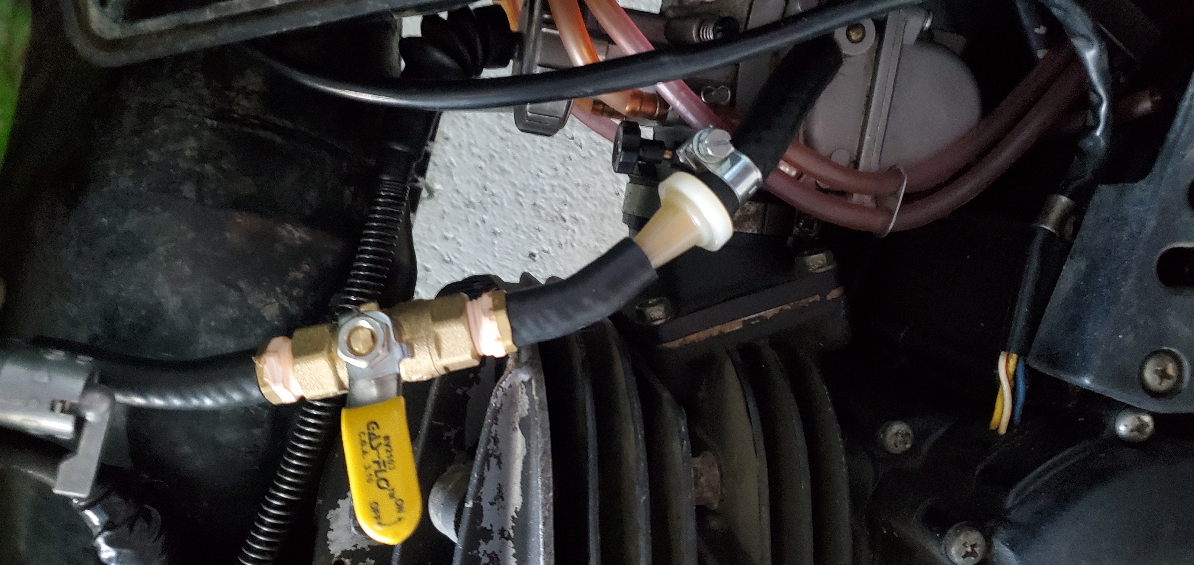

Oh and got the fuel petcock thing figured out with an in-line from the auto parts store with some high pressure fuel hose(for stiffness) and a new filter.

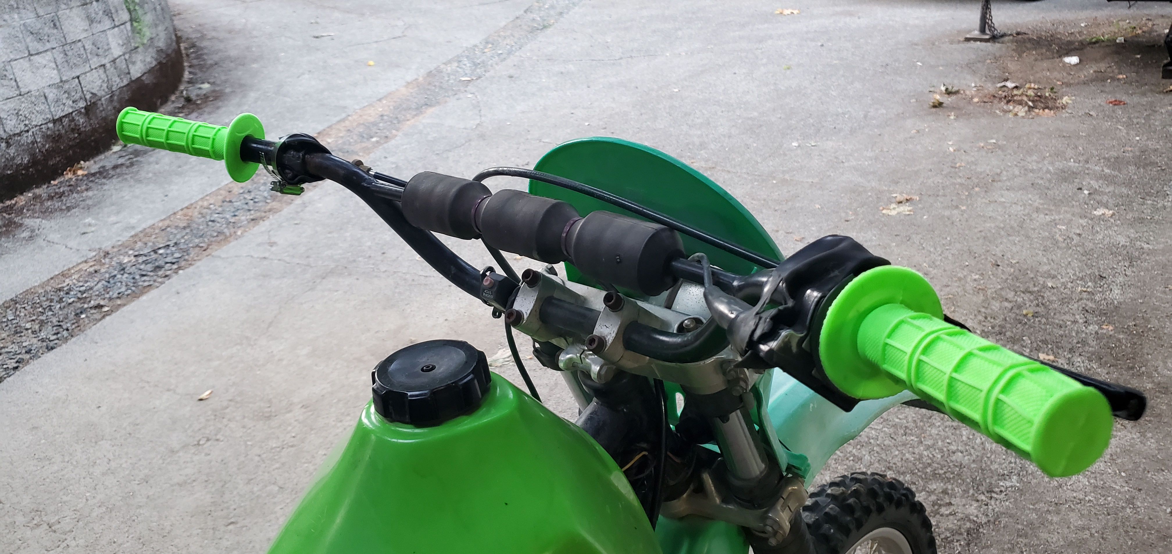

Also new grips!

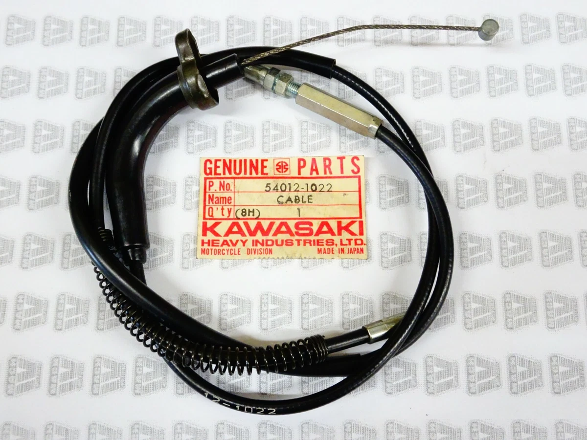

Most throttle cables have a section in them for adjustment like in the pic below. That long hex shaped part along with the nut and the part that threads in to the long hex section does the adjustment. Otherwise, you have the screw at the throttle and the screw cap at the carb.

And someone definitely put some random throttle cable on with this ebay Keihin carb.. I guess the jankness was there to take up the slack because I got no hex adjustment, only adjustable thing would be at the throttle grip, I'll see if I can find some vids on how to do that and see if that works.. thx again.

managed to get rid of the slack with some rejankification, but in a much better way than before lol. getting full throttle now! there was in fact some hex nut adjustment hidden under a piece of rubber at the grips but it was maxed out so just had to install a spacer of sorts at the carb. test run this weekend!! cheers.
