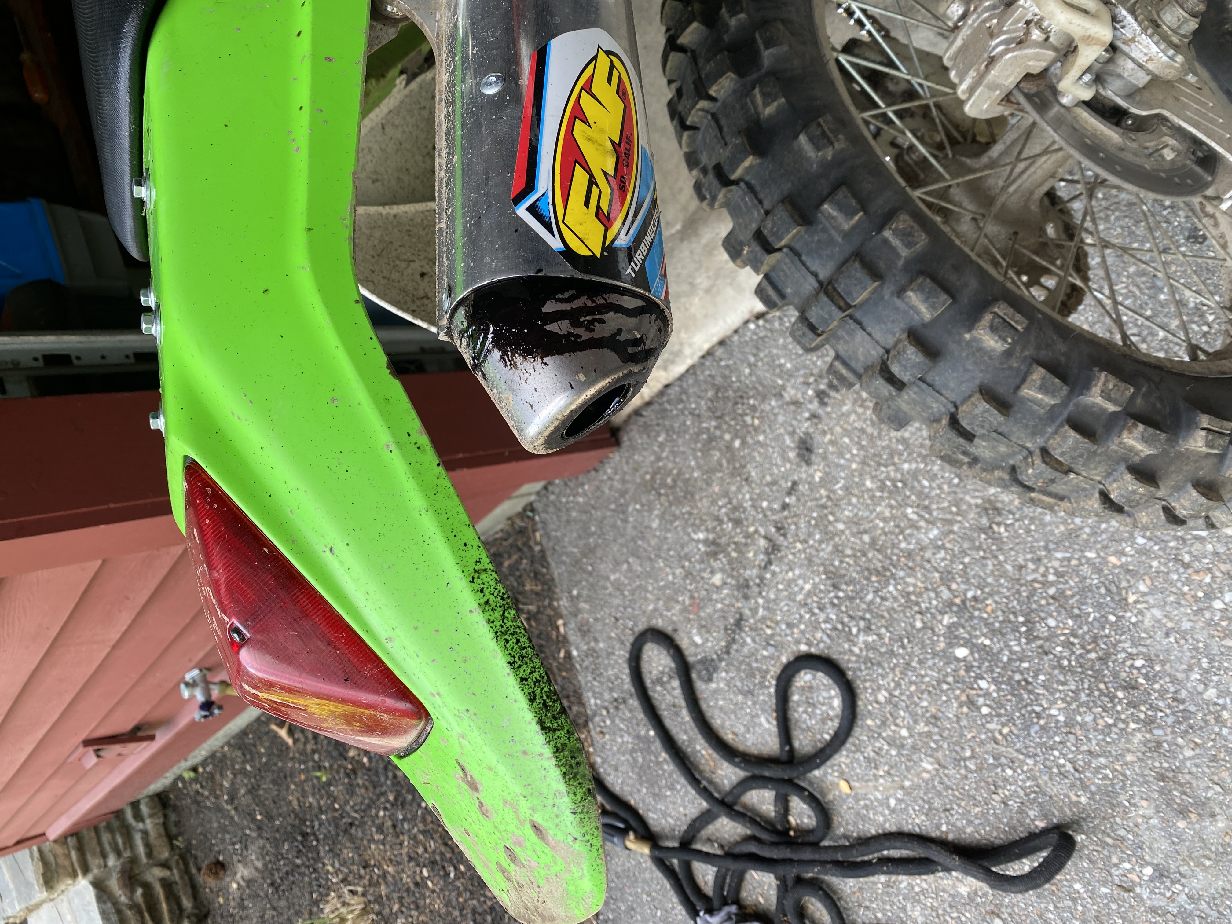

I went to 2 and it cleared a lot of hesitation. Still lots of smoke and slightly blubbery and less responsive when mashing the gas or going 1/2 to full throttle. It’s only smoking when I decide to push it harder. For example I’m trail riding for awhile and coming to a field and banging through the gears. When I look behind me I can see lots of smoke. I’m jetting based off feel and alittle worried that going down to the 145-148 main will be too little. Maybe the porting has added a lot more velocity through the carb and I’m sucking down too much fuel. Still having fun out there but definitely not gonna stop here. Also here’s a pic of the fender, and end cap. (Yes I know I need to drill it out and reseal with new rivets.) Thanks !

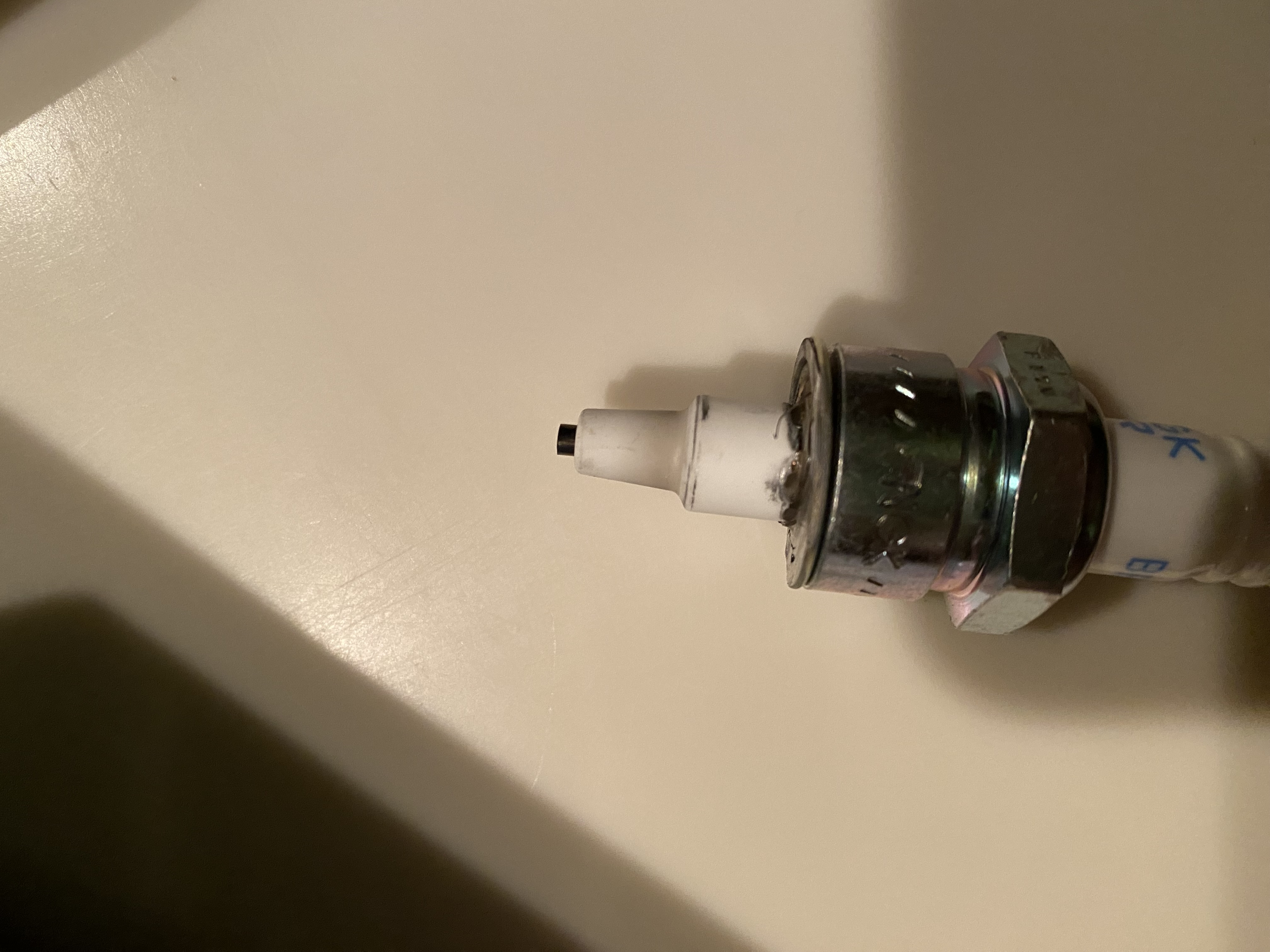

I also pulled the plug with about 3 hours on it and it wasn’t looking great. I’m so confused, I really don’t understand this situation. Ron’s baselines settings should be close but I keep seeing this ugly spark plug. Leak down test was great, carbs sealed up nicely. What the heck. I’m gonna order a coolant temp cap and take it out for a ride when I find the chance.

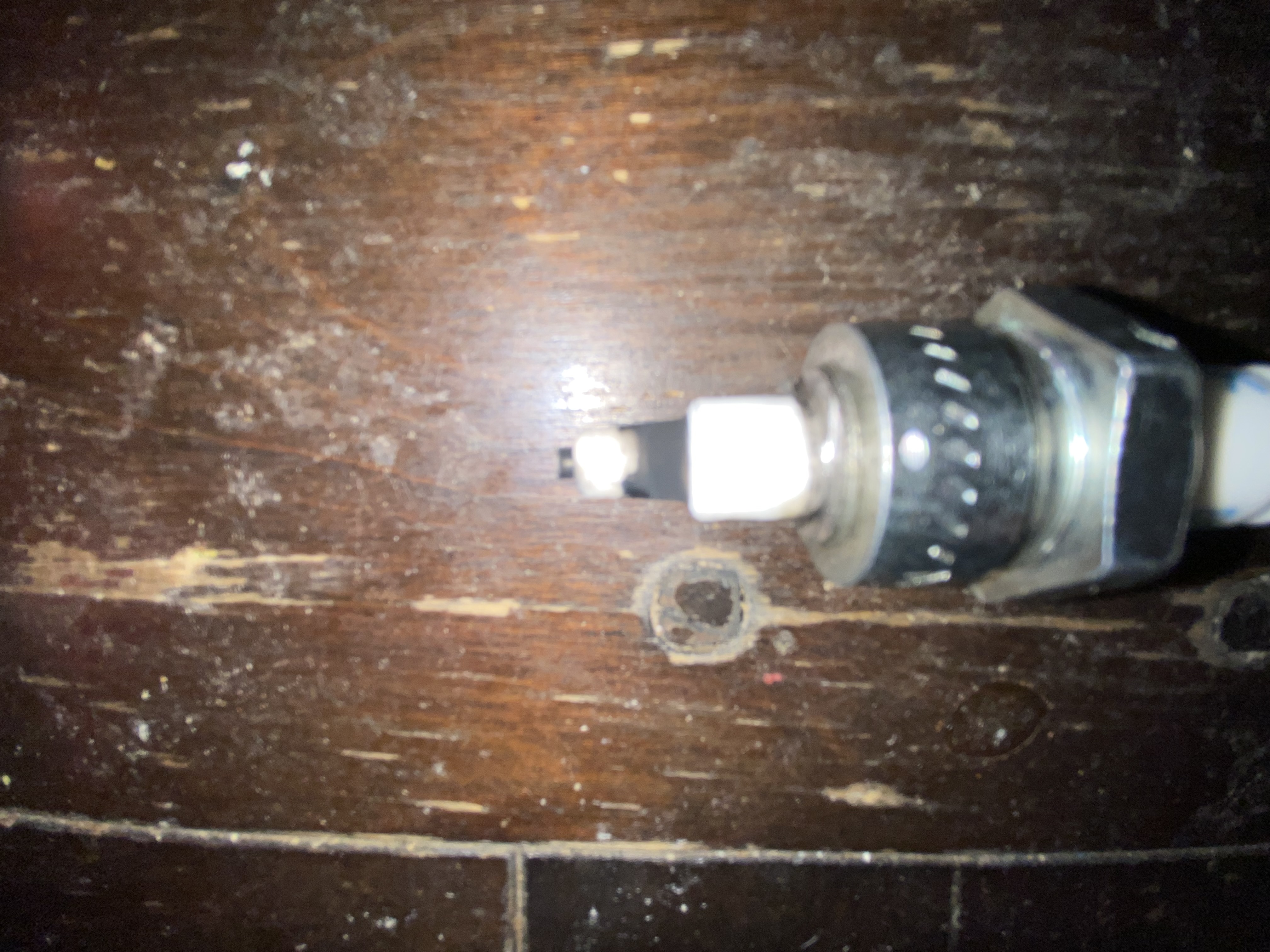

I’ll give that a shot. The plugs looks like it’s getting real hot but I don’t see a problem with running the br8es. My 1991 looks and runs perfect with 4 hours. And it shows. Nice mocha color gradually getting dark toward the base. I can’t say the same about the 220. Look at this plug though. Couldn’t get it to focus

IIRC RBs baseline is for a stock KDX with the modded carb. Change pipes, reeds, porting, etc will require changes away from the baseline. The only reliable way I've ever had results with is the published jetting method you can find on here. Change one thing at a time, and do the pulg chops. Yes it sucks, Yes its boring, Yes it works.

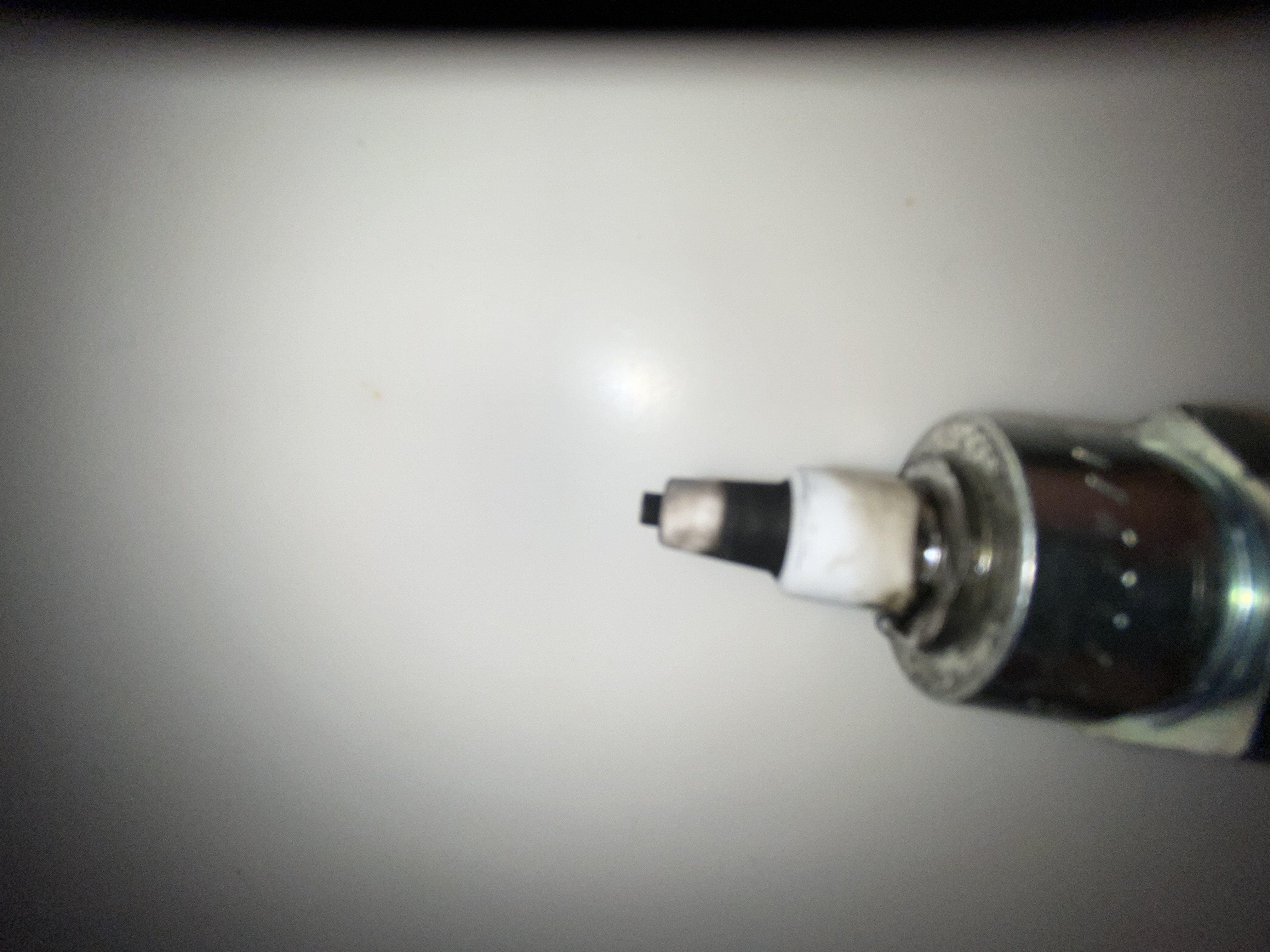

I tried my best to follow the jetting guide the past hour. Started with pilot jet. Follow the procedure to a t. I ended up around 3 turns out with the fast idle with a 40 pilot. I went to a 38 pilot and was still around the same area. Basically the further I turned the air screw out the higher the idle would get. I then attempted to fine tune it but I couldn’t get a good feel. I really think the porting has robbed alot of off idle response. I then went back to the needle on the throes groove. Went from 1/4 to 3/4 throttle several times and it didn’t hesitate but didn’t sound right and was still blowing smoke from part throttle to full. I got fed up and skipped straight to the plug chop. I wasn’t even able to fully rev through 6th as the bike started to feel off like it was losing power when going through the gears and being that hard on the gas the whole time. That’s where I am at. I still looked at the plug and this is it but I’m talking on 250 -300 feet of full throttle

I don’t know what’s with the bike bogging while going through the gears for a plug chop. It just seemed to hate that and felt even worse when doing. I the smoke says to go leaner but the plug and the bogging during the plug test says otherwise. What a pain in the butt. I want to take a look at the top of the piston and see if that can give me any ideas then continue on with jetting.
